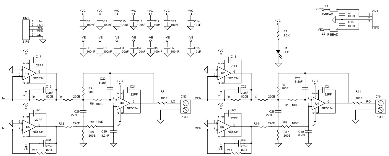

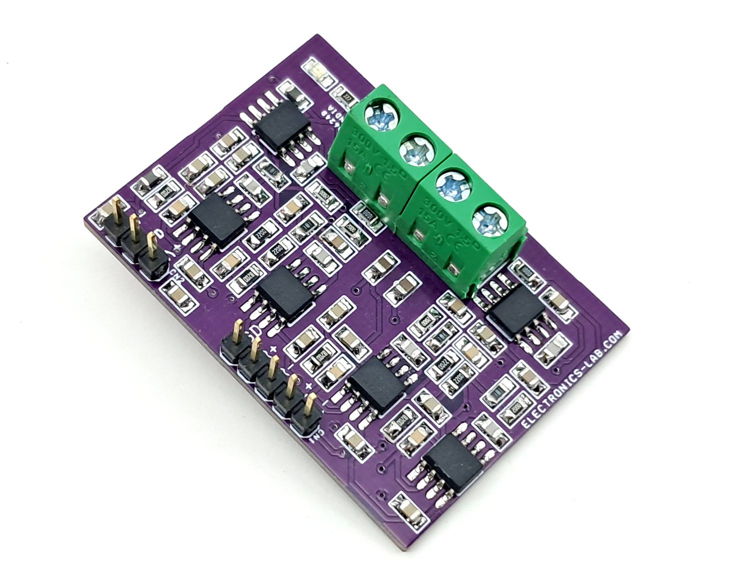

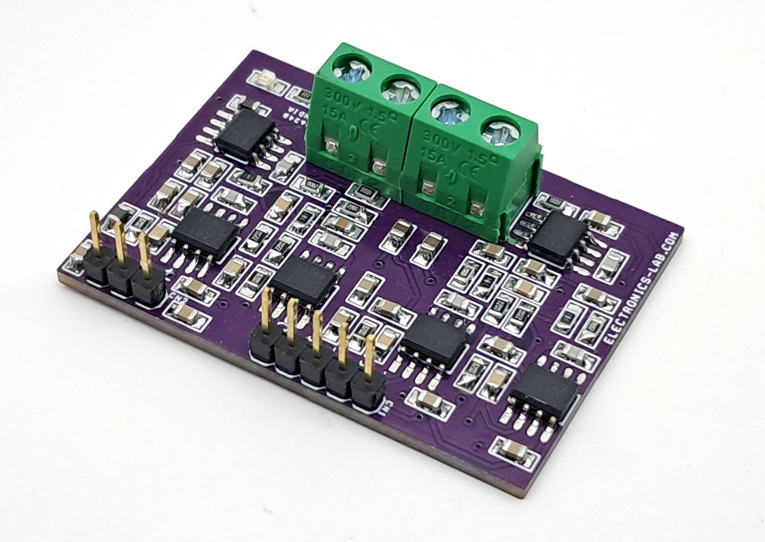

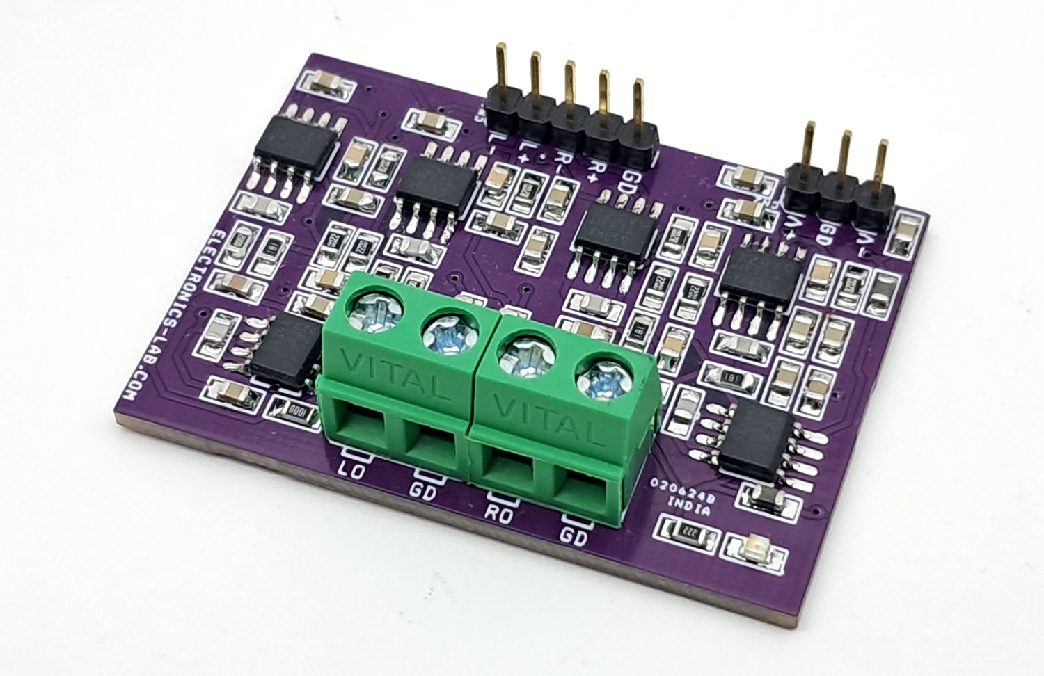

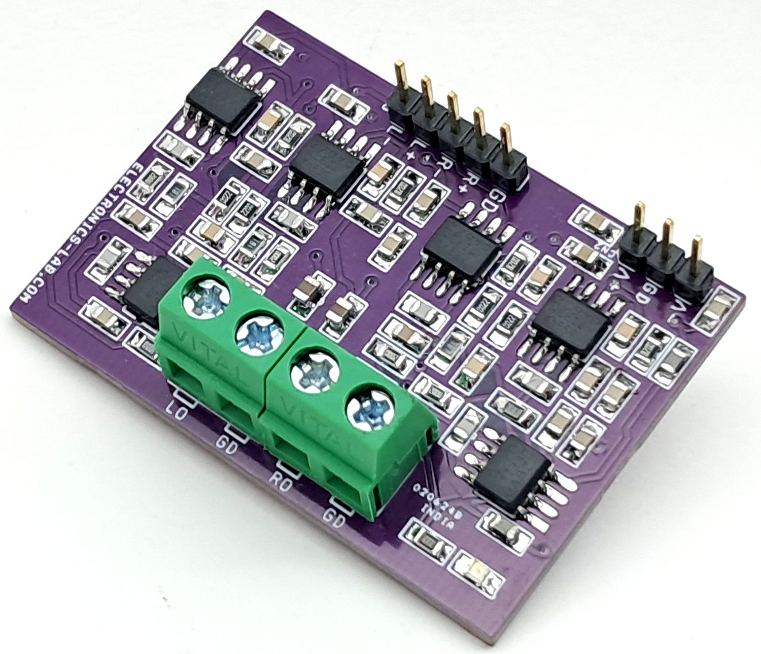

Many high-performance audio digital-to-analog converters (DACs) feature a current output that must be converted into a voltage output for use with audio amplifiers. In premium automotive audio applications, for example, it is critical that the DAC signal-to-noise ratio (SNR) and total harmonic distortion plus noise (THD+N) performance is not compromised by the current-to-voltage (I-V) output stage.

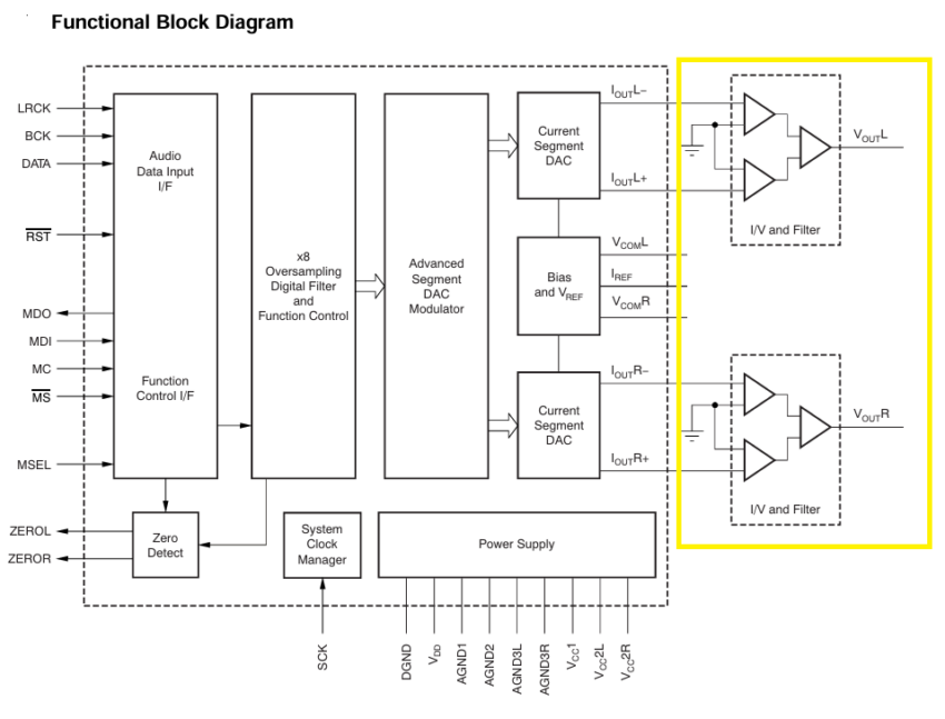

Many high-performance audio digital-to-analog converters (DACs) feature a current output that must be converted into a voltage output for use with audio amplifiers. In premium automotive audio applications, for example, it is critical that the DAC signal-to-noise ratio (SNR) and total harmonic distortion plus noise (THD+N) performance is not compromised by the current-to-voltage (I-V) output stage. The first stage of the circuit converts the current output to a voltage output by providing a virtual ground potential to the OUTP and OUTN nodes of the DAC. The current flowing from the DAC then creates a voltage across the resistor, R4, R18, in the feedback loop. Note that current-output audio DACs have a common mode current that creates an offset to confirm that the DAC is always sourcing current. This common-mode current also results in the output of the first stage always being a negative value. The supplies of the amplifiers of the circuit are not required to be symmetrical. The second stage of the circuit is a differential amplifier that converts the differential voltage of the first stage into a single-ended output voltage. In the third-order, low-pass filter (LPF) circuit, the output level of 2.1 V RMS and 123-dB signal-to noise ratio is achieved. A NE5534 operational amplifier is used for the I/V circuit to obtain the specified performance. Dynamic performance such as the gain bandwidth, settling time, and slew rate of the operational amplifier affects the audio dynamic performance of the I/V section. The current of the PCM1795 device on each of the output pins (IOUTL+, IOUTL–, IOUTR+, IOUTR–) is 4 mA-PP at 0 dB (full-scale).
Circuit Credits: Circuit ideas taken from Texas Instruments PCM1795 IC Datasheet.

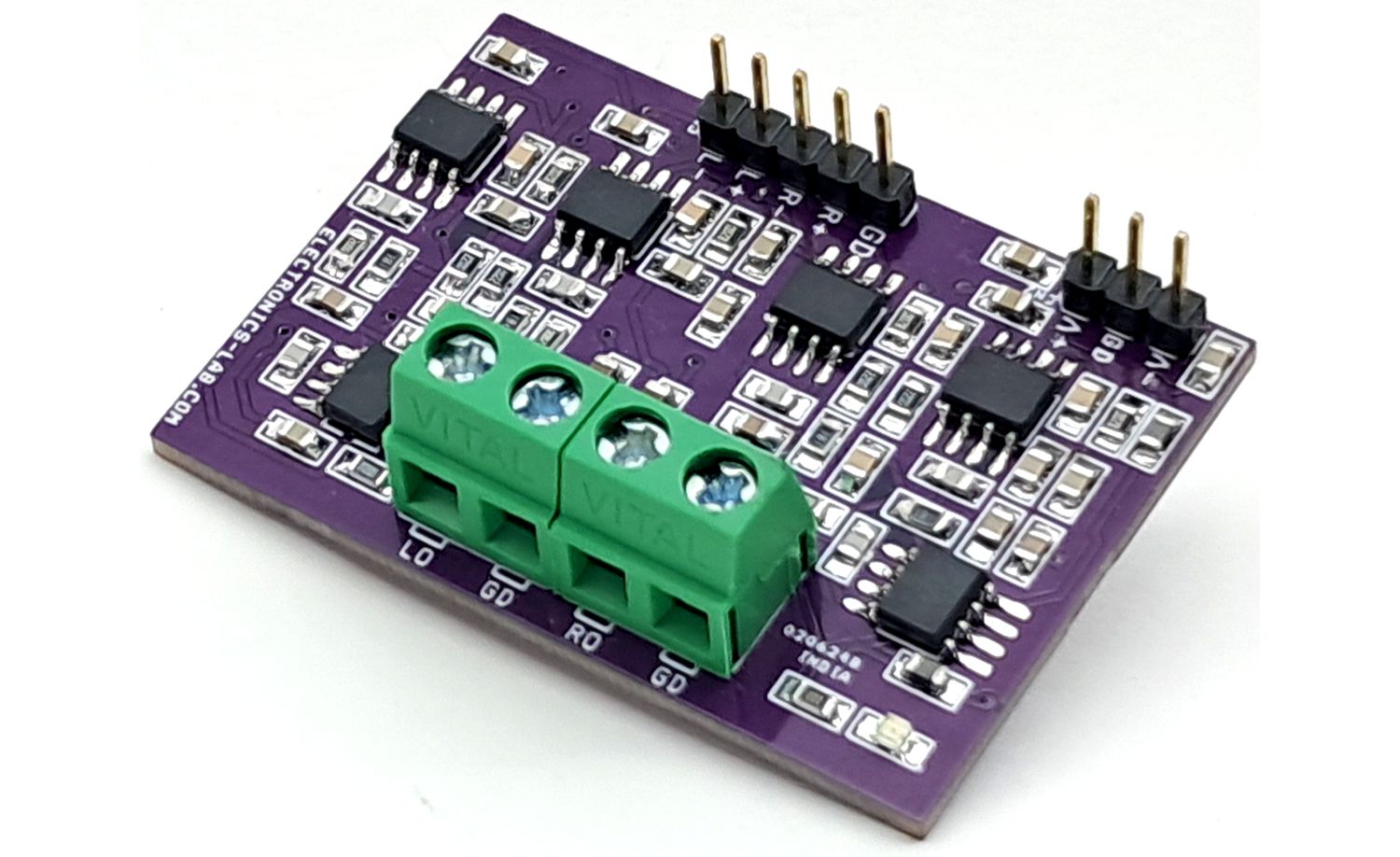

- Power Input +/-15V DC (Dual 15V DC)
- On Board Power LED
- Stereo Output Signal 2.1V RMS
- Header Connector for Input Signals
- Screw Terminals for Audio Output
- PCB Dimensions 46.99 x 33.66 mm

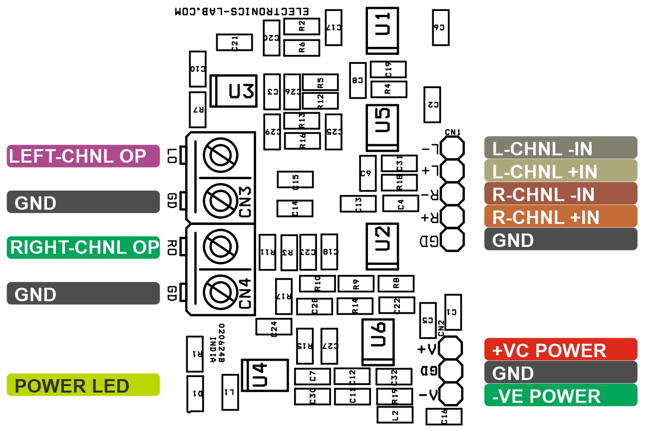

Connections
- CN1 Signal Inputs: Pin 1 = L-Channel -In, Pin 2 = L-Channel +In, Pin 3 = R-Channel -In, Pin 4 = R-Channel +In, Pin 5 = GND
- CN2 Power Input: Pin 1 = +VCC, Pin 2 = GND, Pin 3 = -VEE
- CN3 Signal Output: Pin 1 = Left Channel Output, Pin 2 = GND
- CN4 Signal Output: Pin 1 = Right Channel Output, Pin 2 = GND
- D1: Power LED
Schematic
Parts List
| NO | QNTY | REF. | DESC | MANUFACTURER | SUPPLIER | SUPPLIER PART NO |
| 1 | 1 | CN1 | 5 PIN MALE HEADER PITCH 2.54MM | WURTH | DIGIKEY | 732-5318-ND |
| 2 | 1 | CN2 | 3 PIN MALE HEADER PITCH 2.54MM | WURTH | DIGIKEY | 732-5316-ND |
| 3 | 2 | CN3,CN4 | 2 PIN SCREW TERMINAL PITCH 5.08MM | PHOENIX | DIGIKEY | 277-1247-ND |
| 4 | 14 | C1,C2,C3,C4,C5,C6,C7,C8,C9,C10,C11,C12,C13,C16 | 100nF/25V CERAMIC SMD SIZE 0805 | YAGEO/MURATA | DIGIKEY | |
| 5 | 2 | C14,C15 | 10uF/25V CERAMIC SMD SIZE 0805 | YAGEO/MURATA | DIGIKEY | |
| 6 | 6 | C17,C18,C21,C24,C25,C27 | 22PF/25V CERAMIC SMD SIZE 0805 | YAGEO/MURATA | DIGIKEY | |
| 7 | 4 | C19,C22,C31,C32 | 2.2nF/25V CERAMIC SMD SIZE 0805 | YAGEO/MURATA | DIGIKEY | |
| 8 | 4 | C20,C23,C29,C30 | 8.2nF/25V CERAMIC SMD SIZE 0805 | YAGEO/MURATA | DIGIKEY | |
| 9 | 2 | C26,C28 | 27nF/25V CERAMIC SMD SIZE 0805 | YAGEO/MURATA | DIGIKEY | |
| 11 | 1 | D1 | LED RED SMD SIZE 0805 | OSRAM | DIGIKEY | 475-1278-1-ND |
| 12 | 2 | L1,L2 | FERRITE BEAD 600OHMS SMD SIZE 0805 | LAIRD | DIGIKEY | 240-2390-1-ND |
| 13 | 1 | R1 | 2.2K 5% SMD SIZE 0805 | YAGEO/MURATA | DIGIKEY | |
| 14 | 4 | R2,R3,R16,R17 | 200E 5% SMD SIZE 0805 | YAGEO/MURATA | DIGIKEY | |
| 15 | 4 | R4,R8,R18,R19 | 820E 5% SMD SIZE 0805 | YAGEO/MURATA | DIGIKEY | |
| 16 | 4 | R5,R9,R12,R14 | 220E 5% SMD SIZE 0805 | YAGEO/MURATA | DIGIKEY | |
| 17 | 4 | R6,R10,R13,R15 | 180E 5% SMD SIZE 0805 | YAGEO/MURATA | DIGIKEY | |
| 18 | 2 | R7,R11 | 100E 5% SMD SIZE 0805 | YAGEO/MURATA | DIGIKEY | |
| 19 | 6 | U1,U2,U3,U4,U5,U6 | NE5534 SOICS8 | TI | DIGIKEY | 296-16943-1-ND |

Block Diagram
