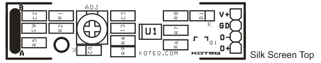

  • Onboard Preset for Level Adjust
  • Operation LED Indicator
  • On Board Power LED
  • Header Connector for Power Supply and LED

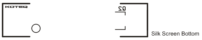

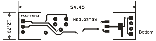

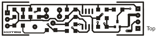

  • PCB dimensions 55.45MM X 12.70 MM
