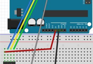

Schematics
The schematics for this project is quite easy. Connect the components as shown below.
Schematics
As mentioned earlier, the B25 voltage sensor is an analog device as such, its output is connected to the analog pin of the Arduino.  To make the schematics easier to follow there is a breakdown of how the devices are connected, pin to pin.
Arduino – Voltage Sensor
GND - GND
A0 - Out
Nokia 5110 – Arduino
Pin 1(RST) – D12
Pin 2(CE) – D11
Pin 3(DC) – D10
Pin 4(DIN) – D9
Pin 5(CLK) – D8
Pin 6(VCC) - VCC
Pin 7(LIGHT) - GND
Pin 8(GND) - GND
