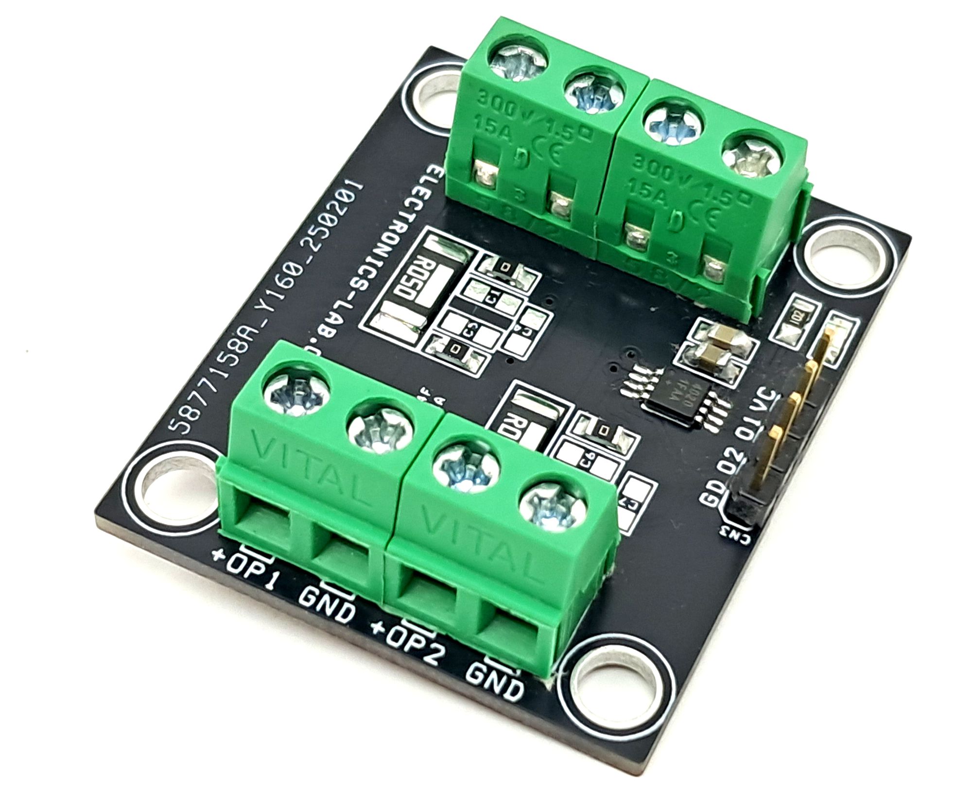

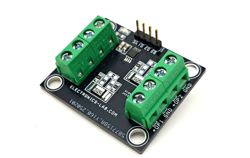

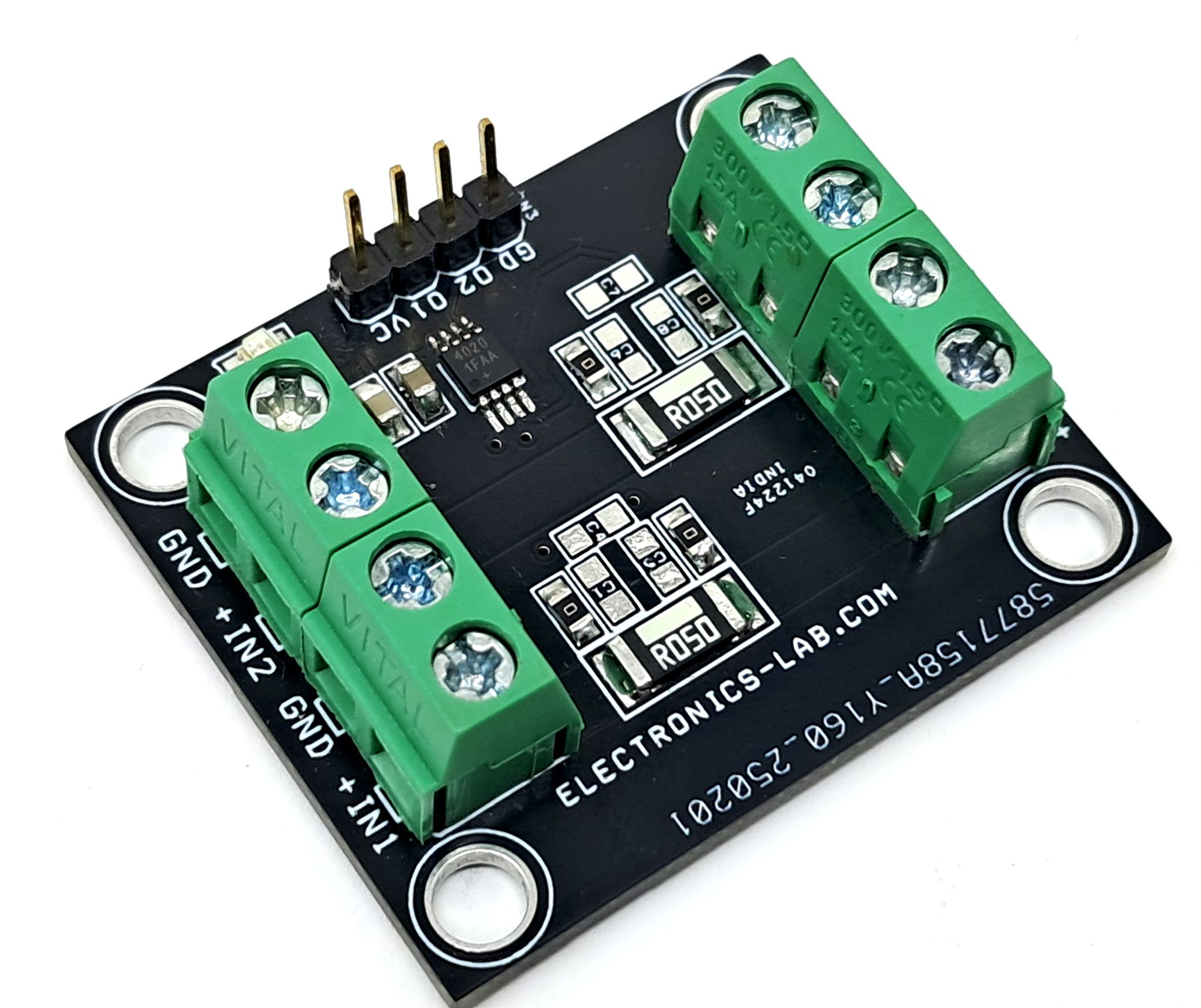

Dual-Channel, 0V to 76V Current-Sense Amplifier
This is a dual-channel current sense amplifier that utilizes the MAX40201F, a high-precision, high-voltage current-sense amplifier. This circuit measures the current flowing through a shunt resistors and provides a voltage output proportional to that current.
The MAX40201F is available in various gain configurations; this project employs the MAX40201F with a gain (G) of 50V/V. With a 0.05 Ohm shunt resistor, the output is 2.5V for a 1A current flow (1A/2.5V). Higher current measurements can be achieved by using a lower-value shunt resistor or by selecting a MAX40201 chip with a lower gain. The input common-mode range is 0V to 76V.

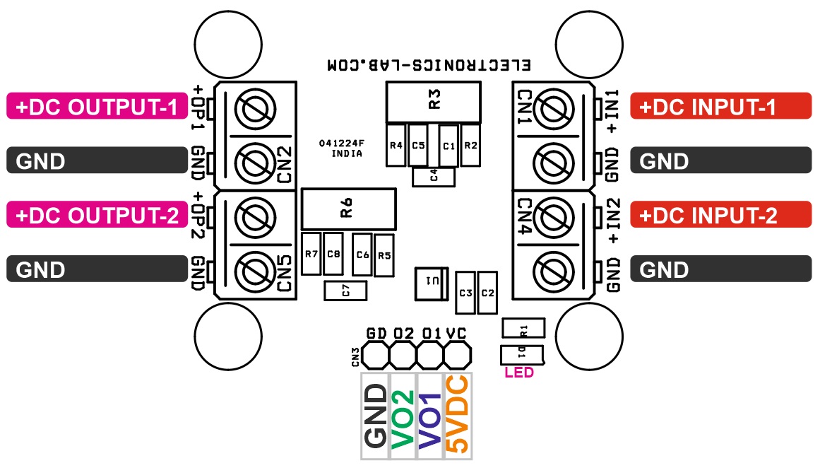

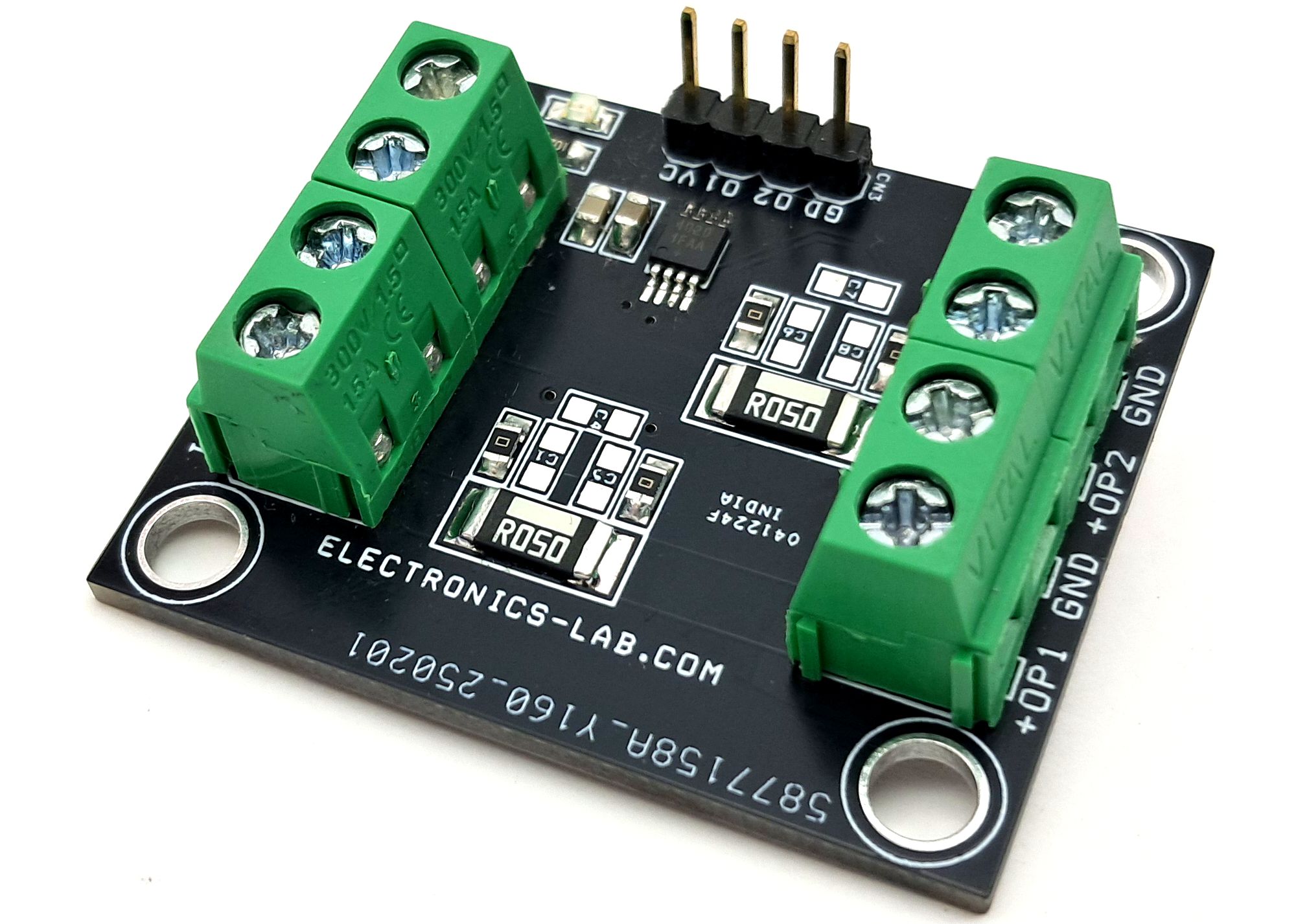

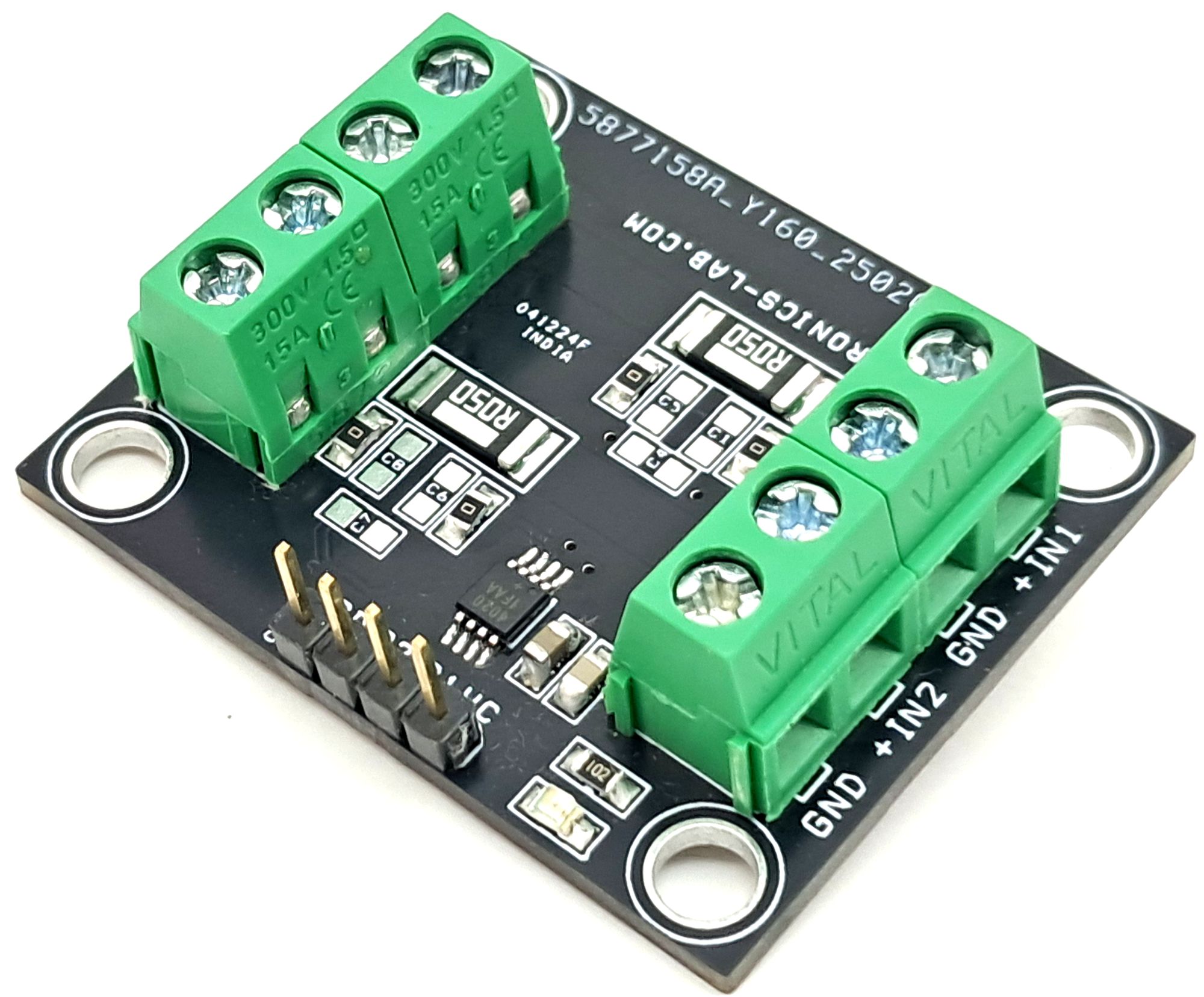

- Screw Terminal Connectors for Inputs and Load Outputs
- Header Connector for Power Supply and Current Monitor Outputs (VO)

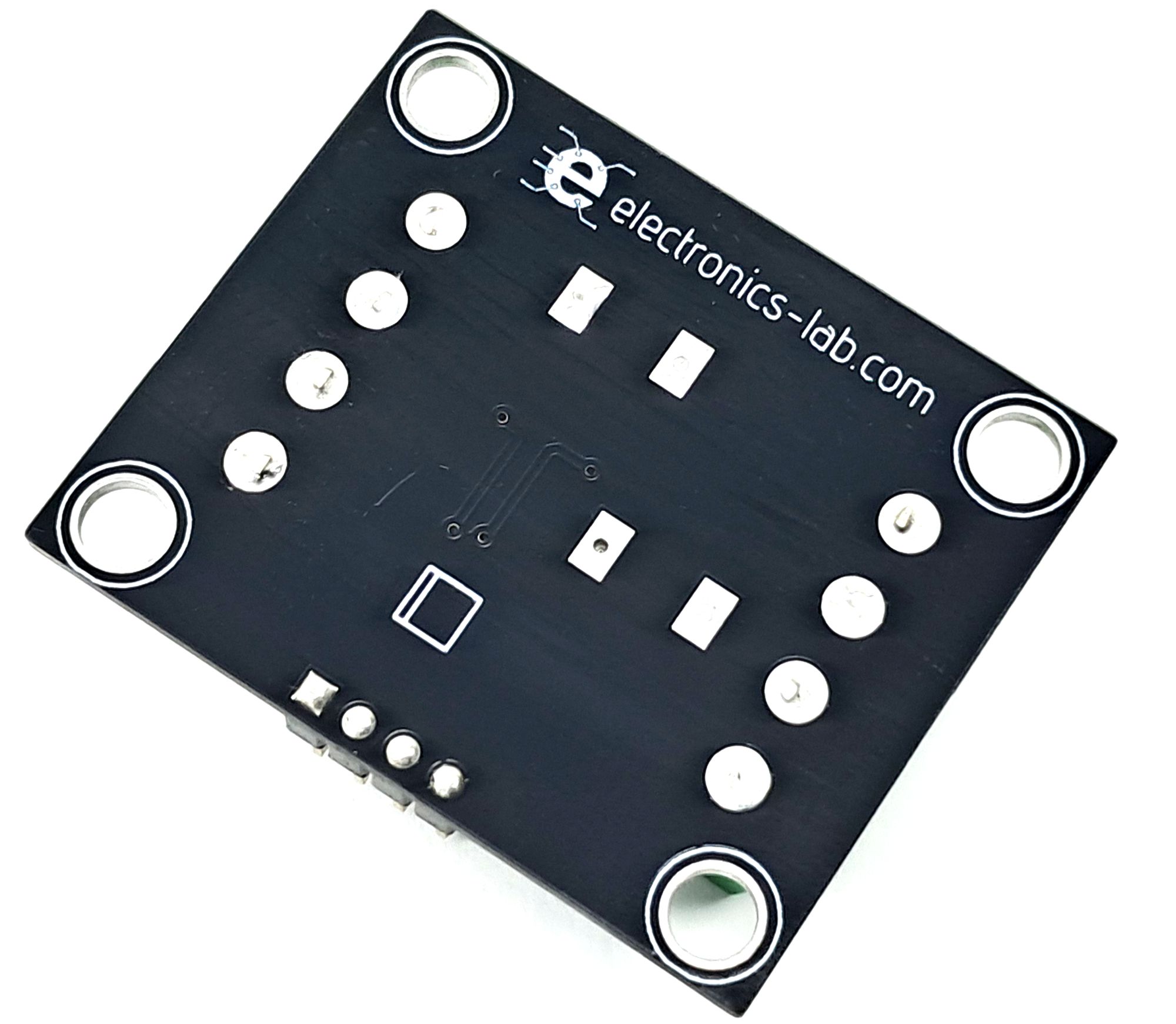

- 4X4MM PCB Mounting Holes
- PCB Dimensions 41.28 x 34.13 mm

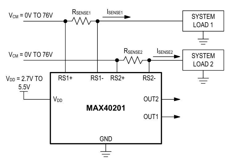

The MAX40201 dual-channel, high-side, current-sense amplifier has VOS of less than 12µV (max) and gain error of less than 0.1% (max). The outputs of the MAX40201 are voltage outputs capable of swinging to a few tens of millivolts of the VDD rail and ground. The MAX40201 features an input common-mode voltage range from 0V to 76V with 80kHz of small-signal bandwidth, which makes it ideal for interfacing with a SAR ADC for multichannel multiplexed data acquisition systems.
Measuring the Load Current
The load current is measured as a voltage drop (VSENSE) across an external sense resistor. This voltage is then amplified by the current-sense amplifier and presented at its VOUT_ pin. Like all differential amplifiers, the output voltage has two components of error (an offset error and a gain error). The offset error affects accuracy at low currents and a gain error affects accuracy at large currents. Both errors affect accuracy at intermediate currents. By minimizing both offset and gain errors, accuracy can be optimized over a wide dynamic range.

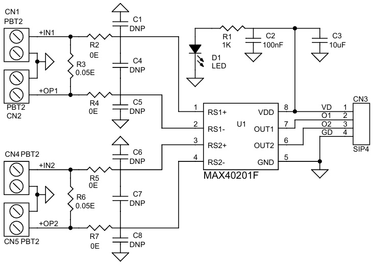

Connections
- CN1: Pin 1 = +Input 1, Pin 2 = GND
- CN2: Pin 1 = +Output 1 (Load), Pin 2 = GND
- CN3: Pin 1 = VDD/5V DC, Pin 2 = Voltage Output 1, Pin 3 = Voltage Output 2, Pin 3 = GND
- CN4: Pin 1 = +Input 2, Pin 2 = GND
- CN5: Pin 1 = +Output 2 (Load), Pin 2 = GND
- D1: Power LED
Schematic
Parts List
| NO. | QNTY. | REF. | DESC. | MANUFACTURER | SUPPLIER | SUPPLIER PART NO |
| 1 | 4 | CN1,CN2,CN4,CN5 | 2 PIN SCREW TERMINAL PITCH 5.08MM | PHOENIX | DIGIKEY | 277-1247-ND |
| 2 | 1 | CN3 | 4 PIN MALE HEADER PITCH 2.54MM | WURTH | DIGIKEY | 732-5317-ND |
| 3 | 6 | C1,C4,C5,C6,C7,C8 | DNP | |||
| 4 | 1 | C2 | 100nF/50V CERAMIC SMD SIZE 0805 | YAGEO/MURATA | DIGIKEY | |
| 5 | 1 | C3 | 10uF/25V CERAMIC SMD SIZE 0805 | YAGEO/MURATA | DIGIKEY | |
| 6 | 1 | D1 | LED RED SMD SIZE 0805 | OSRAM | DIGIKEY | 475-1278-1-ND |
| 7 | 1 | R1 | 1K 5% SMD SIZE 0805 | YAGEO/MURATA | DIGIKEY | |
| 8 | 4 | R2,R4,R5,R7 | 0E SMD SIZE 0805 | YAGEO/MURATA | DIGIKEY | |
| 9 | 2 | R3,R6 | 0.05E/3W 1% SMD SIZE 0805 | BOURNS | DIGIKEY | CRA2512-FZ-R050ELFCT-ND |
| 10 | 1 | U1 | MAX40201F | ANALOG DEVICE | DIGIKEY | MAX40201FAUA+-ND |
