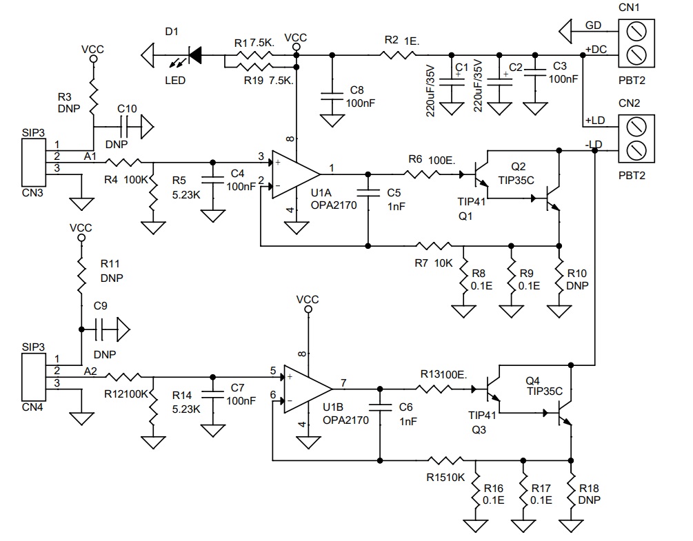

This low-side voltage-to-current (V-I) converter delivers a well-regulated current to a load. The circuit accepts an input voltage from 0V to 3V and converts it to a current from 0A to 6A (combined).
This low-side voltage-to-current (V-I) converter delivers a well-regulated current to a load. The circuit accepts an input voltage from 0V to 3V and converts it to a current from 0A to 6A (combined). The current is accurately regulated by feeding back the voltage drop across a low-side current-sense resistor (R8, R9 + R16, R17) to the OPAMP. Resistor divider (R4 and R5 + R12 and R13) is implemented to limit the maximum voltage at the non-inverting input, Vin, and sense resistor, (R8, R9 + R16, R17), at full-scale. Using a Darlington BJT reduces the output current requirement for the OPAMP. Feedback components R6+R13, R7+R15, and C5+C6 provide compensation to ensure stability. R6+R13 isolates the input capacitance of the bipolar junction transistor (BJT) R7+R15 provides a DC feedback path directly at the current setting resistor (R8, R9 + R16, R17), and C5+C6 provides a high-frequency feedback path that bypass the BJT.

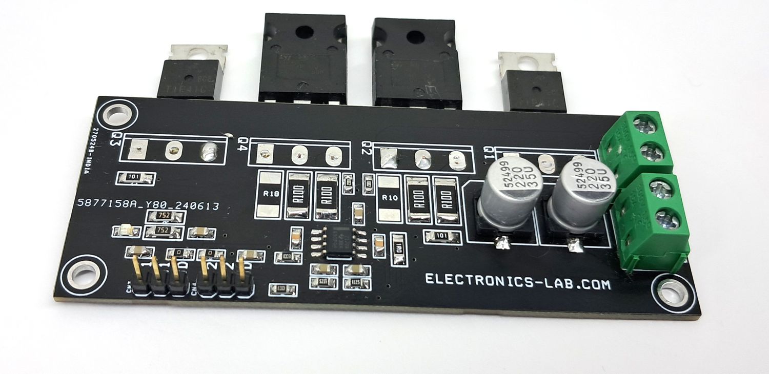

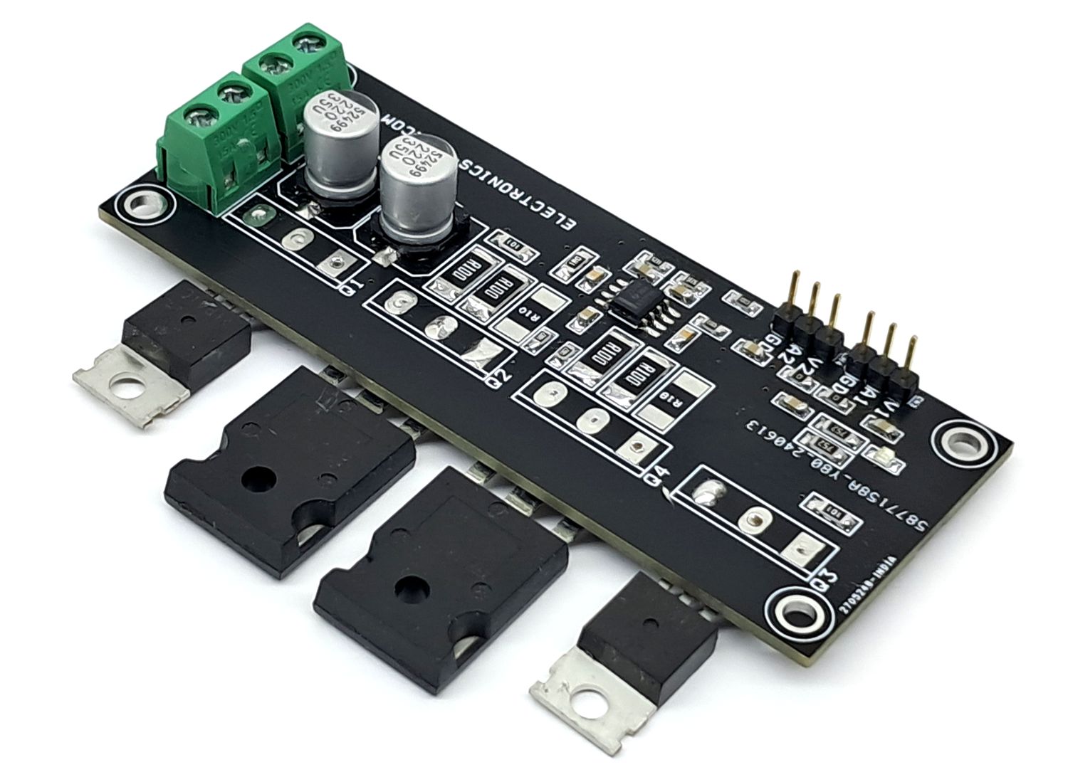

The project is built using the OPA2170 dual OPAMP, which enables the creation of two separate channels. Each channel is capable of handling a current of up to 3A, and when combined, they provide a total current of 6A. Users have the flexibility to utilize only one channel if a lower current is required, in which case the components associated with the second channel can be omitted. To achieve a 6A load, simply tie inputs A1 and A2 together. For a 3A load, only one input is necessary.

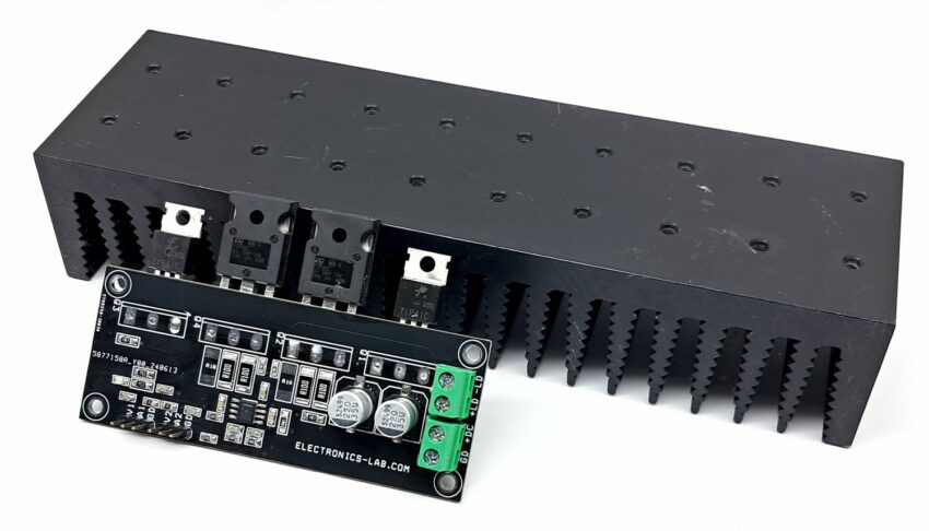

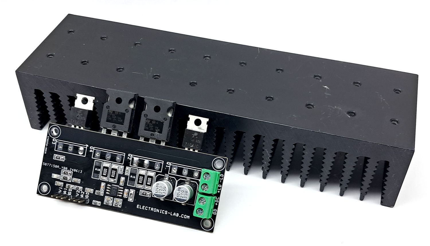

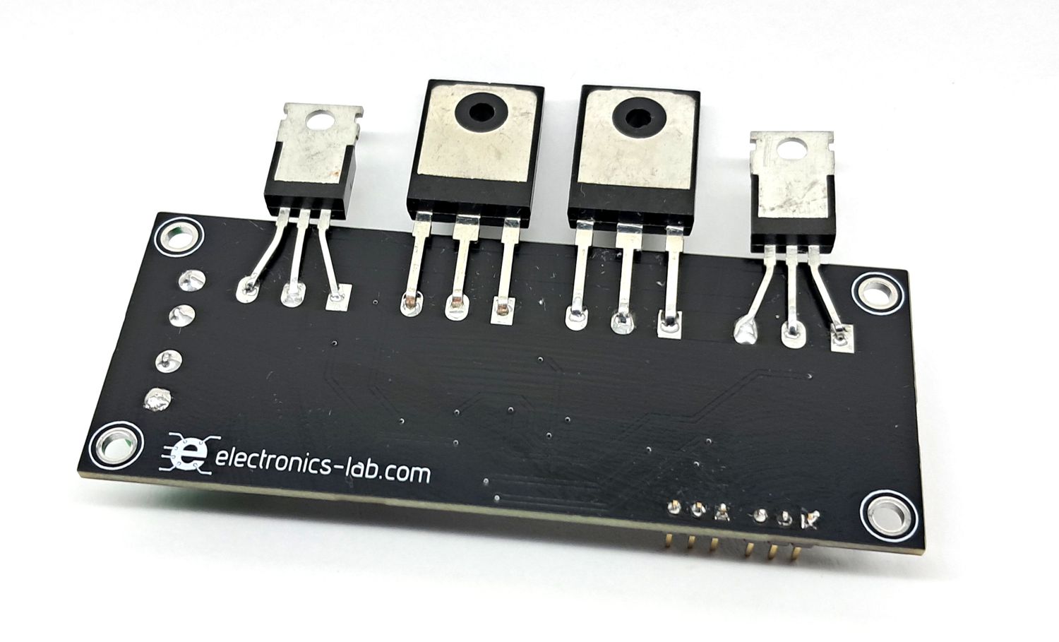

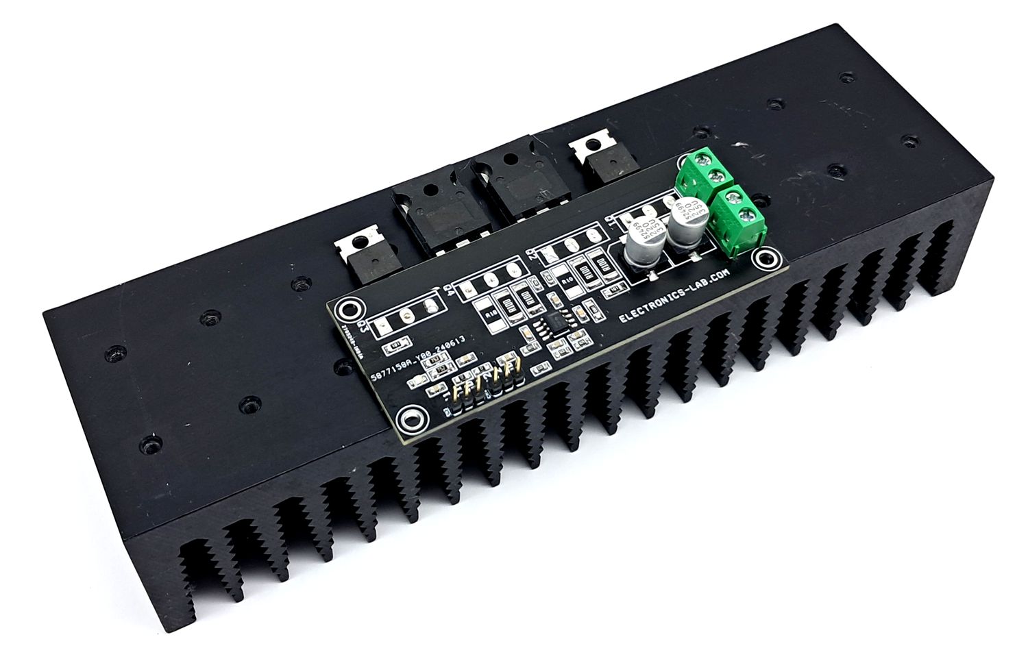

Note: To effectively manage the excessive heat generated by the BJT, it is recommended to utilize a large-sized heat sink. Additionally, it is advisable to employ a fan to facilitate efficient power dissipation. Mount Q2 and Q4 on big heatsink, Q1 and Q3 can be mounted on a small heatsink.

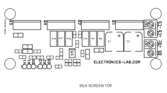

  • 4 x 4 mm Mounting Holes
  • On Board Power LED
  • PCB Dimensions 91.44 x 36.20 mm

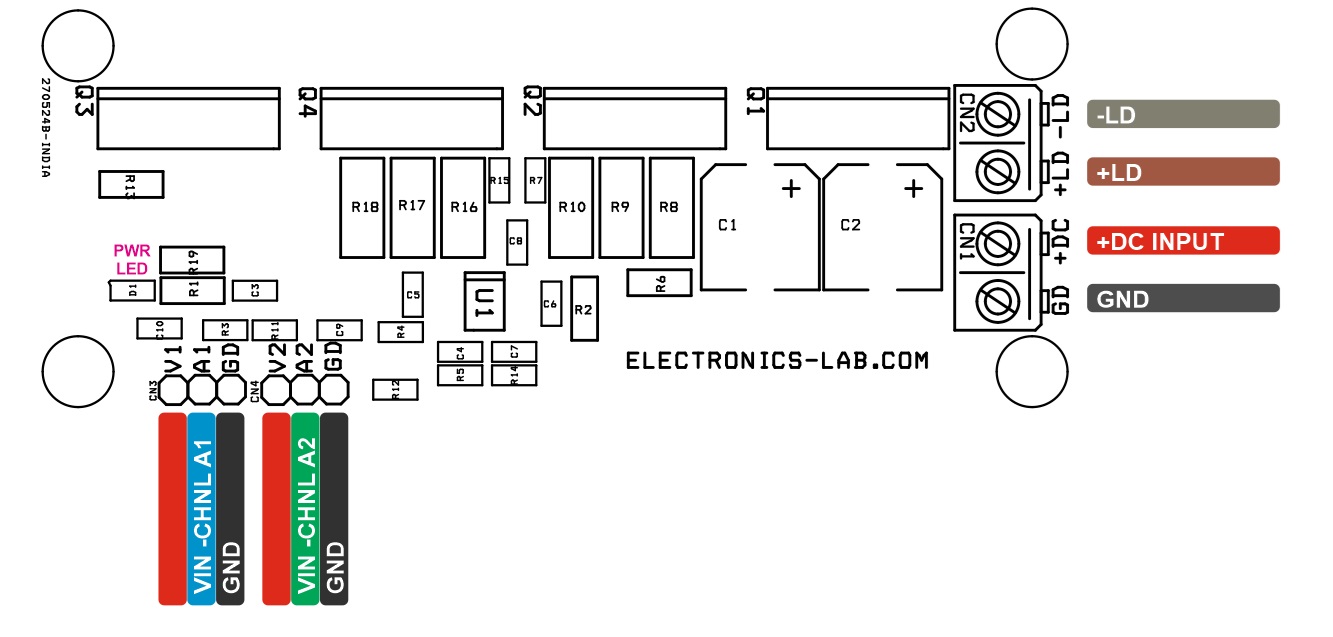

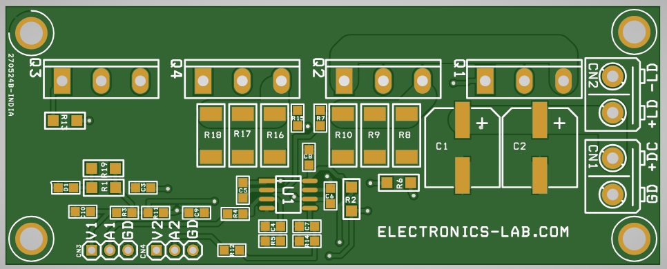

Connections

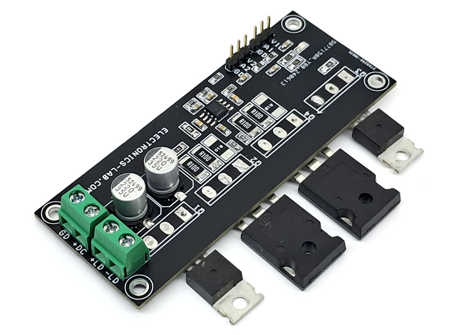

  • CN1: Pin 1 = Power Supply Input 12V TO 30V, Pin 2 = GND
  • CN2: Pin 1 = +Load, Pin 2 = -Load
  • CN3: Pin 1 = No Use, Pin 2 = Analog Voltage in for Channel A1, Pin 3 = GND
  • CN4: Pin 1 = No Use, Pin 2 = Analog Voltage in for Channel A2, Pin 3 = GND
  • D1: Power LED

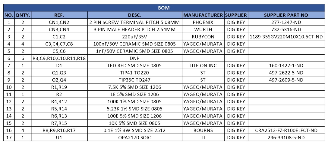

Parts List
NO.QNTY.REF.DESC.MANUFACTURERSUPPLIERSUPPLIER PART NO
12CN1,CN22 PIN SCREW TERMINAL PITCH 5.08MMPHOENIXDIGIKEY277-1247-ND
22CN3,CN43 PIN MALE HEADER PITCH 2.54MMWURTHDIGIKEY732-5316-ND
32C1,C2220uF/35VRUBYCONDIGIKEY1189-35SGV220M10X10.5CT-ND
44C3,C4,C7,C8100nF/50V CERAMIC SMD SIZE 0805YAGEO/MURATADIGIKEY
52C5,C61nF/50V CERAMIC SMD SIZE 0805YAGEO/MURATADIGIKEY
66R3,C9,R10,C10,R11,R18DNP
71D1LED RED SMD SIZE 0805LITE ON INCDIGIKEY160-1427-1-ND
82Q1,Q3TIP41 TO220STDIGIKEY497-2622-5-ND
92Q2,Q4TIP35C TO247STDIGIKEY497-2609-5-ND
102R1,R197.5K 5% SMD SIZE 1206YAGEO/MURATADIGIKEY
111R21E 5% SMD SIZE 1206YAGEO/MURATADIGIKEY
122R4,R12100K 1% SMD SIZE 0805YAGEO/MURATADIGIKEY
132R5,R145.23K 1% SMD SIZE 0805YAGEO/MURATADIGIKEY
142R6,R13100E 5% SMD SIZE 1206YAGEO/MURATADIGIKEY
152R7,R1510K 5% SMD SIZE 0805YAGEO/MURATADIGIKEY
164R8,R9,R16,R170.1E 1% 3W SMD SIZE 2512BOURNSDIGIKEYCRA2512-FZ-R100ELFCT-ND

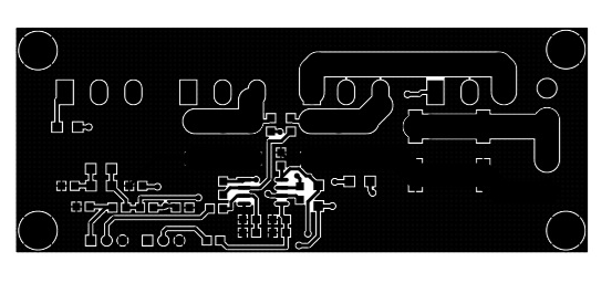

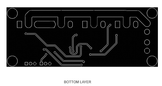

Gerber View

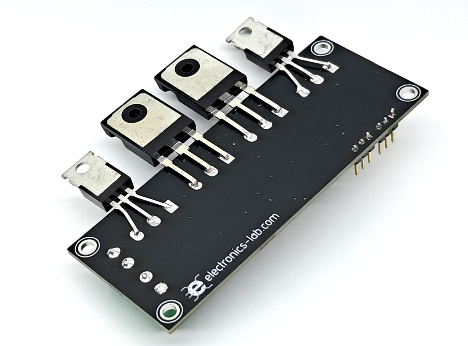

Photos
