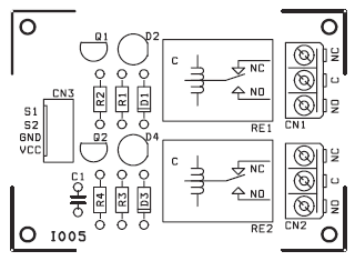

Dual Relay Driver Board
Description Dual Channel Relay Board is a simple and convenient way to interface 2 relays for switching application in your project. Input - 12 VDC @ 84 mA Output - two SPDT relay Relay specification - 5 A @ 230 VAC Trigger level - 2 ~ 5 VDC Berg pins for connecting power and trigger voltage LED on each channel indicates relay status Power Battery Terminal (PBT) for easy relay output connection Four mounting holes of 3.2 mm each PCB dimensions 49 mm x 68 mm Schematic Parts List
Description
  • Input – 12 VDC @ 84 mA
  • Output – two SPDT relay
  • Relay specification – 5 A @ 230 VAC
  • Trigger level – 2 ~ 5 VDC
  • Berg pins for connecting power and trigger voltage
  • LED on each channel indicates relay status
  • Power Battery Terminal (PBT) for easy relay output connection
  • Four mounting holes of 3.2 mm each
  • PCB dimensions 49 mm x 68 mm
Schematic
schematic

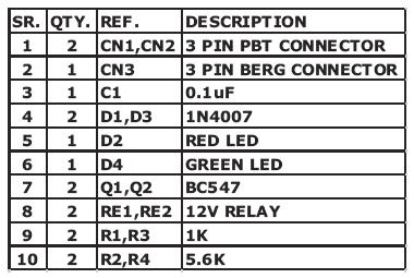

Parts List
parts
