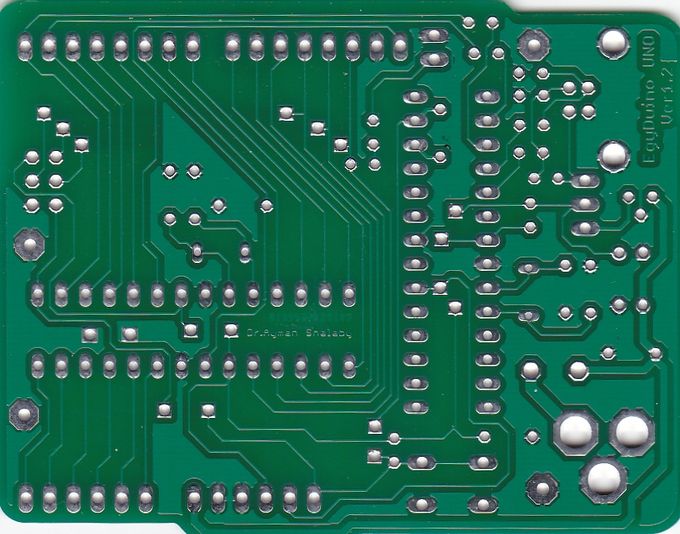

ATmega8 takes care of the USB to serial communication and should be burned with AVR-CDC232 firmware. AVR-CDC creates a virtual COM port on the PC after connecting the device and installing the appropriate driver. The ATmega 8,168 should be programmed with ArduinoNG boatloader. This can be done through another Arduino board (set a ISP programmer) using the Arduino IDE or by using a separate programmer (USB, serial or parallel) like USBasp with suitable software. Also you can use Arduino Duemilanove bootloader for ATmega 168 or 328. The features of this board are:

EGYDuino can be powered via the USB connector, or with a voltage regulator through an external adapter.

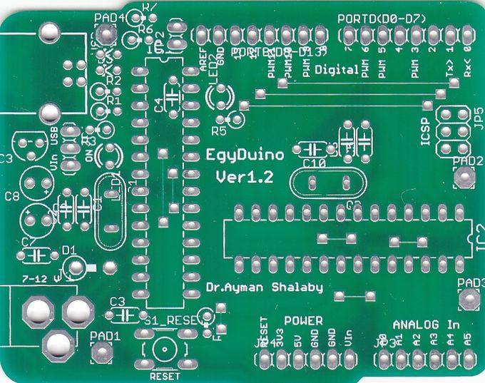

how to install components like 3.6 zener and 68 ohm in this small area? standing?

1- yes you must install the components standing it preserve space with no conflicts.

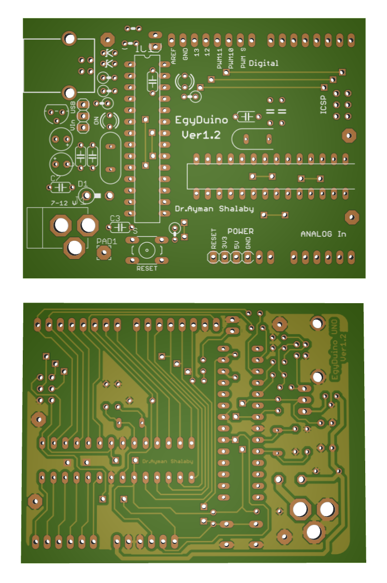

your pdf files for pcb need to be mirrored
You can mirror them as you wish , Regrads
my pc doesen”t recognize the board, I use WIn10
i didn”t have 68ohm resistor so I put 100 ohm, is this the problem?
Please double check parts placement and polarity. I think it will work with 100ohm also.
You must use 47-68 Ohm resistors , better 68 ohm .
also check zinner diodes ,bootloader and crystal .
