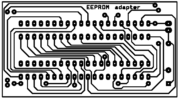

EPROM adapter for ATMEL 89 Series Flash Microcontroller
Devices The EEprom programmer software supports the following devices. 28C16 28C256 28C17 29C256 28C64 Hardware Diode D1 and resistor R1 provide the VDD isolation when programming the 24 pin devices.
sch

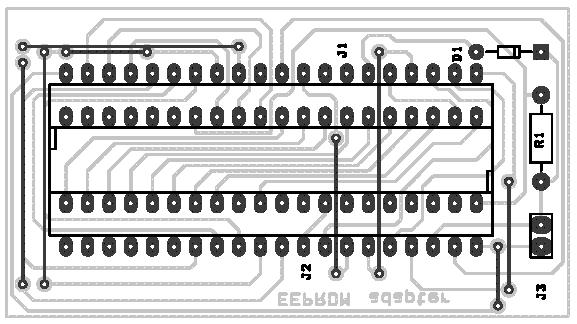

Diode D1 and resistor R1 provide the VDD isolation when programming the 24 pin devices. The jumper J3 must be shorted for 24 pin devices, and open circuit for 28 pin device programming. Following EEPROMs are pin compatible with their EPROMs version,
28C16 —> 2716
28C64 —> 2764
29C256 —> 27256

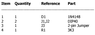

Parts
parts
