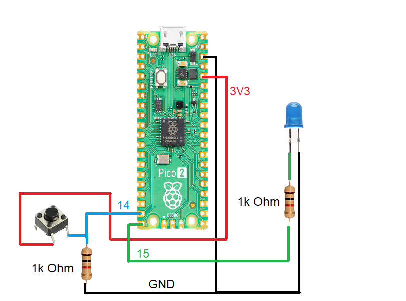

For this tutorial, we will need one push button (those 6×6 mm ones), two 1k Ohm resistors, and one LED (any color). Of course, there will be a need for a Raspberry Pi Pico 2 or Pi Pico original or ESP32. A complete schematic diagram is shown below.
button and LED with raspberry Pi Pico 2
The Pi Pico 2 has internal pull-ups and pull-downs, but I decided to use my own externally at this time. Since this is a pull-down, I could have used a 10k or even 47k Ohm resistor. But I decided to use a 1k Ohm one match with the LED resistor, to reduce component variety.

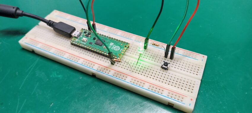

Pins 14 and 15 are general-purpose IO (GPIO), so I randomly picked them to serve as a button and LED, respectively. Could have picked virtually any Pi Pico 2 pin for this task. I took a photo of the setup on my bench, see below.
led and button on a breadboard

Now click the green arrow at the top of the screen (“Run current script (F5)”). Press the push button at the breadboard and observe the LED; it will start blinking. Another press will make the LED stop blinking.
There is also the Pi Pico 2 onboard LED on pin 25, blinking independently. It will neither interfere with nor be interfered with by the interrupts running. I made a video illustrating the assembly. enjoy.
