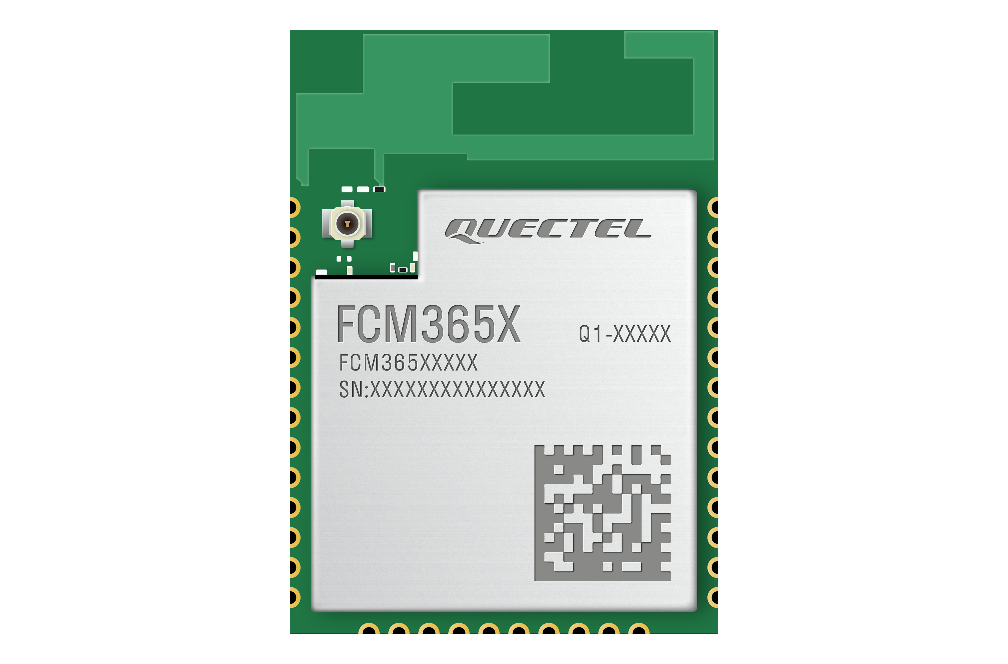

Quectel FCM365X tri-radio WiFi 6, Bluetooth LE 5.4, and IEEE 802.15.4 module based on the NXP RW612 wireless MCU.
Quectel also lists several hardware variants, including models with optional PSRAM, PCB antenna, or IPEX connector, as well as development boards such as the FCM365XABTB-0P-08.
