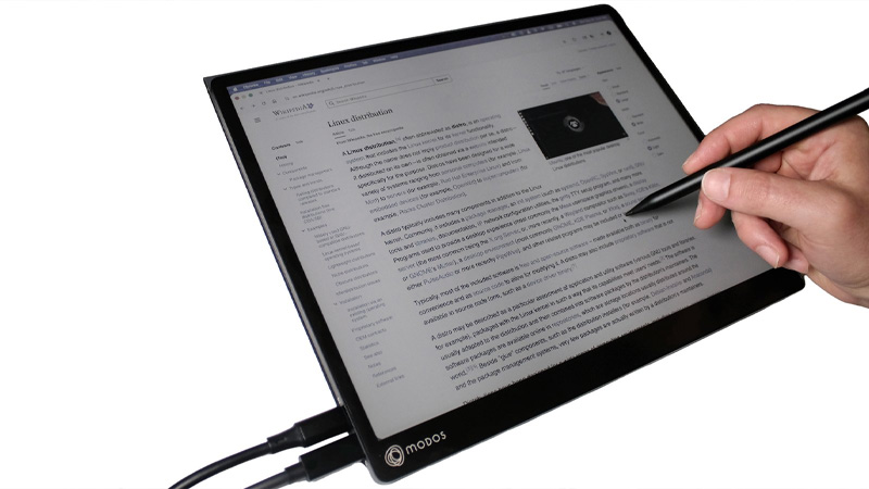

Modos Flow, an open-hardware, 13.3-inch e-paper monitor, supports a stylus on the color model

  • Interactivity: Touchscreen support; Stylus support available on the color model

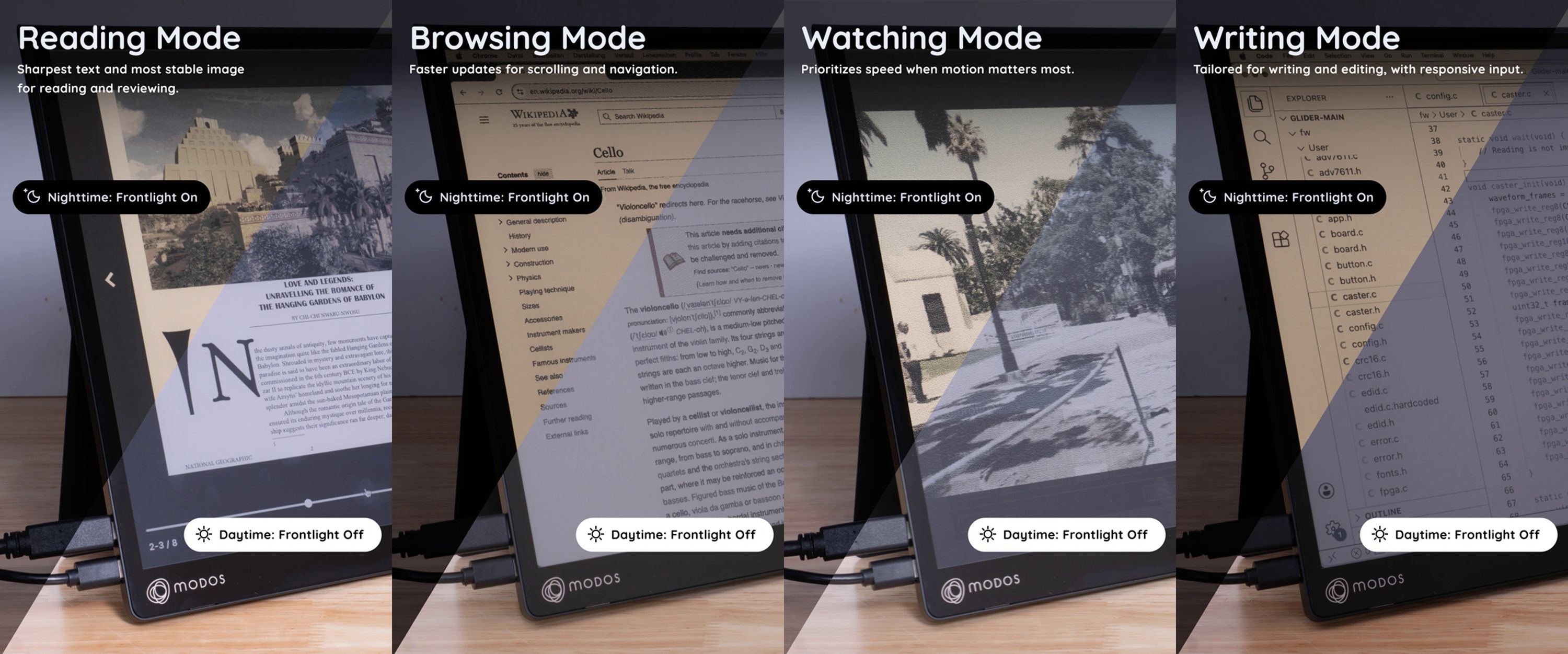

Four display modes optimize Modos Flow for reading, writing, browsing, and video.
It also includes dedicated hardware buttons for switching between four display modes: Reading, Browsing, Watching, and Writing. Each mode adjusts the display refresh behavior to prioritize image quality, responsiveness, or typing latency. Users can also switch modes programmatically through the Modos Flow API or assign keyboard shortcuts for faster access.
