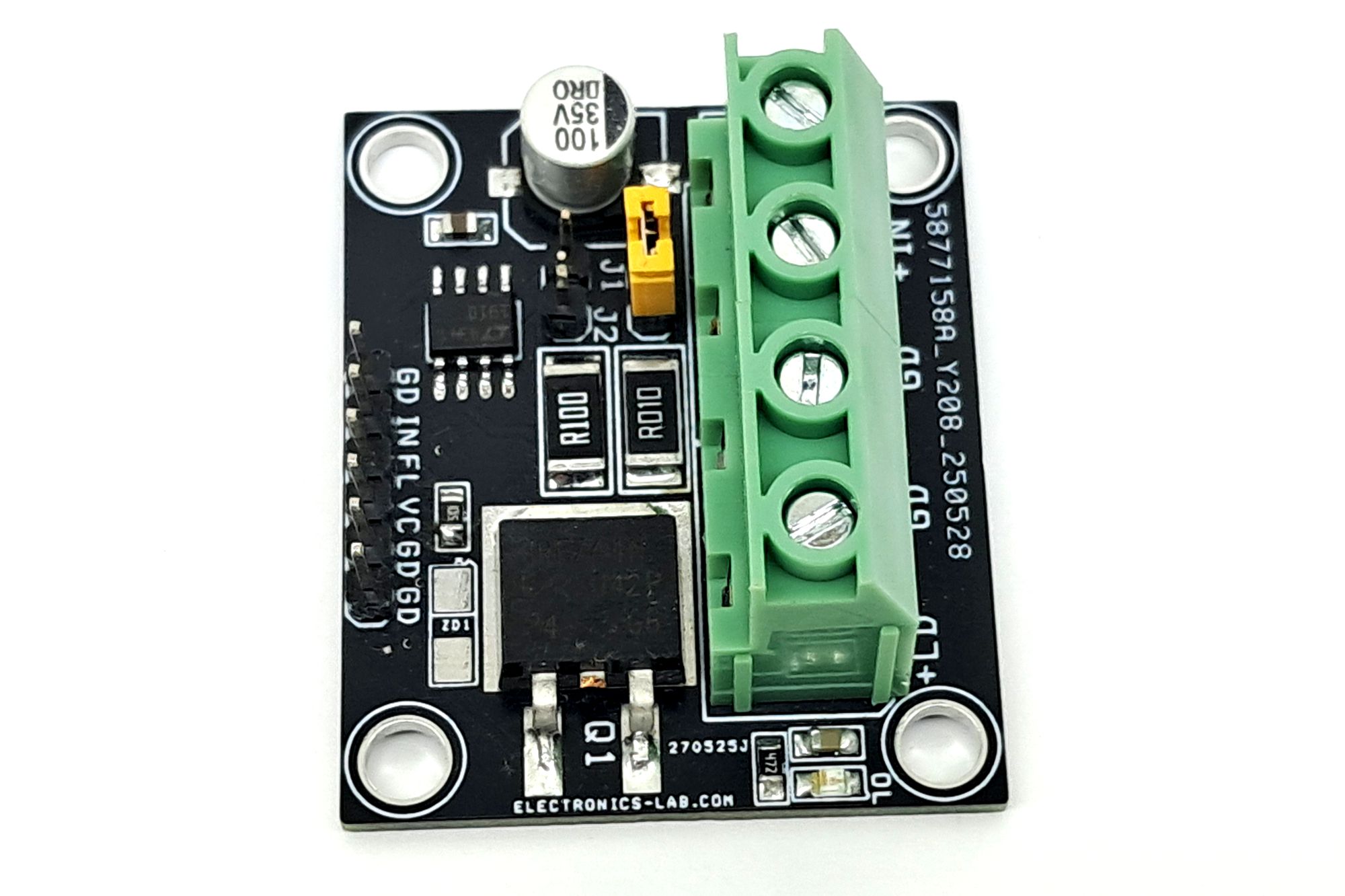

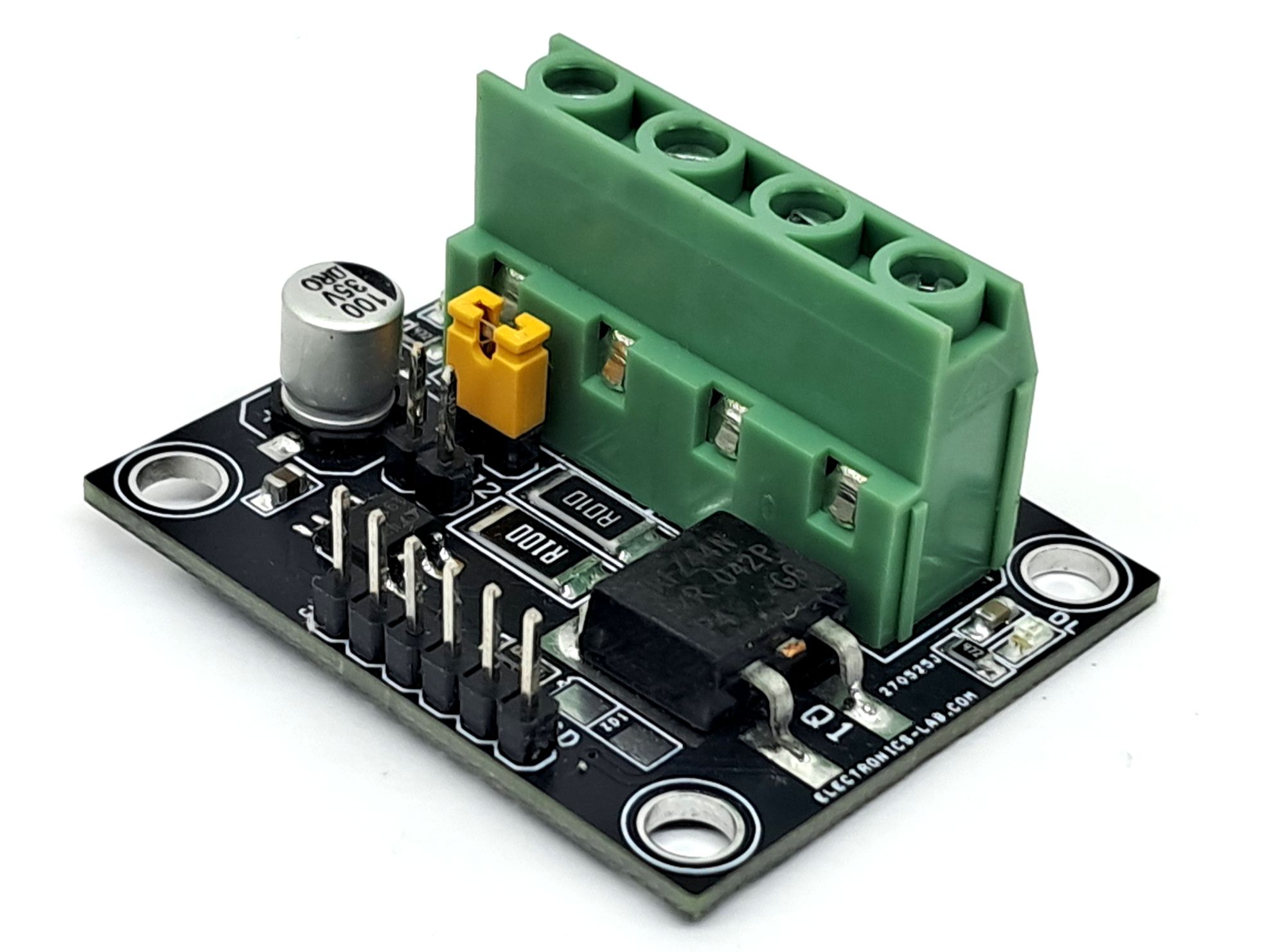

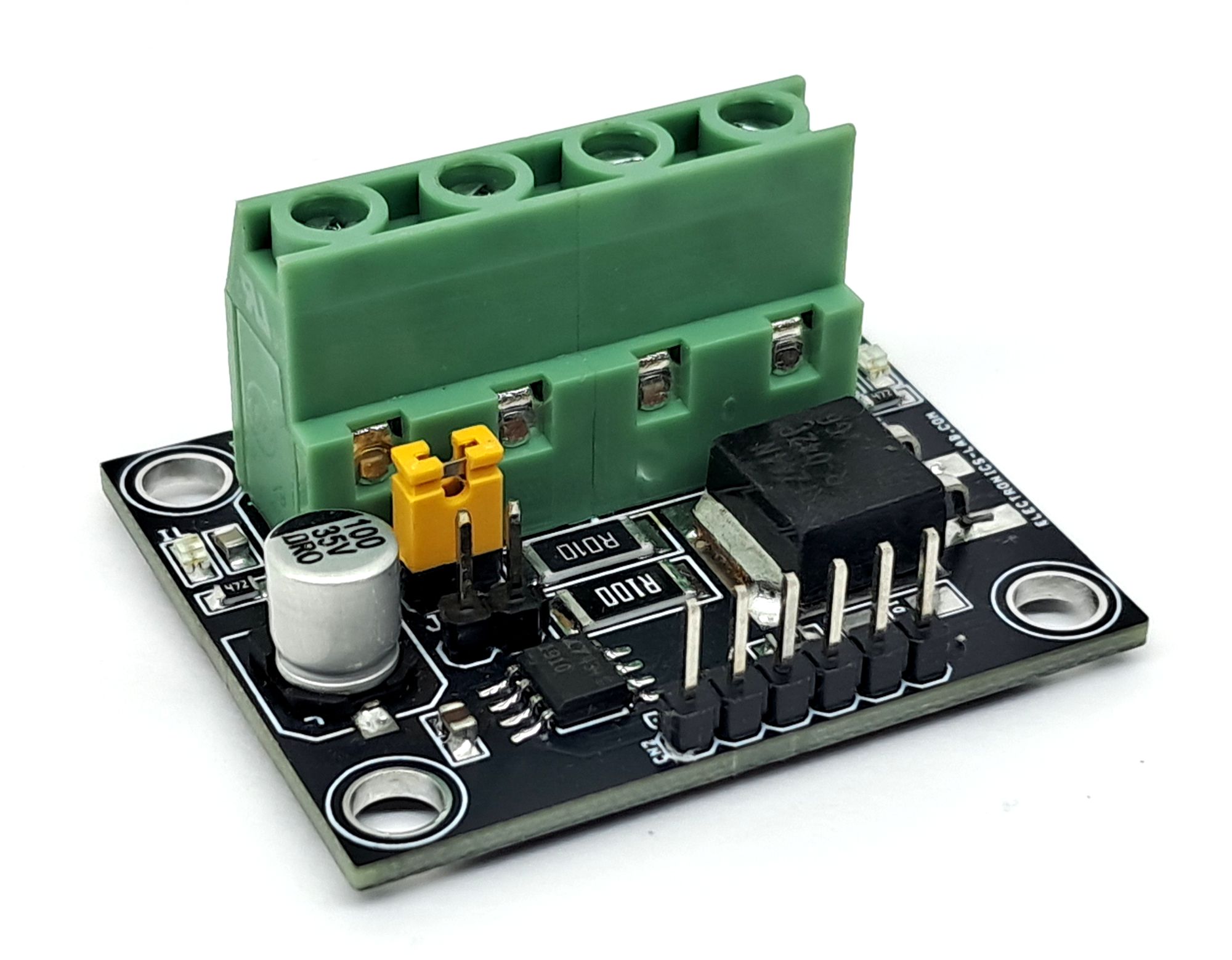

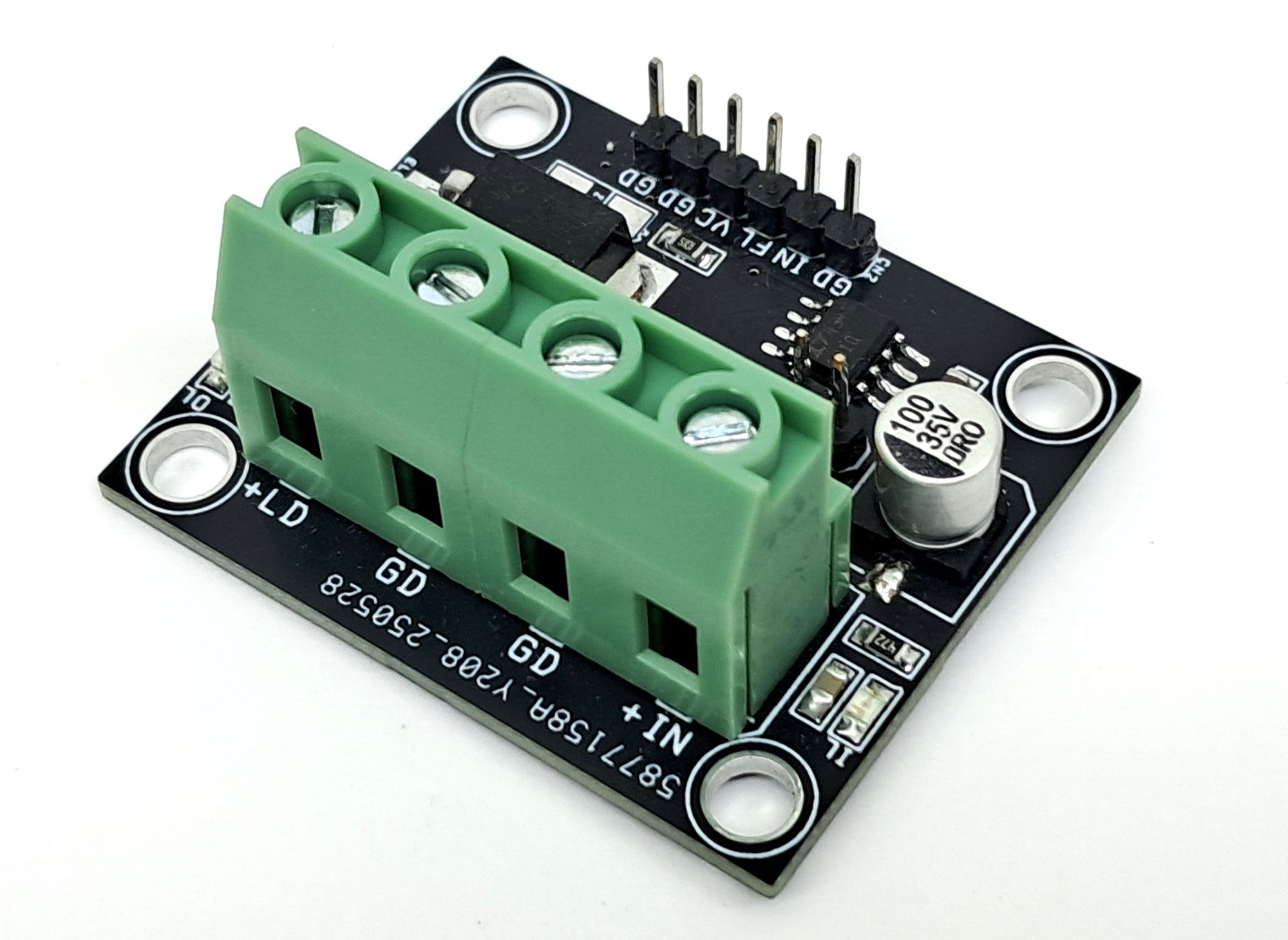

Fault Protected High Side Switch
This project uses the LT1910 high-side switch to protect a load from over-current. It automatically shuts off, flags the fault, waits 150 ms, and attempts to restart. The current trip point is set via selectable shunt resistors.
This project is designed to protect the load from over-current conditions using the LT1910 fault-protected high-side switch controller. When the internal drain comparator detects that the switch current exceeds the preset threshold, the LT1910 immediately turns off the switch and asserts a fault flag.
The switch remains off for approximately 150 ms, as determined by the external timing capacitor C3, and then automatically attempts to restart. If the fault condition persists, the protection cycle repeats until the fault is cleared, thereby safeguarding the MOSFET and the load. Once the switch restarts successfully, the fault flag is reset.
The LT1910 features a 50-mV trip point for current sensing, which determines the value of the shunt resistor. The board includes two selectable shunt resistor options — 0.01 Ω and 0.1 Ω — which can be configured using jumpers J1 and J2. A third option allows both shunt resistors to be used in parallel (by closing both jumpers J1 and J2), providing additional flexibility in setting the desired trip point.

Connections
- CN1: Pin 1 = +Load Power Input 24V DC, Pin 2 = GND
- CN2: Pin 1 = GND, Pin 2 = Trigger Input 5V, Pin 3 = Fault Output Normally High, Pin 4 = VCC 5V DC, Pin 5 GND, Pin 6 = GND
- CN3: Pin 1 = +Load, Pin 2 = GND
- J1: Jumper for Low Current Range
- J2: Jumper for High Current Range
- D1: Input Power LED
- D2: Output LED
