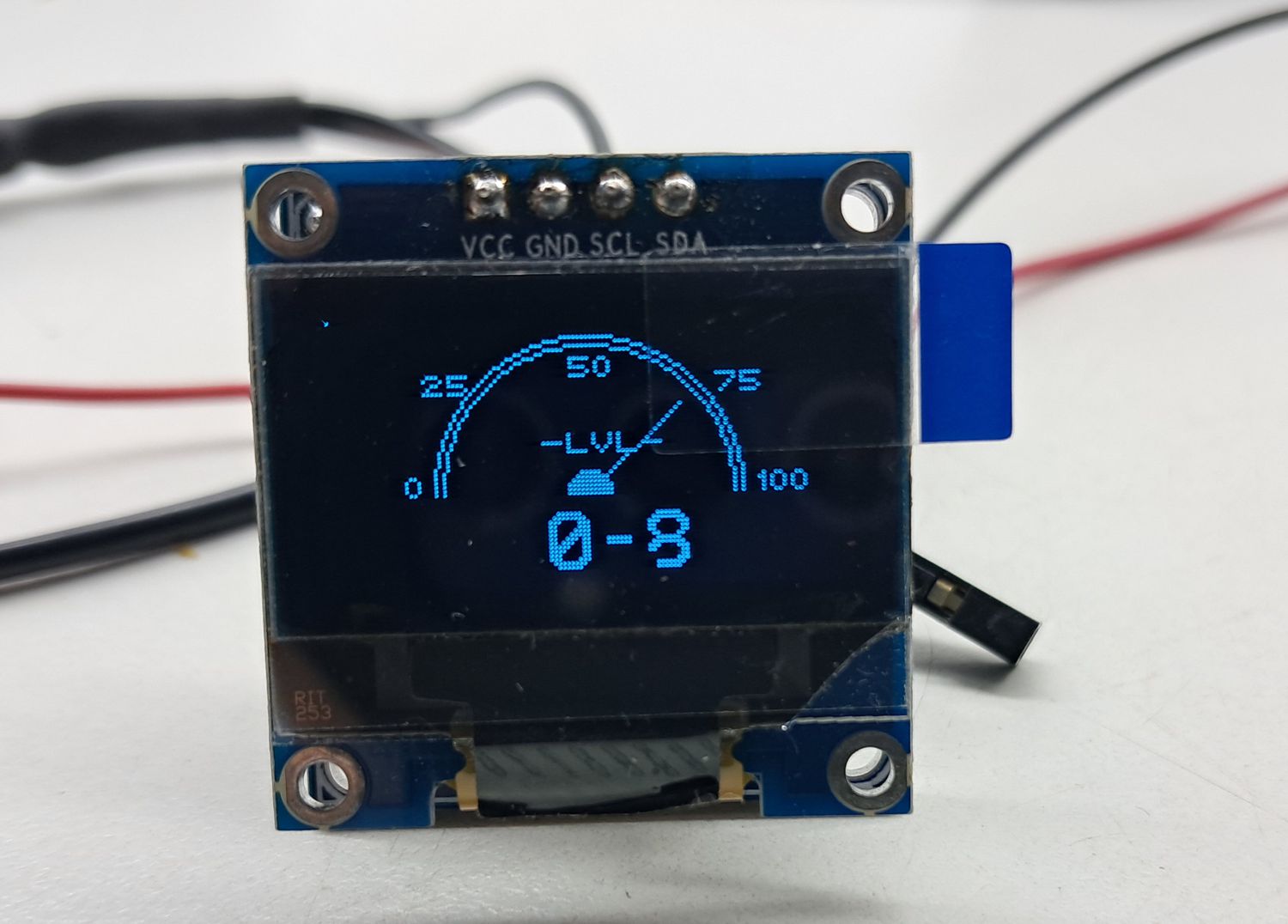

This project enables the measurement of fuel levels in a tank using a resistive float sensor. The fuel level is measured and displayed on an OLED display.
Automotive by mixos

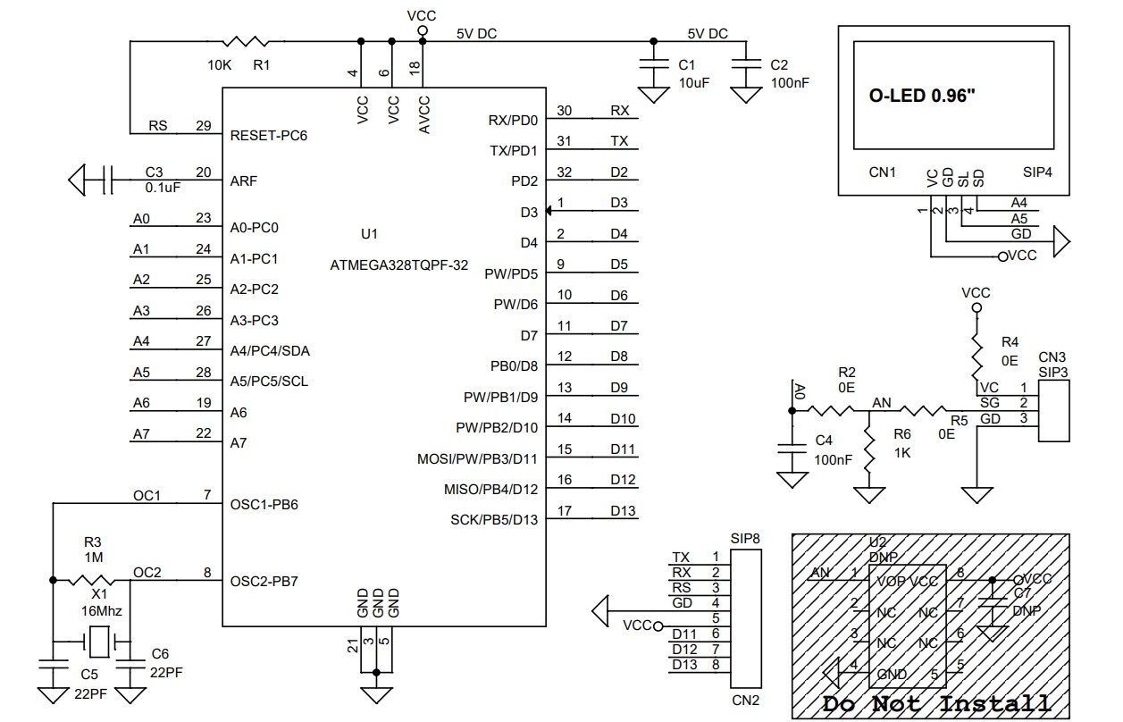

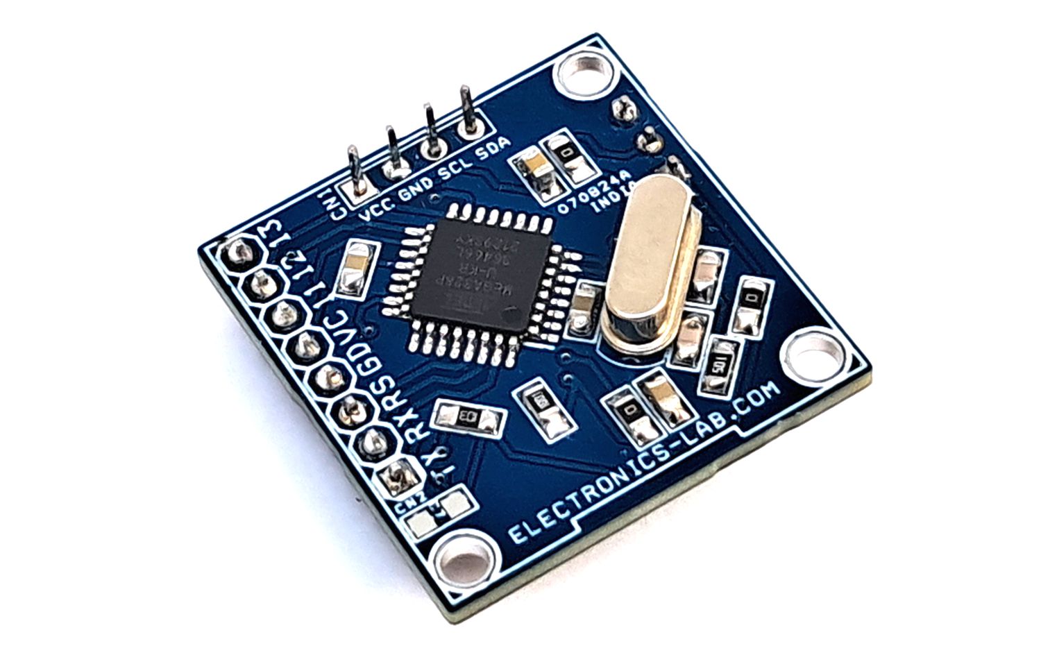

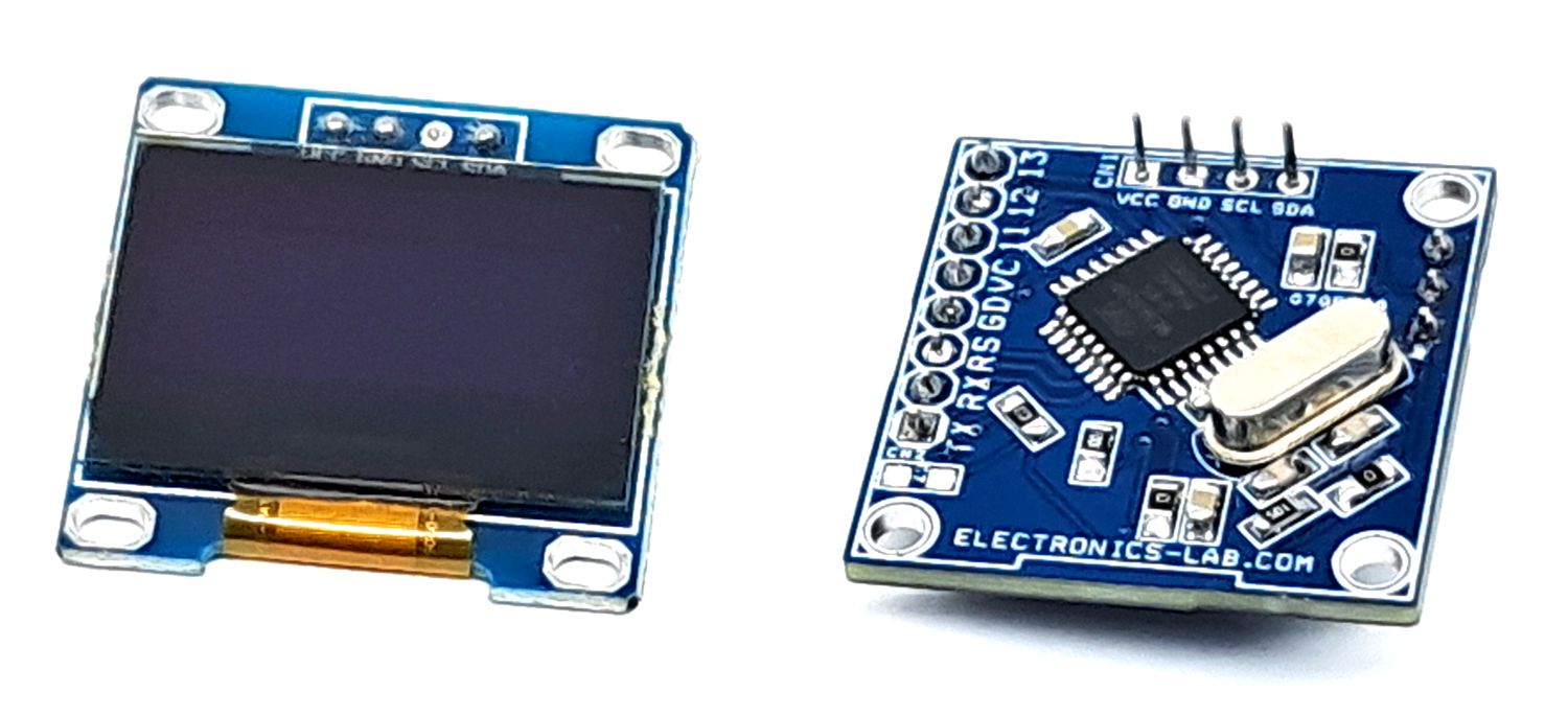

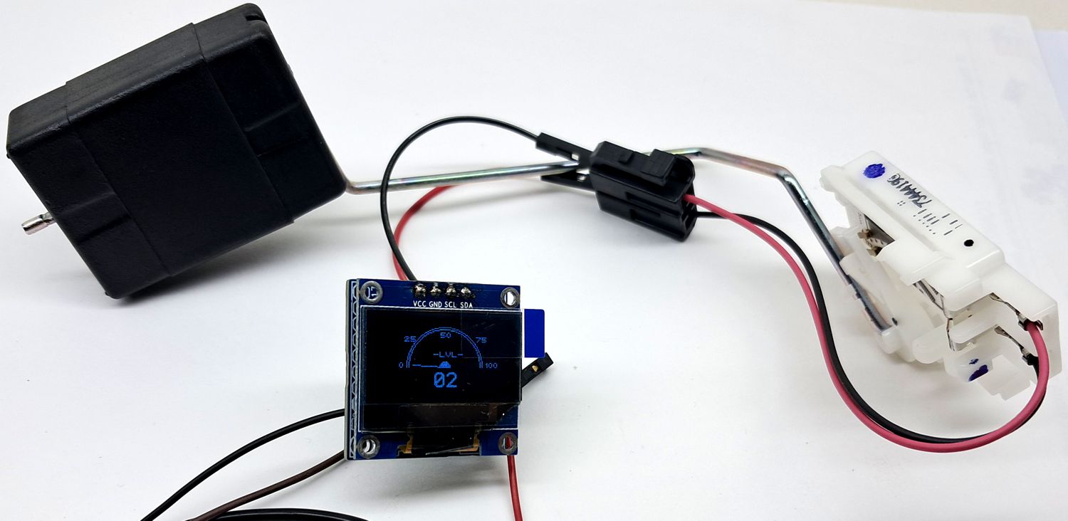

This project enables the measurement of fuel levels in a tank using a resistive float sensor. The fuel level is measured and displayed on an OLED display. The project is compatible with Arduino and features an ATMEGA328 microcontroller. The resistive sensor, connected to a divider resistor, is linked to Analog pin A0 of the Arduino chip. The OLED display is connected to the I2C pins of the microcontroller. Overall, the OLED display with needle-type visualization and 0 to 100% fuel capacity range provides a clear, accurate, and easy-to-read indication of the fuel level, making it an essential feature in modern vehicles.

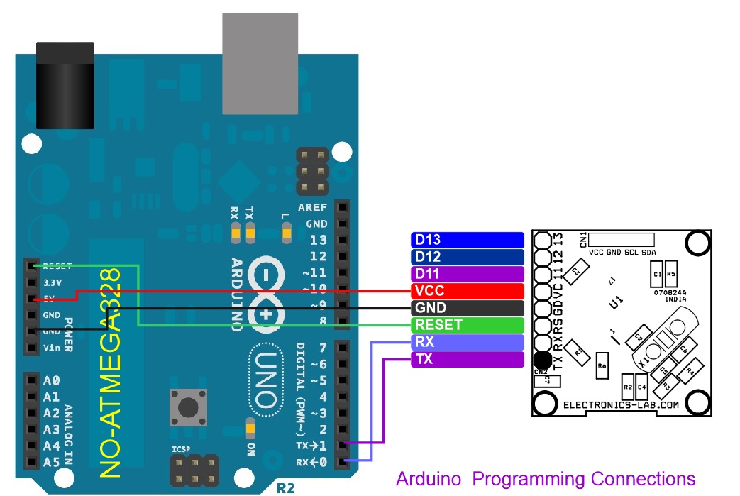

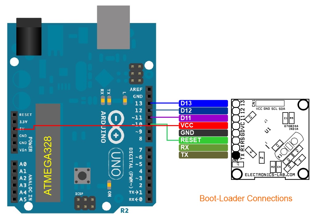

The Arduino code for testing the project is available in downloads. To utilize the code, load the bootloader and upload the code to a new ATMEGA328 microcontroller using the onboard programming connector. Please refer to the connection diagram for guidance.
Bootloader:  https://docs.arduino.cc/retired/hacking/software/Bootloader/
Arduino Bootloader and Arduino Programming: https://docs.arduino.cc/built-in-examples/arduino-isp/ArduinoToBreadboard/

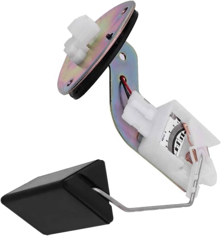

Sensor

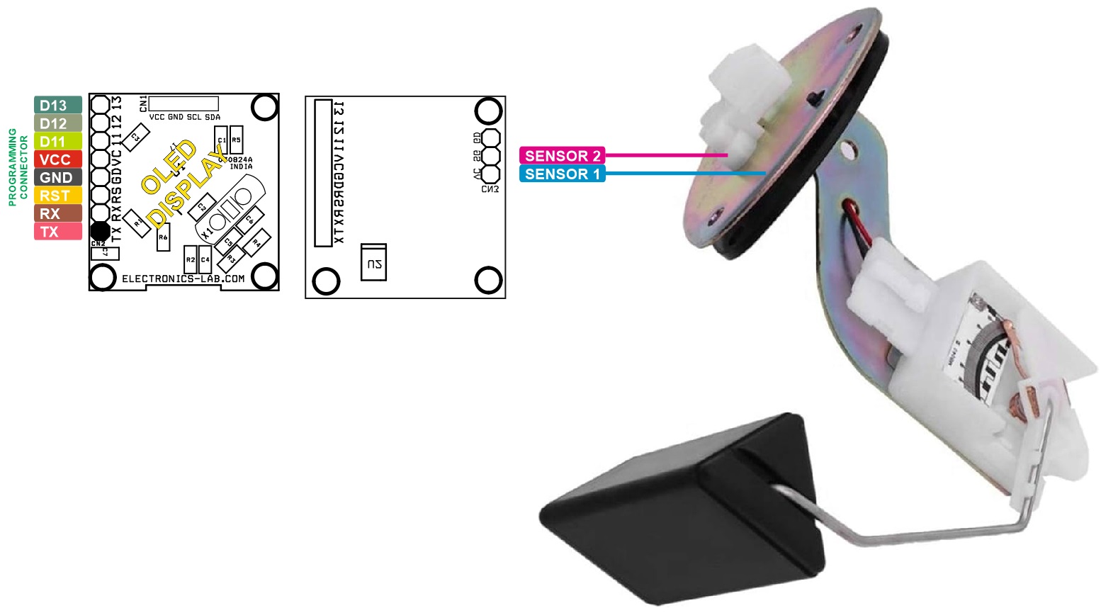

The resistive sensor is employed to measure the fuel level, and when paired with a 1K divider resistor, it produces an analog value ranging from 795 to 980. This analog signal is then connected to the Analog-to-Digital Converter (ADC) pin A0 of the Arduino chip. The Arduino chip evaluates the input signal and subsequently displays the fuel level on the OLED display.
Note: Different sensors may produce varying output values. To ensure accurate readings, it is recommended to map the correct value in the Arduino code according to the specific sensor’s output. This calibration step is crucial to obtain reliable fuel level measurements.
resistive fuel level sensor

  • On Board Connector for Bootloader and Arduino Programming

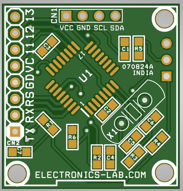

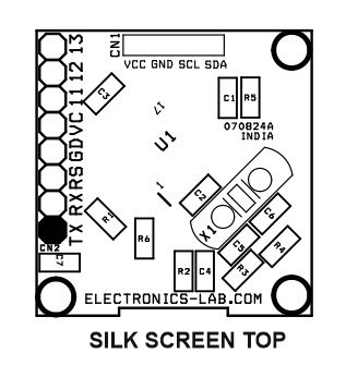

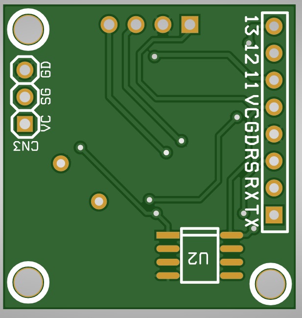

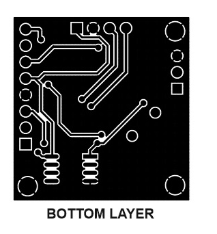

  • PCB Dimensions 27.62 x 28.73mm
Arduino Pins
  • Sensor Input Analog-0 Arduino
  • Arduino A4= SDA – OLED Display
  • Arduino A5 = SCL – OLED Display

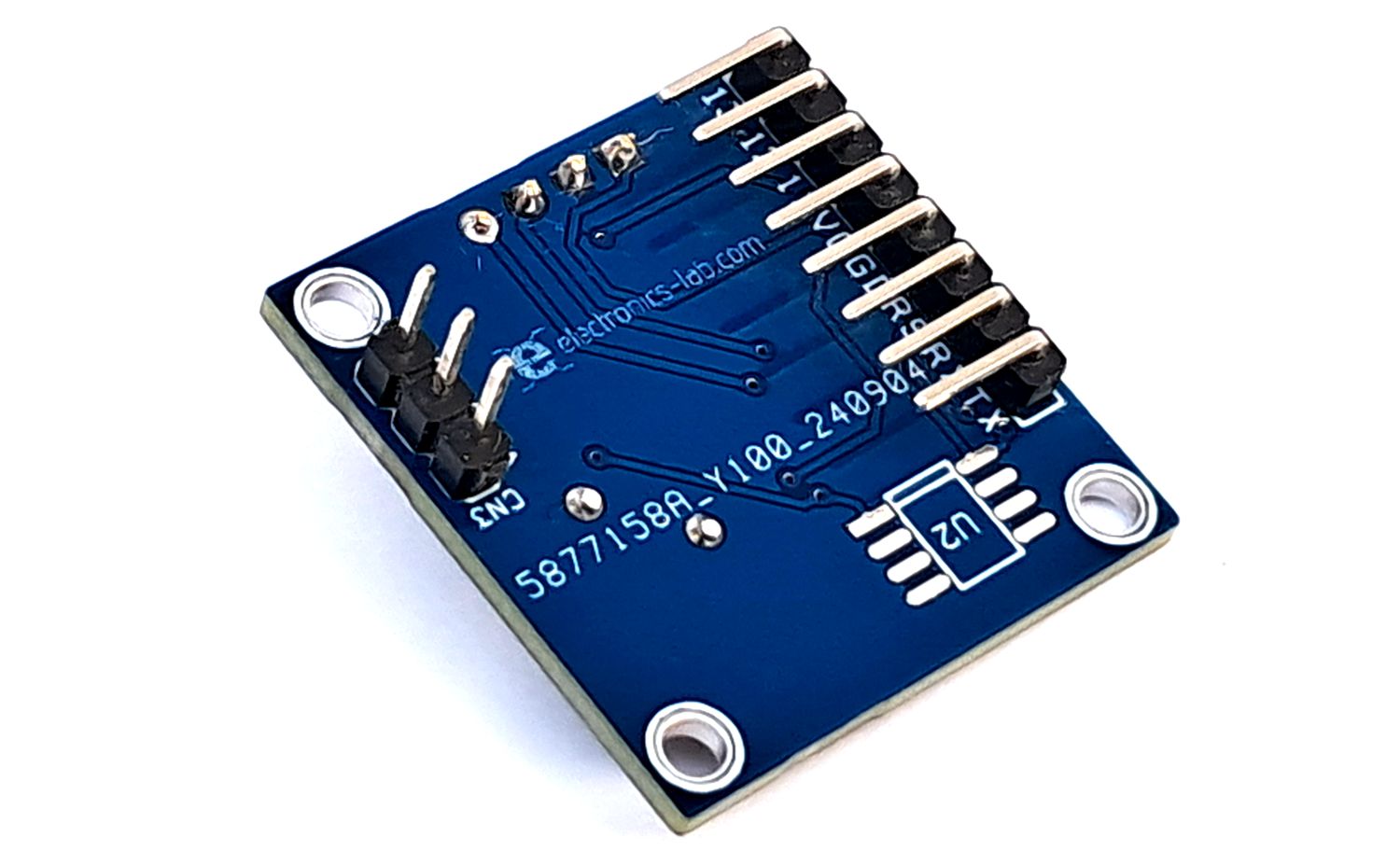

Connections
  • CN1: OLED Display, Pin 1 = VCC, Pin 2 = GND, Pin 3 = SCL, Pin 4 = SDA
  • CN1: Programming Connector, Pin 1 = TX, Pin 2 = RX, Pin 3 = Reset, Pin 4 = GND, Pin 5 = VCC, Pin 6 = D11, Pin 7 = D12, Pin 8 = D13
  • CN3: Sensor Connection, Pin 1 = Sensor 1 (VCC), Pin 2 = Sensor 2 (Analog A0), Pin 3 = GND Note in Use

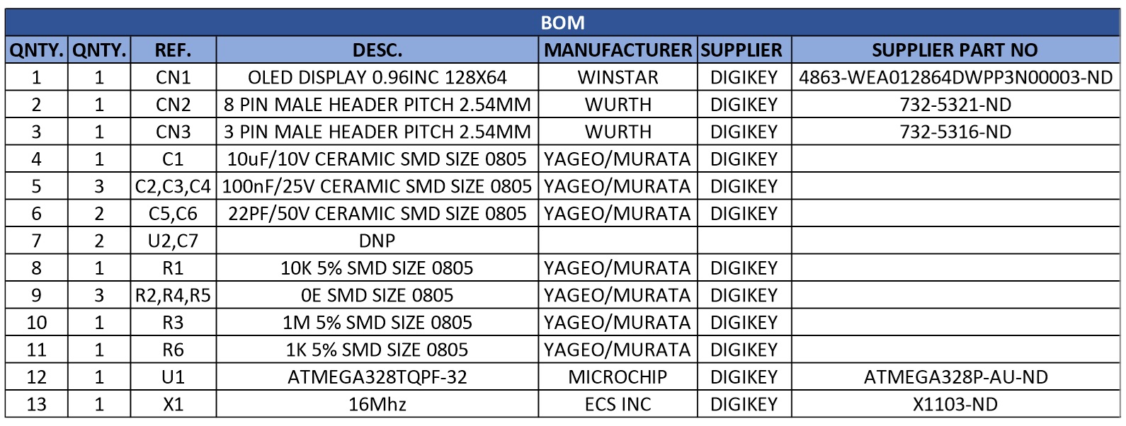

Parts List
QNTY.QNTY.REF.DESC.MANUFACTURERSUPPLIER SUPPLIER PART NO
11CN1OLED DISPLAY 0.96INC 128X64WINSTARDIGIKEY4863-WEA012864DWPP3N00003-ND
21CN28 PIN MALE HEADER PITCH 2.54MMWURTHDIGIKEY732-5321-ND
31CN33 PIN MALE HEADER PITCH 2.54MMWURTHDIGIKEY732-5316-ND
41C110uF/10V CERAMIC SMD SIZE 0805YAGEO/MURATADIGIKEY
53C2,C3,C4100nF/25V CERAMIC SMD SIZE 0805YAGEO/MURATADIGIKEY
62C5,C622PF/50V CERAMIC SMD SIZE 0805YAGEO/MURATADIGIKEY
72U2,C7DNP
81R110K 5% SMD SIZE 0805YAGEO/MURATADIGIKEY
93R2,R4,R50E SMD SIZE 0805YAGEO/MURATADIGIKEY
101R31M 5% SMD SIZE 0805YAGEO/MURATADIGIKEY
111R61K 5% SMD SIZE 0805YAGEO/MURATADIGIKEY
121U1ATMEGA328TQPF-32MICROCHIPDIGIKEYATMEGA328P-AU-ND
131X116MhzECS INCDIGIKEYX1103-ND

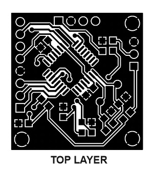

Gerber View

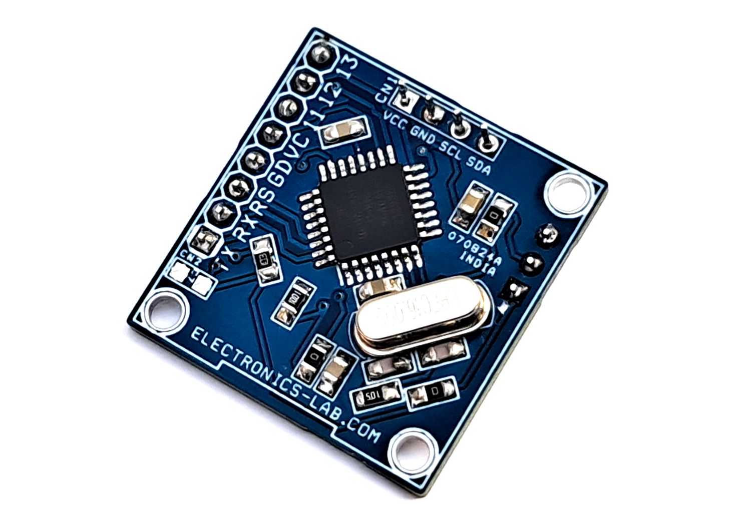

Photos
