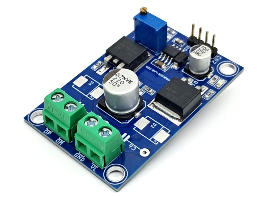

This project is a Half Bridge with Inbuilt Oscillator utilizing the NCP1392B MOSFET driver and IRF540 MOSFETs for half-bridge topology applications. It allows for adjustable operating frequency from 25 kHz to 100 kHz with a trimmer potentiometer. The project includes brown-out protection, a PFC delay timer, and fixed dead time to improve performance. Designed for low-voltage applications up to 36V and 3A load current with forced air cooling, it can be modified for high-voltage use up to 400V by changing components like capacitors and MOSFETs. The operating frequency can be tuned up to 480 kHz depending on component values, with recommendations to consult the datasheet for optimal performance in higher frequency applications.
This is a Half Bridge with Inbuilt Oscillator project that uses the NCP1392B, a self-oscillating high-voltage MOSFET driver, and two IRF540 MOSFETs. This project is specifically designed for applications that employ half-bridge topology.
The operating frequency of the driver can be adjusted from 25 kHz to 100 kHz using a trimmer potentiometer (PR1). Additionally, the project features adjustable brown-out protection, ensuring that the bulk voltage operates within the correct range. An internal 100 ms or 12.6 ms PFC delay timer guarantees that the main downstream converter will be turned on only when the bulk voltage is fully stabilized. The device also provides a fixed dead time, which helps reduce shoot-through current.
This project is configured for low-voltage applications, supporting up to 36V, with a continuous load current of up to 3A when forced air cooling is used. However, with some modifications, the project can be adapted to support high-voltage applications up to 400V DC. These modifications include replacing the DC bus capacitor, MOSFETs, and selecting an appropriate boot capacitor based on the specific frequency and voltage requirements.
The operating frequency of the project can be adjusted within a range of 25 kHz to 100 kHz using the trimmer potentiometer PR1. The chip itself supports frequencies up to 480 kHz, but the actual frequency depends on the values of PR1 and resistor R6. For frequency adjustment, it is recommended to refer to the chip’s datasheet. It is also important to choose the right MOSFET and boot capacitor for higher frequency applications to ensure optimal performance.

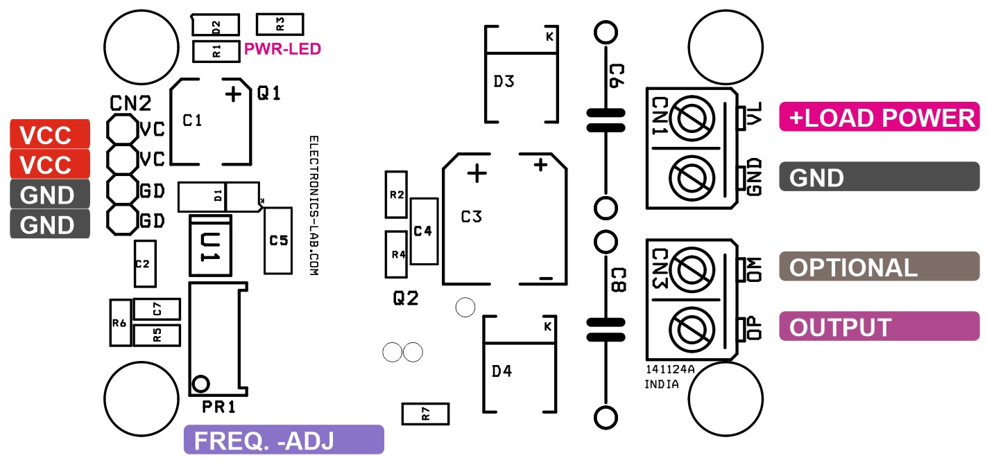

Connections
- CN1 Load Power: Pin 1 + Load Power 24V-36V, Pin 2 = GND
- CN2 Gate Driver Power: Pin 1, 2 = +12V to 15V, Pin 3, 4= GND
- CN3 Output: Pin 1 = Optional for Single Ended Push Pull Output 1/2V, Pin 2 = Half-Bridge Output
- D2: Power LED Gate Driver
- PR1: Frequency Adjust
