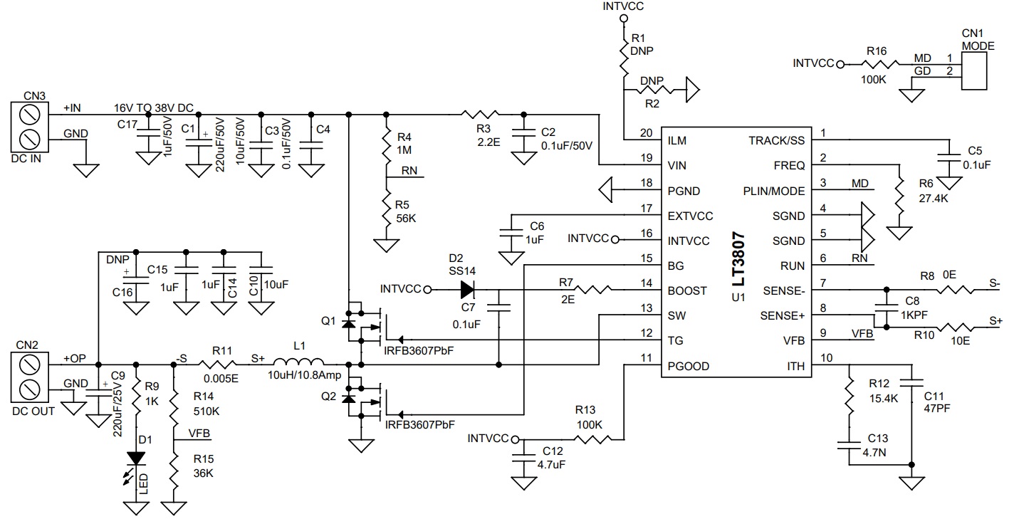

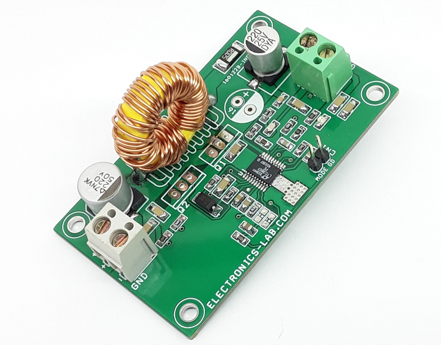

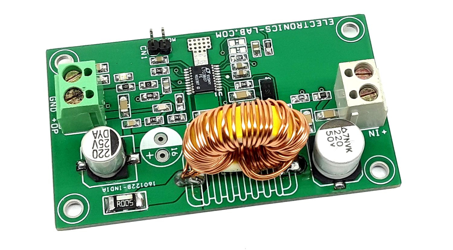

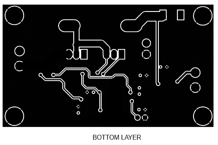

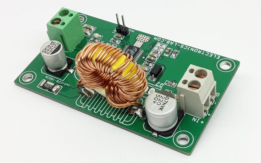

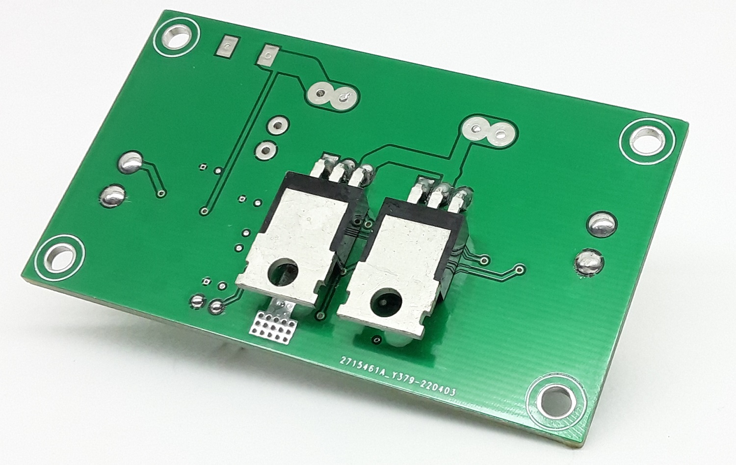

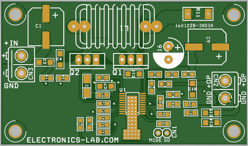

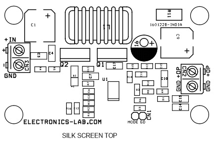

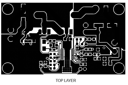

The project presented here is a low quiescent current, synchronous buck converter featuring the LTC3807. This DC-DC converts a 16V to 38V input voltage to a 12V at 6A output. The main features of this board include an internal LDO for gate drive power from VIN or EXTVCC, RUN pins, a mode selector jumper CN1 that allows the converter to run in constant current mode (CCM), pulse-skipping or Burst Mode operation, and selectable current limit. Output is fixed and provides 12V DC but it supports an adjustable output voltage. Refer to the datasheet below to learn more about the adjustable output. The circuit has also soft-start and tracking. The wide input voltage range of 16V to 38V is suitable for automotive and distributed DC power systems where the low quiescent current is essential. The operating frequency is set to 120Khz using resistor R6. MOSFETs are mounted under the PCB for easy heatsink mounting, it is important to use a heatsink for a full current load.
Main Control Loop
The LTC3807 uses a constant frequency, current mode step-down architecture. During normal operation, the external top MOSFET is turned on when the clock for that channel sets the RS latch and is turned off when the main current comparator, ICMP, resets the RS latch. The peak inductor current at which ICMP trips and resets the latch is controlled by the voltage on the ITH pin, which is the output of the error amplifier, EA. The error amplifier compares the output voltage feedback signal at the VFB pin (which is generated with an external resistor divider connected across the output voltage, VOUT, to ground) to the internal 0.800V reference voltage. When the load current increases, it causes a slight decrease in VFB relative to the reference, which causes the EA to increase the ITH voltage until the average inductor current matches the new load current. After the top MOSFET is turned off each cycle, the bottom MOSFET is turned on until either the inductor current starts to reverse, as indicated by the current comparator IR, or the beginning of the next clock cycle.

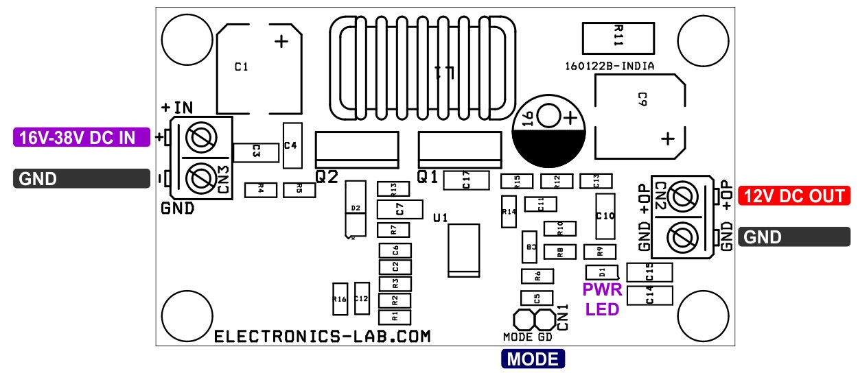

CN1 Can be used as jumper: Jumper/Shunt Open = Pulse Skip Mode, Jumper/Shunt Closed Burst Mode, Use R16 0 Ohms Resistor to select FCM Mode (Don’t Use Shunt in this Case)
External Synchronization Input to Phase Detector and Forced Continuous Mode Input. When an external clock is applied to this pin, the phase-locked loop will force the rising TG signal to be synchronized with the rising edge of the external clock, and the regulator operates in forced continuous mode. When not synchronizing to an external clock, this input determines how the LTC3807 operates at light loads. Pulling this pin to the ground selects Burst Mode operation. An internal 100k resistor to the ground also invokes Burst Mode operation when the pin is floated. Tying this pin to INTVCC forces continuous inductor current operation. Tying this pin to a voltage greater than 1.2V and less than INTVCC –1.3V selects pulse-skipping operation.
Note1: The circuit offers output current up to 6A with a safe margin. The project can provide a higher current of up to 10A with low ohmic MOSFETs. In this case, the PCB needs to have thick tracks such as 95Microns and a higher current rating inductor L1.
Note2: Output voltage is fixed at 12V DC, this can be changed and its adjustable range is 0.8V to 24V, use appropriate feedback resistors R14 and R15 values to alter the output voltage and refer to the datasheet for more information on this.

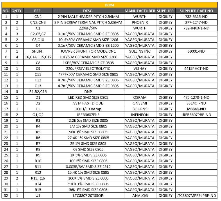

Parts List
NO.QNTY.REF.DESC.MANUFACTURERSUPPLIER PART NO
11CN12 PIN MALE HEADER PITCH 2.54MMWURTHDIGIKEY732-5315-ND
22CN2,CN32 PIN SCREW TERMINAL PITCH 5.08MMPHOENIXDIGIKEY277-1247-ND
31C1220uF/50VWURTHDIGIKEY732-8463-1-ND
43C2,C5,C70.1uF/50V CERAMIC SMD SIZE 0805YAGEO/MURATADIGIKEY
52C3,C1010uF/50V CERAMIC SMD SIZE 1206YAGEO/MURATADIGIKEY
61C40.1uF/50V CERAMIC SMD SIZE 1206YAGEO/MURATADIGIKEY
71SHUNTJUMPER SHUNT FOR MODE CN1SULLINS INCDIGIKEYS9001-ND
84C6,C14,C15,C171uF/50V CERAMIC SMD SIZE 1206YAGEO/MURATADIGIKEY
91C81KPF/50V CERAMIC SIZE 0805YAGEO/MURATADIGIKEY
101C9220uF/25V ELECTROLYTICVISHAYDIGIKEY4415PHCT-ND
111C1147PF/50V CERAMIC SMD SIZE 0805YAGEO/MURATADIGIKEY
121C124.7uF/50V CERAMIC SMD SIZE 0805YAGEO/MURATADIGIKEY
131C134.7nF/50V CERAMIC SMD SIZE 0805YAGEO/MURATADIGIKEY
143R1,R2,C16DNP
151D1LED RED SMD SIZE 0805OSRAMDIGIKEY475-1278-1-ND
161D2SS14 FAST DIODEONSEMIDIGIKEYSS14CT-ND
171L110uH/10.8AmpBOURNSDIGIKEYM8848-ND
182Q1,Q2IRFB3607PbFINFINEONDIGIKEYIRFB3607PBF-ND
191R32.2E 5% SMD SIZE 0805YAGEO/MURATADIGIKEY
201R41M 1% SMD SIZE 0805YAGEO/MURATADIGIKEY
211R556K 1% SMD SIZE 0805YAGEO/MURATADIGIKEY
221R627.4K 1% SMD SIZE 0805YAGEO/MURATADIGIKEY
231R72E 1% SMD SIZE 0805YAGEO/MURATADIGIKEY
241R80E SMD SIZE 0805YAGEO/MURATADIGIKEY
251R91K 5% SMD SIZE 0805YAGEO/MURATADIGIKEY
261R1010E 5% SMD SIZE 0805YAGEO/MURATADIGIKEY
271R110.005E/3W SMD SIZE 2512YAGEO/MURATADIGIKEY
281R1215.4K 1% SMD SIZE 0895YAGEO/MURATADIGIKEY
292R13,R16100K 5% SMD SIZE 0805YAGEO/MURATADIGIKEY
301R14510K 1% SMD SIZE 0805YAGEO/MURATADIGIKEY
311R1536K 1% SMD SIZE 0805YAGEO/MURATADIGIKEY
321U1LTC3807 20TSSOPANALOGDIGIKEYLTC3807MPFE#PBF-ND
