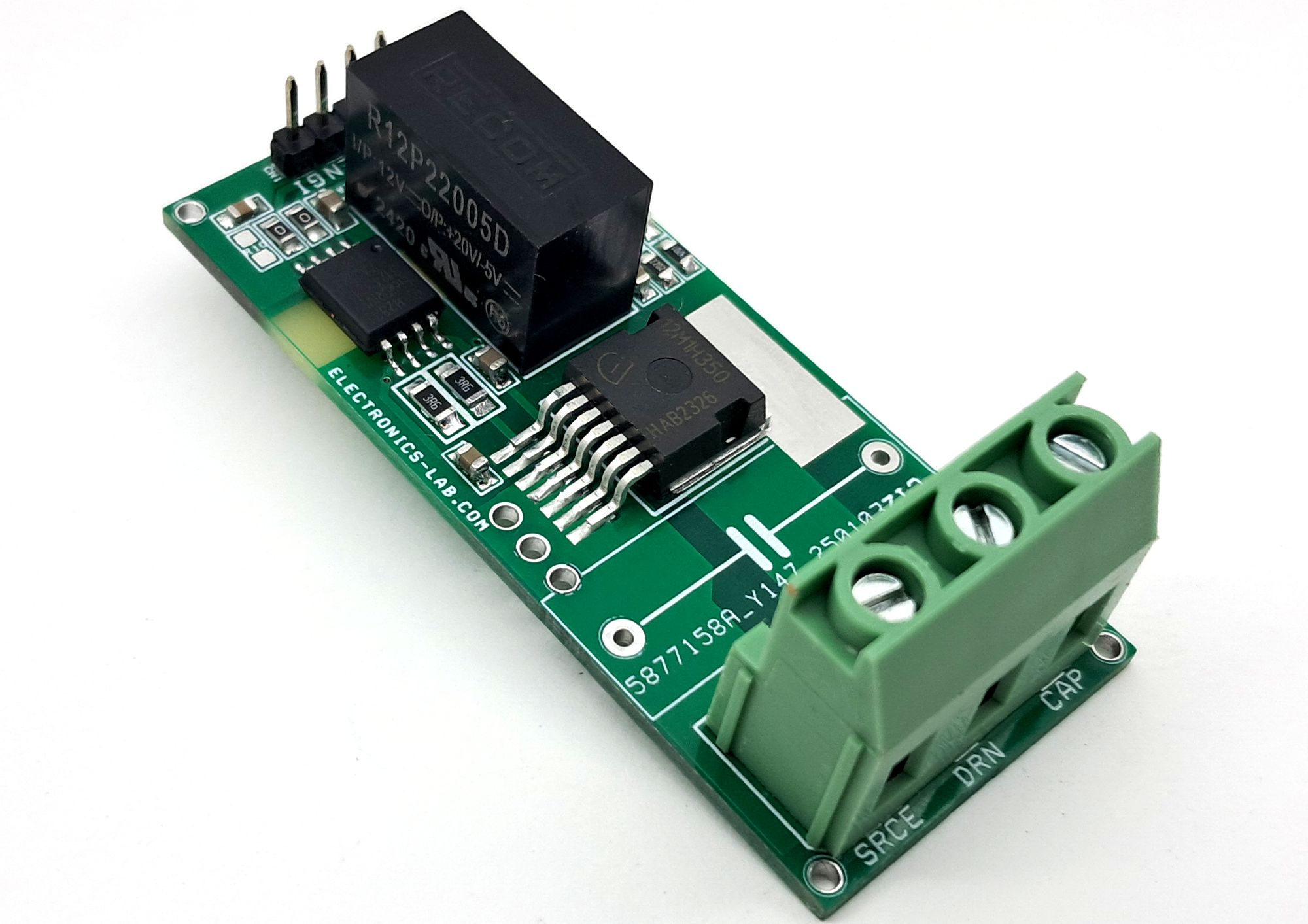

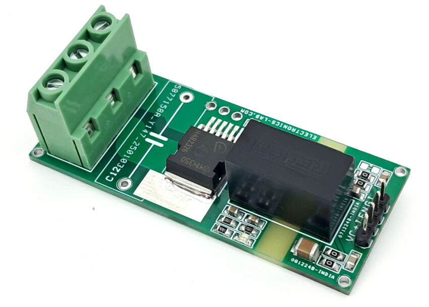

The isolated high-voltage SiC MOSFET switch is a reliable and efficient solution for power driver applications. It includes a gate driver chip, a 1.2kV/4.7A SiC MOSFET, and a 2W DC-DC converter. The module is suitable for various configurations and can be connected to high-current/voltage screw terminals.
The isolated high-voltage SiC MOSFET switch offers a straightforward solution for power drivers, comprising a gate driver chip (1ED3124MC12H), a 1.2kV/4.7A SiC MOSFET, and an isolated 2W DC-DC converter (R12P22005D). The gate driver chip is optimized for high-frequency operations and can deliver high gate driver currents of up to 14A. This module is well-suited for various applications, including half-bridge, full-bridge, and single SiC MOSFET switch configurations.
For convenient access, the Source and Drain of the SiC MOSFET are connected to high-current/voltage screw terminals. Additionally, an optional high-voltage C12 capacitor can be installed as per the specific application requirements, providing flexibility and adaptability to different use cases. Overall, this isolated high-voltage SiC MOSFET switch module provides a reliable and efficient solution for power driver applications.

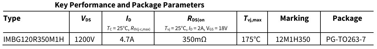

  • On Board High Voltage TO263-7 SIC MOSFET (IMBG120R350M1H 1200V/4.7A /350mΩ/175°C)

  • Screw Terminal Provided for SiC MOSFET Drain Source Connections
  • On Board Power LED (Output DC-DC Converter)
  • PCB Dimensions 64.93 x 27.31 mm

SiC MOSFET Data

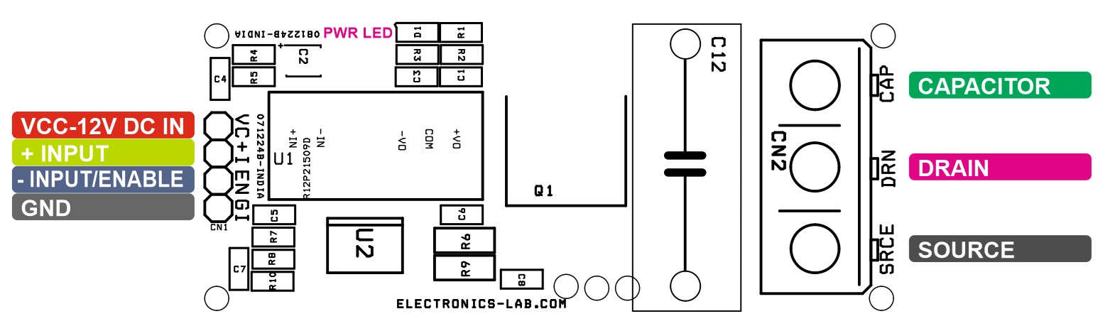

Connections
  • CN1: Pin 1 = VCC 12V DC Input, Pin 2 = IN+ PWM Input, Pin 3 = IN- PWM Input, Pin 4 = GND-Input Side
  • CN2: Pin 1 = Optional Capacitor, Pin 2 = SiC MOSFET Drain, SiC MOSFET Source
  • D1: Power LED Output side

Connections

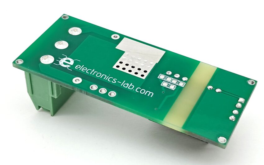

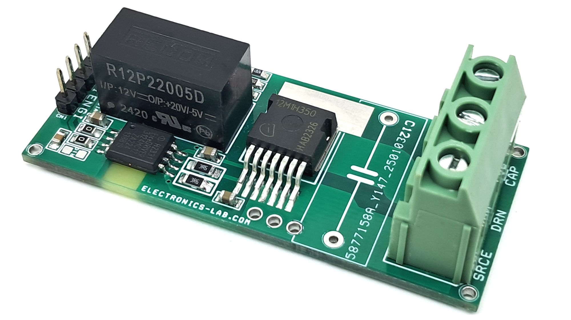

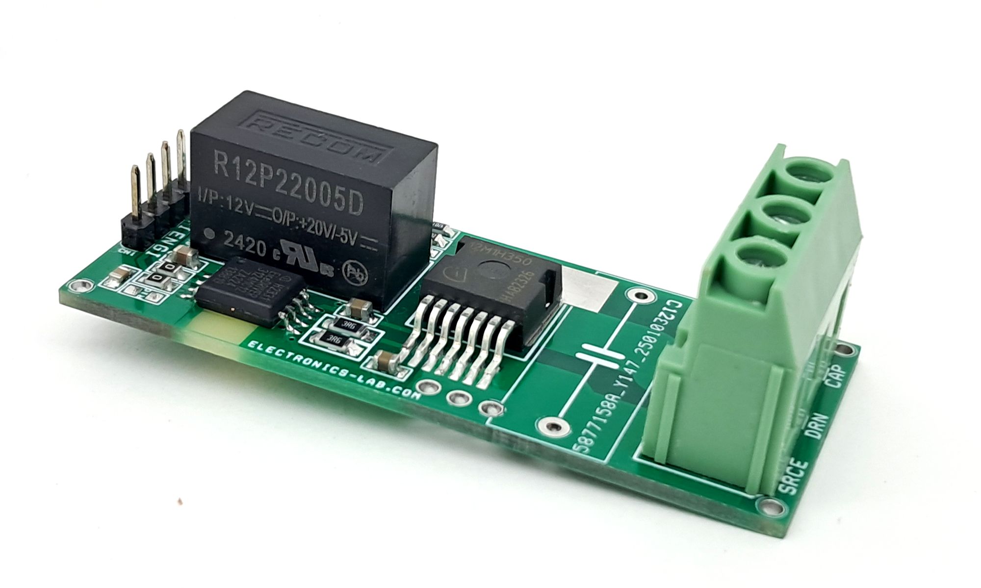

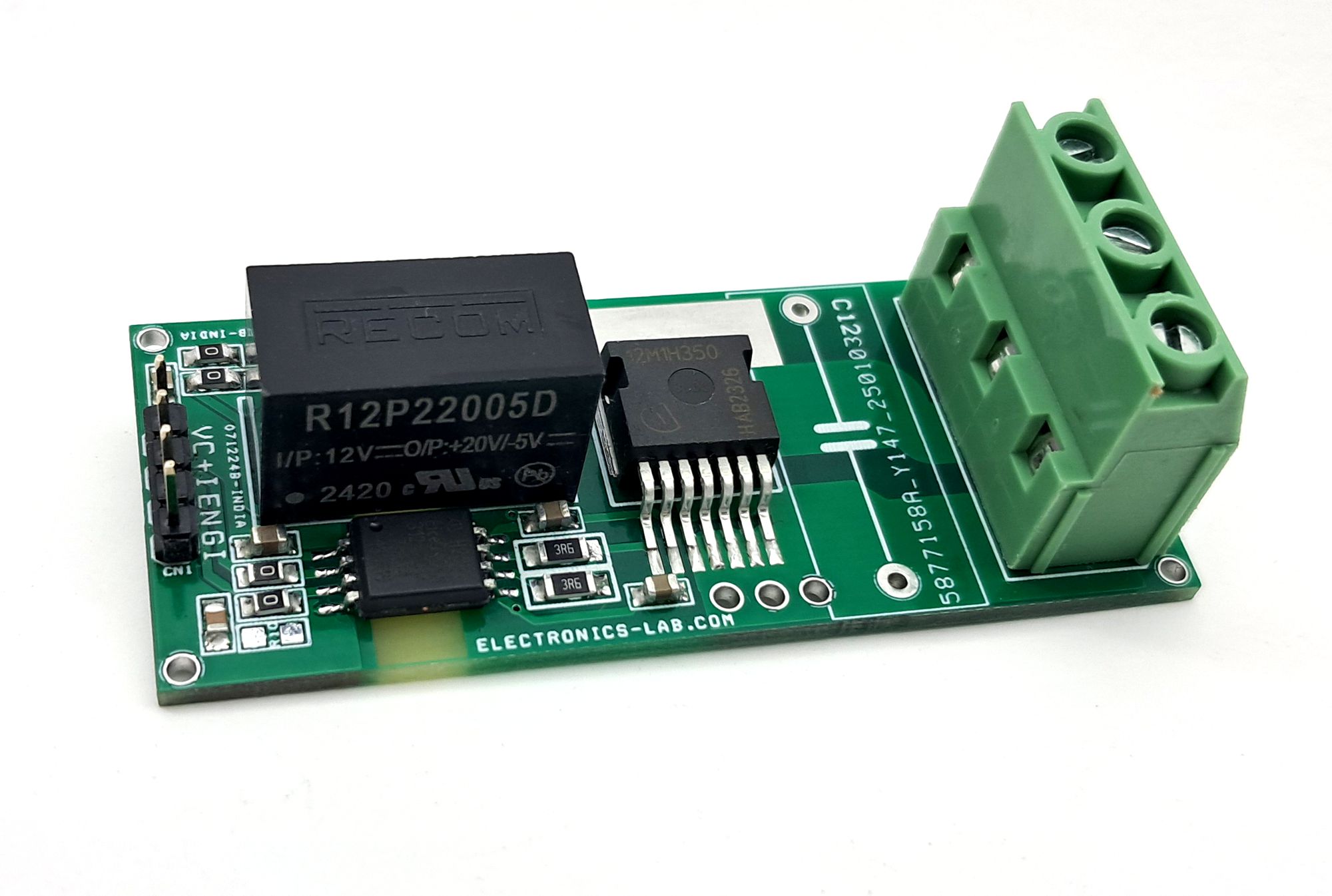

Photos
