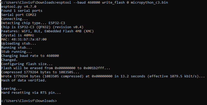

Once inside there, you just have to issue the command below and hit enter. Remember to use your file name, not necessarily mine (micropython_c3.bin).
esptool --baud 460800 write_flash 0 micropython_c3.bin
Upon success, you are going to see something similar to the screen below:
flashing new firmware to esp32-c3
