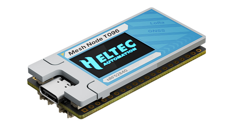

Heltec Automation has introduced the Mesh Node T096, a compact low-power development board built for long-range wireless communication, decentralized networking, and positioning applications. The board combines the nRF52840 microcontroller, SX1262 LoRa transceiver, and UC6580 GNSS receiver into a small platform designed for Meshtastic, MeshCore, and LoRaWAN projects. With support for Bluetooth, LoRa, and satellite positioning, the device targets developers working on mesh communication systems, asset tracking, environmental monitoring, and remote sensing deployments.
The board uses the Nordic nRF52840 SoC, which features a 64MHz Arm Cortex-M4F processor with Bluetooth 5 and Bluetooth Mesh support. Unlike many ESP32-based LoRa platforms, the T096 focuses heavily on low-power operation, making it more suitable for battery-powered and solar-powered nodes. Heltec also integrates an SX1262 LoRa transceiver with a built-in PA that delivers up to 28±1 dBm transmit power for long-range connectivity and improved signal reliability. The onboard UC6580 GNSS chip supports GPS, GLONASS, BeiDou, Galileo, NAVIC, and QZSS positioning systems for accurate location tracking.

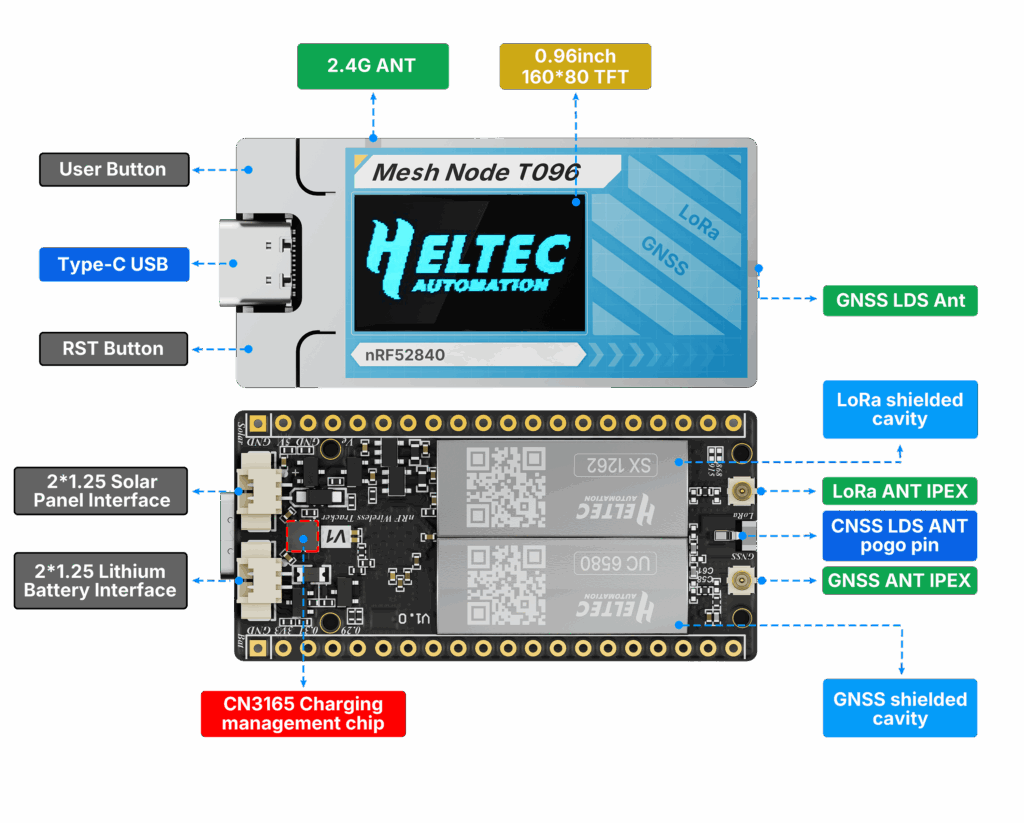

Heltec T096 LoRa Mesh Node Layout
Heltec T096 LoRa mesh node features:
  • MCU: nRF52840
    • 64MHz Arm Cortex-M4F processor
    • Bluetooth 5 and Bluetooth Mesh support
    • Hardware cryptographic acceleration
  • LoRa Connectivity: SX1262
    • 863MHz to 928MHz frequency range
    • Up to 28±1 dBm TX power
    • Long-range wireless communication
  • GNSS Support: UC6580
    • Supports GPS, GLONASS, BeiDou, Galileo, NAVIC, and QZSS
    • L1+L5 positioning support
  • Wireless Features:
    • Bluetooth LE
    • Bluetooth Mesh
    • Compatible with Meshtastic and MeshCore
  • Interfaces:
    • USB Type-C
    • SPI, UART, I2C, PWM, QSPI, I2S, and PDM
    • 2× 13-pin 2.54mm header connectors
    • IPEX connectors for LoRa and GNSS antennas
  • Power Management:
    • Lithium battery charging and protection
    • Automatic USB and battery switching
    • Solar panel connector support
    • Ultra-low power operation
  • Additional Hardware:
    • 0.96-inch TFT display
    • Two LEDs and two buttons
    • LDS-based integrated Bluetooth and GNSS antennas
  • Dimensions: 52.0 × 25.4 × 10.26 mm
  • Operating temperature: -20°C to 70°C

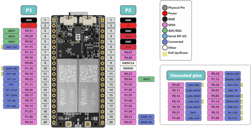

Heltec T096 LoRa Mesh Node Pinmap
The LoRa mesh node supports Arduino, PlatformIO, and MicroPython development environments, allowing developers to quickly build wireless communication and tracking applications. Heltec also provides LoRa and LoRaWAN example projects for rapid prototyping. Since the board supports Meshtastic and MeshCore out of the box, users can deploy decentralized mesh networks without depending on traditional communication infrastructure. The nRF52840 platform also enables concurrent Bluetooth and mesh networking operation while maintaining low power consumption.
