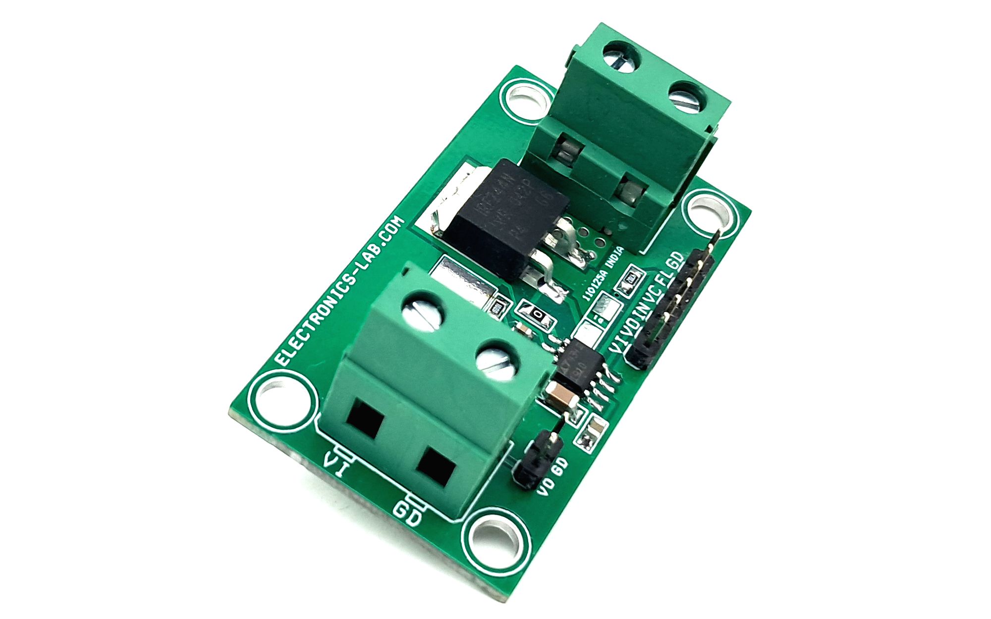

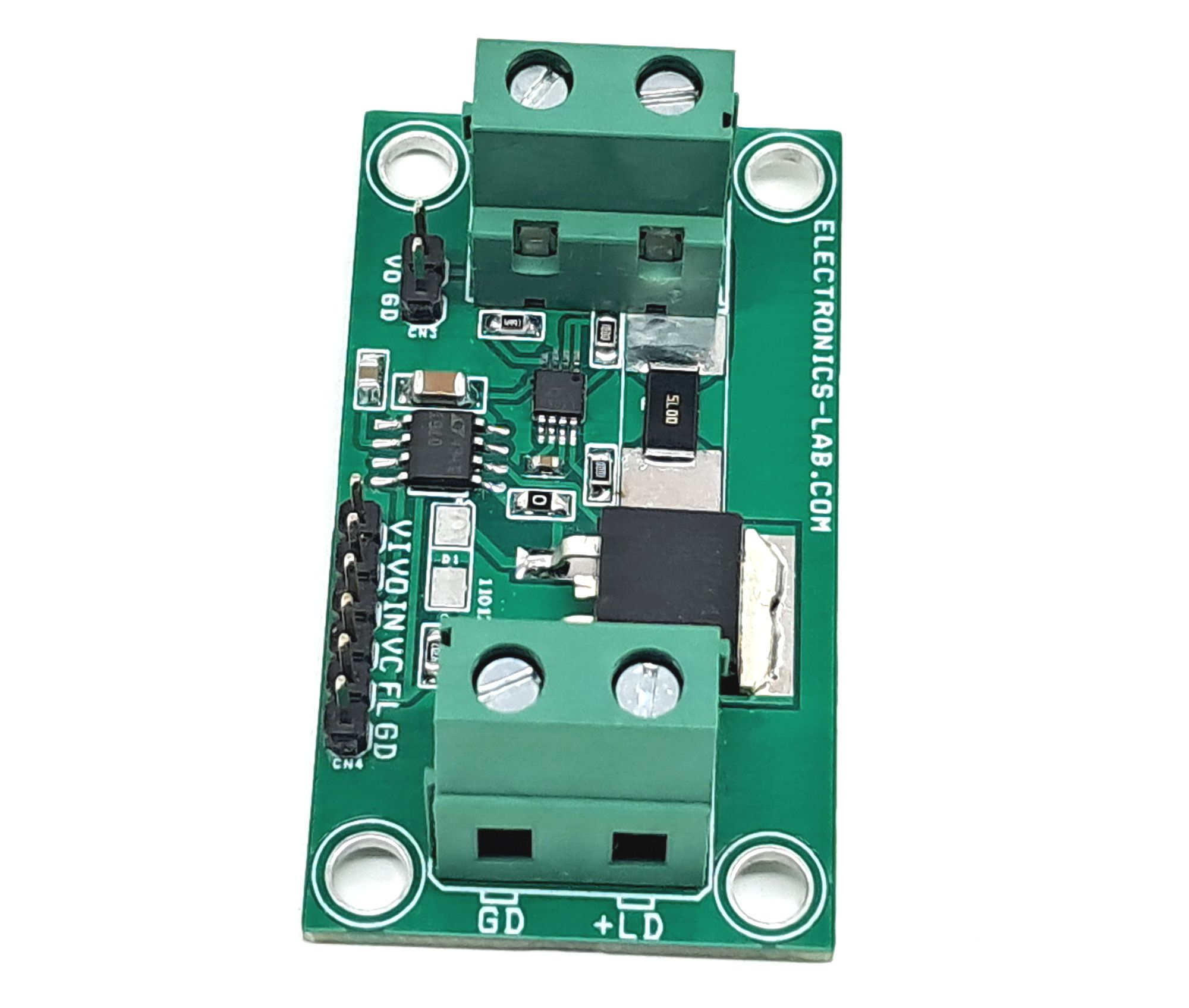

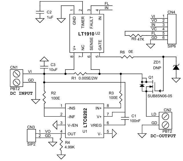

This high-side switch handles loads up to 10A. It uses an LTC6102 and LT1910 to monitor current and disable the MOSFET upon a fault, with automatic restart.
This is an intelligent high-side switch with integrated current monitoring allows users to control loads up to 10A. Upon receiving a trigger signal, the switch activates the load. In the event of a short circuit or overcurrent condition, the output MOSFET is disabled. The system attempts to re-enable the output after a 150ms delay. If the fault persists, this cycle repeats until the fault is cleared. Circuit also provides fault output low Pin5 CN4.
The project consists of LTC6102 precision zero drift current sensor amplifier and LT1910 protected high side MOSFET driver and high current MOSFET SUB85N06-5. The LTC6102 measure the current across current sense resistor and provides the voltage feedback. With 0.005Ohm resistor the feedback is Vo=2.5V at 10A full-scale current . LT1910 is high side gate driver that allows power MOSFET for high side switching applications. LT1910, contains a completely self-contained charge pump to fully enhance an N-channel MOSFET switch with no external components.
When the internal drain comparator senses that the switch current has exceeded the preset level, the switch is turned off and a fault flag is asserted. The switch remains off for a period of time set by an external timing capacitor and then automatically attempts to restart. If the fault still exists, this cycle repeats until the fault is removed, thus protecting the MOSFET. The fault flag becomes inactive once the switch restarts successfully. Test conducted with IRFZ44 MOSFET.

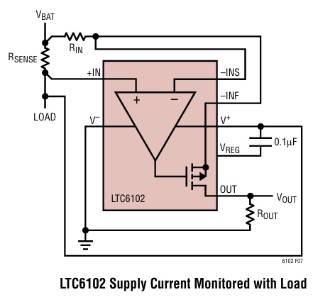

Current Sense Threshold and Feedback Output
The selection of RS should be based on the minimum threshold voltage: RS = 50mV/ISET Thus the 0.005Ω drain-sense resistor in will yield a minimum trip current of 10A. This simple configuration is appropriate for resistive or inductive loads that do not generate large current transients at turn-on. Current feedback Vo=2.5V at 10A full-scale.

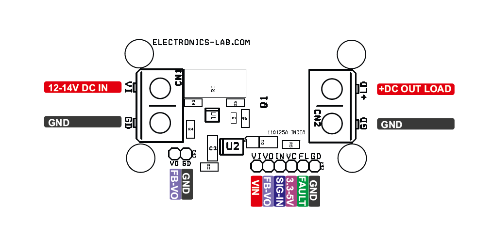

Connections
  • CN1: Pin 1 = VI/Power Input 12-14V DC, Pin 2 = GND
  • CN2: Pin 1 = +Load, Pin 2 = -Load/GND
  • CN3: Pin 1 = VO/Current Feed Back Voltage Output, Pin 2 = GND
  • CN4: Pin 1 = VI, Pin 2 = VO, Pin 3 = Trigger Input, Pin 4 = VCC/5V, Pin 5 = Fault, Pin 6 = GND
