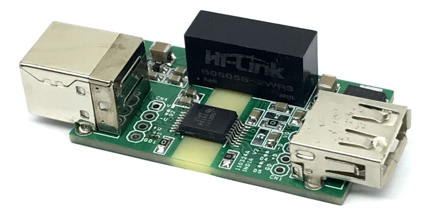

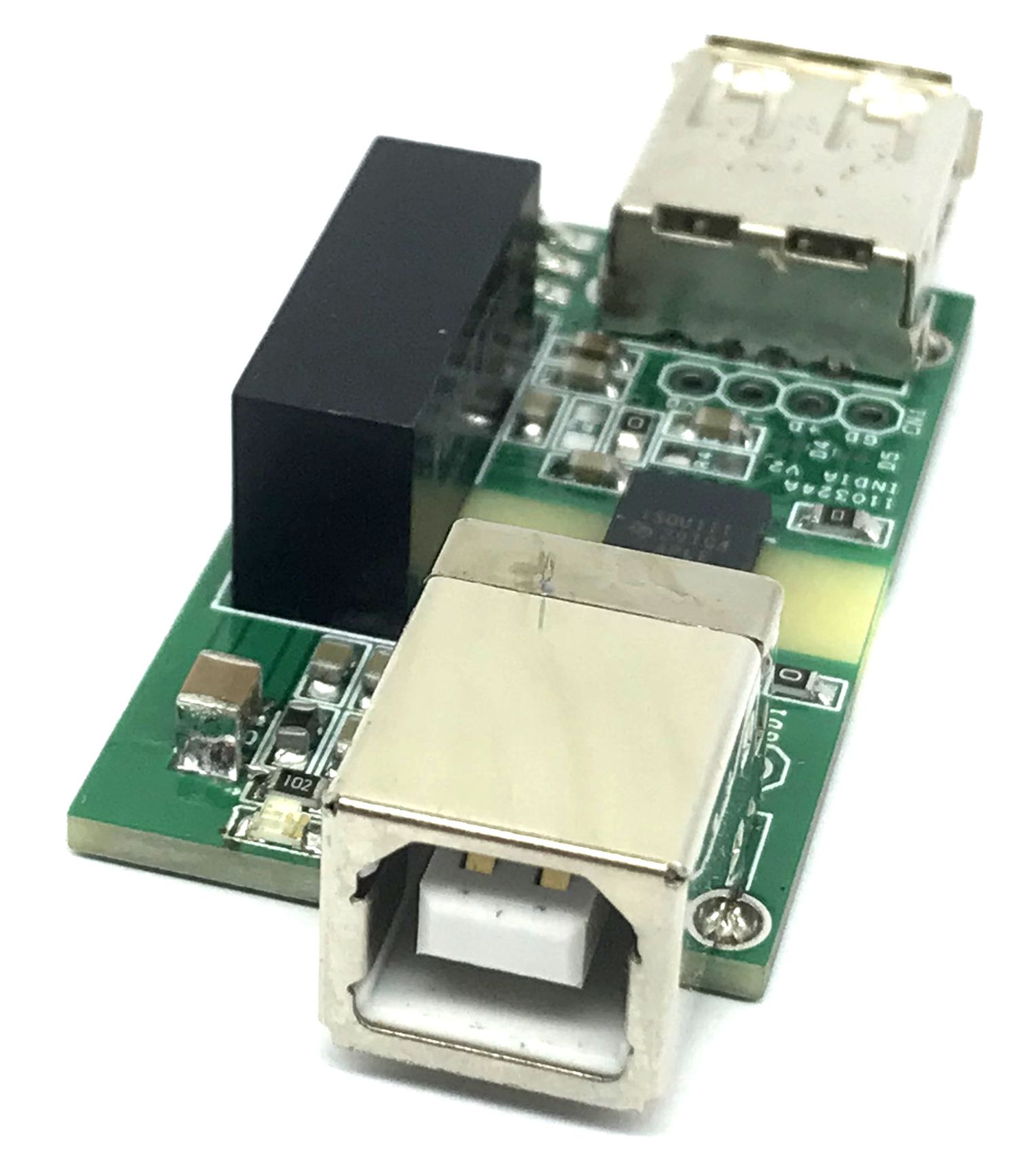

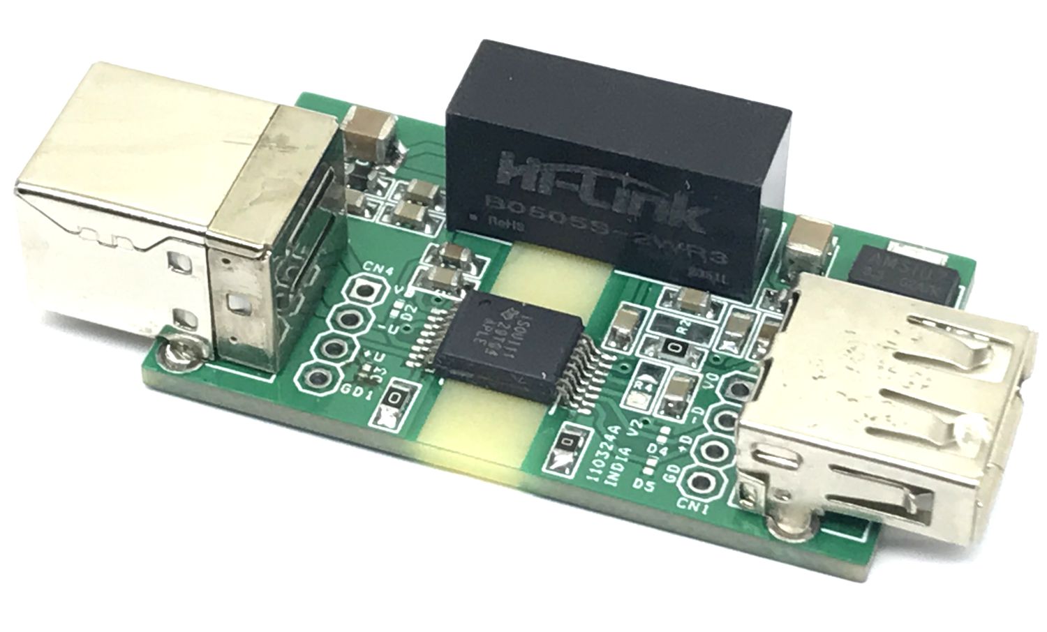

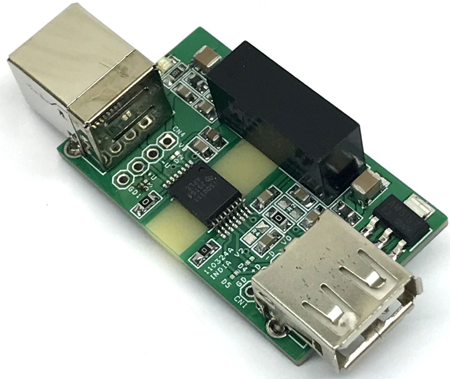

The project presented here is a USB port-powered, USB 2.0 isolator that isolates the USB host and USB device. It is a galvanically-isolated USB2.0 repeater, that supports low speed 1.5Mbps, and full speed 12Mbps communication.

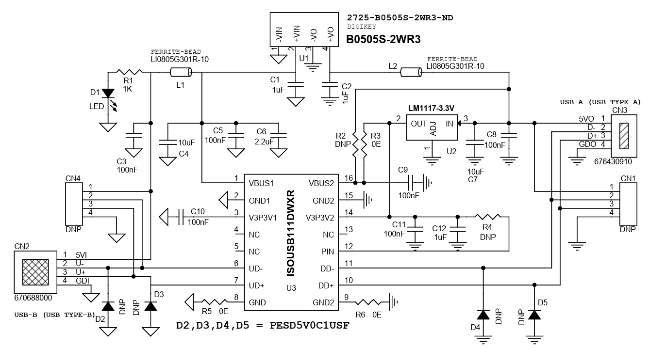

The project presented here is a USB port-powered, USB 2.0 isolator that isolates the USB host and USB device. It is a galvanically-isolated USB2.0 repeater, that supports low speed 1.5Mbps, and full speed 12Mbps communication. The project automatically connects and detects the bus speed. This USB 2.0 isolator is efficiently powered from the USB port and requires no external power, on board isolated DC-DC converter U1 provides 5V to the other side of the circuitry and USB port. U2 LDO provides 3.3V to the chip. L1 and L2 ferrite beads take care of noise immunity on the DC bus. The project protects the host USB port from noise and high voltage.
Note: Output USB Connector CN3 can supply 5V to an external USB device, DC-DC converter can output a maximum 400mA. The user must take care not to overload the Output of the USB Power, the load has to be within 400mA. The output of USB is isolated and continuously protected from short circuits.

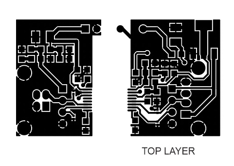

  • PCB Dimensions 44.77 x 25.72 mm

The ISOUSB111 is a galvanically-isolated USB 2.0 compliant repeater supporting low speed (1.5 Mbps) and full speed (12 Mbps) signaling rates. The device supports automatic connect and speed detection, reflection of pull-ups/pull-downs, and link power management allowing drop-in USB hub, host, peripheral, and cable isolation. The device also supports automatic role reversal – if after disconnect, a new connect is detected on the Upstream facing port, then the Upstream and Downstream port definitions are reversed. This feature enables the device to support USB On-The-Go (OTG) and Type-C Dual Role Port (DRP) implementations. This device uses a silicon dioxide (SiO2) insulation barrier with a withstand voltage of up to 5000 VRMS and a working voltage of 1500 VRMS. Used in conjunction with isolated power supplies, the device protects against high voltage and prevents noise currents from the bus from entering the local ground. The ISOUSB111 device is available for reinforced isolation. It supports a wide ambient temperature range of –40°C to +125°C.

NOQNTYREFDESCMANUFACTURERSUPPLIERSUPPLIER PART NO
14CN1,R2,R4,CN4DNPDO NOT INSTALL
21CN2USB-B (USB TYPE-B)MOLEXWM17113-ND
31CN3USB-A (USB TYPE-A)MOLEXWM4993-ND
43C1,C2,C121uF/25V CERAMIC SMD SIZE 0805YAGEO/MURATA
56C3,C5,C8,C9,C10,C11100nF/50V CERAMIC SMD SIZE 0805YAGEO/MURATA
62C4,C710uF/16V CERAMIC SMD SIZE 1210 OR 1206YAGEO/MURATA
71C62.2uF/25V CERAMIC SMD SIZE 0805YAGEO/MURATA
81D1LED SMD SIZE 0805OSRAM475-1278-1-ND
92L1,L2LI0805G301R-10 FERRITE BEADLAIRD
101R11K 5% SMD SIZE 0805YAGEO/MURATA
113R3,R5,R60E SMD SIZE 0805YAGEO/MURATA
121U1B0505S-2WR3 DC-DC CONVERTERMORNSUN AMERICA2725-B0505S-2WR3-ND
131U2LM1117-3.3VTILM1117IMPX-3.3/NOPBCT-ND
141U3ISOUSB111DWXRTI296-ISOUSB111DWXRCT-ND
154D2,D3,D4,D5PESD5V0C1USF OPTIONALNEXPERIADIGIKEY1727-PESD5V0C1USFYLCT-ND
