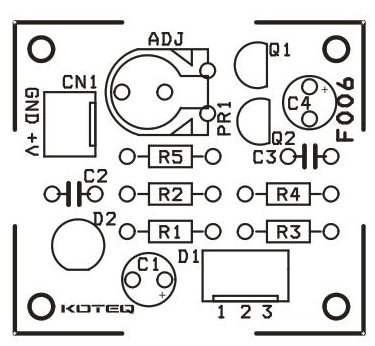

Laser Diode Driver project will help you safely drive (constant current) a 3 mW visible Laser Diode for your application. Input supply - 2.5 to 6 VDC Onboard preset to adjust the current flow to the Laser Diode Power-On LED indicator Header connector for easy input supply and LASER DIODE module connection Laser diode is not included Circuit is designed around Sanyo DL3148-025 LASER DIODE PCB dimensions 37 mm x 42 mm Schematic Parts List
LASER DIODE DRIVER PIC
  • Input supply – 2.5 to 6 VDC
  • Onboard preset to adjust the current flow to the Laser Diode
  • Power-On LED indicator
  • Header connector for easy input supply and LASER DIODE module connection
  • Laser diode is not included
  • Circuit is designed around Sanyo DL3148-025 LASER DIODE
  • PCB dimensions 37 mm x 42 mm

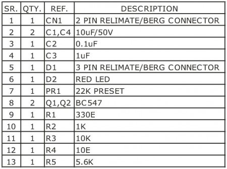

Parts List
LASER DIODE DRIVER BOM
