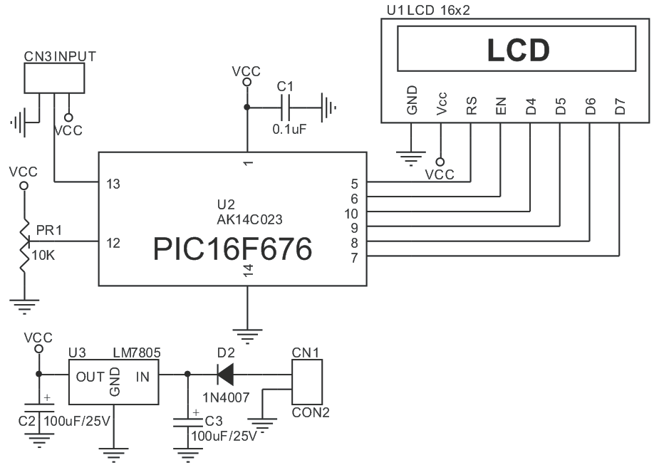

The circuit uses a Microcontroller to read a LM35 Temperature sensor and display the results on the LCD. The onboard ADC on the microcontroller converts the analog signal from the LM35 sensor, computes the results and displays it on the LCD.
Specifications:

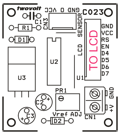

  • Preset PR1 allows the user to adjust the ADC Reference voltage for the project.
  • Temperature sensor (LM35) is connected by a relimate connector at CN3 connector.
  • U3 is a voltage regulator IC, 7805 which provides a regulated voltage to the entire circuit.
  • D2 is a reverse polarity protection diode to prevent against wrong polarity connection of DC supply at connector CN1.

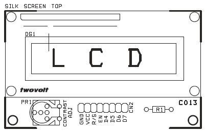

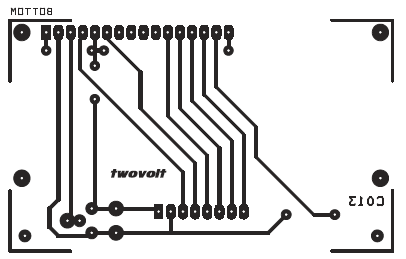

  • LCD Module – C013 is connected at connector marked U1. Please solder corresponding pins marked on this PCB with the One marked on the
Schematic
lm35-themometer-pic16f676-schematic
lm35-themometer-pic16f676-schematic-lcd

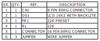

Parts List
lm35-themometer-pic16f676-parts
lm35-themometer-pic16f676-parts-lcd
