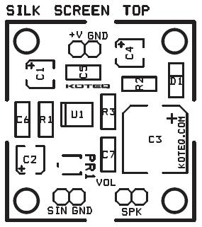

  • On Board Potentiometer for Audio Level Adjust
  • Header Connecter for Supply, Signal in and Speaker
  • On Board Power LED

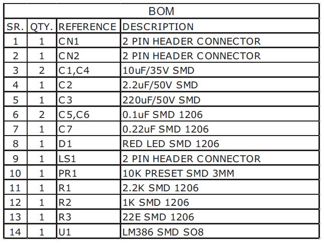

Parts List
LM386_Amplifier_BOM
