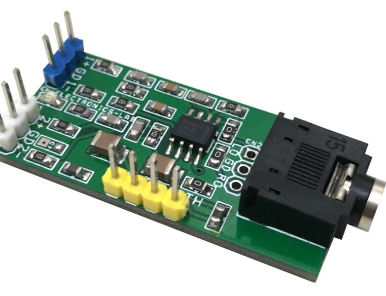

This project is a Mini Stereo Audio Amplifier based on TDA2822 IC.
Description
The dual low power amplifier built around TDA2822 8pin DIP. IC, it is mainly designed to use in portable players, radios and other building block project. A 3V supply can be used to drive headphones providing 20mW in 32 Ohms per channel, and a 12V power supply will provide 1W in 8 Ohm per channel for small loudspeakers.

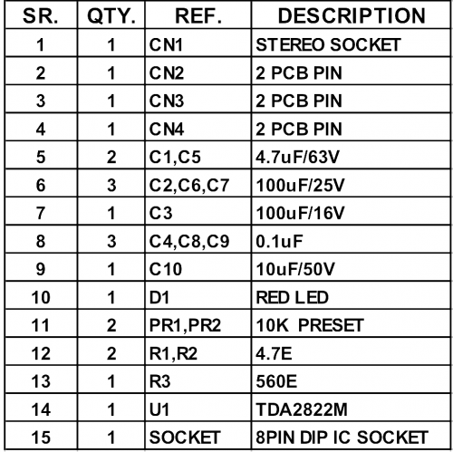

Parts
Mini_Stereo_Audio_Amplifier_BOM

Is there an equivalent capacitor for 0.1uf? Im trying to build multiple amps like these,but have no 0.1uf capacitors. I do have 1uf. Will that damage any of the other components?
Olivier olieter
4.7e = 4k7?
