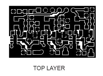

This is a fantastic project for makers, offering multiple output options of 3.3V, 5V, and 12V, with an input of 18-24V DC. This project is built around the MP2451 high-frequency (2Mhz) step-down switching regulator, ensuring efficient and reliable power conversion.
This is a fantastic project for makers, offering multiple output options of 3.3V, 5V, and 12V, with an input of 18-24V DC. This project is built around the MP2451 high-frequency (2Mhz) step-down switching regulator, ensuring efficient and reliable power conversion. For added convenience, a header connector is provided for outputs and input supply, while a power LED indicator ensures easy power status monitoring. This project is particularly well-suited for low-current applications, and its compact PCB design occupies a minimal footprint, making it ideal for space-constrained projects.

- PCB Dimensions 32.07 x 19.37 mm

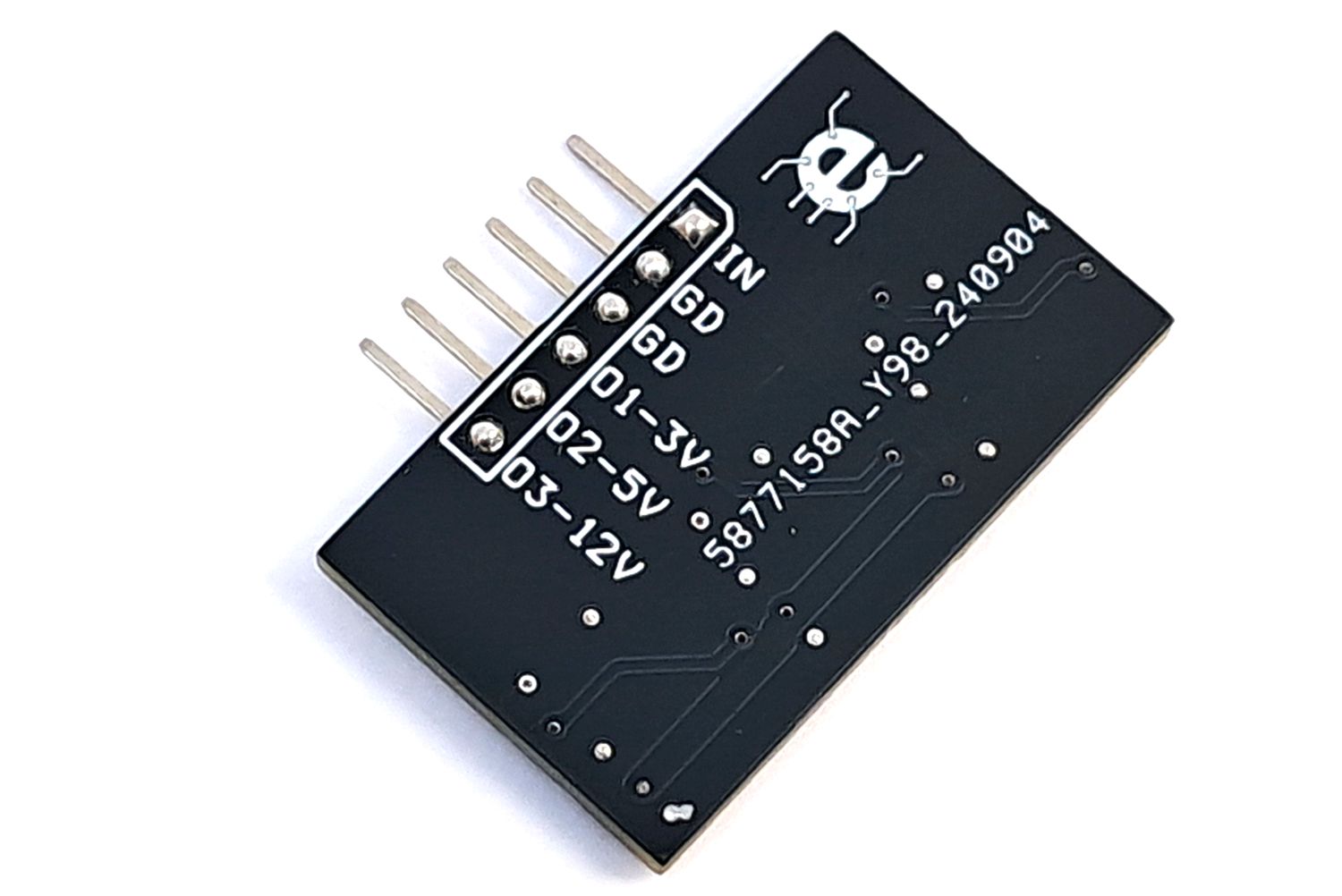

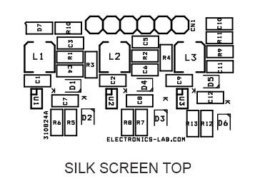

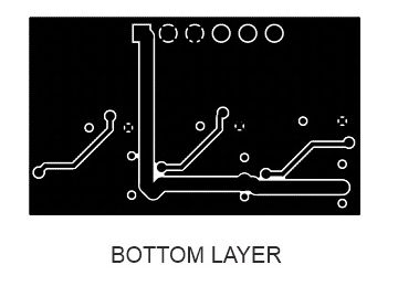

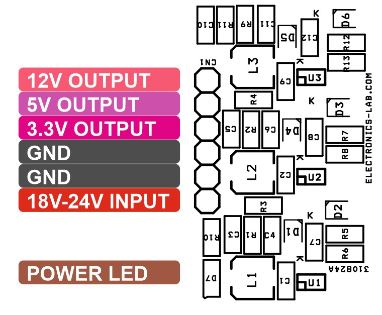

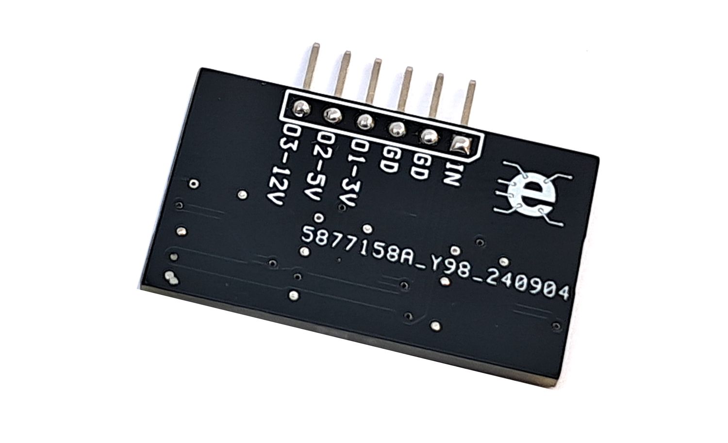

Connections
- CN1: Pin 1 = DC Input 18V to 24V, Pin 2 = GND, Pin 3 = GND, Pin 4 = 3.3V, Pin 5 = 5V, Pin 6 = 12V
- D7: Power LED (Input)

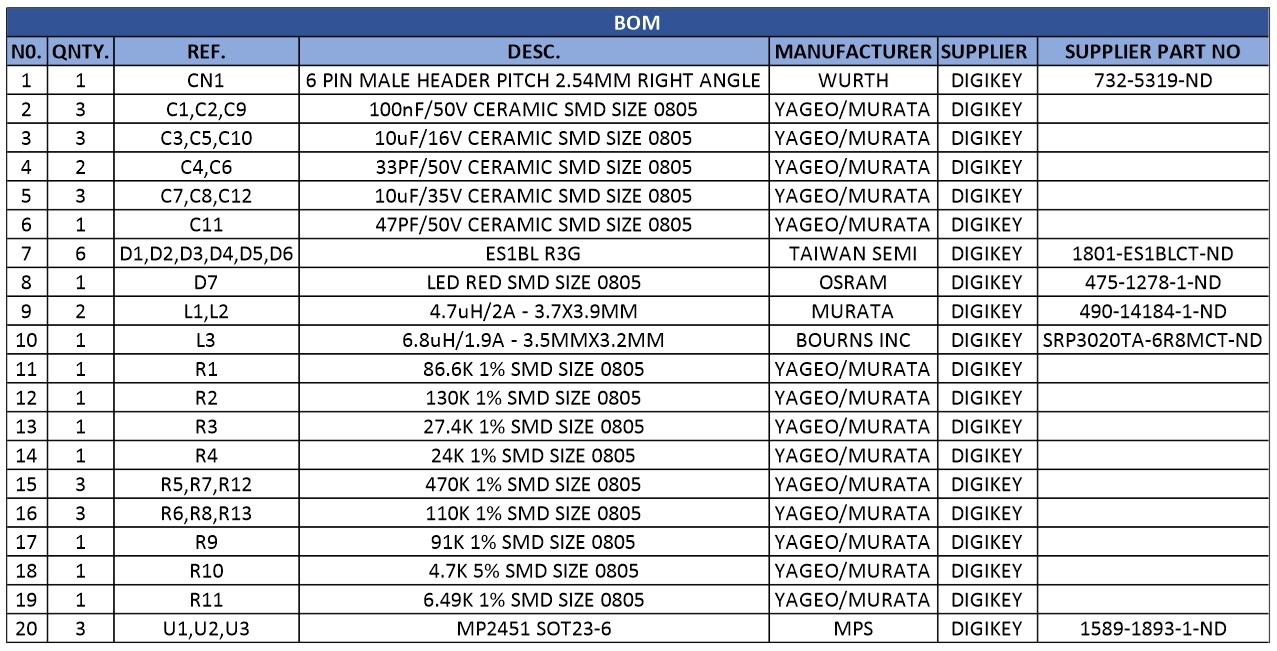

Parts List
| N0. | QNTY. | REF. | DESC. | MANUFACTURER | SUPPLIER | SUPPLIER PART NO |
| 1 | 1 | CN1 | 6 PIN MALE HEADER PITCH 2.54MM RIGHT ANGLE | WURTH | DIGIKEY | 732-5319-ND |
| 2 | 3 | C1,C2,C9 | 100nF/50V CERAMIC SMD SIZE 0805 | YAGEO/MURATA | DIGIKEY | |
| 3 | 3 | C3,C5,C10 | 10uF/16V CERAMIC SMD SIZE 0805 | YAGEO/MURATA | DIGIKEY | |
| 4 | 2 | C4,C6 | 33PF/50V CERAMIC SMD SIZE 0805 | YAGEO/MURATA | DIGIKEY | |
| 5 | 3 | C7,C8,C12 | 10uF/35V CERAMIC SMD SIZE 0805 | YAGEO/MURATA | DIGIKEY | |
| 6 | 1 | C11 | 47PF/50V CERAMIC SMD SIZE 0805 | YAGEO/MURATA | DIGIKEY | |
| 7 | 6 | D1,D2,D3,D4,D5,D6 | ES1BL R3G | TAIWAN SEMI | DIGIKEY | 1801-ES1BLCT-ND |
| 8 | 1 | D7 | LED RED SMD SIZE 0805 | OSRAM | DIGIKEY | 475-1278-1-ND |
| 9 | 2 | L1,L2 | 4.7uH/2A - 3.7X3.9MM | MURATA | DIGIKEY | 490-14184-1-ND |
| 10 | 1 | L3 | 6.8uH/1.9A - 3.5MMX3.2MM | BOURNS INC | DIGIKEY | SRP3020TA-6R8MCT-ND |
| 11 | 1 | R1 | 86.6K 1% SMD SIZE 0805 | YAGEO/MURATA | DIGIKEY | |
| 12 | 1 | R2 | 130K 1% SMD SIZE 0805 | YAGEO/MURATA | DIGIKEY | |
| 13 | 1 | R3 | 27.4K 1% SMD SIZE 0805 | YAGEO/MURATA | DIGIKEY | |
| 14 | 1 | R4 | 24K 1% SMD SIZE 0805 | YAGEO/MURATA | DIGIKEY | |
| 15 | 3 | R5,R7,R12 | 470K 1% SMD SIZE 0805 | YAGEO/MURATA | DIGIKEY | |
| 16 | 3 | R6,R8,R13 | 110K 1% SMD SIZE 0805 | YAGEO/MURATA | DIGIKEY | |
| 17 | 1 | R9 | 91K 1% SMD SIZE 0805 | YAGEO/MURATA | DIGIKEY | |
| 18 | 1 | R10 | 4.7K 5% SMD SIZE 0805 | YAGEO/MURATA | DIGIKEY | |
| 19 | 1 | R11 | 6.49K 1% SMD SIZE 0805 | YAGEO/MURATA | DIGIKEY | |
| 20 | 3 | U1,U2,U3 | MP2451 SOT23-6 | MPS | DIGIKEY | 1589-1893-1-ND |

Hi Mike,
Thank you for sharing the power supply you listed on the Electronics-Lab website. I want to use this power supply in my project, and I want to know if the Gerber on this page can be useful? Because when I download it, the file format is different (SVG). Those files should be named: “Gerber,” “RS-274X,” “fabrication files,” “CAM,” “manufacturing ZIP,” and “.gbr/.gtl/.gbl/.gko/.drl”. But I didn’t find them on the page. I want to know how to get the actual Gerber file for this PCB. You put everything on this page, and it is very easy to draw it and make a PCB on Altium or any PCB software. But I want to save my time if it is possible to get the real Gerber file. I appreciate your help, thanks.
check this file: https://www.electronics-lab.com/wp-content/uploads/2024/11/GERBER.zip
