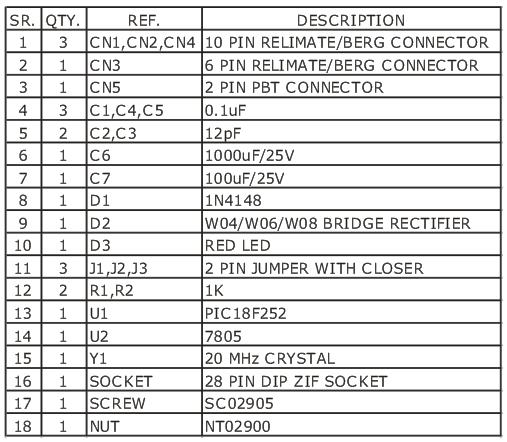

Parts List
PIC_18F_28_PIN_PIC_Development_Board_BOM
