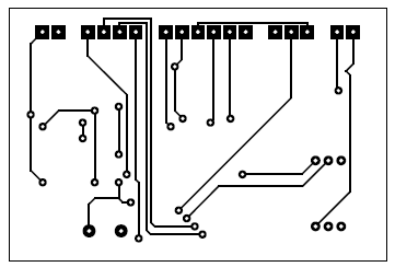

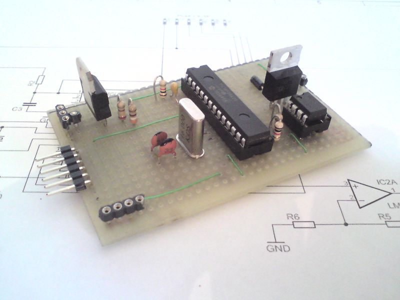

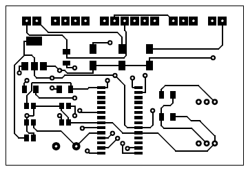

photo_02
Photo of the prototype on perfboard
Schematic
Schematic
