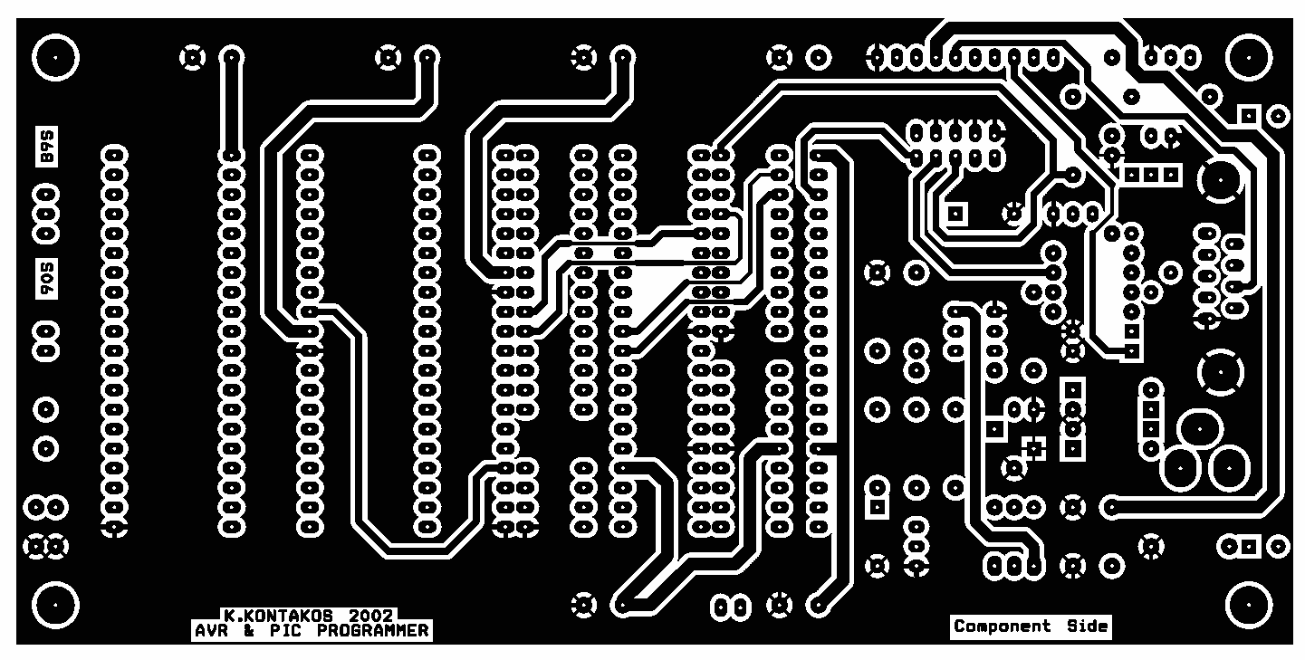

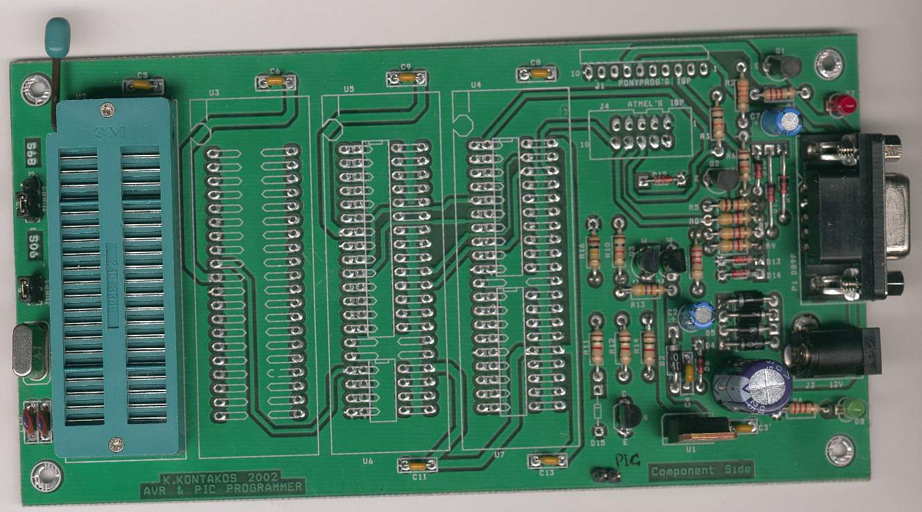

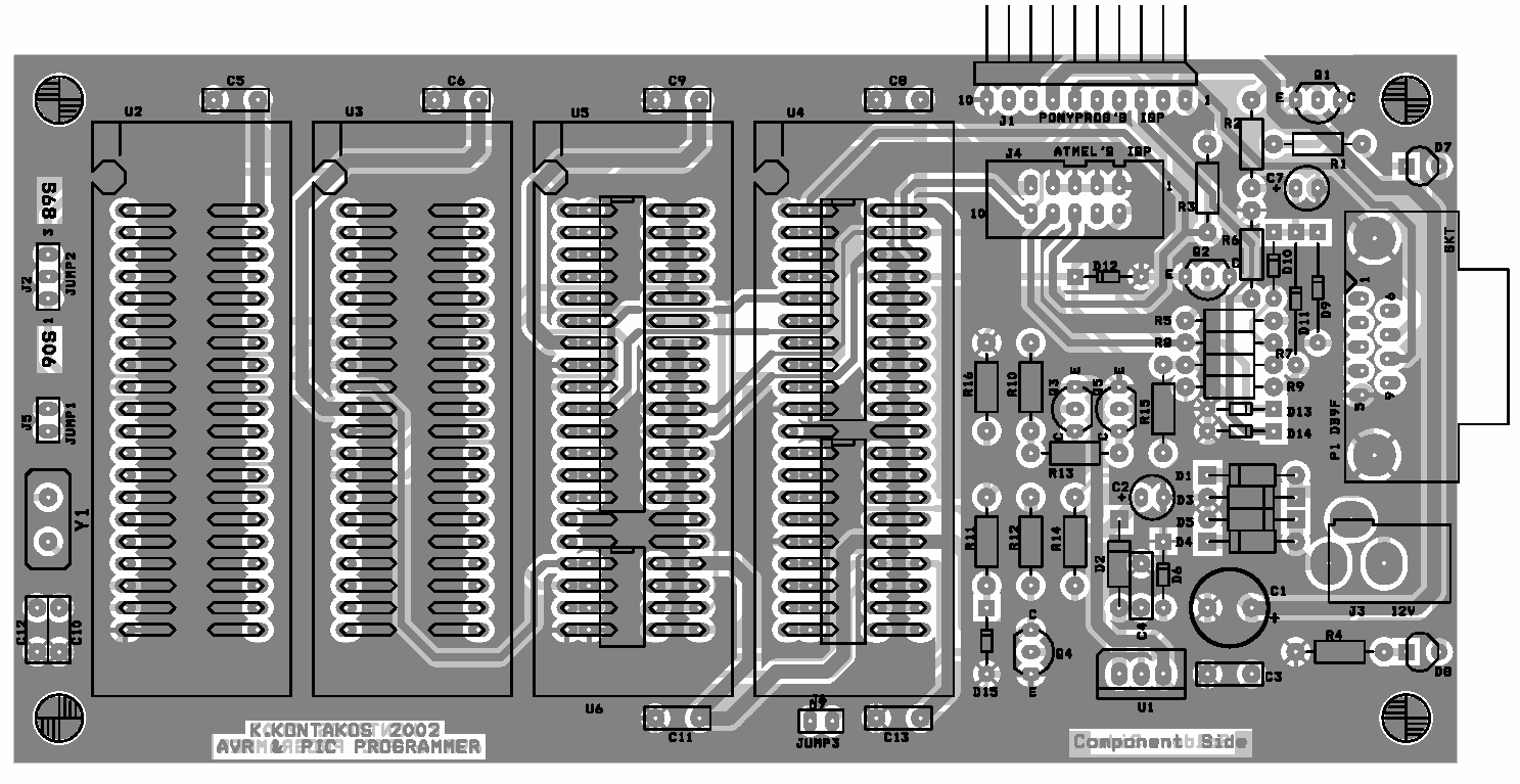

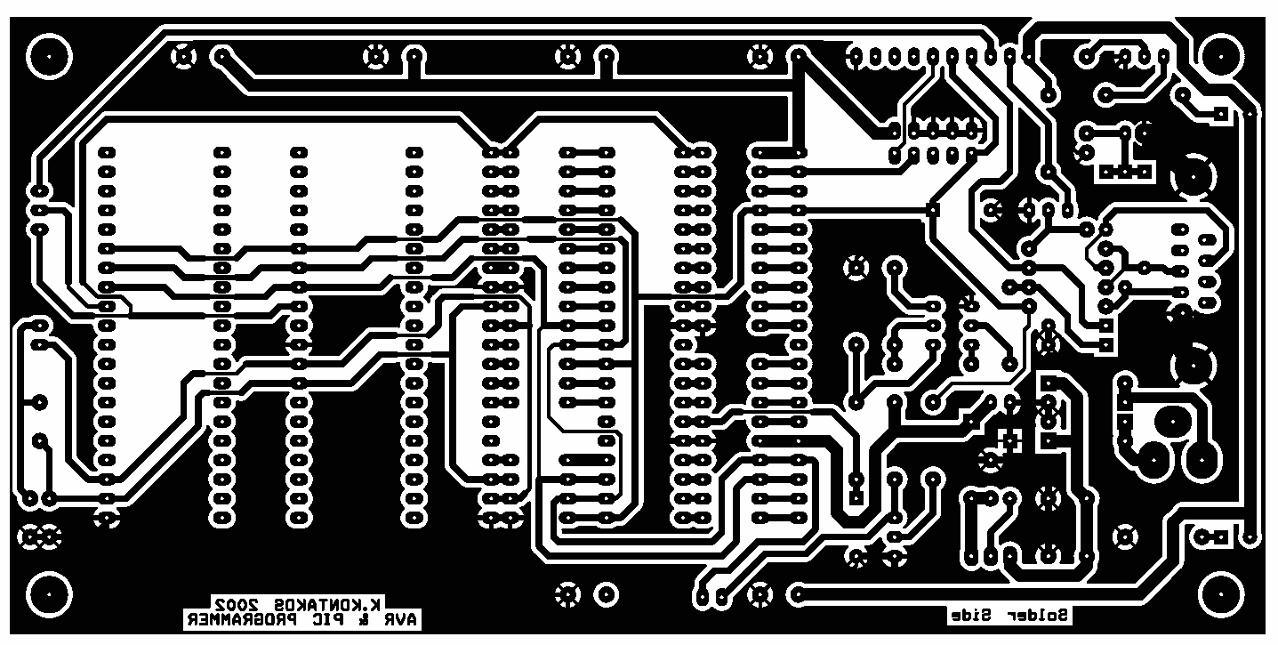

‘PIC JUMP’ is used to switch between Microchip’s PIC and ATMEL’s microcontrollers. With jumper ON only PIC can be programmed, while OFF can program ATMEL’s microcontrollers. If you don’t need to program PICs, you can leave their board area unsoldered. The PCB has been designed so that DIP sockets or ZIF sockets can be used. Because of its cost, it is recommended that only one ZIF is used combined with some pin-arrays to switch between the four different places.
The board must be connected to a PC COM port through a 9 pin to pin cable and work with the below application:
