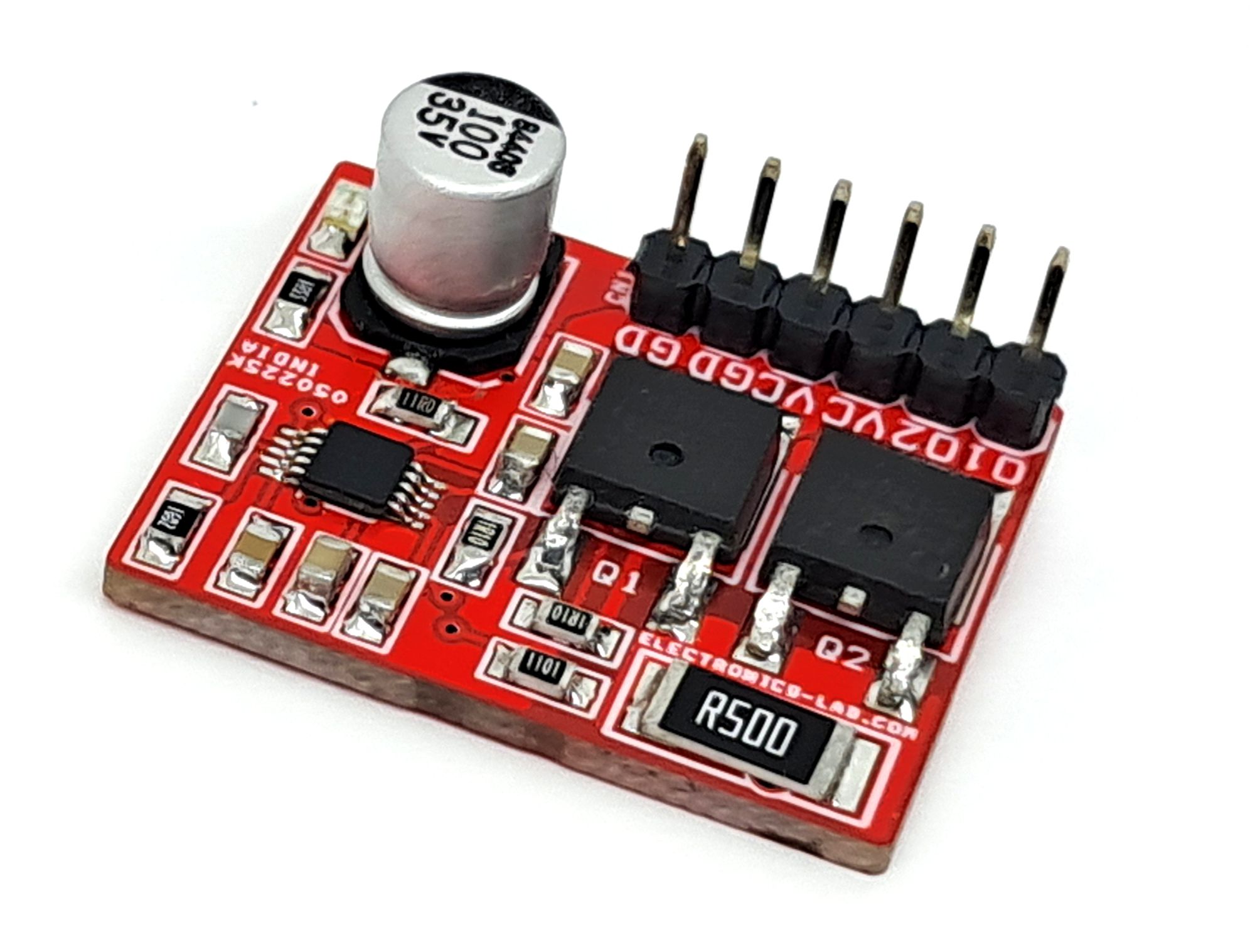

This project is a simple, low-voltage push-pull PWM controller using the TI LM5032 chip and two MOSFETs. It's suitable for applications like DC-DC converters or Tesla Coil drivers. Frequency, current sensing, and soft start are configured via external components.
This is a simple low voltage push-pull voltage mode PWM controller based on LM5032 chip from TI. The board is build around LM5032 chip and two 100V 7A MOSFETs. It can be used in simple DC-DC converter, Tesla Coil Driver etc. The frequency can be changed with resistor R5. Resistor R7 play roll of current sense. Capacitor C4 configures the soft start function. Output is square wave open drain.
Frequency Selection
- R5 16K Ohm = Frequency 339Khz
- R5 8.2K Ohm = Frequency 600Khz
- R5 26.7K Ohm = Frequency 200Khz
- Power Supply 15V to 30V DC
- Maximum Load 1A (MOSFET 7A)
- Operating Frequency 339Khz
- Thermal Shutdown
- Over Current Protection 1A
- PCB Dimensions 27.31 x 21.75 mm

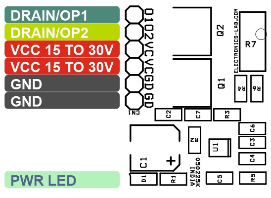

CN1: Pin 1,2= GND, Pin 3,4 = +Power, Pin 5 = Drain/Output2, Pin 6 = Drain/Output1
