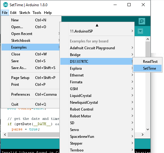

Before we start we have to download RTC library and set its time. The required library is available at github. Download it and extract it into Arduino libraries folder, then open Arduino IDE and from examples choose ‘setTime’ from DS1307 library. Finally upload it while the RTC module is connected with Arduino, and it will set its time as the computer time.
