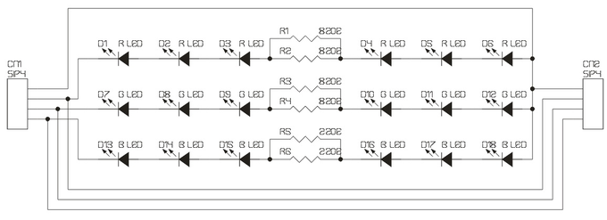

Schematic
RGB_LED_Based_Disco_Lights_main_board_schematic
RGB_LED_Based_Disco_Lights_LED_Board_Schematic_th

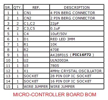

Parts List
RGB_LED_Based_Disco_Lights_main_board_BOM
