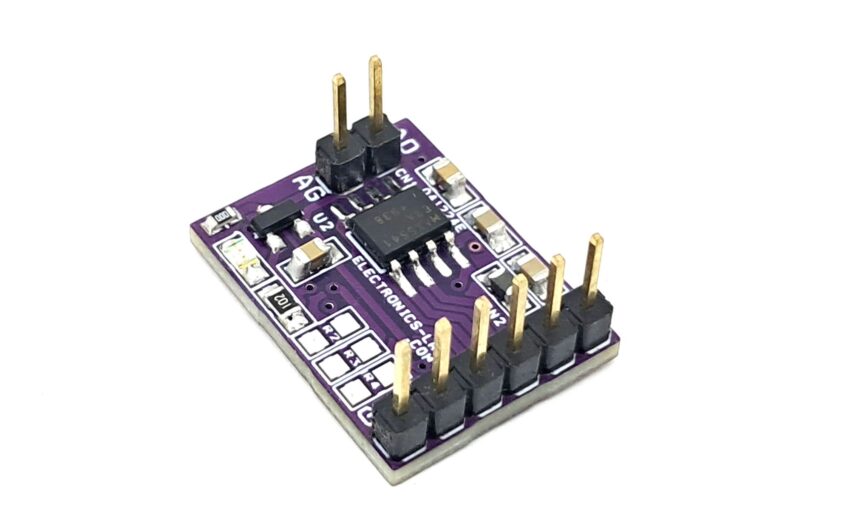

- Power Supply 5V DC
- Full 16-Bit Performance Without Adjustments
- Low Power: 1.5mW
- 1µs Settling Time
- On Bord Ref-Voltage Chip Output 2.5V (REF3025)
- Unbuffered Voltage Output Directly Drives 60kΩ Loads
- SPI/QSPI/MICROWIRE-Compatible Serial Interface
- Power-On Reset Circuit Clears DAC Output to 0V (unipolar mode)
- Schmitt Trigger Inputs for Direct Optocoupler Interface
- Header Connector for Serial Interface and output
- On Board Power LED
- PCB Dimensions: 20.85 x 15.92 mm

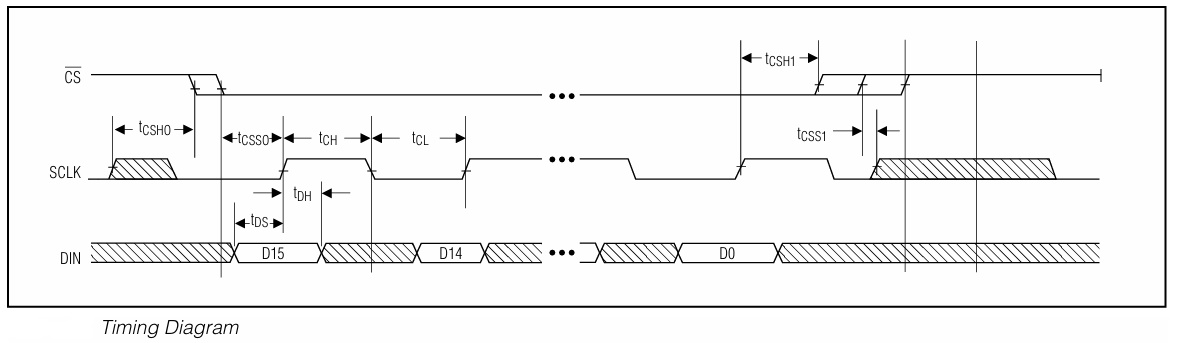

Digital Interface
The MAX5541 digital interface is a standard 3-wire connection compatible with SPI/QSPI/MICROWIRE interfaces. The chip-select input (CS) frames the serial data loading at the data input pin (DIN). Immediately following CSs high-to-low transition, the data is shifted synchronously and latched into the input register on the rising edge of the serial-clock input (SCLK). After 16 data bits have been loaded into the serial input register, it transfers its contents to the DAC latch on CSs low-to-high transition (Figure 2). Note that if CS does not remain low during the entire sixteen SCLK cycles, data will be corrupted. In this case, reload the DAC latch with a new 16-bit word.

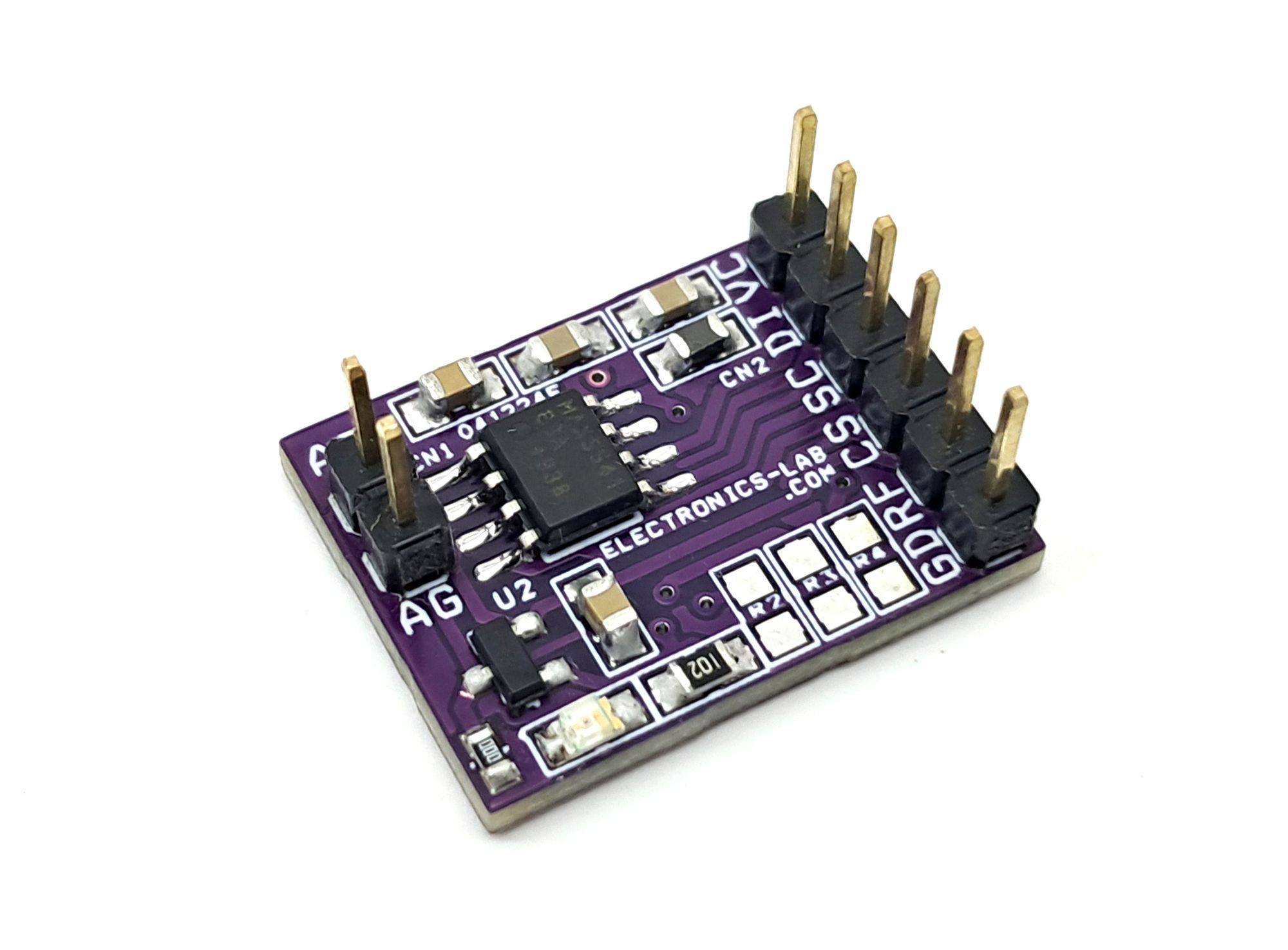

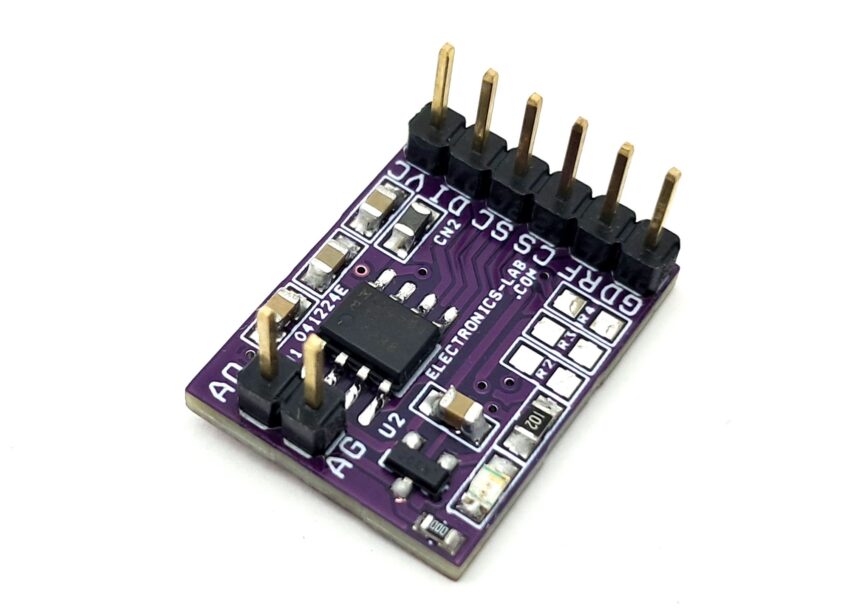

Connections
- CN1 DAC (Analog Output): Pin 1 = Analog Voltage Output, Pin 2 = Analog GND
- CN2 Interface & Power: Pin 1 = VCC 5V DC, Pin 2 = DIN, Pin 3 = SCLK, Pin 4 = CS, Pin 5 = Reference Output 2.5V, Pin 6 = GND
- D1: Power LED
