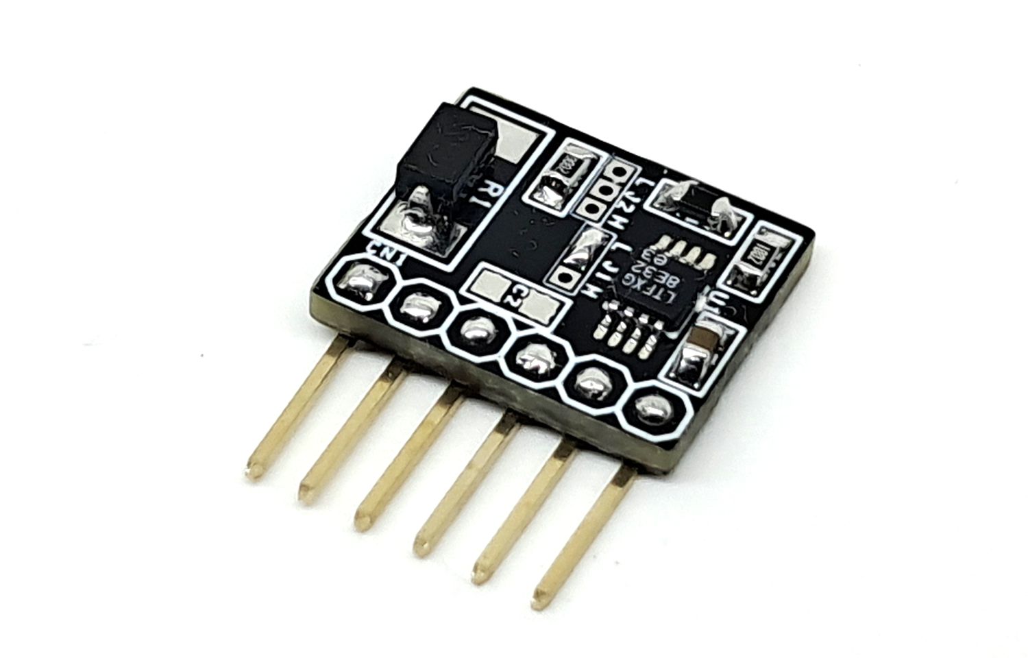

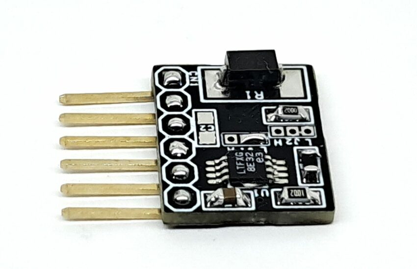

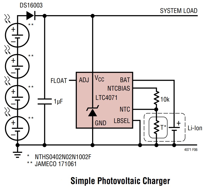

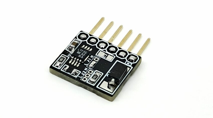

A simple photovoltaic (PV) to Li-On battery charger project is described here. At low VCC voltage, PV current flows to both the system at VCC and the battery.

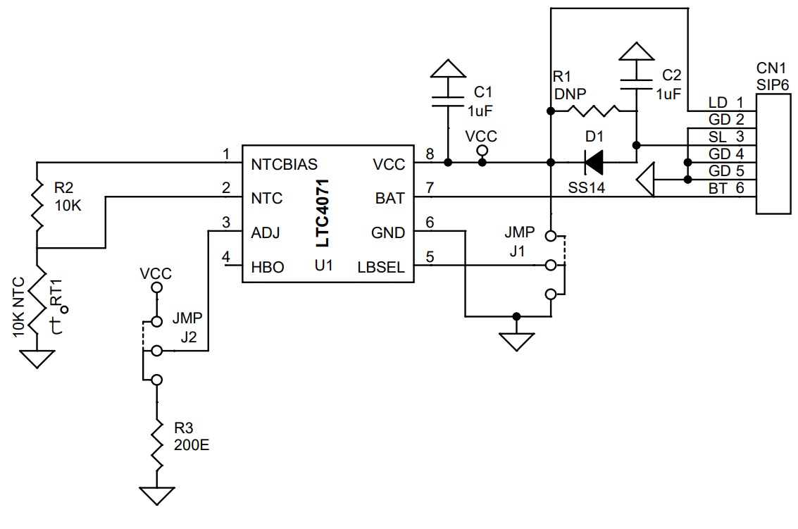

A simple photovoltaic (PV) to Li-On battery charger project is described here. At low VCC voltage, PV current flows to both the system at VCC and the battery. When VCC reaches the programmed float voltage (4.1V with ADJ floating), the LTC4071 shunts excess current not used by the load, limiting VCC to 4.1V and effectively reducing the battery charge current to zero. If the PV cells stop supplying current, the battery supports the load at VCC through the LTC4071. A diode in series with the PV cells prevents reverse leakage of the PV cells from draining the battery. If the battery discharges to the point where VCC falls below VLBD (3.2V with LBSEL tied to GND) – Jumper J1=GND the LTC4071 disconnects the load from the battery to protect the battery from over discharge. Typically, solar cells are inherently limited in current, but this circuit may require an external resistor in series with the LTC4071 input for high-current solar cells. Select a series resistor such that the LTC4071 never needs to shunt more than 50mA. Low Capacity, Li-Ion/Polymer Battery Back-Up, suitable for Thin Film Batteries.
- Input Solar Cell Up to 5V max – 50mA
- Li-on Battery Small Size

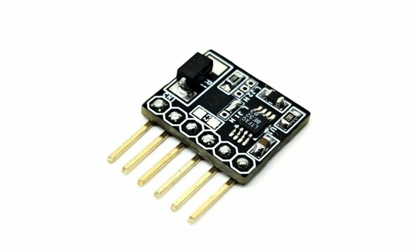

- On Board NTC for Battery Over Temperature Detection
- Header Connector for Battery, Solar Cell, and Load
- PCB Dimensions 15.88 x 13.34 mm

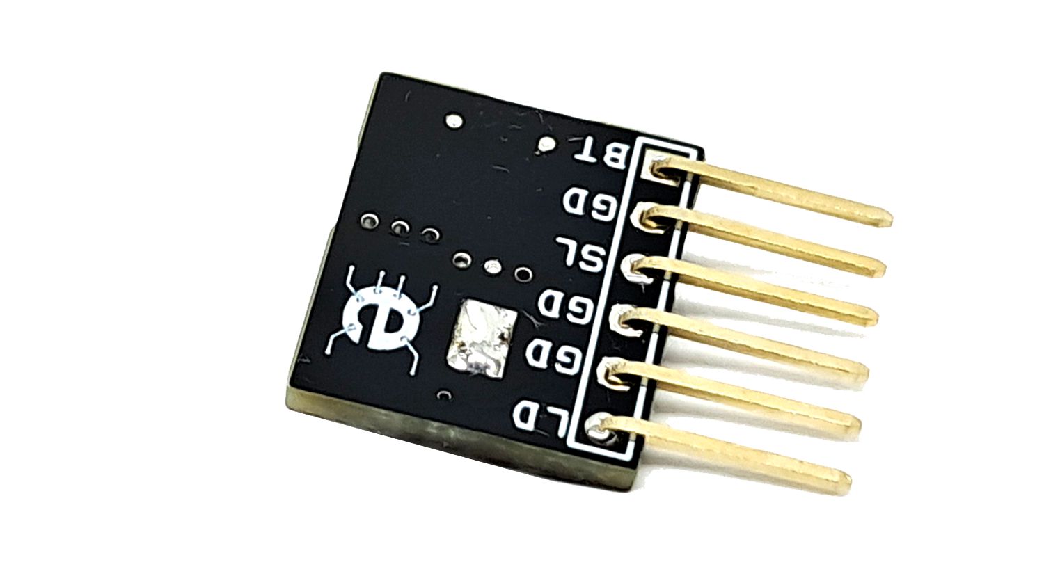

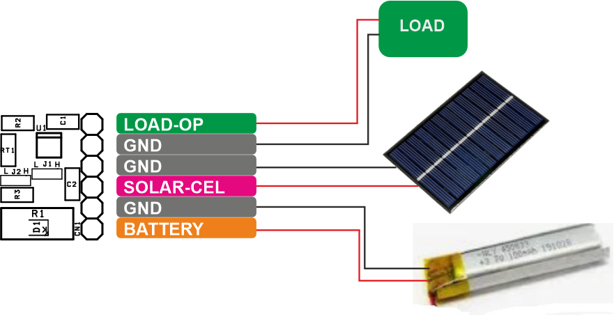

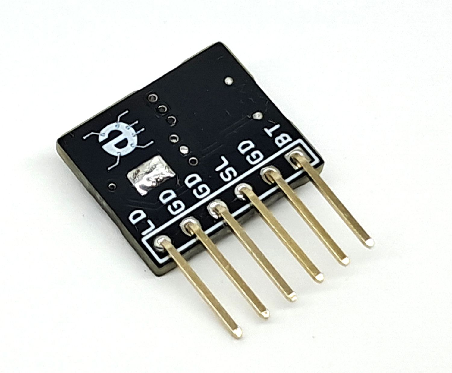

Connections CN1
- Pin 1 = + Load
- Pin 2 = GND
- Pin 3 = Solar Cell
- Pin 4 = GND
- PIN 5 = GND
- PIN 6 = Li-On Battery
- Jumper J1 = GND
- Jumper 2 No Use
Schematic
Parts List
| NO | QNTY. | REF. | DESC. | MANUFACTURER | SUPPLIER | SUPPLIER PART NO |
| 1 | 1 | CN1 | 6 PIN MALE HEADER PITCH 2.54MM | WURTH | DIGIKEY | 732-5339-ND |
| 2 | 2 | C1,C2 | 1uF/16V CERAMIC SMD SIZE 0805 | MURATA/YAGEO | DIGIKEY | |
| 3 | 1 | D1 | SS14 | SMC DIODE | DIGIKEY | 1655-SS14CT-ND |
| 4 | 2 | J1,J2 | JMP-SOLDER JUMPER | |||
| 5 | 1 | RT1 | 10K NTC | MURATA | DIGIKEY | 490-2456-1-ND |
| 6 | 1 | R1 | DNP | |||
| 7 | 1 | R2 | 10K 5% SMD SIZE 0805 | MURATA/YAGEO | DIGIKEY | |
| 8 | 1 | R3 | 200E 1% SMD SIZE 0805 | MURATA/YAGEO | DIGIKEY | |
| 9 | 1 | U1 | LTC4071 8MSOP | ANALOG DEVICE | DIGIKEY | 505-LTC4071EMS8E#PBF-ND |

Application Diagram
