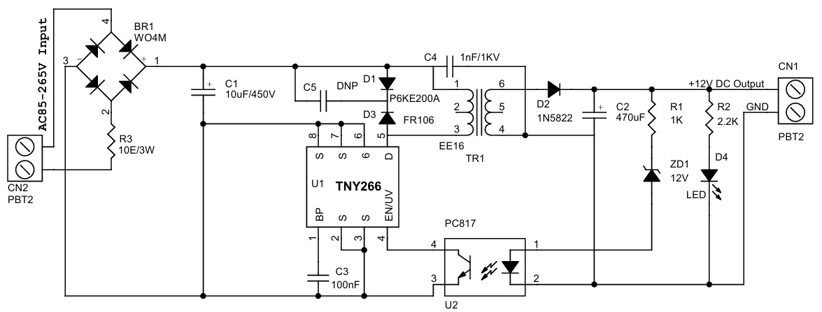

Simple SMPS, 85-265VAC Input with Output 12VDC @ 750mA

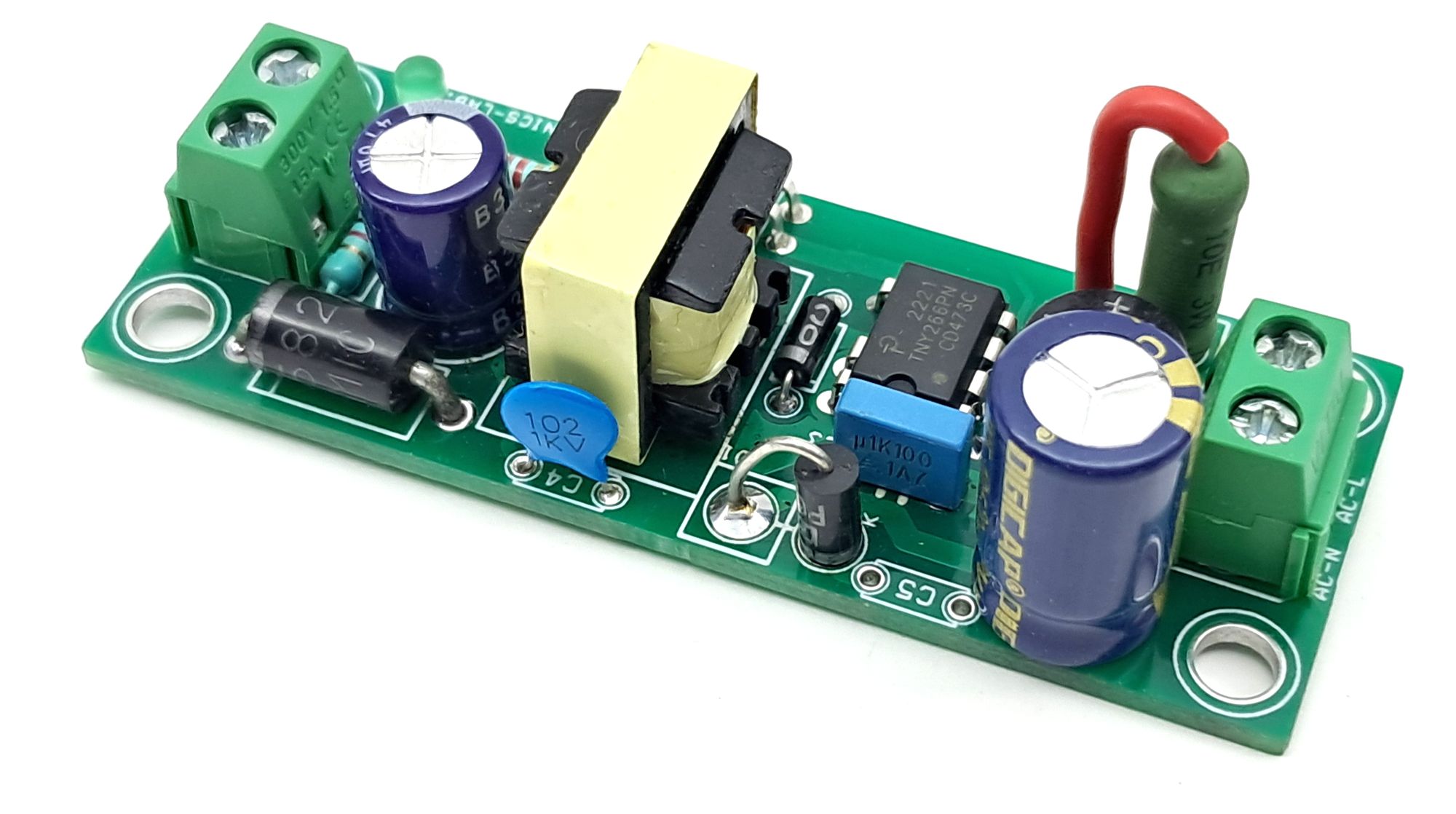

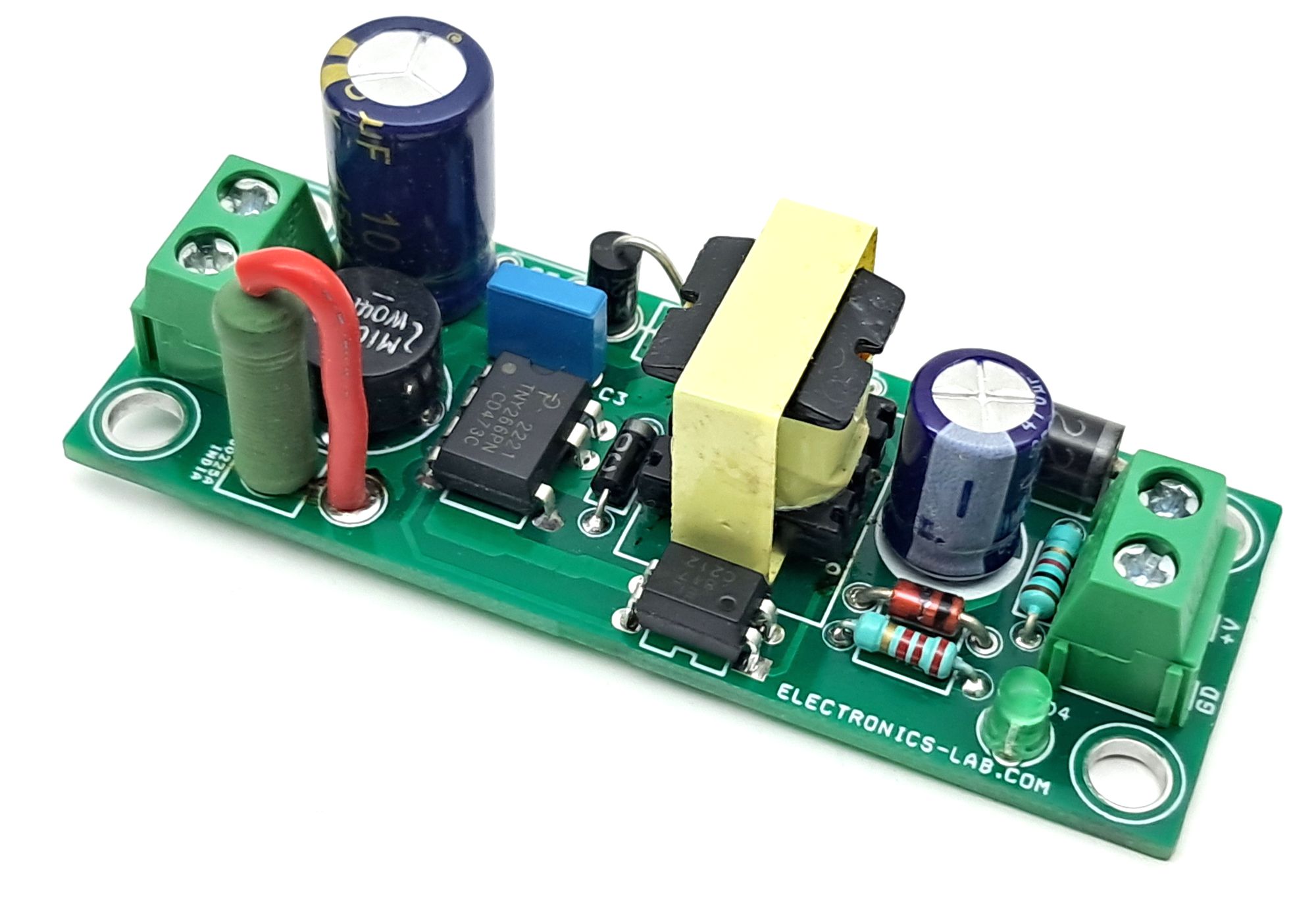

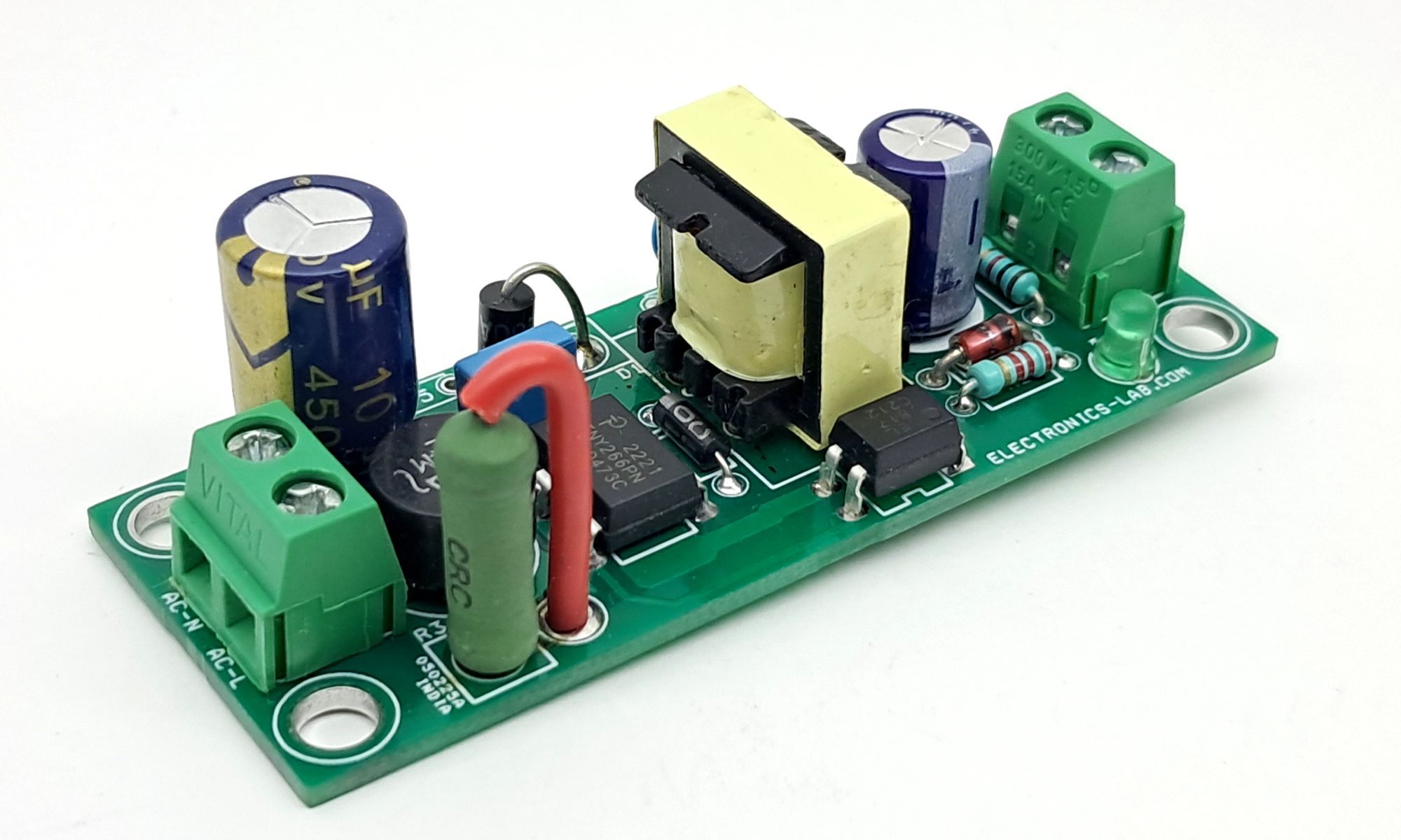

This is a compact Switch-Mode Power Supply (SMPS) using the TNY266 chip for cost-effective solutions like power adapters and LED drivers. It includes a rectifier, TNY266 switch, and PC817 optocoupler feedback. It requires no auxiliary power.
This compact Switch-Mode Power Supply (SMPS) is built around the TNY266 chip, offering a cost-effective solution for various applications, including power adapters and LED drivers. The SMPS consists of a bridge rectifier, a DC bus capacitor, the TNY266 switch IC, a rectifier diode, and a PC817 optocoupler for feedback and fault condition monitoring.
The board features screw terminals for easy connection of AC input and DC output, as well as an onboard LED indicator for output voltage. Notably, no auxiliary power is required to drive the chip, making it a highly efficient design.
A simple 4-pin transformer is used, which can be readily sourced from online marketplaces such as AliExpress and eBay. This makes it an ideal solution for DIY enthusiasts and professionals alike, looking for a reliable and affordable SMPS solution.
- Power Input 85-265V AC
- Output 12V, 750mA (Output +/-5%)
- Screw Terminals for AC Input and DC Output
- Operating Switching Frequency 132Khz
- 4 x 4 mm Mounting Holes
- PCB Dimensions 69.06 x 25.88 mm
Transformer
- Primary winding 0.8mH, Turn ratio 90:10
- Magnetic Core EE16, with 6Pin Bobin, Pin 1, 3 + 4,6 (Pin 2, Pin 5 NC)
- Primary 4 in 6 out, 90T, 0.2mm, 0.8mH inductance
- Secondary 1 in 3 out, 11T, 0.5mmx2 double-wire winding

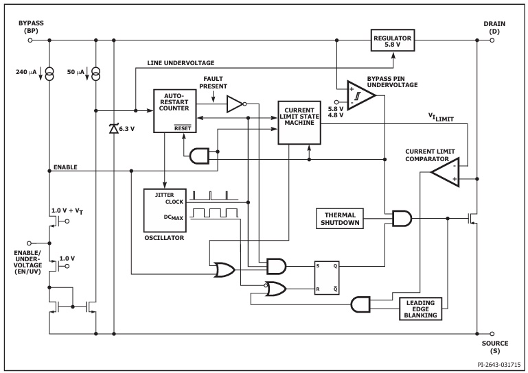

Tiny Switch™-II integrates a 700 V power MOSFET, oscillator, high voltage switched current source, current limit and thermal shutdown circuitry onto a monolithic device. The start-up and operating power are derived directly from the voltage on the DRAIN pin, eliminating the need for a bias winding and associated circuitry. In addition, the Tiny Switch-II devices incorporate auto-restart, line undervoltage sense, and frequency jittering. An innovative design minimizes audio frequency components in the simple ON/OFF control scheme to practically eliminate audible noise with standard taped/varnished transformer construction.
The fully integrated auto-restart circuit safely limits output power during fault conditions such as output short circuit or open loop, reducing component count and secondary feedback circuitry cost. An optional line sense resistor externally programs a line undervoltage threshold, which eliminates power down glitches caused by the slow discharge of input storage capacitors present in applications such as standby supplies. The operating frequency of 132 kHz is jittered to significantly reduce both the quasi-peak and average EMI, minimizing filtering cost.

Connections

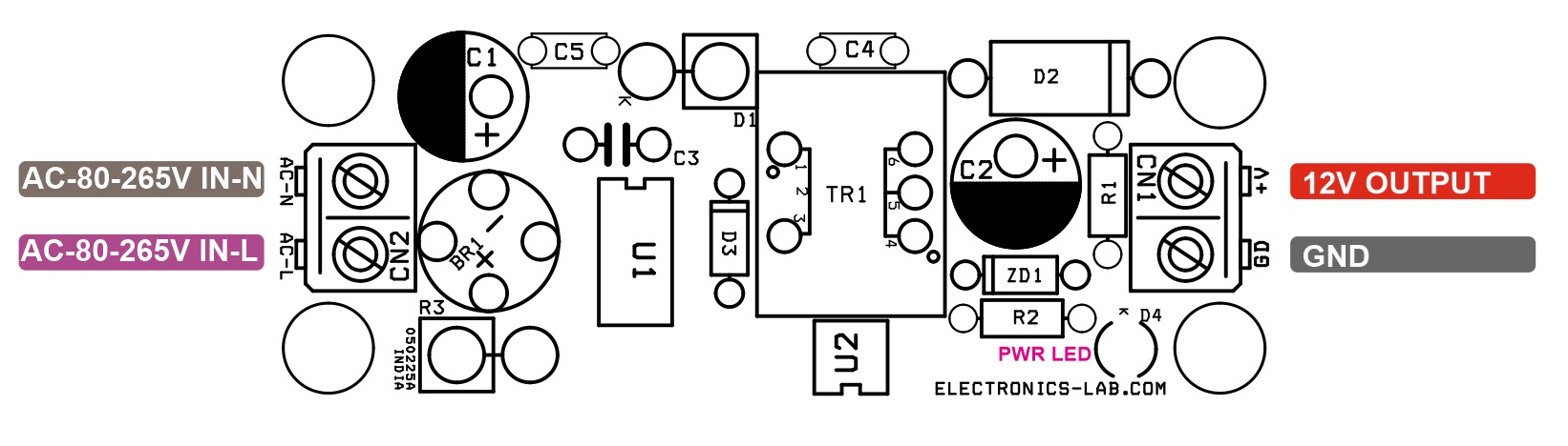

- CN1: Pin 1 = +12V DC Output, Pin 2 = GND
- CN2: Pin 1 = AC-L Input, Pin 2 = AC-N Input, (AC 85-265V Input)
- D1: Power LED
Schematic
Parts List
| NO. | QNTY. | REF. | DESC | MANUFACTURER | SUPPLIER | SUPPLIER PART NO |
| 1 | 1 | BR1 | W04M 400V,1A BRIDGE RECTIFIER | LUMIMAX | DIGIKEY | 4491-W04M-ND |
| 2 | 2 | CN1,CN2 | 2 PIN SCREW TERMINAL PITCH 5.08MM | PHOENIX | DIGIKEY | 277-1247-ND |
| 3 | 1 | C1 | 10uF/450V ELECTROLYTIC | RUBYCON | DIGIKEY | 1189-1894-ND |
| 4 | 1 | C2 | 470uF/25V ELECTROLYTIC | WURTH | DIGIKEY | 732-8831-3-ND |
| 5 | 1 | C3 | 100nF/63V THT | EPCOS | DIGIKEY | 495-B32529C0104J289CT-ND |
| 6 | 1 | C4 | 1nF/1KV THT | TDK | DIGIKEY | 445-175507-ND |
| 7 | 1 | C5 | DNP | |||
| 8 | 1 | D1 | P6KE200A | LITTLE FUSE | DIGIKEY | P6KE200ALFTR-ND |
| 9 | 1 | D2 | 1N5822 OR 1N5819 | ST | DIGIKEY | 497-11370-1-ND |
| 10 | 1 | D3 | FR106 | SMC DIODE | DIGIKEY | 1655-FR106TB-ND |
| 11 | 1 | D4 | LED 3MM | DIGIKEY | ||
| 12 | 1 | R1 | 1K/5% 1/4W | YAGEO | DIGIKEY | |
| 13 | 1 | R2 | 2.2K 5% 1/4W | YAGEO | DIGIKEY | |
| 14 | 1 | R3 | 10E/3W | YAGEO | DIGIKEY | 10AXCT-ND |
| 15 | 1 | TR1 | EE16 SMPS TRANSFORMER | ALIEXPRESS | DIGIKEY | |
| 16 | 1 | U1 | TNY266 | POWER INTEGRATIONS | DIGIKEY | 596-1051-5-ND |
| 17 | 1 | U2 | PC817 | SHARP | DIGIKEY | PC817X2NSZ9F-ND |
| 18 | 1 | ZD1 | 12V/1W ZENER DIODE/1N4742A | NEXPERIA | DIGIKEY | 1727-2762-2-ND |

TNY266 Block Diagram

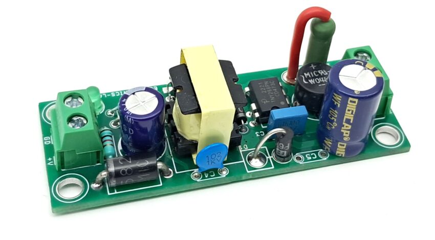

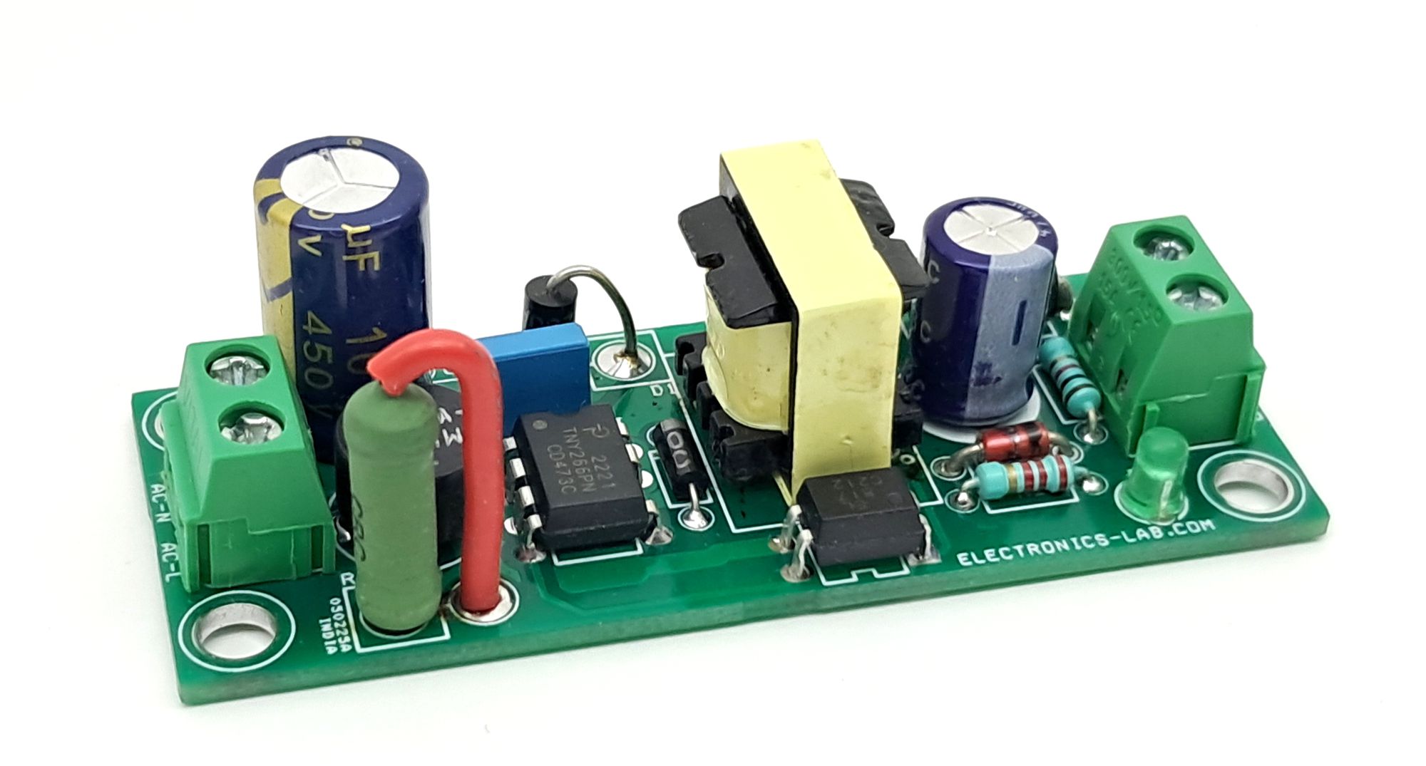

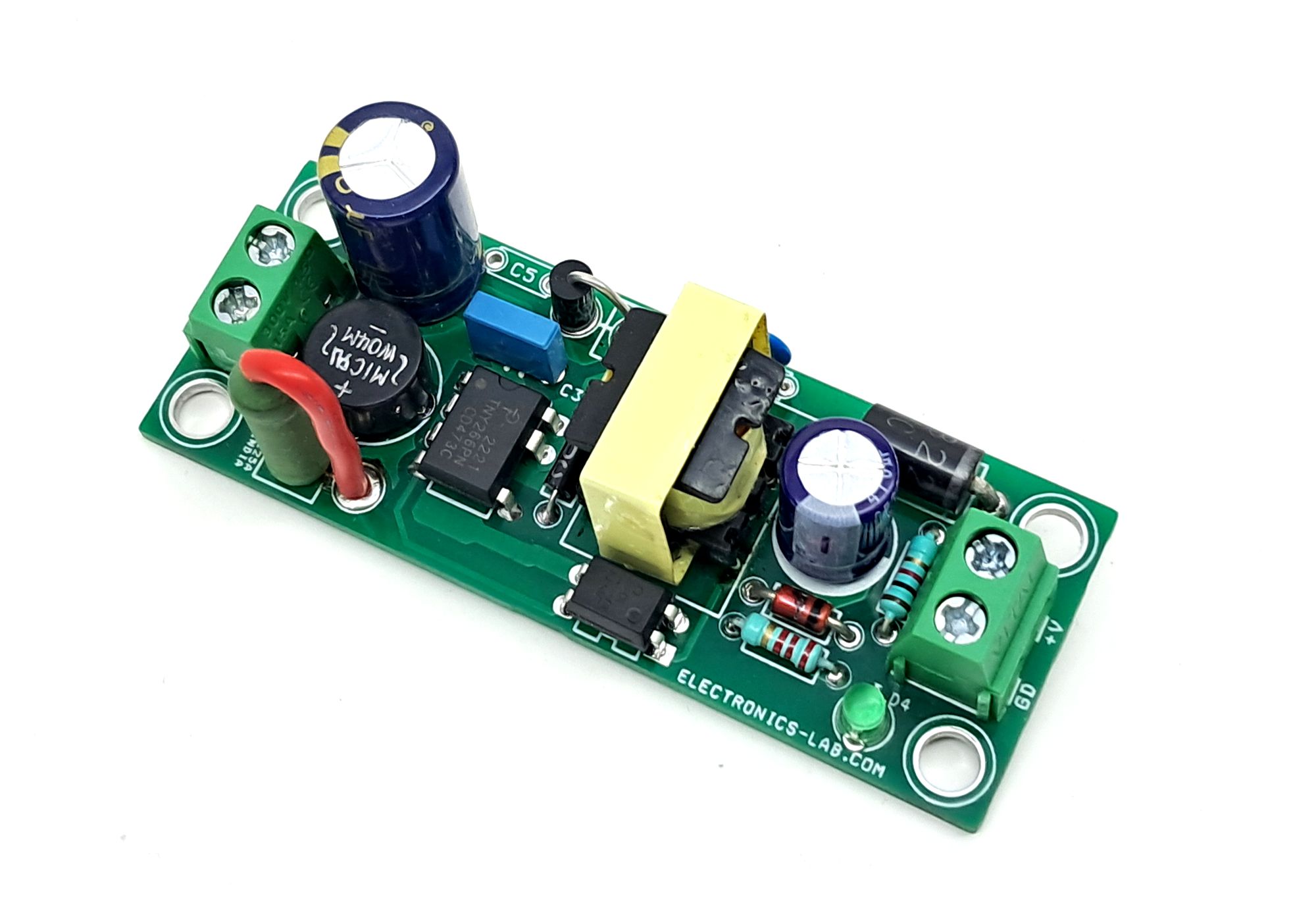

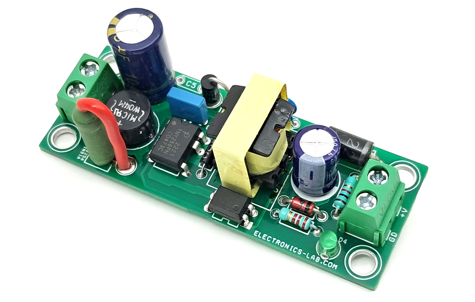

Photos
