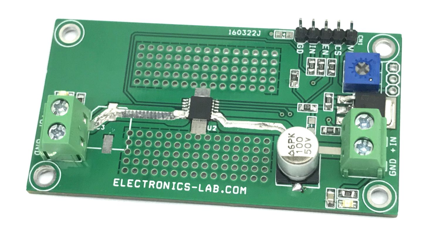

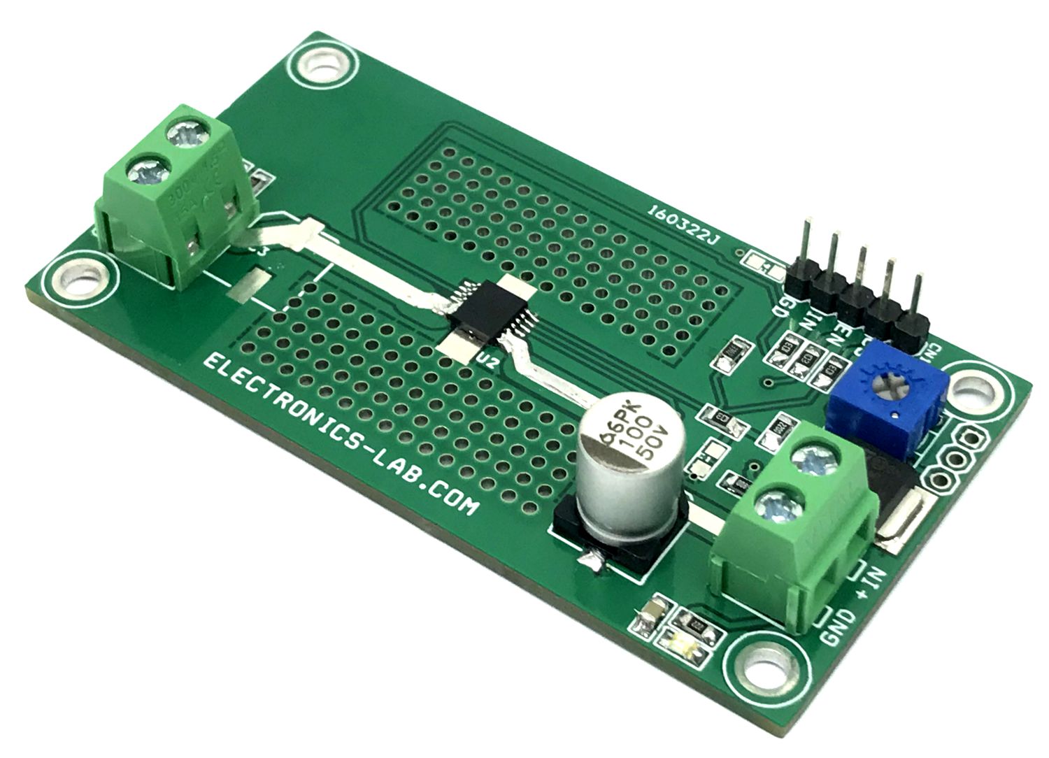

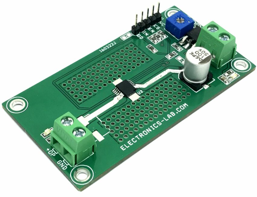

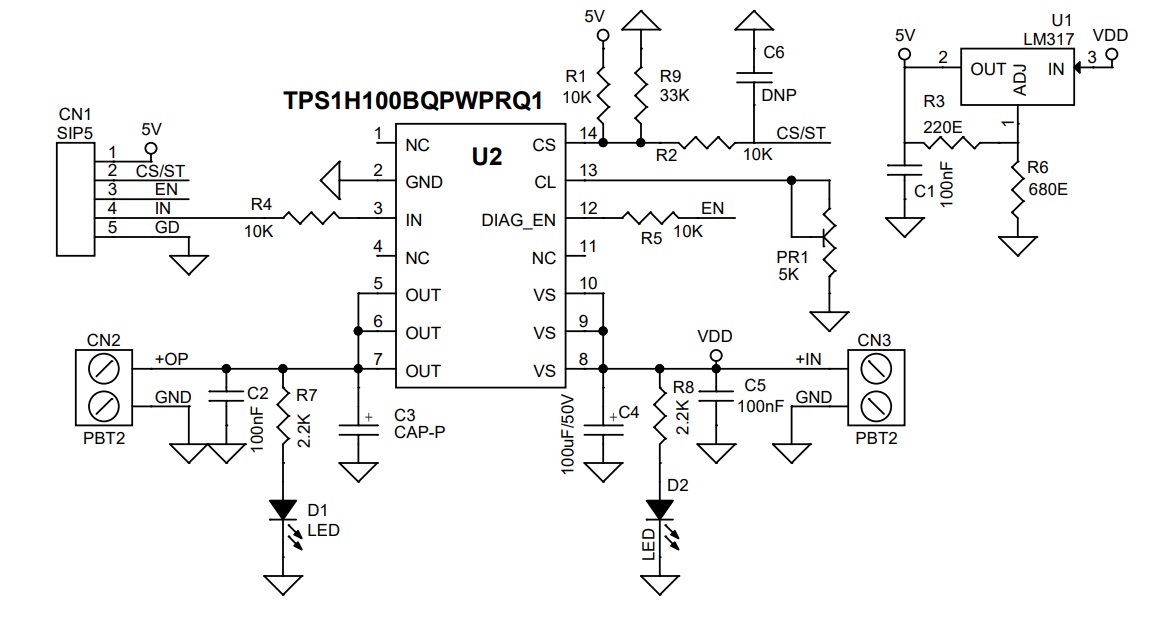

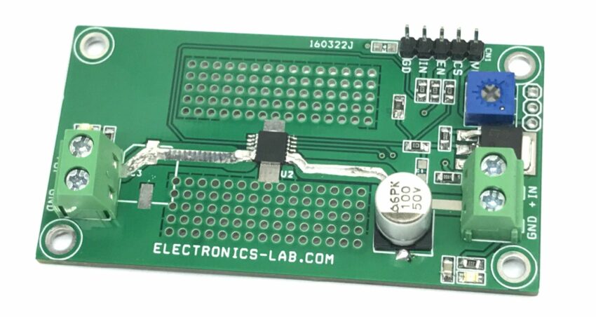

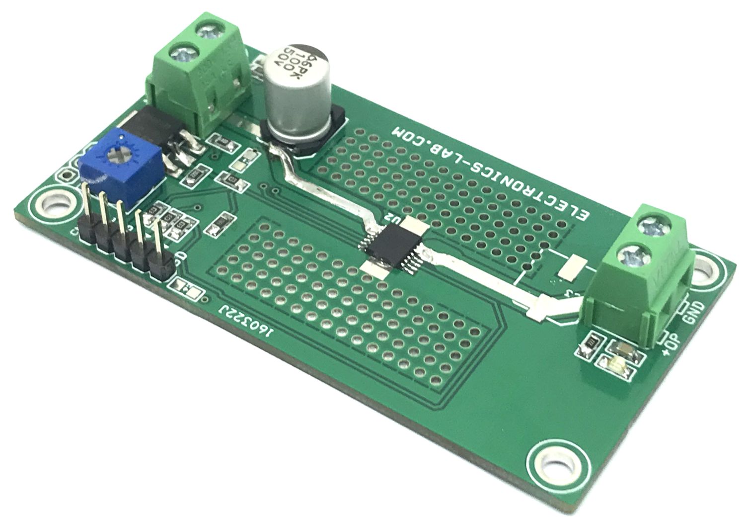

The project can be used as a high-side power switch for a wide variety of resistive, inductive, and capacitive loads, including low-wattage bulbs, LEDs, relays, solenoids, and heaters. CL (Current Limit) resistor can be changed through PR1 Trimmer potentiometer. When PR1 is 0 Ohm there is no external current limit function and the internal current limit is active. This current limit value is around 0.5A.
- Operating voltage 5 to 37V (Limited Due to L317 Input Supply)
- Current Limit Adjustable 0.5A to 5Amps (PR1 Trimmer Potentiometer)
- Operating junction temperature: –40ºC to 150ºC
- Very-low standby current: <1 µA
- Microcontroller input control: 3.3-V and 5-V logic compatible
- High-accuracy current sense – Analog current output as a ratio of the output current (3% at nominal load and 20% at light load)
- Programmable current limit with external Trimmer Potentiometer PR1
- High-accuracy current sense, ±30 mA at 1 A, ±4 mA at 5 mA
- PCB Dimensions 73.50 x 39.05 mm
- 4 x 3 mm Mounting Holes

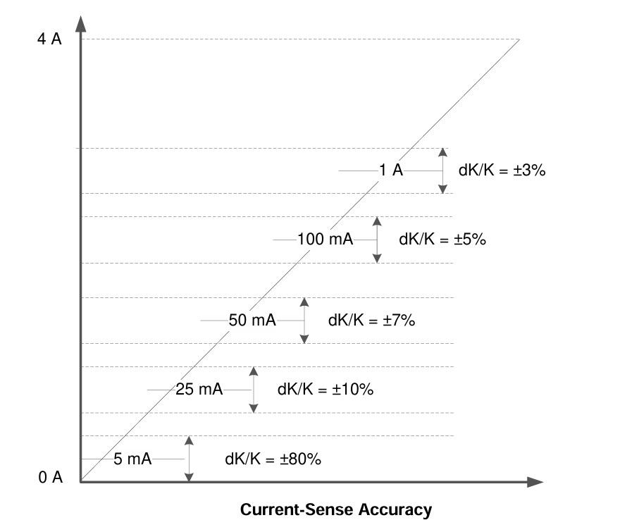

Accurate Current Sense
High-accuracy current sense signal allows better real-time monitoring of effects and more accurate diagnostics without further calibration. It provides the real-time output current monitoring. Accurate Current mirror is used to source 1/K of the load current, and reflected as VCS=ICS×RCS. Voltage level at CS pin is maintend within limit of 0 to 4V for normal operations Also, when a fault condition happens, it works as a diagnostics report pin. When an open load/short to battery event happens in on-state, VCS almost equals to 0. When a current limit, thermal shutdown/swing, open load/short to battery event in off-state happens, the voltage is clamped at VCS, H

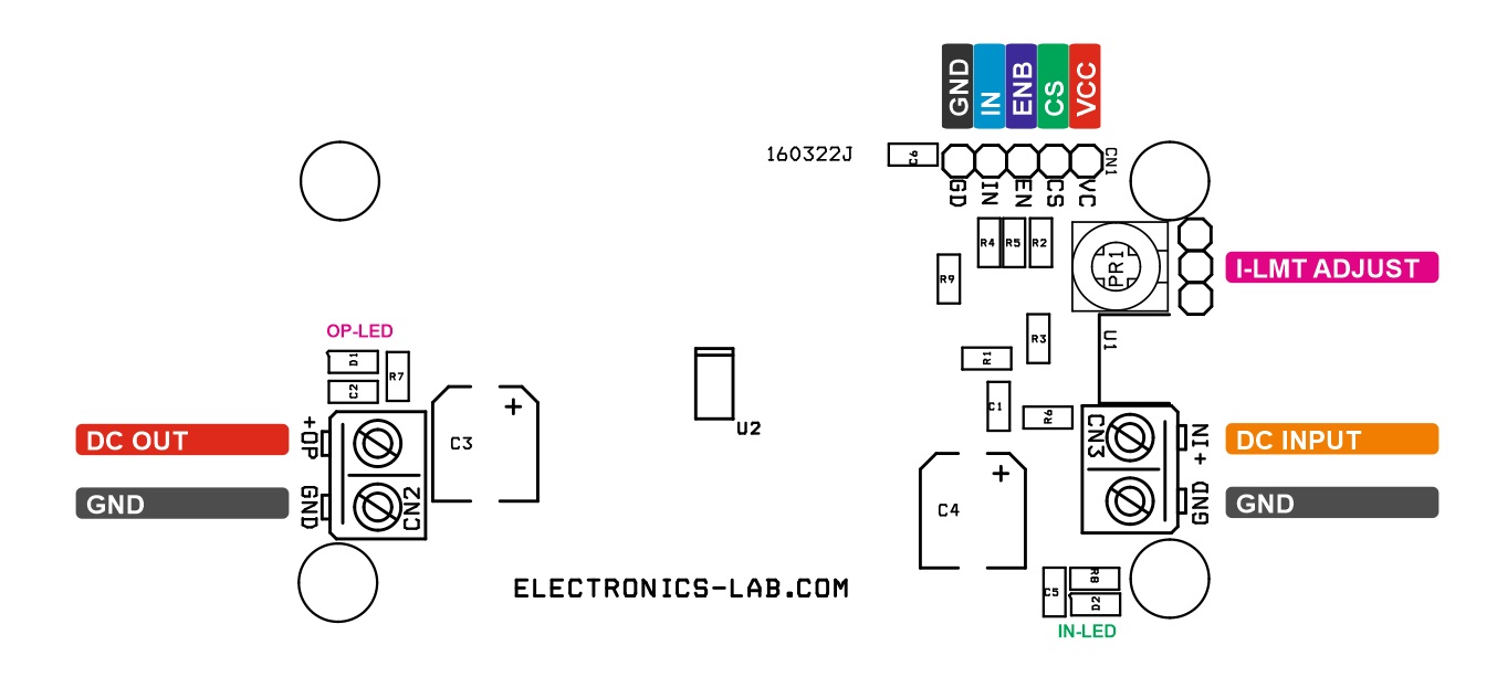

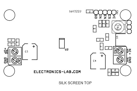

Connections
- CN1: Pin 1 = 5V DC Output, Pin 2 = CS, Pin 3 Enable, Pin 4 = Input, Pin 5 = GND
- CN2: Pin 1 = Voltage Output, Pin 2 = GND
- CN3: Pin 1 = Voltage Input, Pin 2 = GND
- D1: Output LED
- D2: Input LED
- PR1: Current Limit Trimmer Potentiometer
Schematic
