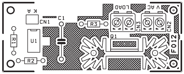

Description Solid State Relay Switch is a simple kit which will help you control (ON / OFF) a single high power circuit from a low power drive. Load - 24 to 240 VAC @ 500 W Trigger voltage - 2 to 5 VDC (TTL) @ 10 mA Input isolated with use of Optocoupler Power Battery Terminal (PBT) for easy input 230 VAC mains and load connection Terminal pins for connecting input trigger signal Heatsink for TRIAC Four mounting holes of 3.2 mm each PCB dimensions 29 mm x 74 mm Schematic Parts List
Description
  • Load – 24 to 240 VAC @ 500 W
  • Trigger voltage – 2 to 5 VDC (TTL) @ 10 mA
  • Input isolated with use of Optocoupler
  • Power Battery Terminal (PBT) for easy input 230 VAC mains and load connection
  • Terminal pins for connecting input trigger signal
  • Heatsink for TRIAC
  • Four mounting holes of 3.2 mm each
  • PCB dimensions 29 mm x 74 mm

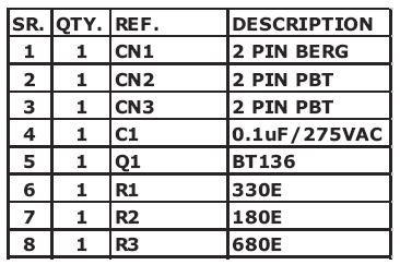

Parts List
parts
