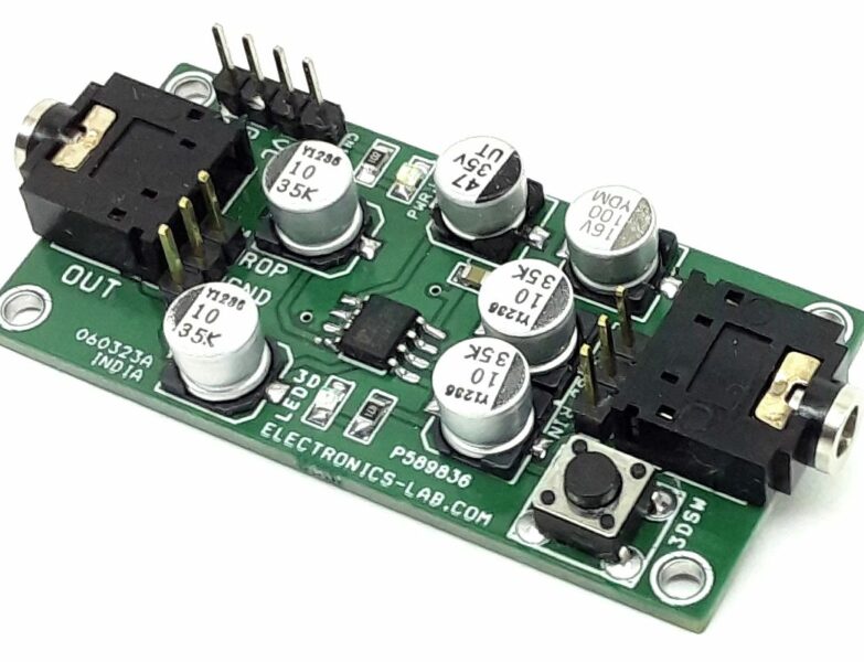

This project is a sound activated switch. Description Clap switch/Sound-activated switch designed around op-amp, flip-flop and popular 555 IC.
Description
Clap switch/Sound-activated switch designed around op-amp, flip-flop and popular 555 IC. Switch avoids false triggering by using 2-clap sound. Clapping sound is received by a microphone, the microphone changes the sound wave to electrical wave which is further amplified by op-amp.
555 timer IC acts as mono-stable multi-vibrator then flip-flop changes the state of output relay on every two-clap sound. This can be used to turn ON/OFF lights and fans. Circuit activates upon two-clap sound and stays activated until another sound triggers the circuit.
Specifications:
  • Supply 12V DC @ 60mA
  • On board preset to set the sensitivity
  • On board LED to indicate the Relay on/off state
  • On board Microphone
  • Relay switch 5Amps, 110V-230V
