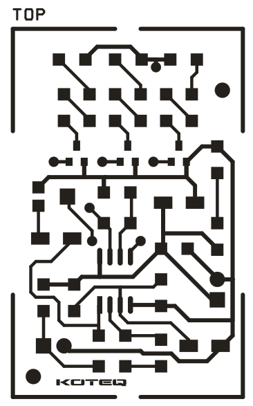

Sound to Light Effect
This PROJECTS will turn your favorite music into light effects, a microphone picks up the sound and gives light effects with 6 Red LEDs, ideal for creating fun atmosphere at parties & discos. Supply 9V-12V DC.
Audio by mixos
SOUND-TO-LIGHT-EFFECT-PIC
  • Supply 9V-12V DC (PP3 9V Battery)
  • On Board Preset for Gain Adjust
  • 6 On Board LEDs
  • On Board Condenser Microphone
  • SMD based small Board
  • PCB Dimension 45.72 X 28.58 MM
  • CN1 Supply Input
  • PR1 Sensitivity Adjust

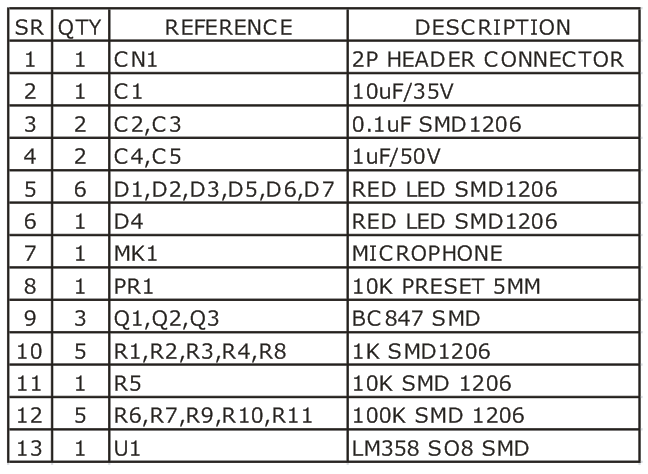

Parts List
SOUND-TO-LIGHT-EFFECT-BOM
