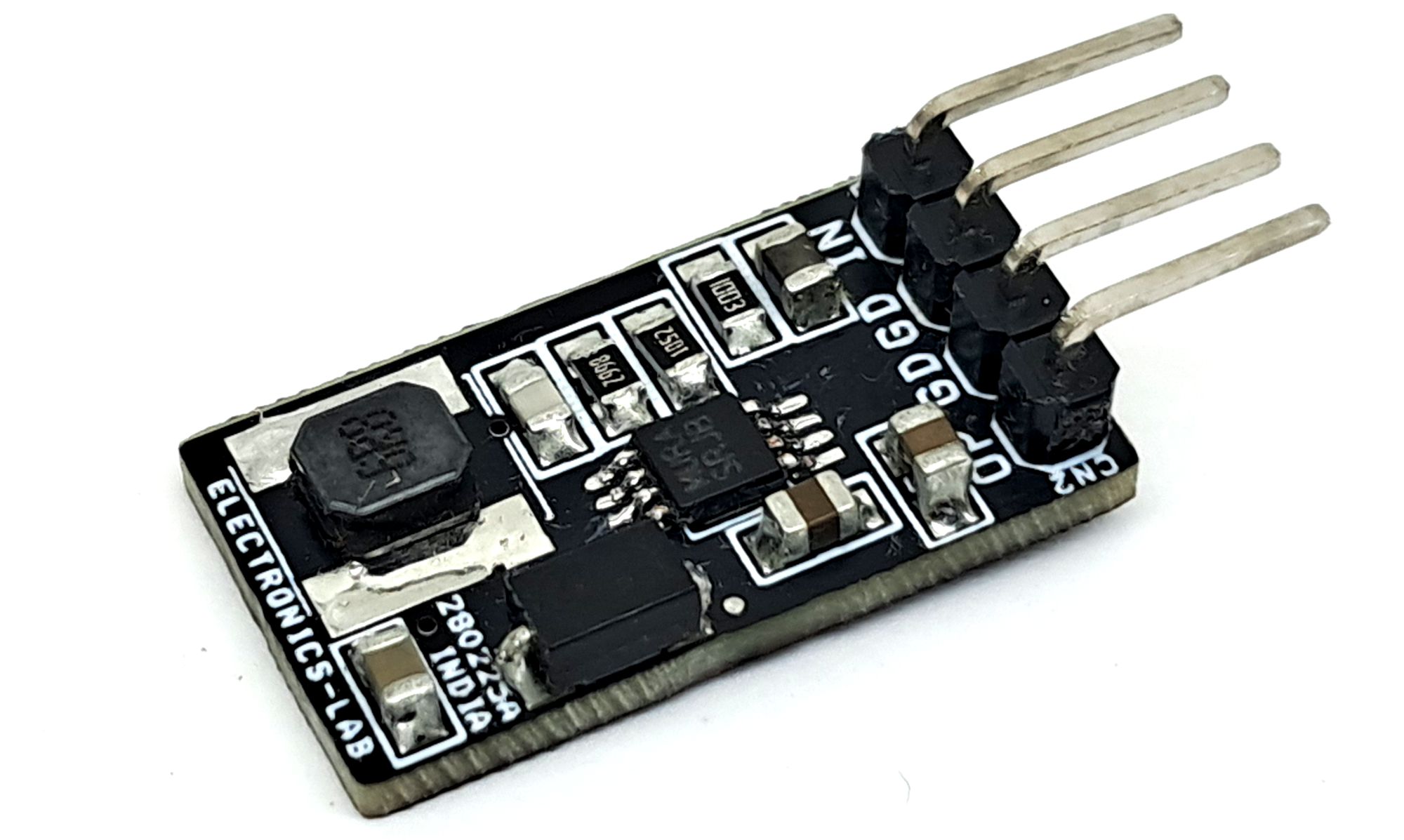

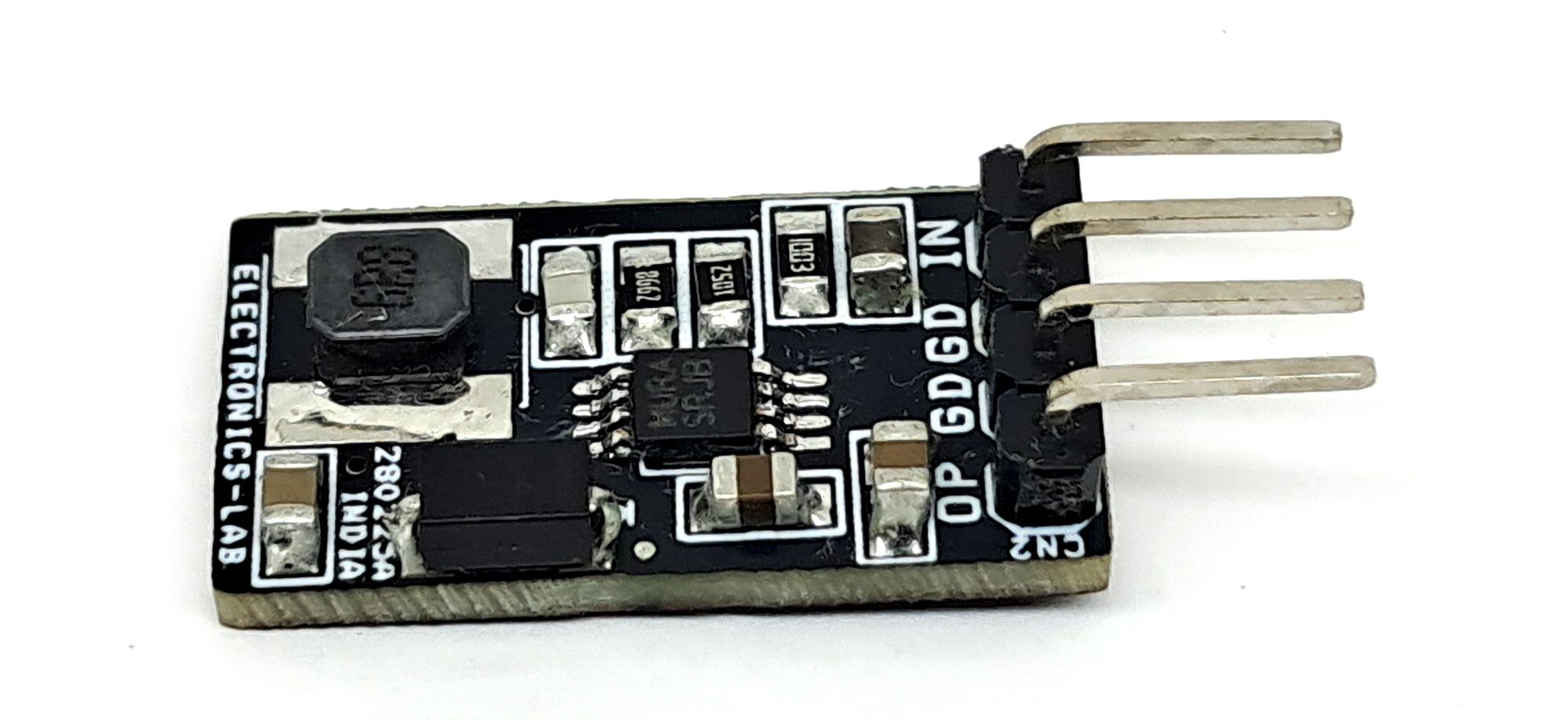

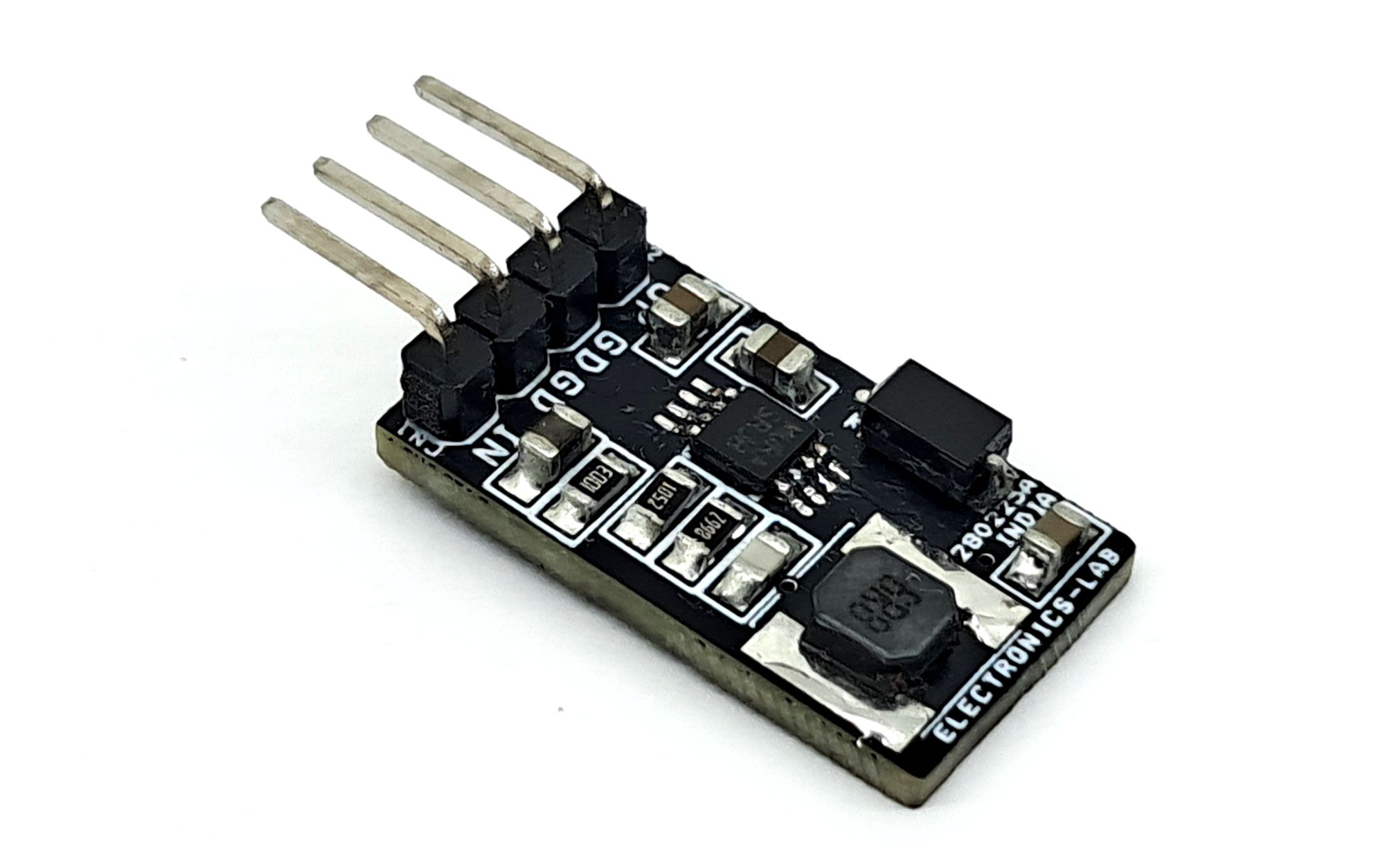

This is a Step-up DC-DC converter that converts 3V to 5.5V input to 12V output for up to 200mA load current. The project consists of LM2735X 1.6MHz DC-DC switching converter.
- Input Supply 3V to 5.5V
- Output 12V DC
- Load Current Up to 200mA
- Operating Frequency 1.6Mhz
- Internal Soft Start
- Internal Compensation
- Current-Mode Control

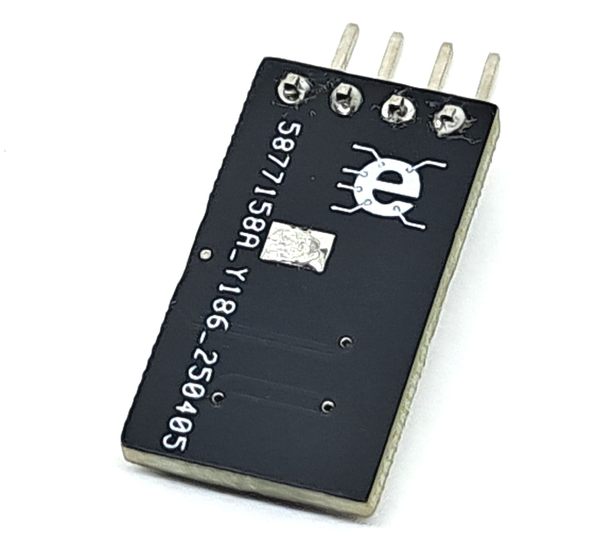

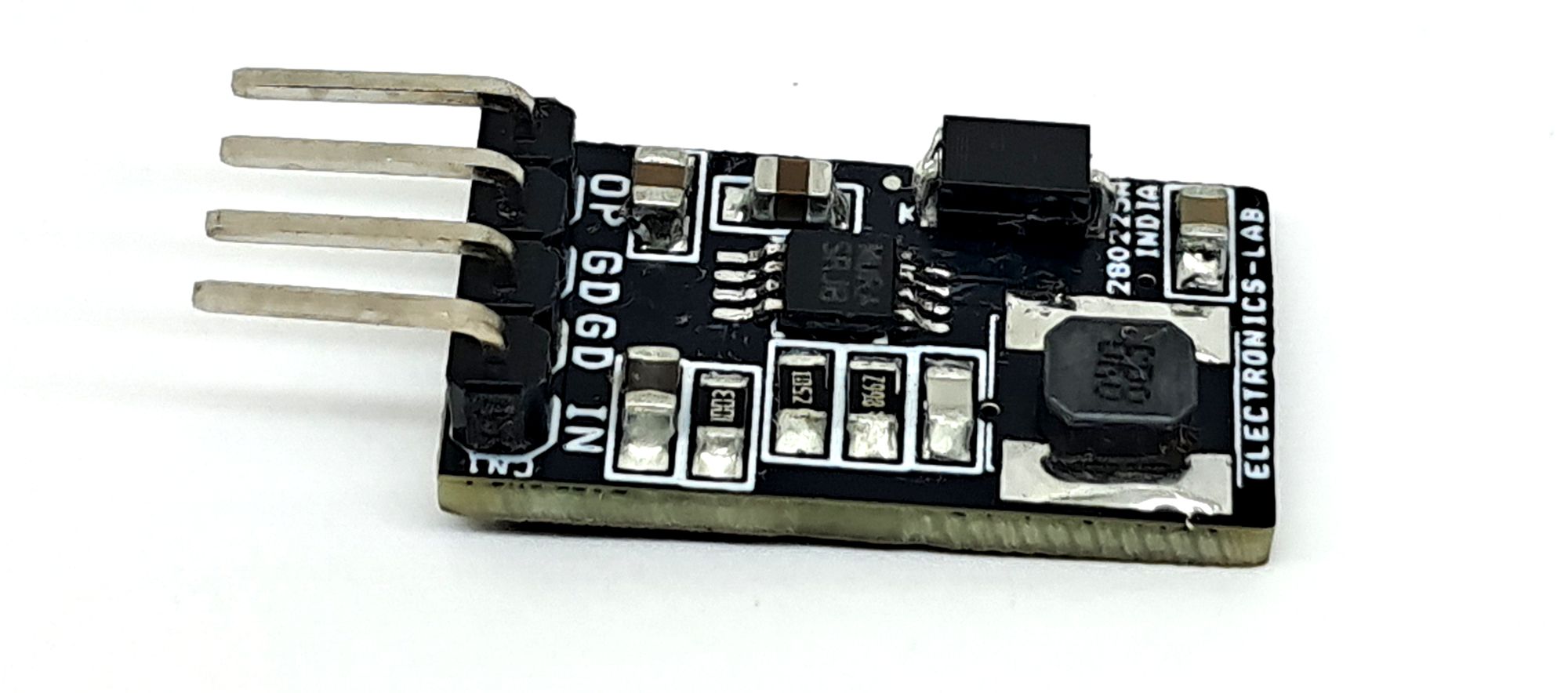

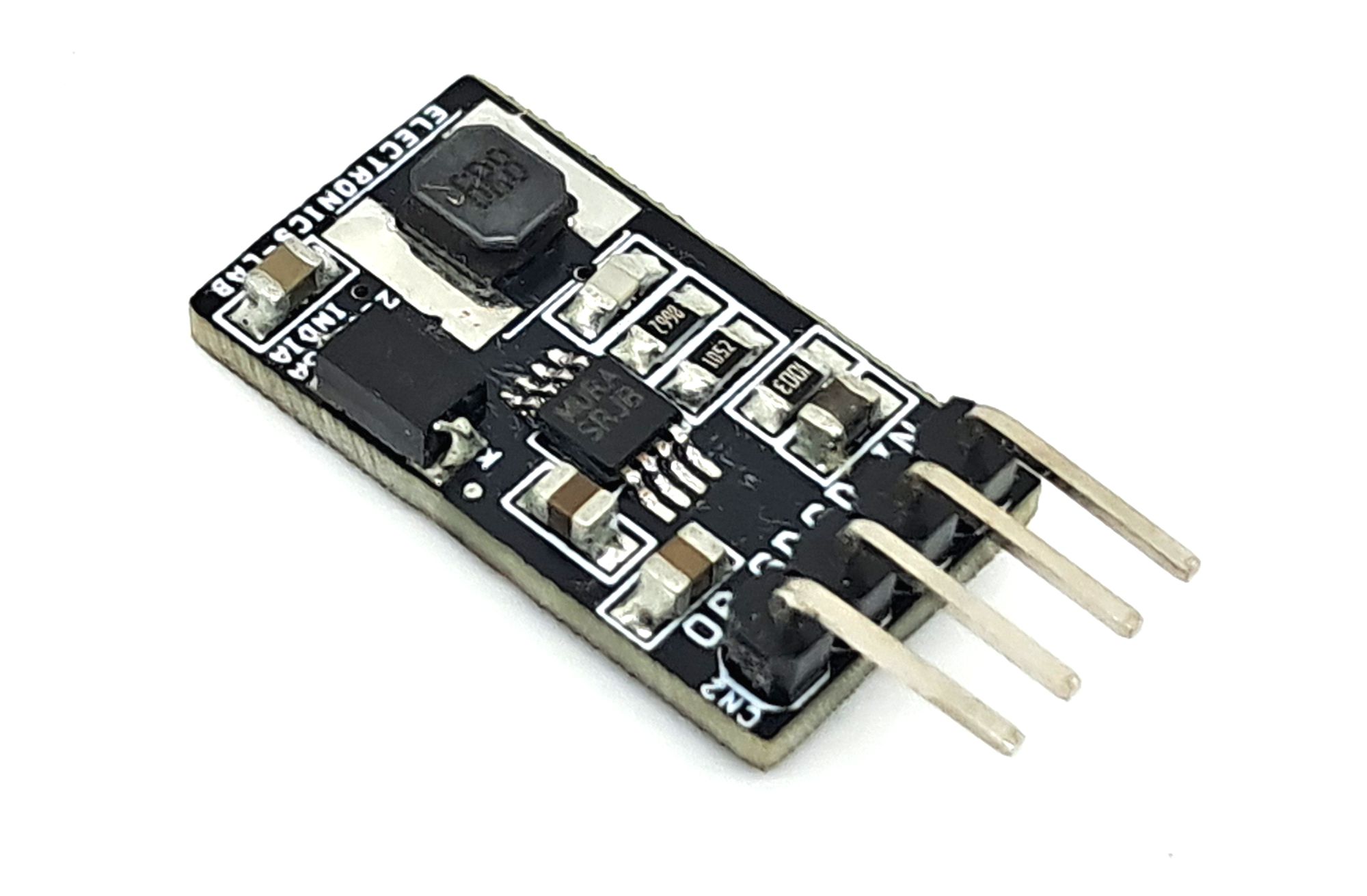

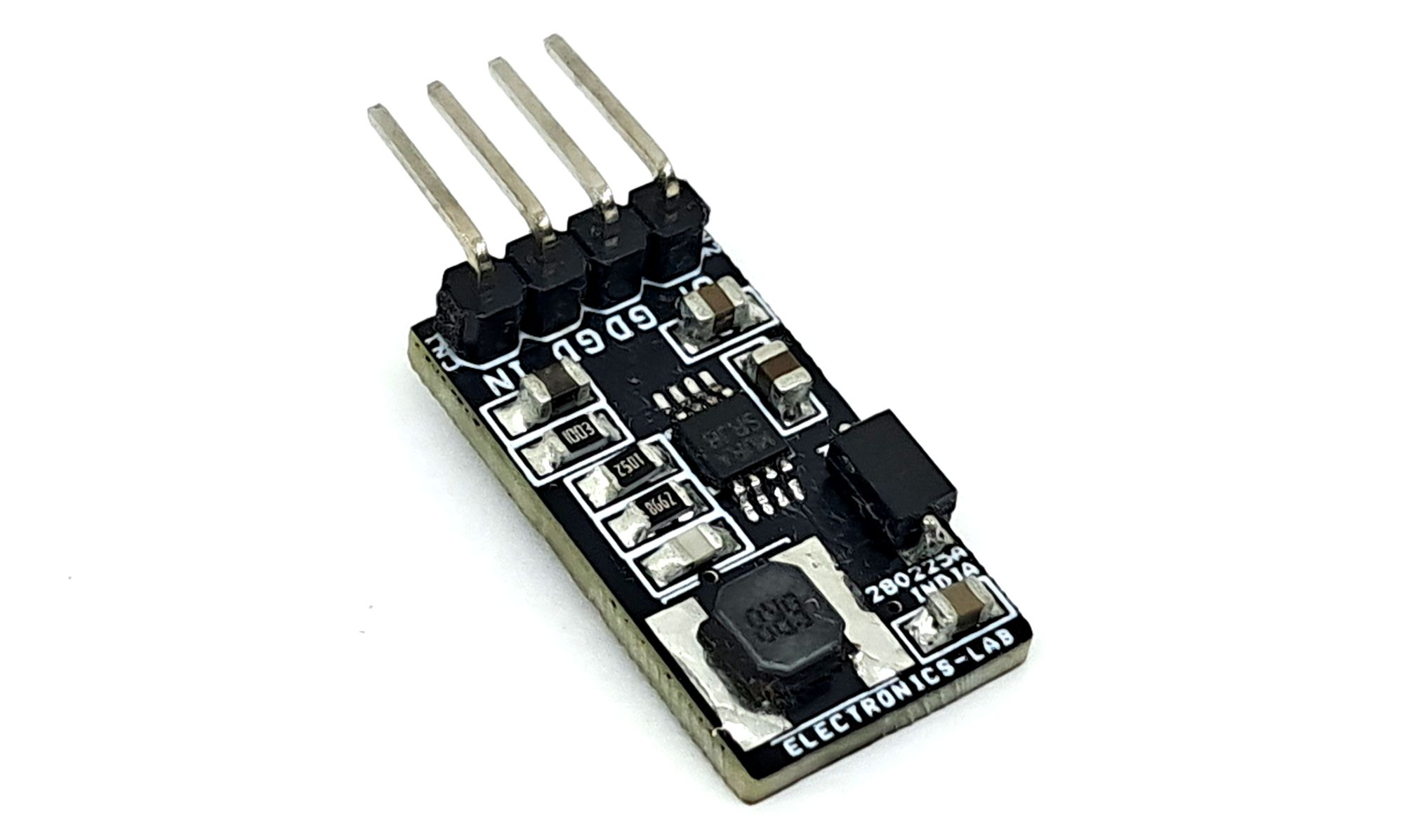

- 4Pin Header Connector for Input and Output
- PCB Dimensions 21.75 x 11.91mm

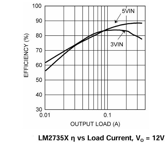

The LM2735 device is an easy-to-use, space-efficient 2.1-A low-side switch regulator, ideal for Boost and SEPIC DC/DC regulation. The device provides all the active functions to provide local DC-DC conversion with fast-transient response and accurate regulation in the smallest PCB area. Switching frequency is internally set to either 520 kHz or 1.6 MHz, allowing the use of extremely small surface mount inductor and chip capacitors, while providing efficiencies of up to 90%. Current-mode control and internal compensation provide ease-of-use, minimal component count, and high-performance regulation over a wide range of operating conditions. External shutdown features an ultra-low standby current of 80 nA, ideal for portable applications. Tiny SOT-23, WSON, and MSOP-PowerPAD packages provide space savings. Additional features include internal soft start, circuitry to reduce inrush current, pulse-by-pulse current limit, and thermal shutdown.

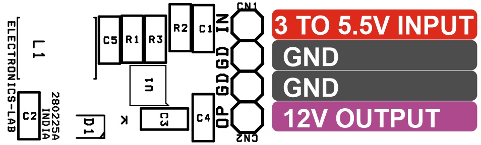

Connections
- CN1: Pin 1 = 3 To 5.5V DC Input, Pin 2 = GND
- CN2: Pin 1 = 12V Output, Pin 2 = GND

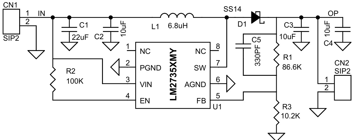

Schematic
Parts List
| NO. | QNTY. | DESC. | REF. | MANUFACTURER | SUPPLIER | SUPPLIER PART NO |
| 1 | 2 | CN1,CN2 | 2 PIN MALE HEADER PITCH 2.54MM | WURTH | DIGIKEY | 732-5315-ND |
| 2 | 1 | C1 | 22uF/6.3V CERAMIC SMD SIZE 0805 | YAGEO/MURATA | DIGIKEY | |
| 3 | 3 | C2,C3,C4 | 10uF/6.3V CERAMIC SMD SIZE 0805 | YAGEO/MURATA | DIGIKEY | |
| 4 | 1 | C5 | 330PF/50V CERAMIC SMD SIZE 0805 | YAGEO/MURATA | DIGIKEY | |
| 5 | 1 | D1 | SS14 SMD DIODE | ON SEMI | DIGIKEY | SS14CT-ND |
| 6 | 1 | L1 | 6.8uH/2A 8X8MM | EATON - ELECTRONICS DVS | DIGIKEY | 513-1134-1-ND |
| 7 | 1 | R1 | 86.6K 1% SMD SIZE 0805 | YAGEO/MURATA | DIGIKEY | |
| 8 | 1 | R2 | 100K 1% SMD SIZE 0805 | YAGEO/MURATA | DIGIKEY | |
| 9 | 1 | R3 | 10.2K 1% SMD SIZE 0805 | YAGEO/MURATA | DIGIKEY | |
| 10 | 1 | U1 | LM2735XMY | TI | DIGIKEY | LM2735XMY/NOPBCT-ND |
