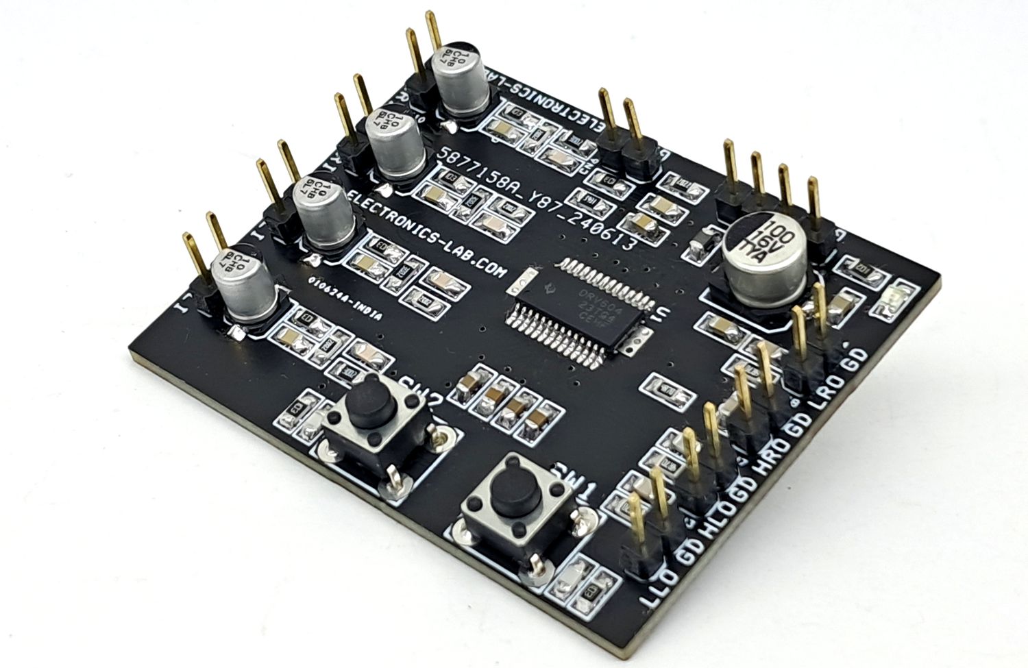

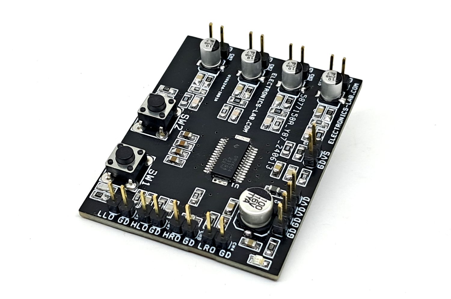

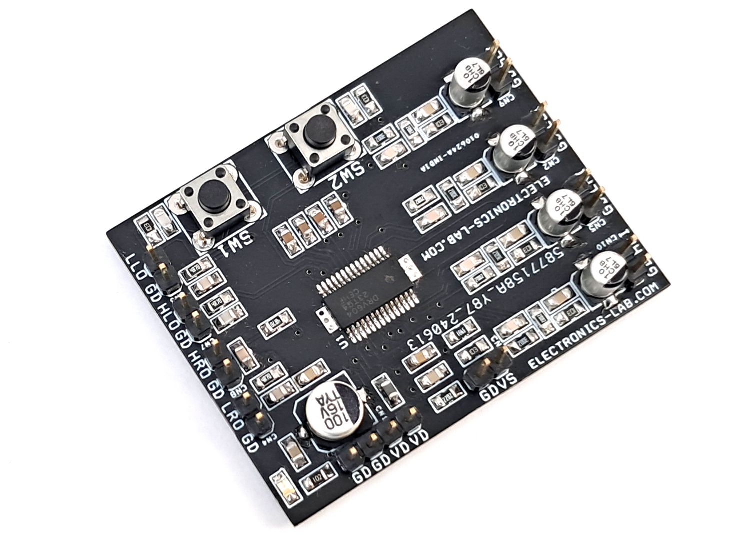

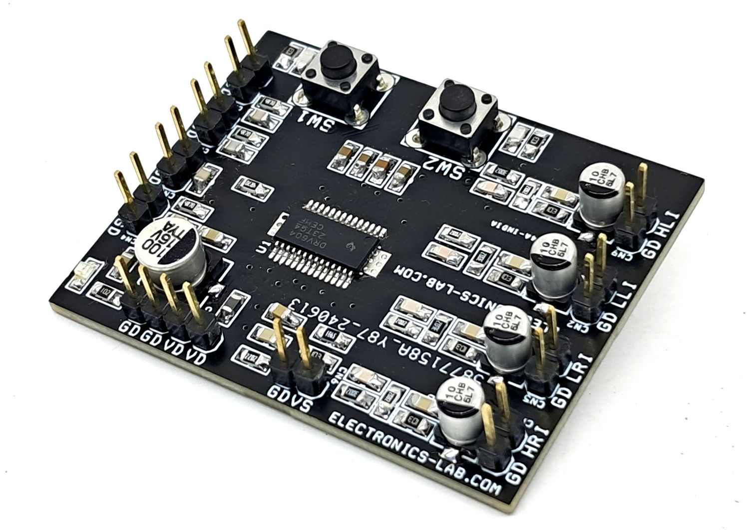

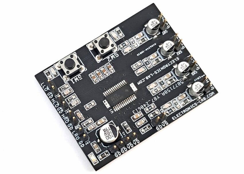

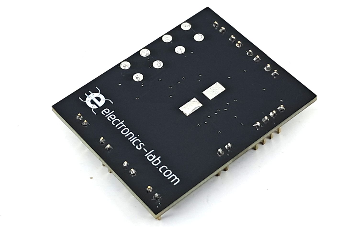

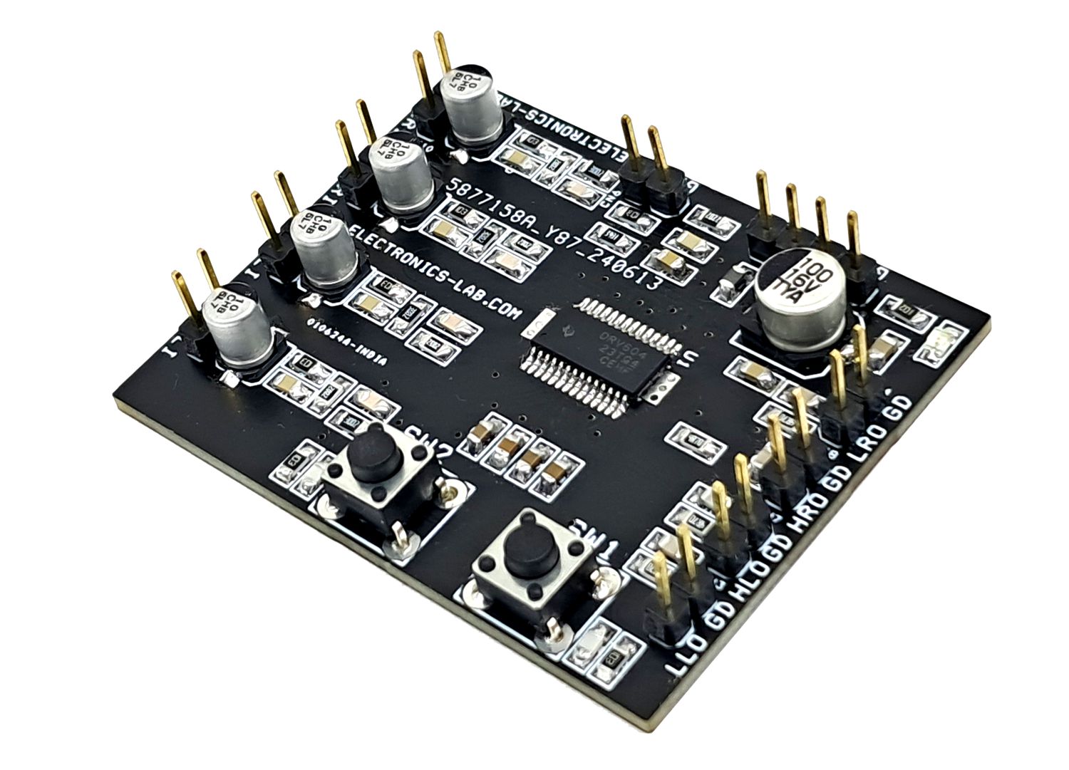

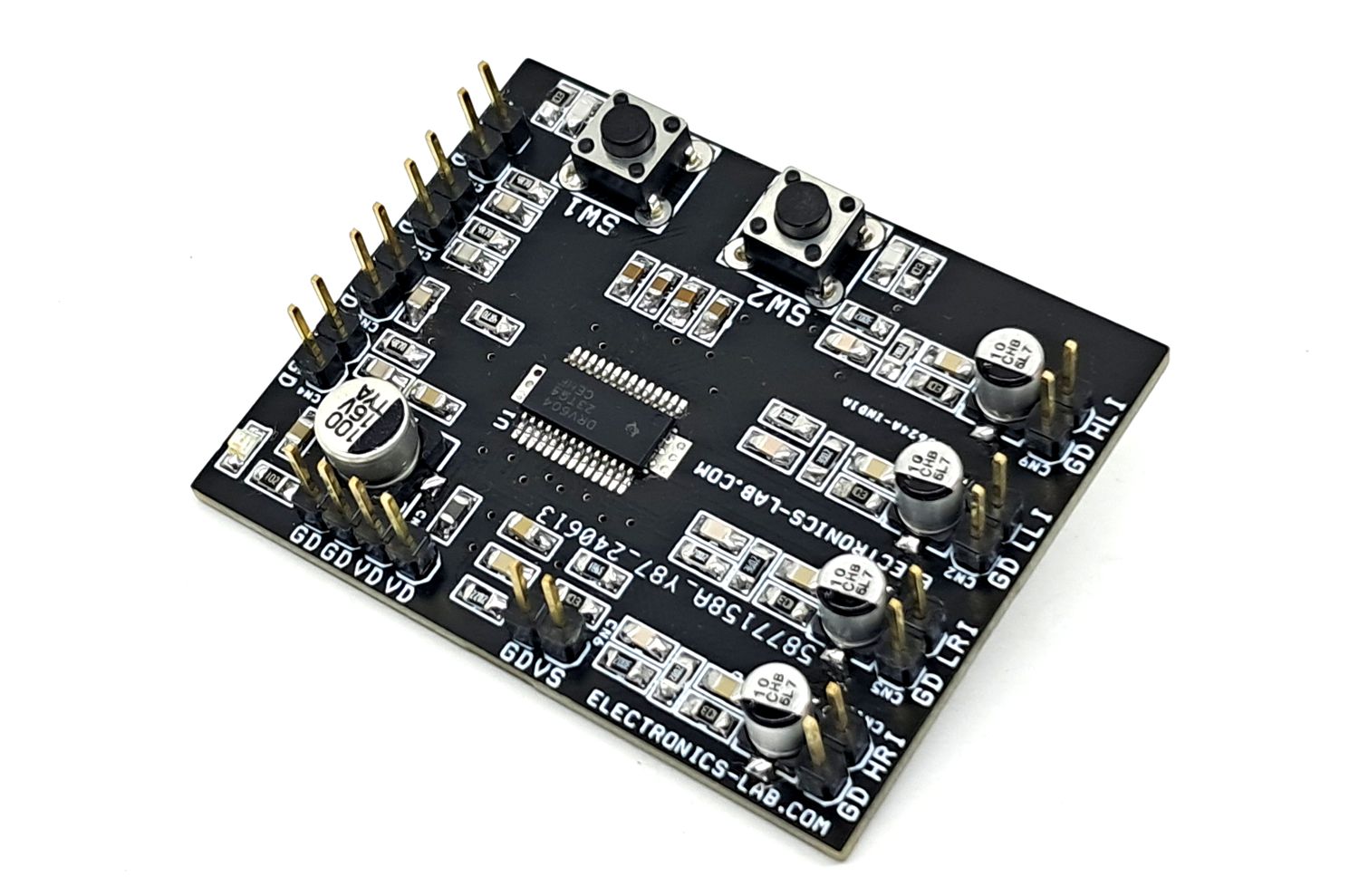

This is a 2Vrms Pop-Free stereo line driver with a stereo headphone driver designed to allow the removal of the output DC-blocking capacitors for reduced component count and cost. The project is based on the DRV604 chip which is ideal for single supply electronics where size and cost are critical design parameters.
This is a 2Vrms Pop-Free stereo line driver with a stereo headphone driver designed to allow the removal of the output DC-blocking capacitors for reduced component count and cost. The project is based on the DRV604 chip which is ideal for single supply electronics where size and cost are critical design parameters. The project is capable of driving 2Vrms into a 5kΩ load and a clean 40mW into a 32Ω headphone with a single 3.3V supply voltage. Line and headphone outputs have ±8kV IEC ESD protection. The device has built-in shutdown control for pop-free on/off control. The DRV604 does not require a power supply greater than 3.3V to generate its 5.6Vpp output, nor does it require a split rail power supply. The DRV604 integrates its charge pump to generate a negative supply rail that provides a clean, pop-free ground biased 2Vrms output. This project is configured with single-ended header input connectors for analog input, headphones, and line output. The power supply is connected via a four-pin 2.54mm pin header.
- Power Supply 3.3V (Range 3V To 3.7V)
- VSUP 3.3V Enables the Output
- Number of Channels 4
- Single-ended analog input and output
- Load Impedance: Line Min 5K Ohms
- Load Impedance: Headphone Min 32 Ohms
- Up to 2-Vrms Line Output
- Output Power: Headphone 40mW
- Dynamic Range > 103dB
- Eliminates Pop/Clicks
- Low Noise and THD DESCRIPTION– SNR > 109dB, Typical Vn < 7µVrms 20–20kHz,
- Shutdown Switch for Line and Headphone
- Power Sense UVP for Brown Out Protection
- Short Circuit and Thermal Protection
- PCB Dimensions 50.64 x 39.85 mm

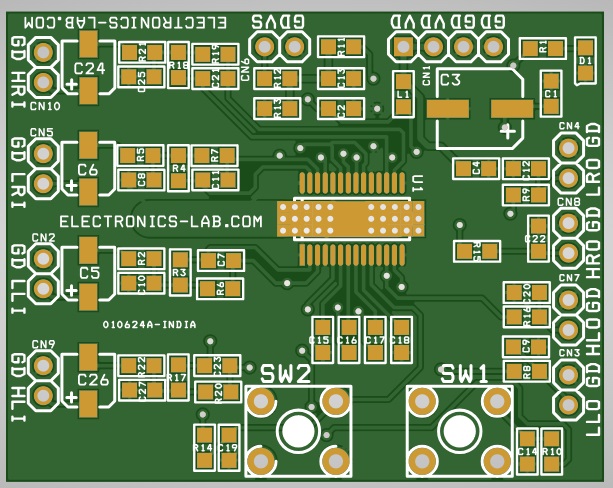

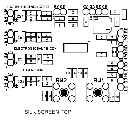

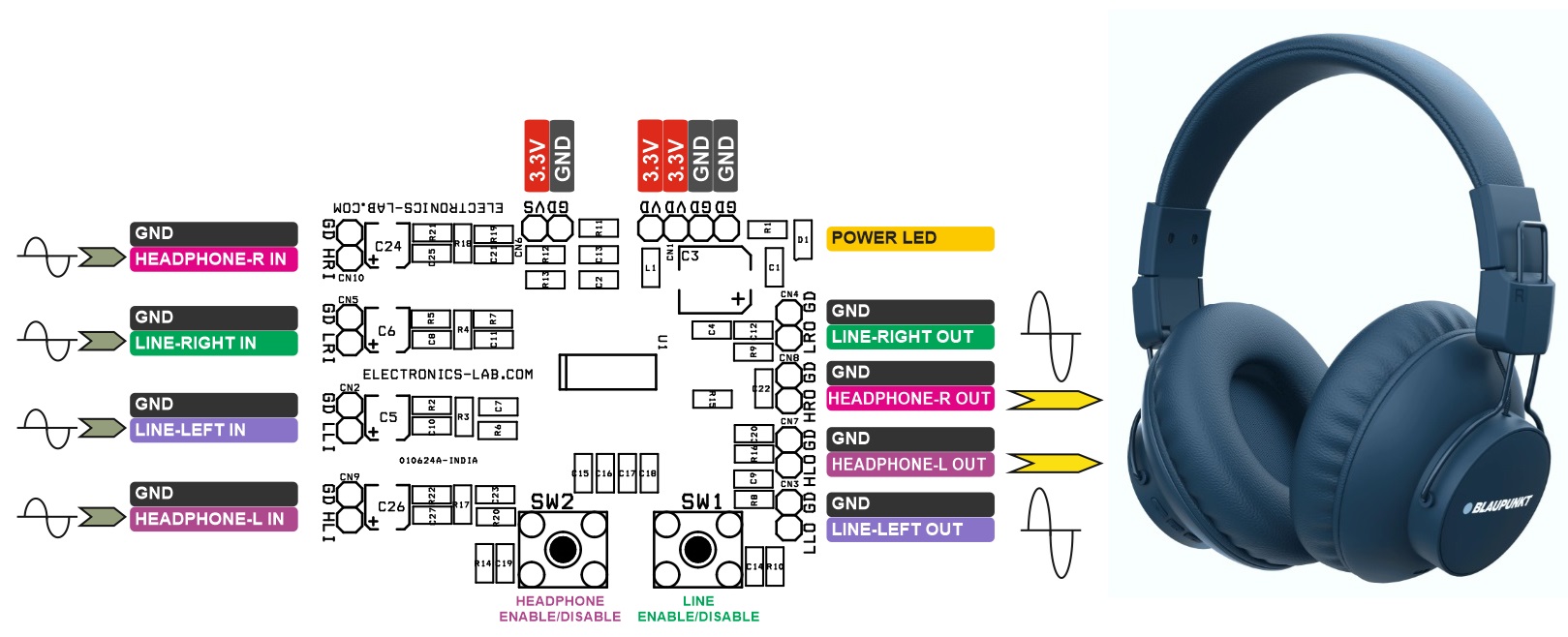

Connections
- CN1: Pin 1,2 = VDD 3.3V, Pin 3,4 = GND
- CN2: Pin 1 = Line Input Left Channel, Pin 2 = GND
- CN3: Pin 1 = Line Output Left Channel, Pin 2 = GND
- CN4: Pin 1 = Line Output Right Channel, Pin 2 = GND
- CN5: Pin 1 = Line Input Right Channel, Pin 2 = GND
- CN6: Pin 1 = VSUP 3.3V, Enable/Disable for Pop free Output (3.3V=Enable)
- CN7: Pin 1 = Headphone Left Channel, Pin 2 = GND
- CN8: Pin 1 = Headphone Right Output, Pin 2 = GND
- CN9: Pin 1 = Headphone Left Channel Input, Pin 2 = GND
- CN10: Pin 1 = Headphone Right Channel Input, Pin 2 = GND
- SW1: Line Input Enable/Disable, Normally Enabled
- SW2: Headphone Enable/Disable, Normally Enabled
- D1: Power LED

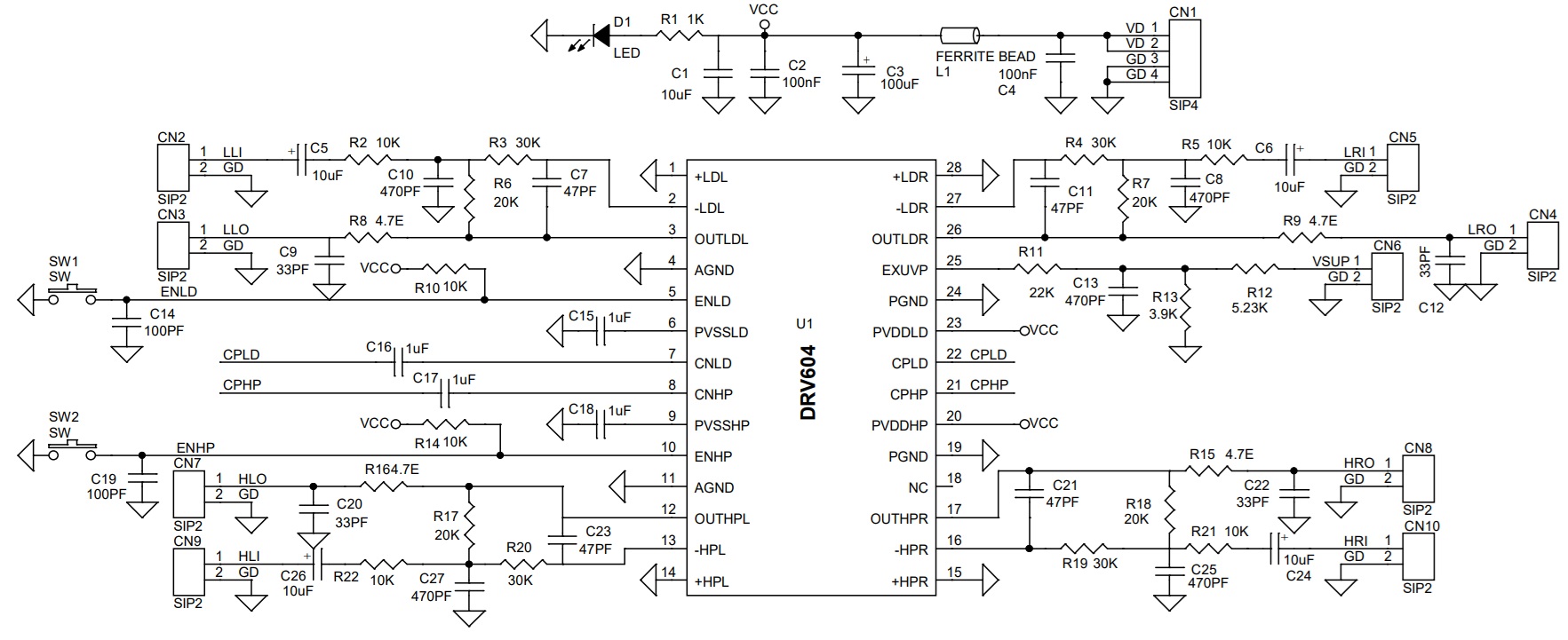

Schematic

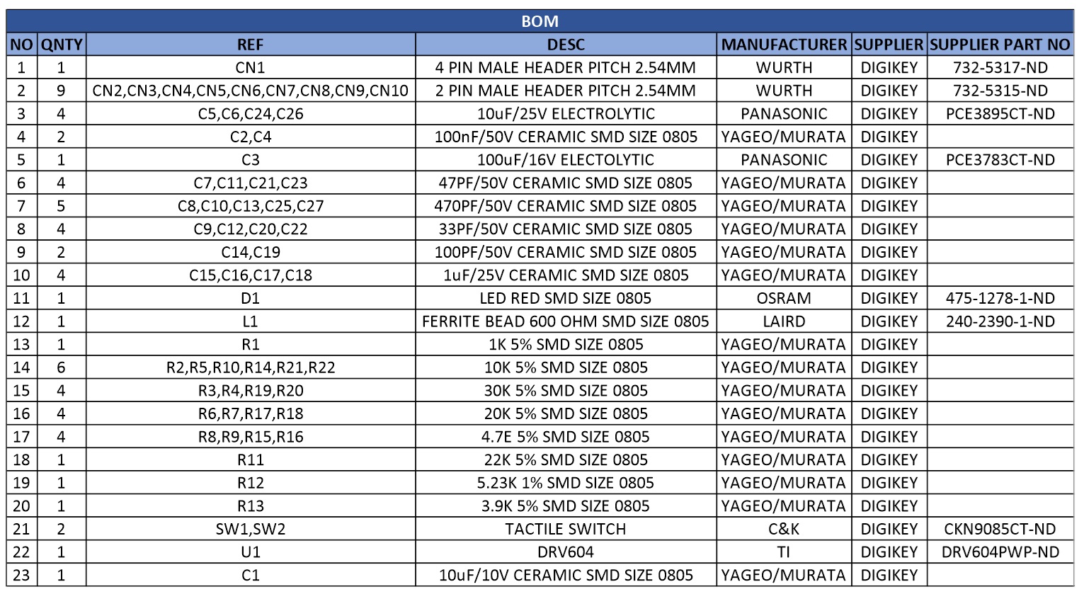

Parts List
| NO | QNTY | REF | DESC | MANUFACTURER | SUPPLIER | SUPPLIER PART NO |
| 1 | 1 | CN1 | 4 PIN MALE HEADER PITCH 2.54MM | WURTH | DIGIKEY | 732-5317-ND |
| 2 | 9 | CN2,CN3,CN4,CN5,CN6,CN7,CN8,CN9,CN10 | 2 PIN MALE HEADER PITCH 2.54MM | WURTH | DIGIKEY | 732-5315-ND |
| 3 | 4 | C5,C6,C24,C26 | 10uF/25V ELECTROLYTIC | PANASONIC | DIGIKEY | PCE3895CT-ND |
| 4 | 2 | C2,C4 | 100nF/50V CERAMIC SMD SIZE 0805 | YAGEO/MURATA | DIGIKEY | |
| 5 | 1 | C3 | 100uF/16V ELECTOLYTIC | PANASONIC | DIGIKEY | PCE3783CT-ND |
| 6 | 4 | C7,C11,C21,C23 | 47PF/50V CERAMIC SMD SIZE 0805 | YAGEO/MURATA | DIGIKEY | |
| 7 | 5 | C8,C10,C13,C25,C27 | 470PF/50V CERAMIC SMD SIZE 0805 | YAGEO/MURATA | DIGIKEY | |
| 8 | 4 | C9,C12,C20,C22 | 33PF/50V CERAMIC SMD SIZE 0805 | YAGEO/MURATA | DIGIKEY | |
| 9 | 2 | C14,C19 | 100PF/50V CERAMIC SMD SIZE 0805 | YAGEO/MURATA | DIGIKEY | |
| 10 | 4 | C15,C16,C17,C18 | 1uF/25V CERAMIC SMD SIZE 0805 | YAGEO/MURATA | DIGIKEY | |
| 11 | 1 | D1 | LED RED SMD SIZE 0805 | OSRAM | DIGIKEY | 475-1278-1-ND |
| 12 | 1 | L1 | FERRITE BEAD 600 OHM SMD SIZE 0805 | LAIRD | DIGIKEY | 240-2390-1-ND |
| 13 | 1 | R1 | 1K 5% SMD SIZE 0805 | YAGEO/MURATA | DIGIKEY | |
| 14 | 6 | R2,R5,R10,R14,R21,R22 | 10K 5% SMD SIZE 0805 | YAGEO/MURATA | DIGIKEY | |
| 15 | 4 | R3,R4,R19,R20 | 30K 5% SMD SIZE 0805 | YAGEO/MURATA | DIGIKEY | |
| 16 | 4 | R6,R7,R17,R18 | 20K 5% SMD SIZE 0805 | YAGEO/MURATA | DIGIKEY | |
| 17 | 4 | R8,R9,R15,R16 | 4.7E 5% SMD SIZE 0805 | YAGEO/MURATA | DIGIKEY | |
| 18 | 1 | R11 | 22K 5% SMD SIZE 0805 | YAGEO/MURATA | DIGIKEY | |
| 19 | 1 | R12 | 5.23K 1% SMD SIZE 0805 | YAGEO/MURATA | DIGIKEY | |
| 20 | 1 | R13 | 3.9K 5% SMD SIZE 0805 | YAGEO/MURATA | DIGIKEY | |
| 21 | 2 | SW1,SW2 | TACTILE SWITCH | C&K | DIGIKEY | CKN9085CT-ND |
| 22 | 1 | U1 | DRV604 | TI | DIGIKEY | DRV604PWP-ND |
| 23 | 1 | C1 | 10uF/10V CERAMIC SMD SIZE 0805 | YAGEO/MURATA | DIGIKEY |
