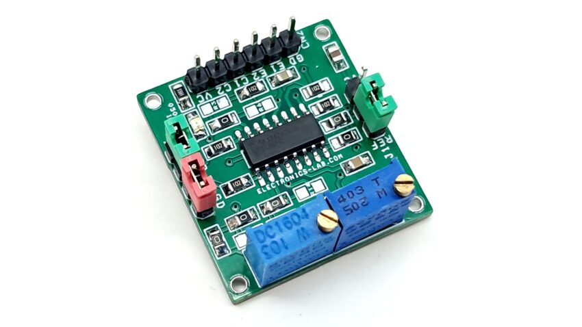

TL494-Based PWM Generator Module
This module is a versatile PWM generator based on the TL494 control chip. Its flexible design allows custom component configuration for various applications beyond power supply control. The TL494 integrates key functions like two error amplifiers, an adjustable oscillator, a dead-time control (DTC) comparator, a pulse-steering flip-flop, and a precision 5V regulator.
This is a versatile PWM generator module built around the TL494 PWM control chip. The flexible design allows for multiple component configurations to support various applications. Users can customize the module by installing only the components required for their specific application while leaving out unnecessary components.
- Power Supply 7V to 40V DC
- Complete PWM Power-Control Circuitry
- Uncommitted Outputs for 200-mA Sink or Source Current
- Output Control Selects Single-Ended or Push-Pull Operation
- Internal Circuitry Prohibits Double Pulse at Either Output
- Variable Dead Time Provides Control Over Total Range
- Internal Regulator Provides a Stable 5-V REF
- Reference Supply With 5% Tolerance
- Circuit Architecture Allows Easy Synchronization

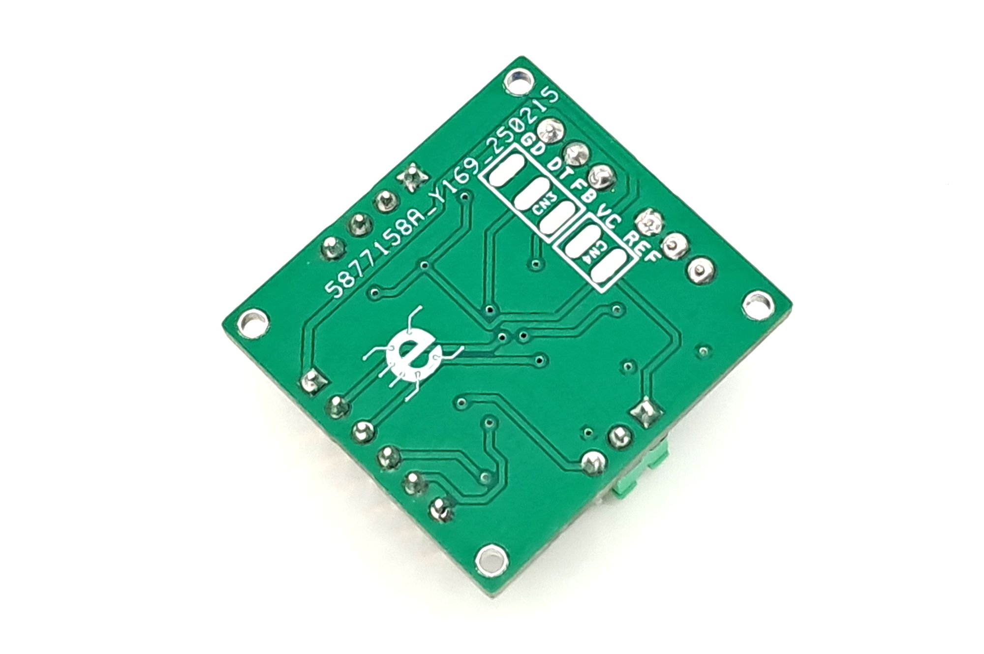

- PCB Dimensions 29.21 x 27.15 mm

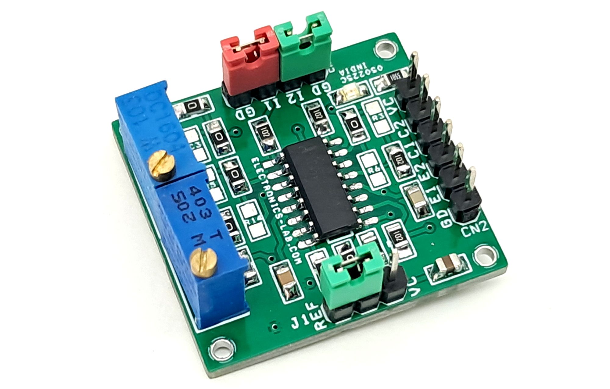

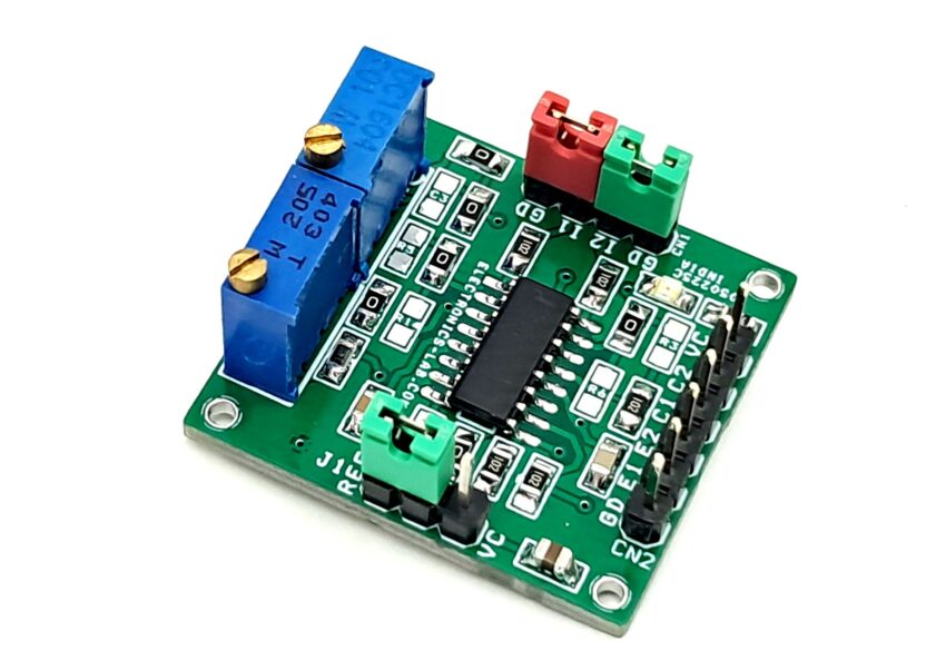

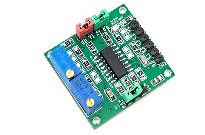

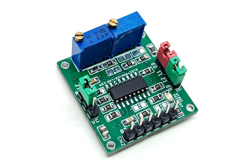

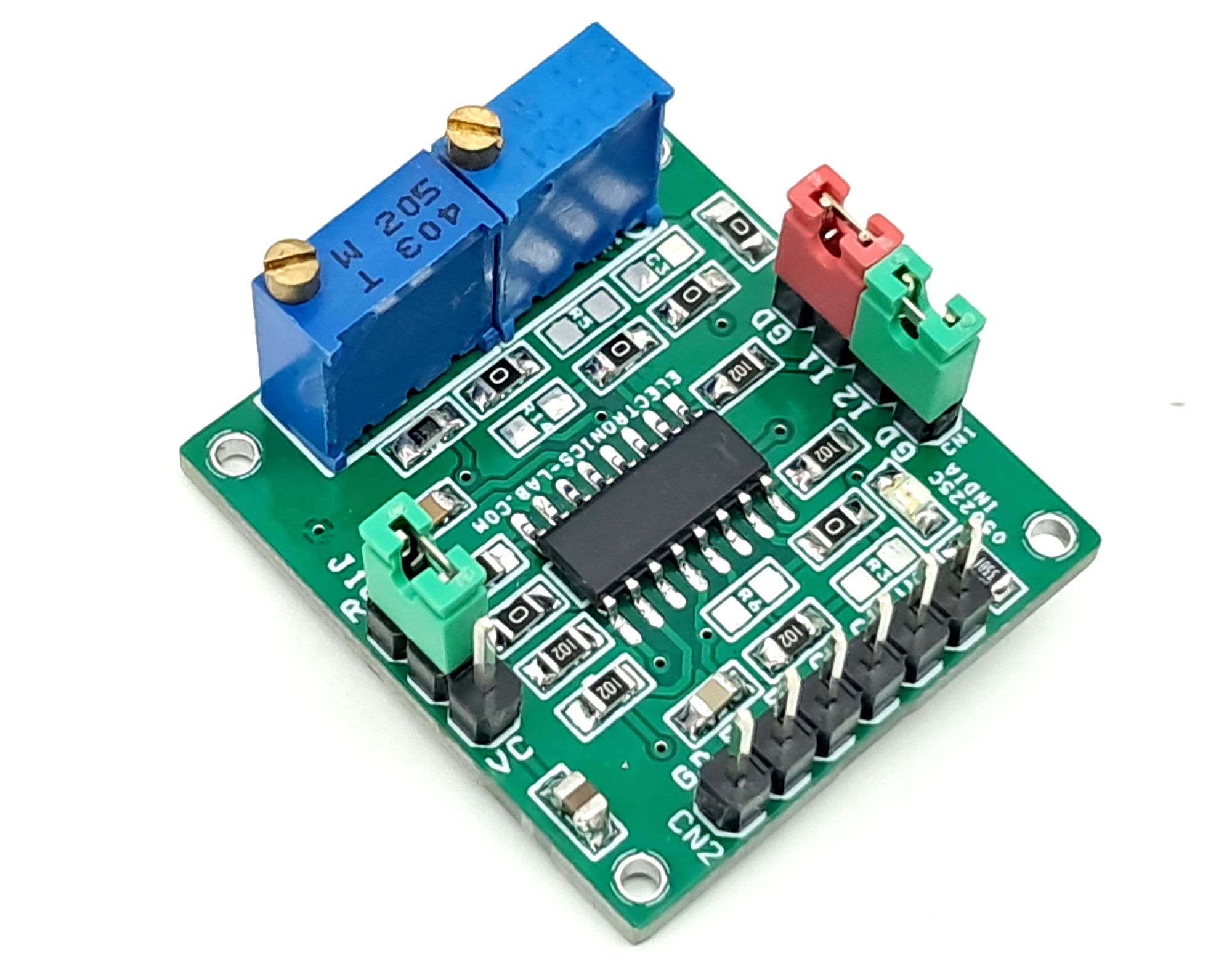

Connector and Component Details
CN1: Jumper Configuration
- Use jumper closures (shunts) to short:
- Pins 1 and 2
- Pins 3 and 4
D1: LED Indicator
- Functions as power status indicator
J1: Output Voltage Selection Jumper
- Short with Ref: Provides 5V PWM output
- Short with VCC: Provides high voltage PWM output
PR1: PWM Duty Cycle Adjustment
- Trimmer potentiometer for adjusting duty cycle
- Adjustment range: approximately 5% to 95%
PR2: Frequency Adjustment
- Trimmer potentiometer for frequency control
- Adjustment range: 100Hz to 50kHz
CN2: Main Connection Terminal (6-pin)
- Pin 1: VCC input (7V to 40V)
- Pin 2: Collector 2 output
- Pin 3: Collector 1 output
- Pin 4: Emitter 2 output (PWM Output)
- Pin 5: Emitter 1 output (PWM Output)
- Pin 6: Ground (GND)
CN3 and CN4: Not in use
