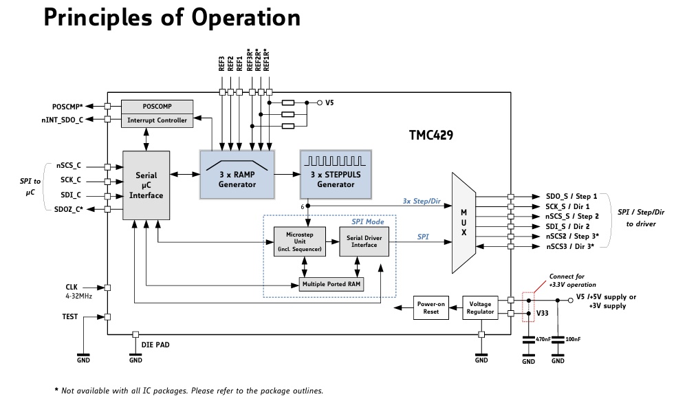

The TMC429 scores with its autonomous handling of all real time critical tasks. By offloading the motion-control function to the TMC429, up to three motors can be operated reliably with very little demand for service from the microcontroller. Software only needs to send target positions, and the TMC429 generates precisely timed step pulses by hardware for up to three stepper motor driver chips. Parameters for each motor can be changed on the fly while software retains full control using an SPI bus. This way, high precision and reliable operation is achieved while costs are kept down.
Serial µC Interface
From the software point of view, the TMC429 provides a set of registers, accessed by a microcontroller via a serial interface in a uniform way. Each datagram contains address bits, a read writes selection bit, and data bits to access the registers and the on-chip memory. Each time the microcontroller sends a datagram to the TMC429 it simultaneously receives a datagram from the TMC429. This simplifies the communication with the TMC429 and makes programming easy. Most microcontrollers have an SPI hardware interface, which directly connects to the serial four wire microcontroller interface of the TMC429. For microcontrollers without SPI hardware software doing the serial communication is sufficient and can easily be implemented.
Step/Dir Driver Interface
The TMC429-LI controls the motor position by sending pulses on the STEP signal while indicating the direction on the DIR signal. A programmable step pulse length and step frequencies up to 1MHz allow operation at high speed and high microstep resolution. The driver chip converts these signals into the coil currents which control the position of the motor. The TMC429-LI perfectly fits to the TMC26x smart power Step/Dir driver family.
Serial Driver Interface
The TMC429 automatically generates the required data-stream for SPI drivers and provides user configurable microstep waves and motor ramps for up to three motors. The serial interface to the motor drivers is flexibly configurable for different types (from different vendors) with up to 64-bit length for the SPI daisy chain. The TMC429-I perfectly fits to the TMC24x driver family.

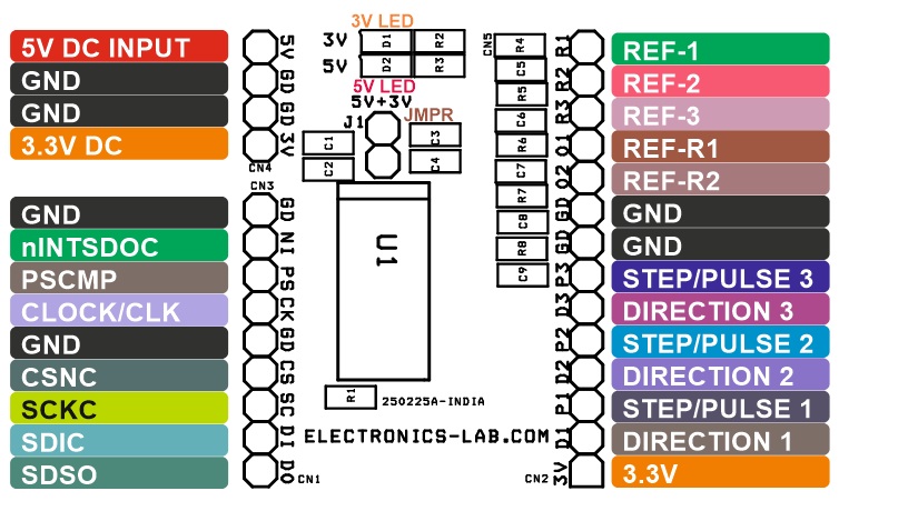

Connections
  • CN1 Microcontroller SPI Interface: Pin 1 = SDOC, Pin 2 = SDIC, Pin 3 = SCKC, Pin 4 = CSNC, Pin 5 = GND
  • CN2 Step/Dir Output: Pin 1 = 3.3V, Pin 2 = Direction 1, Pin 3 = Step 1, Pin 4 = Direction 2, Pin 5 = Step 2, Pin 6 = Direction 3, Pin 7 = Step 3, Pin 8 = GND
  • CN3: Pin1 = CLK, Pin 2 = PSCMP, Pin 3 = nINTSDOC, Pin 4 = GND
  • CN4: Pin 1 = 5V DC, Pin 2 = GND, Pin 3 = GND, Pin 4 = 3.3V
  • CN5: Pin1 = Reference 1, Pin 2 = Reference 2, Pin 3 = Reference 3, Pin 4 = Reference R1, Pin 5 = Reference R2, Pin 6 = GND
  • Jumper J1 = 3.3V+5V
  • D1: 3.3V LED
  • D2: 5V LED
CN2 Step/Direction vs SPI
  • SDO_S / Step 1, SCK_S / Dir 1, nSCS_S / Step 2, SDI_S / Dir 2, nSCS2 / Step 3*, nSCS3 / Dir 3*

Principles of Operation

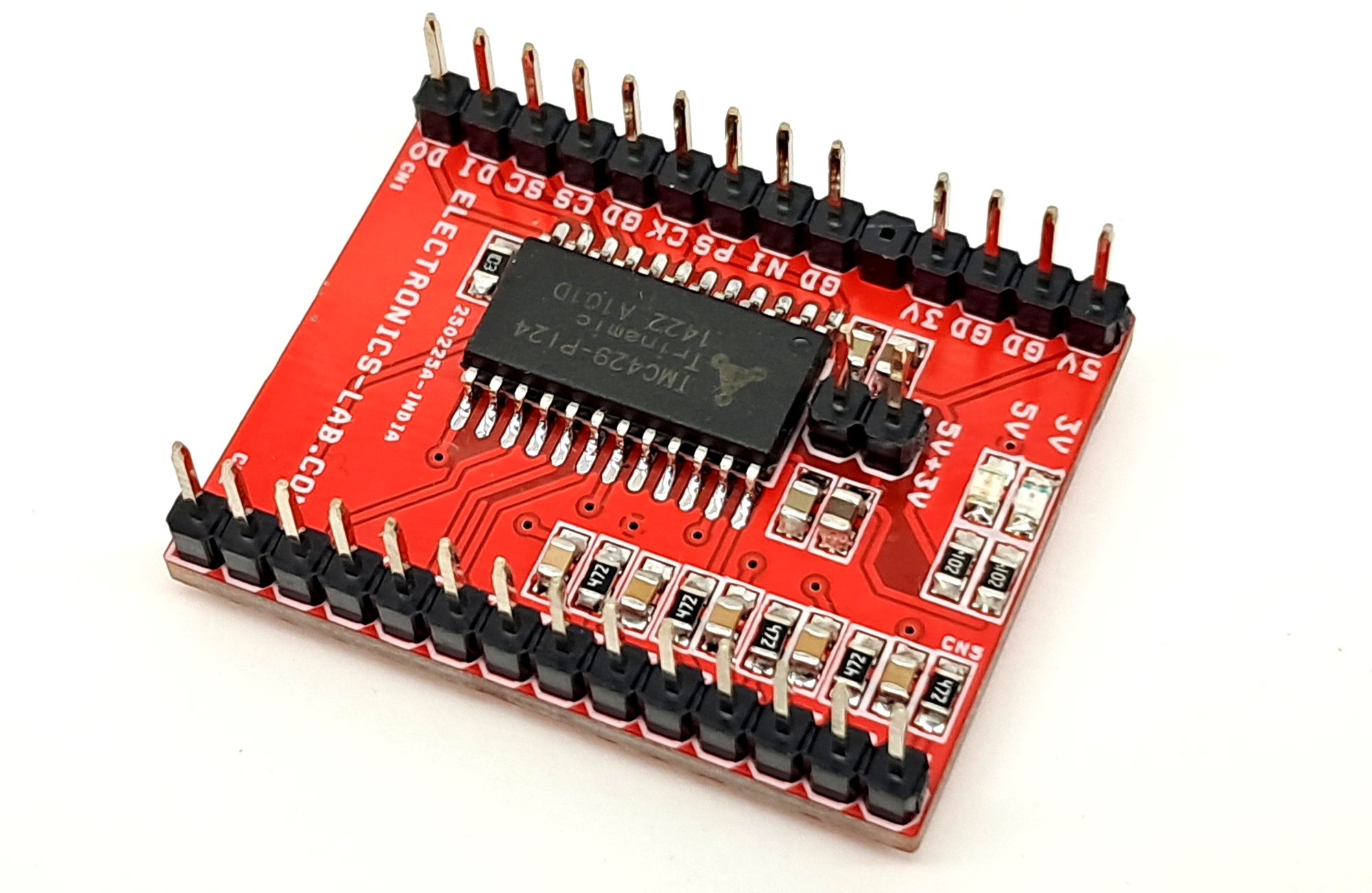

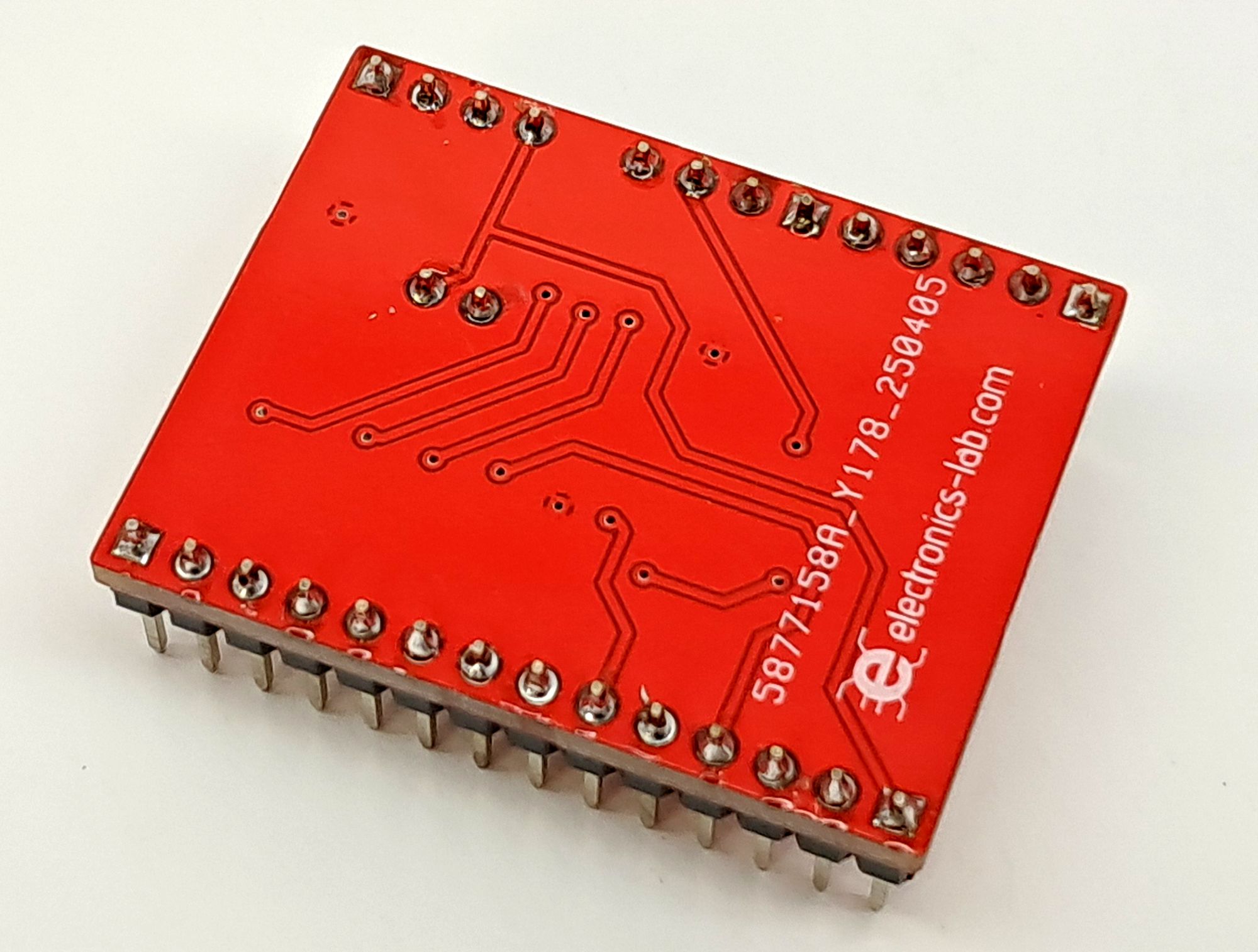

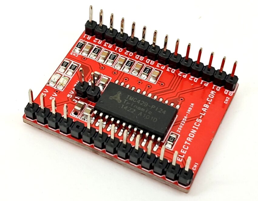

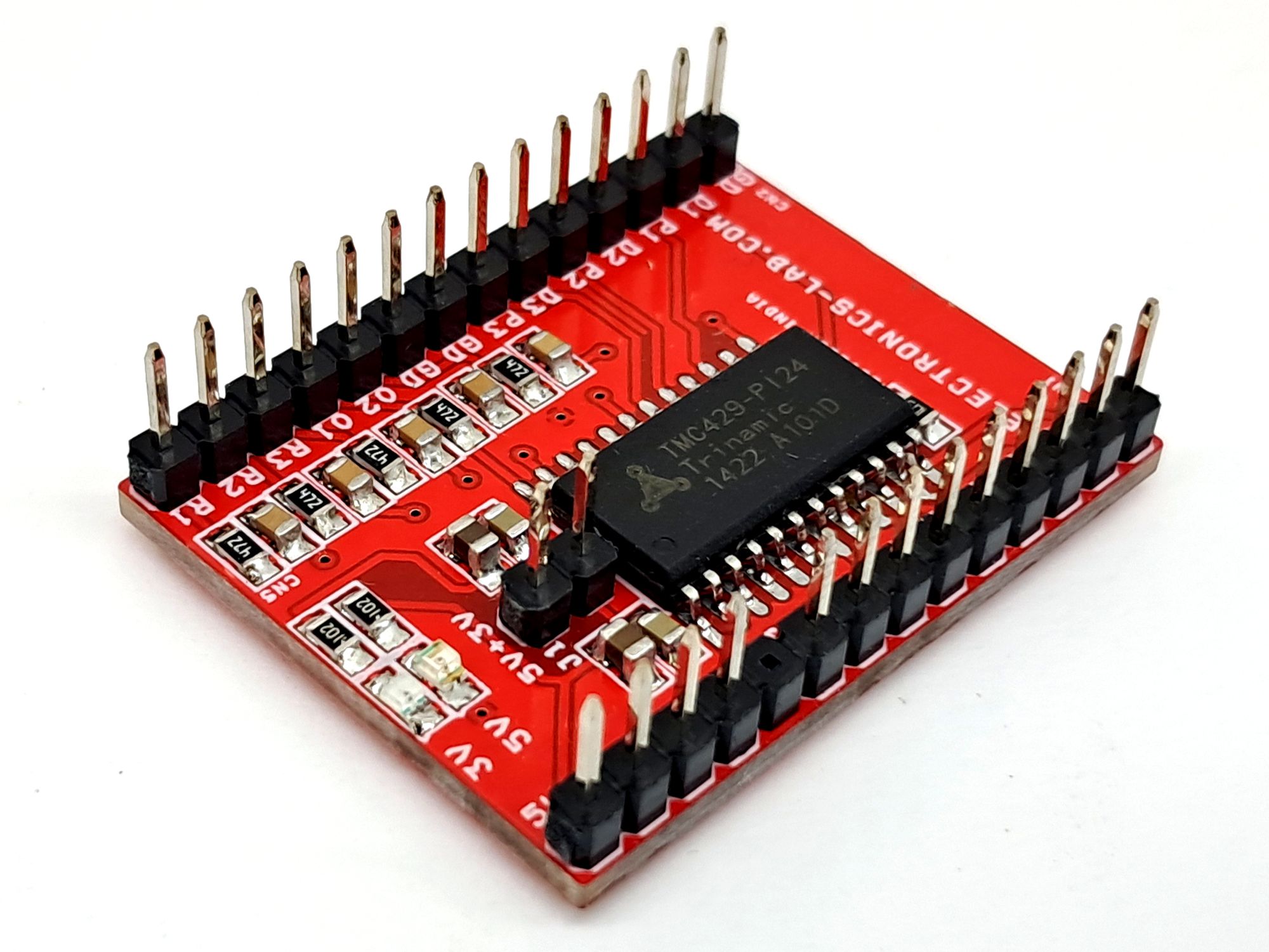

Photos
