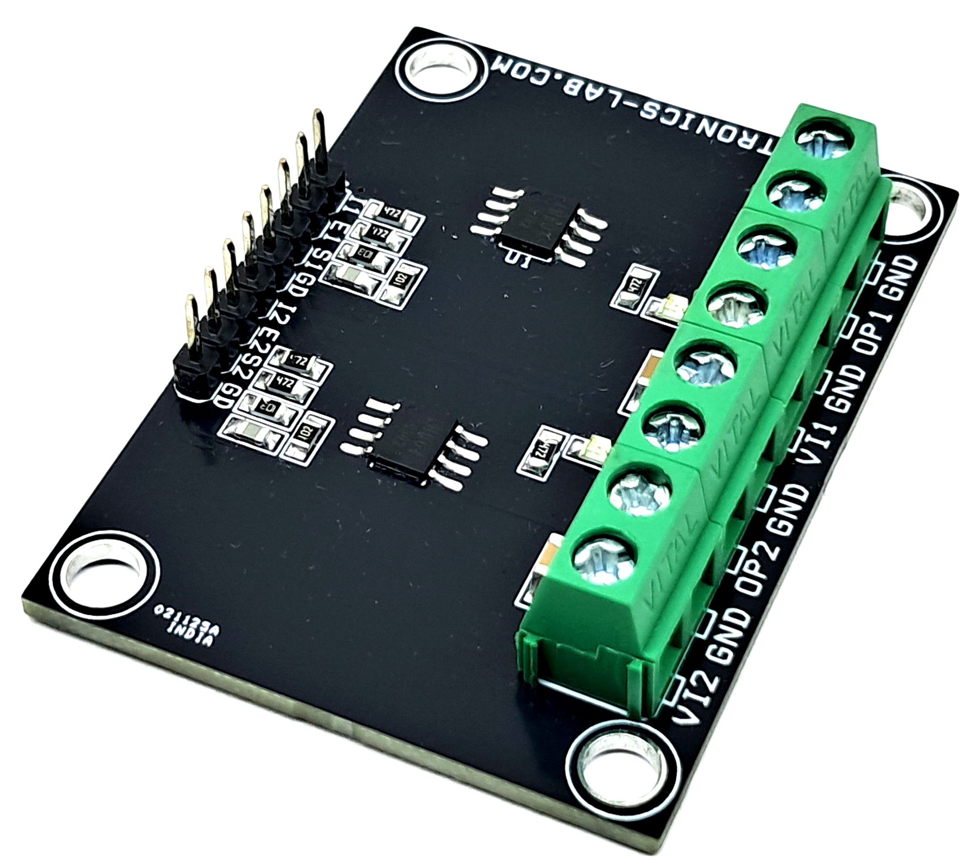

Two Channel High-Side Switch with Current Sensing
This automotive-grade two-channel high-side switch provides a robust power management solution by integrating overcurrent, thermal, and open-load protections alongside a dedicated current-sensing function for real-time load monitoring.
Automotive by mixos

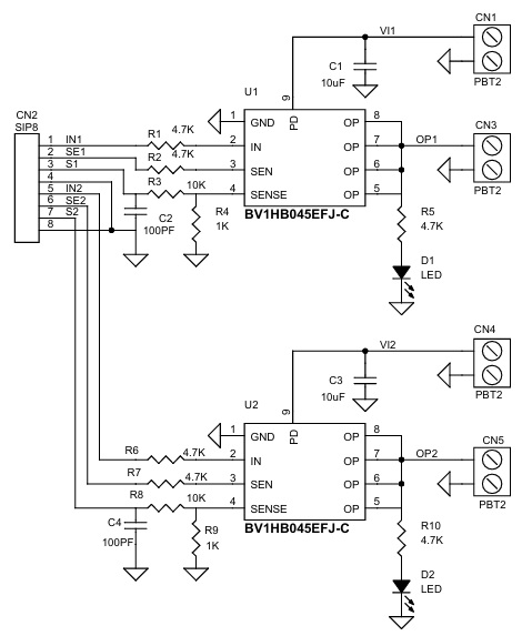

This is a two Channel high-side switch designed for automotive applications. It has a built-in overcurrent limit function, thermal shutdown protection function, open load detection function, low power output-OFF function etc. It also has a current sensing function of output load current.
  • Resistor R1, R2, R6, R7 limit resistance for the negative surge
  • Resistor R3, R8, capacitor C2, C4 for noise suppression filters
  • Power 6V to 28V DC
  • ON Resistance 45mOhmes
  • Built-in current sensing function
  • Built-in Dual TSD (Note 1)
  • Built-in Overcurrent Protection Function (OCP)
  • Built-in thermal shutdown protection function (TSD)
  • Built-in open load detection function
  • Built-in Low-Voltage Output-OFF Function (UVLO)
  • Built-in diagnostic output
  • Input Frequency 1Khz
  • Low On-Resistance Single Nch MOSFET Switch (On Resistance 45mOhm)

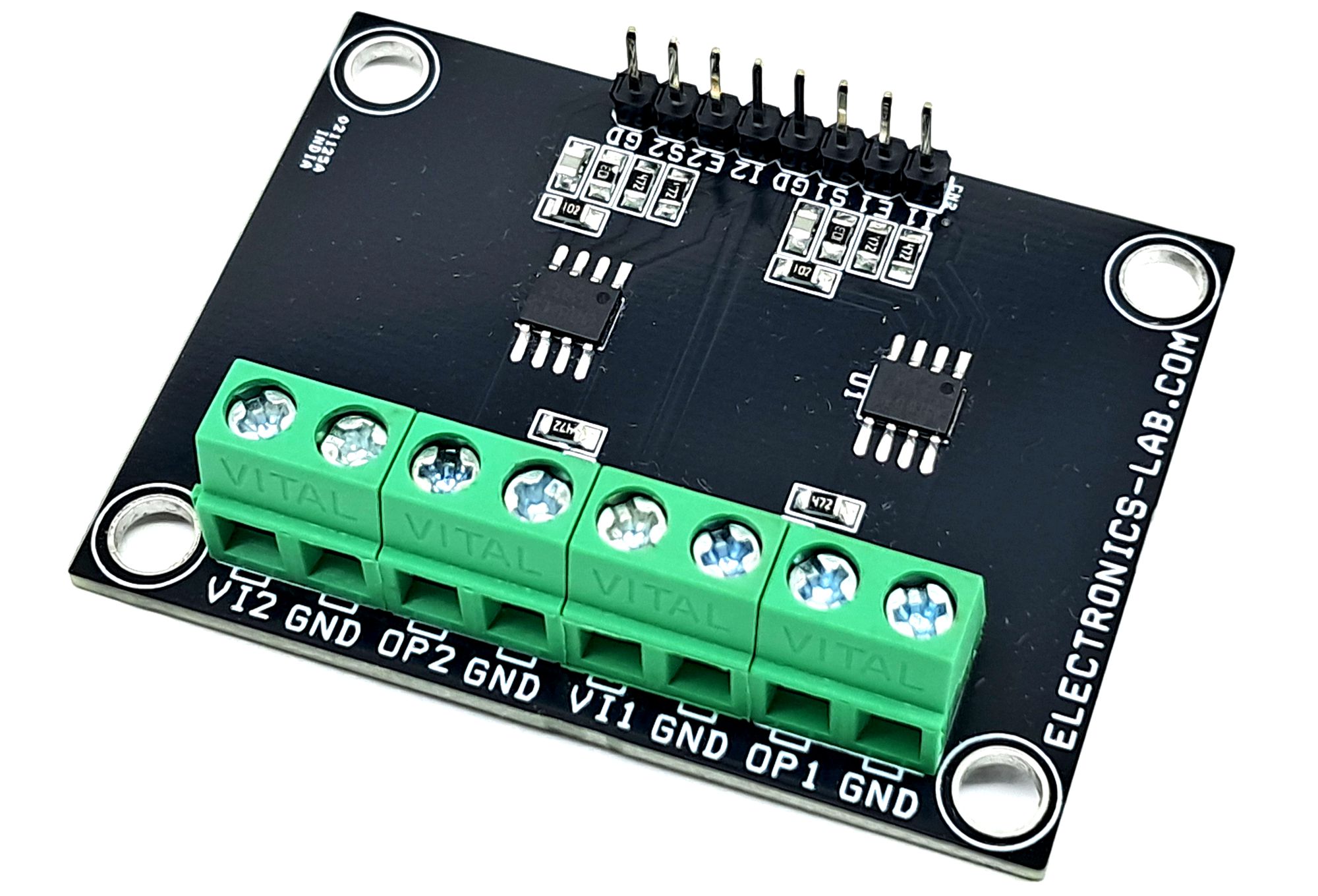

  • Screw Terminals for Loads and Power Input
  • Header Connector for Input, Current Sense
  • 4 x 4 mm Mounting Holes
  • PCB Dimensions 54.61 x 40.32 mm

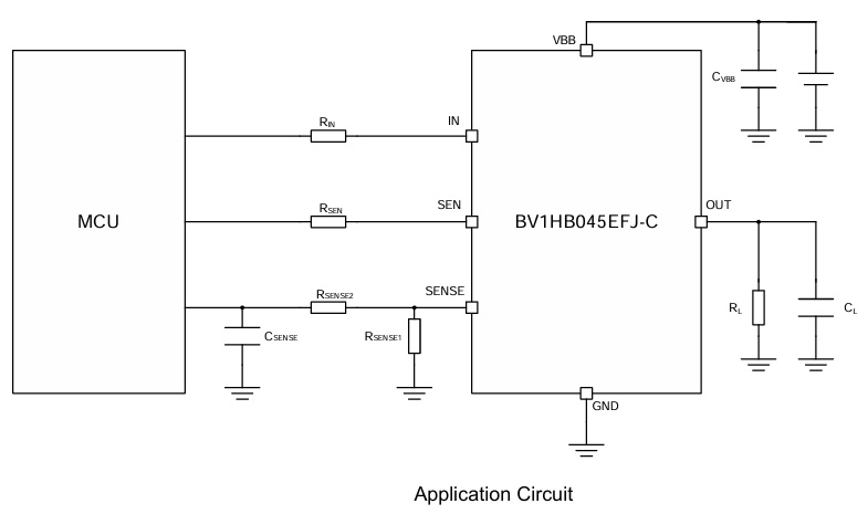

The sense voltage varies linearly according to the load current IOUT during normal operation The Vsense theoretical equation are shown bellow:
  • Vsense=Rsense/Isense
  • Isense=Iout/N
  • Vsense=RsenseXIout/N= 1000X2/1450 = 1.379V
  • Vsense=1.379V/2A

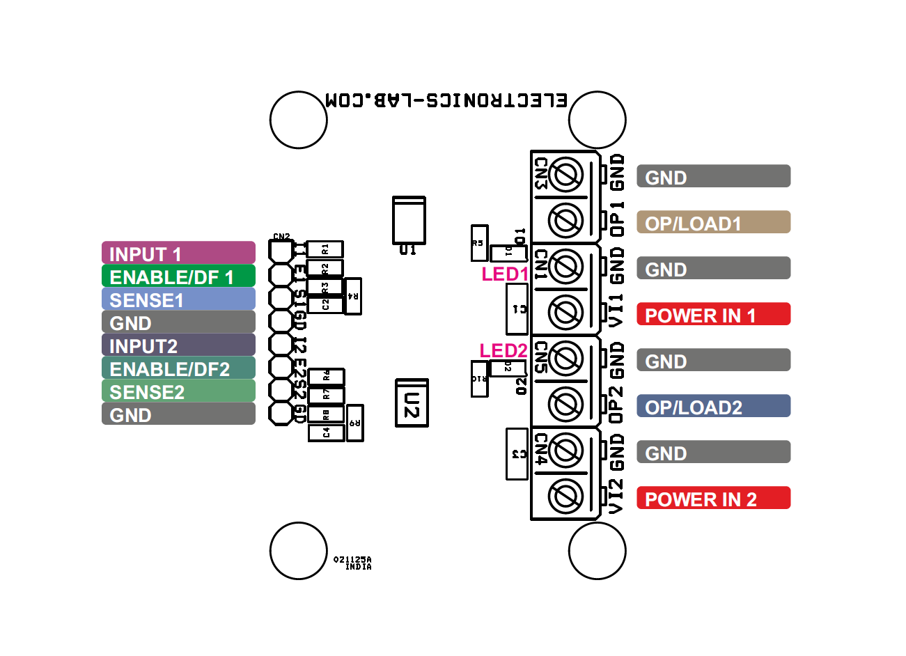

Connections
  • CN1: Pin 1 = VI1 Load Supply, Pin 2 = GND
  • CN3: Pin 1 = Load/OP1, Pin 2 = GND
  • CN4: Pin 1 = VI2 Load Supply, Pin 2 = GND
  • CN5: Pin 1 = Load/OP2, Pin 2 = GND
  • D1: Output 1 LED
  • D2: Output 2 LED
  • CN2: Pin 1 = Input 1, Pin 2 = Diagnostic/Sense/Enable 1, Pin 3 = Sense 1, Pin 4 = GND, Pin 5 = Input 2,Pin 6 = Diagnostic/Sense/Enable 2, Pin 7 =- Sense 2, Pin 8 = GND
Schematic

Application Schematic

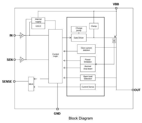

Block Diagram

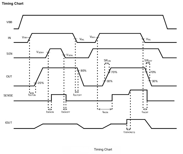

Timming Diagram

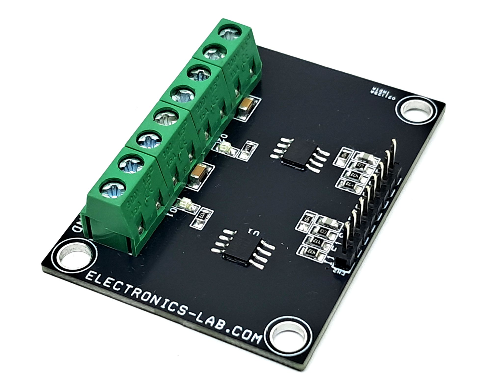

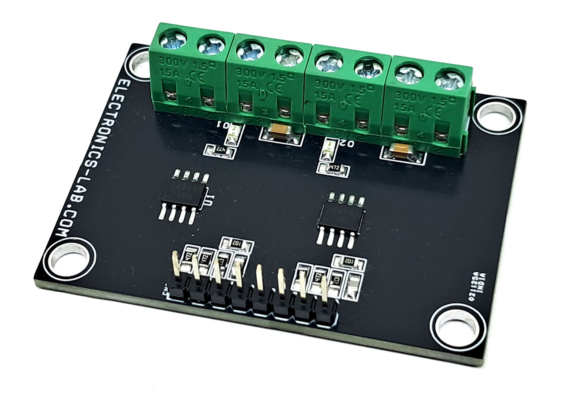

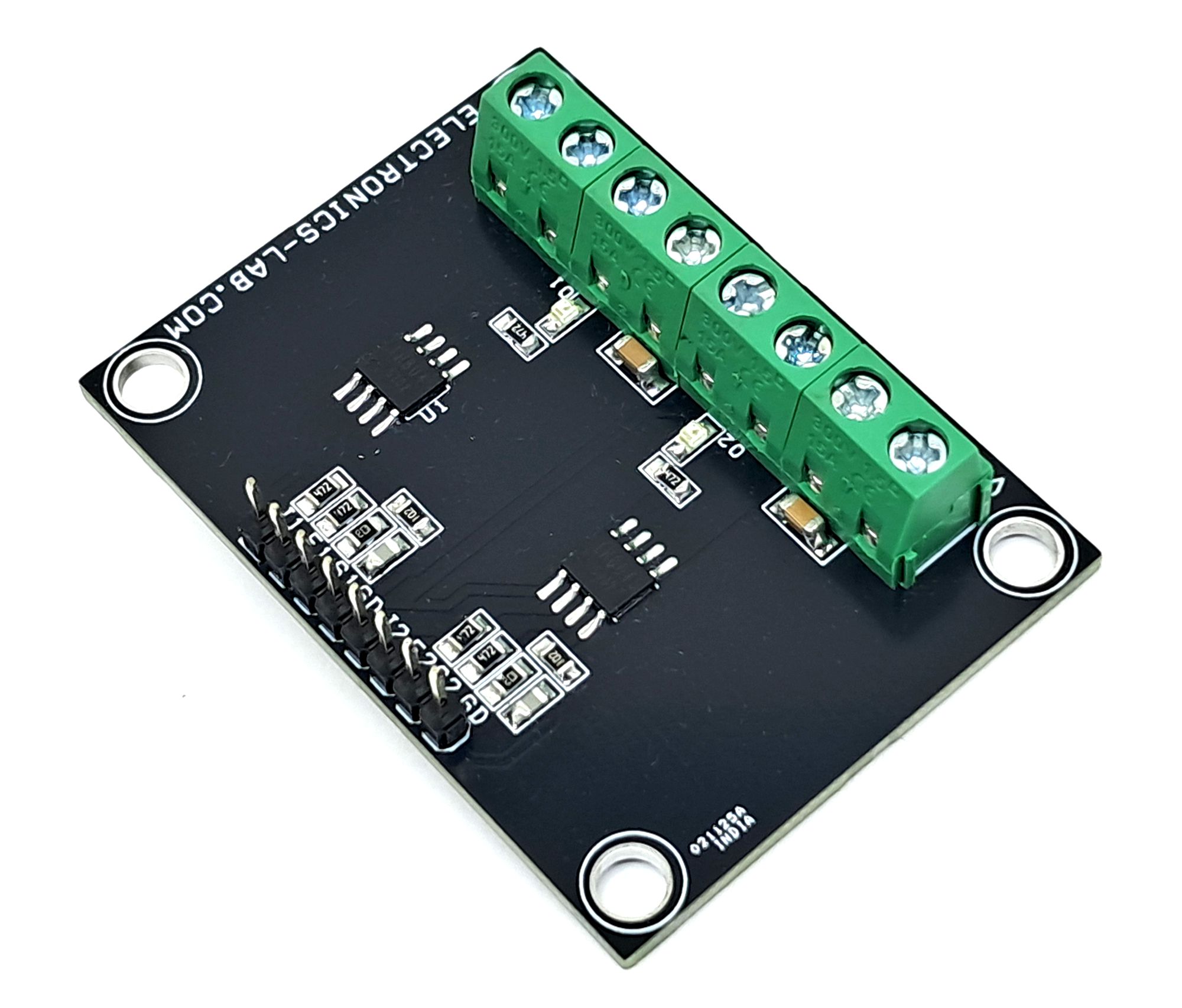

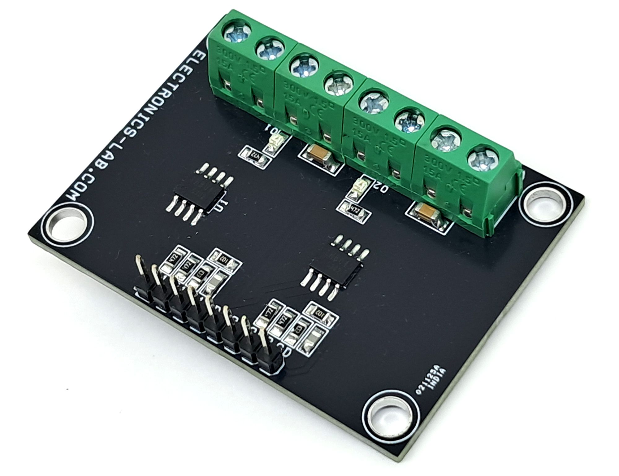

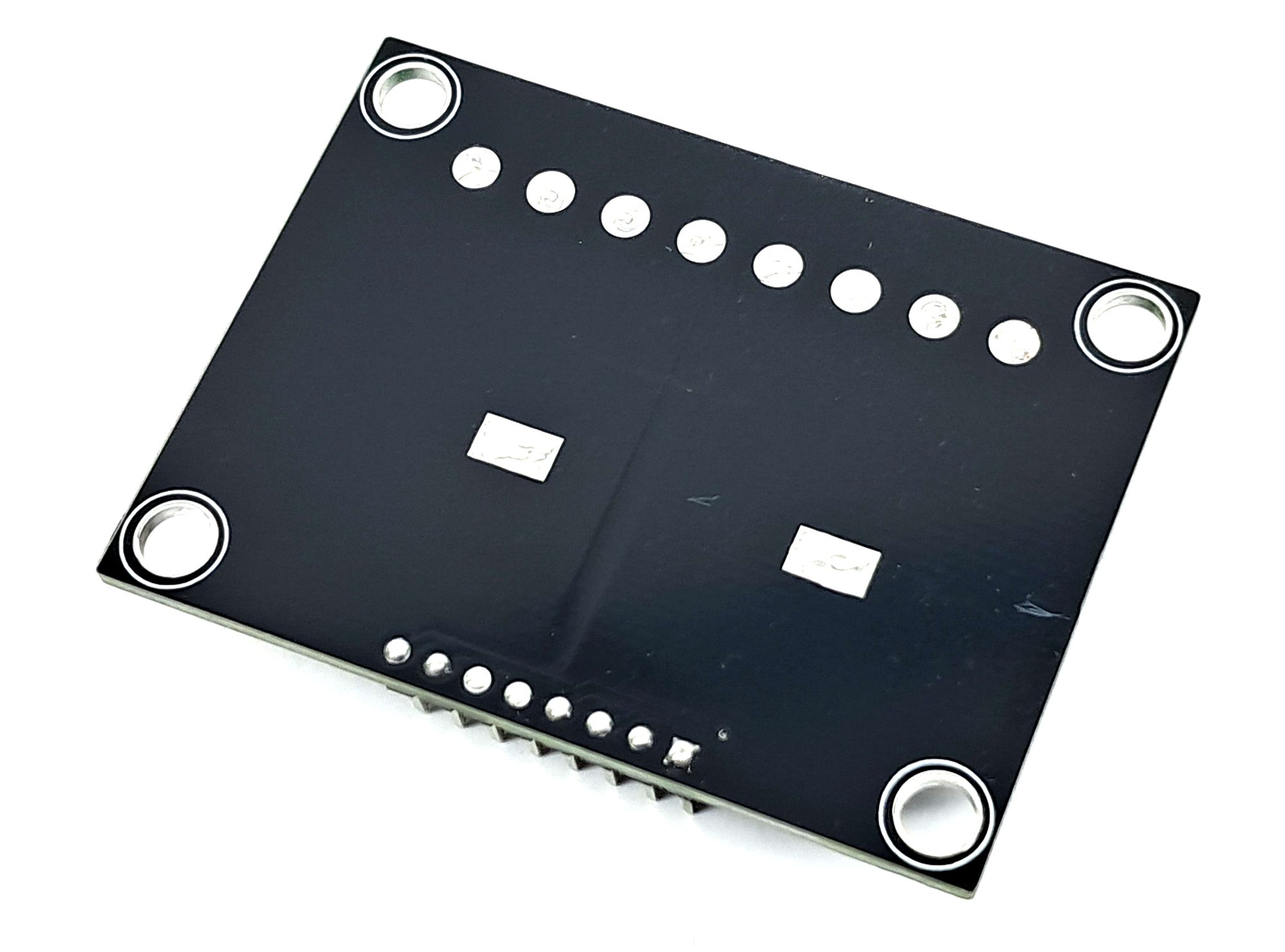

Photos
