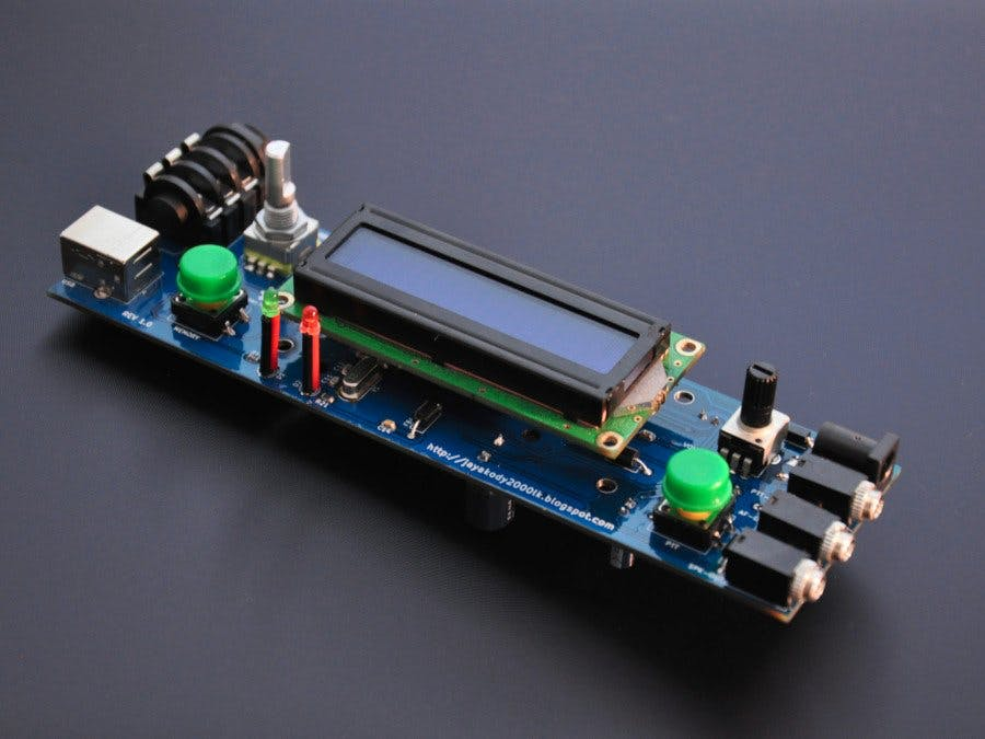

Fig.1 – The top side of the finished Auto keyer PCB.
To reduce the dimension of the PCB this unit is designed with combining both through-hole and surface mount components. To facilitate future upgrades and modifications, the PIC16F886 MCU sticks with the standard 28-pin DIP package.
