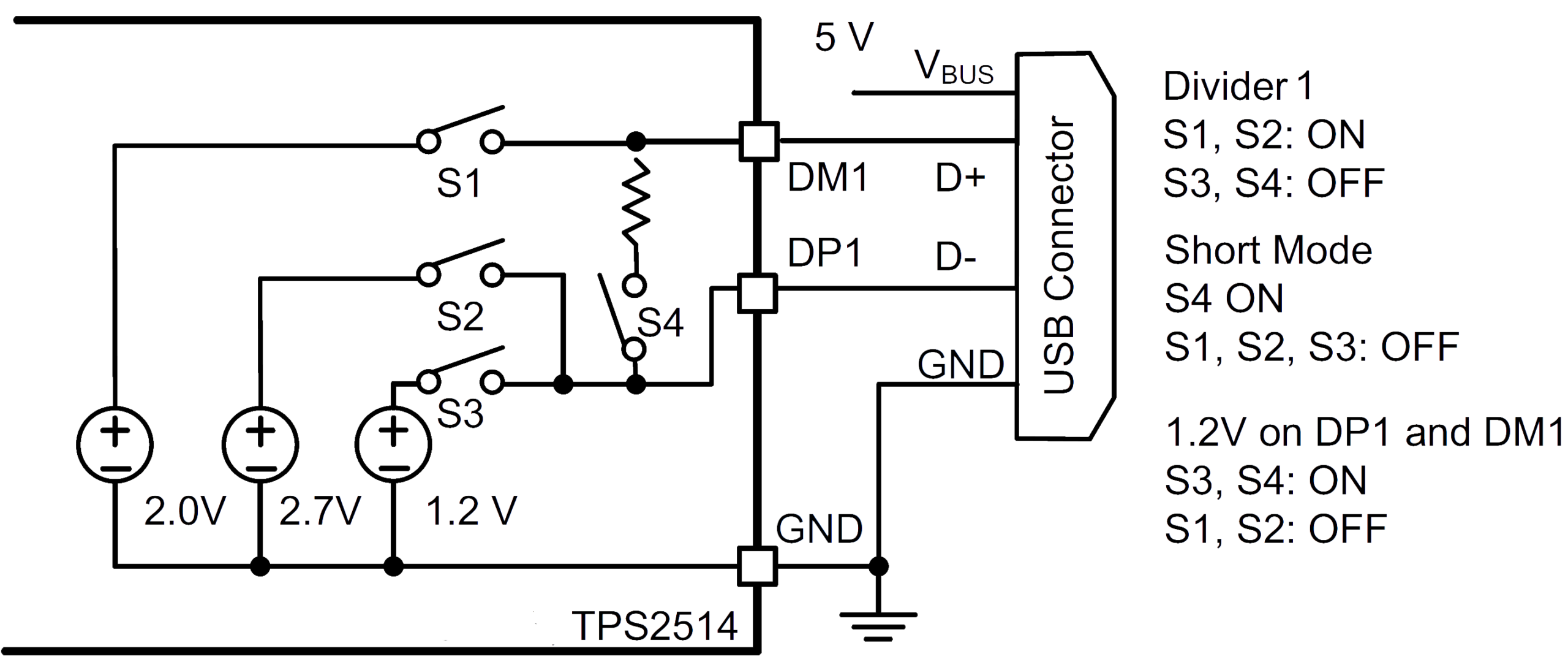

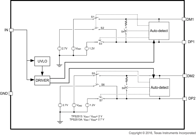

The TPS2514 IC is a USB dedicated charging port (DCP) controller. An auto-detect feature monitors USB data line voltage, and automatically provides the correct electrical signatures on the data lines to charge compliant devices among the following dedicated charging schemes:
  • Divider 1 DCP, required to apply 2 V and 2.7 V on the D+ and D– Lines respectively (TPS2513, TPS2514)
  • Divider 2 DCP, required to apply 2.7 V and 2 V on the D+ and D– Lines respectively (TPS2513, TPS2514)
  • Divider 3 DCP, required to apply 2.7 V and 2.7 V on the D+ and D– Lines respectively (TPS2513A, TPS2514A)
  • BC1.2 DCP, required to short the D+ Line to the D– Line
  • Chinese Telecom Standard YD/T 1591-2009 Shorted Mode, required to short the D+ Line to the D– Line
  • 1.2 V on both D+ and D– Lines

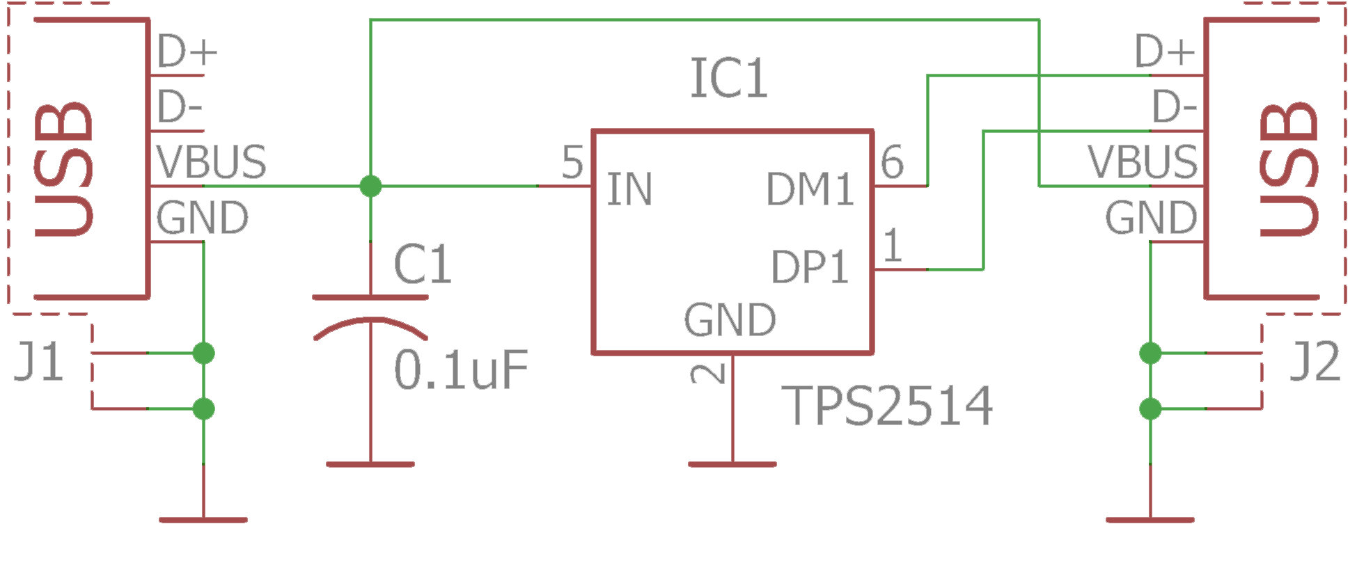

With TPS2514 device implementing the USB charging adapter is simple, see the schematic below. When charging Apple devices the current is limited to 1A as it is implemented Divider 1 charging schema with D+ = 2.0 V and D− = 2.7 V. Also, try to use good quality charging cables. The one particularly bad cable I was using introduced a significant voltage drop forcing my Samsung device switching to the slow charging mode.

  • Supports USB DCP Shorting D+ Line to D– Line per USB Battery Charging Specification, Revision 1.2 (BC1.2)
  • Supports Shorted Mode (Shorting D+ Line to D– Line) per Chinese Telecommunication Industry Standard YD/T 1591-2009
  • Supports USB DCP Applying 2.7 V on D+ Line and 2 V on D– line (or USB DCP Applying 2 V on D+ Line and 2.7 V on D– Line) (TPS2513, TPS2514)
  • Supports USB DCP Applying 2.7 V on D+ Line and 2.7 V on D– Line (TPS2513A, TPS2514A)
  • Supports USB DCP Applying 1.2 V on D+ and D– Lines
  • Automatically Switch D+ and D– Lines Connections for an Attached Device
  • Dual USB Port Controller (TPS2513, TPS2513A)
  • Single USB Port Controller (TPS2514, TPS2514A)

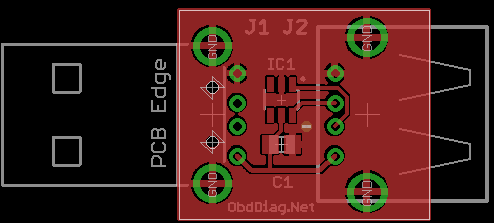

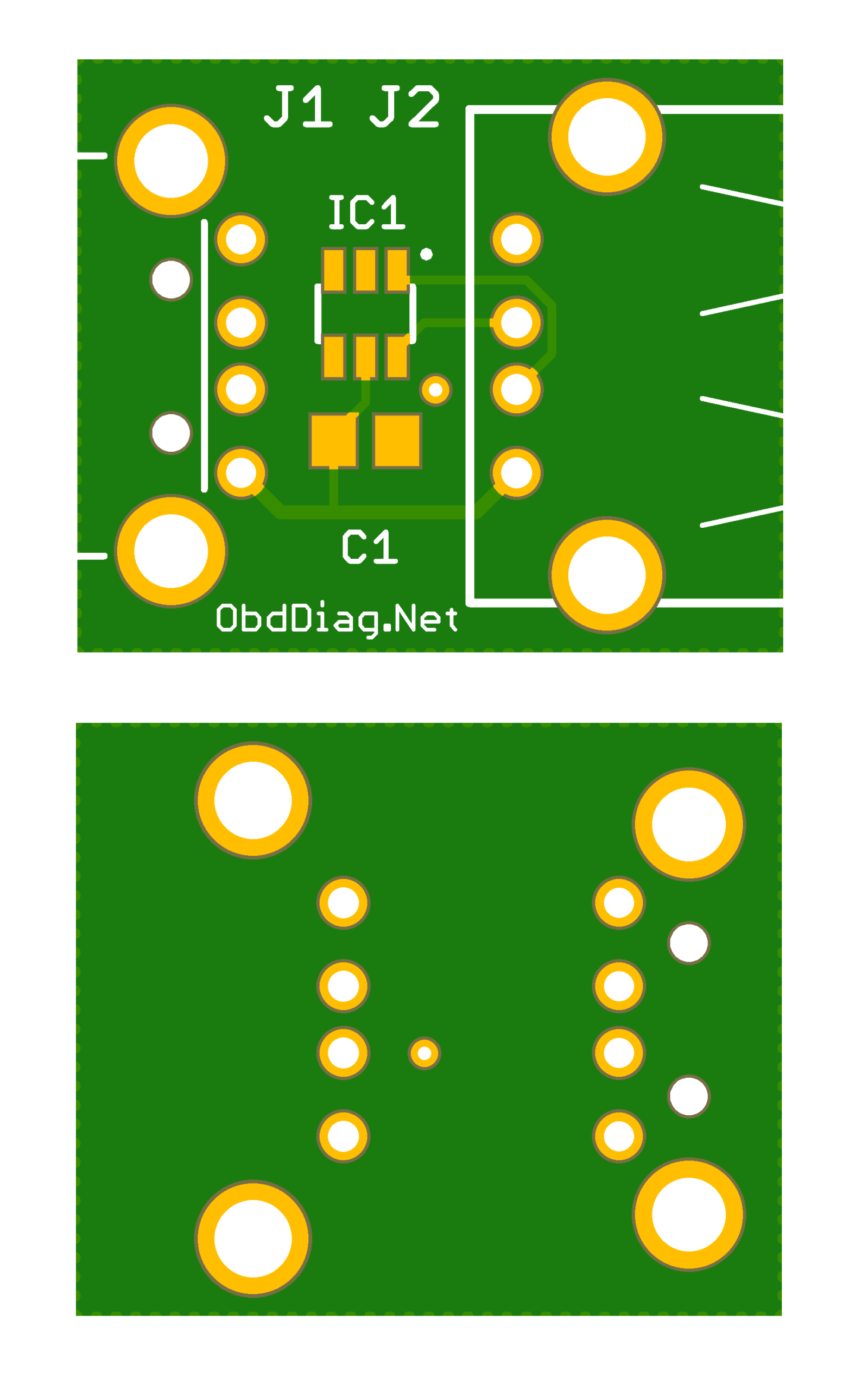

PCB
