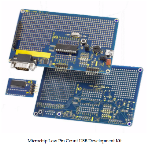

Most of hobby electronic projects still are in RS232 serial communications world. Think in that great market,
Microchip create a very smart line of microcontrollers, USB capable, to move your projects to future. They have great introductory kits, one of them is the “Low Pin Count USB Development Kit”.
microchip_low_pin_count
These boards contain a PIC18F14K50 microcontroller and can help you to grow up your USB knowledge and with a few steps you still able to create a mouse device, a USB temperature meter or a USB-Serial converter.

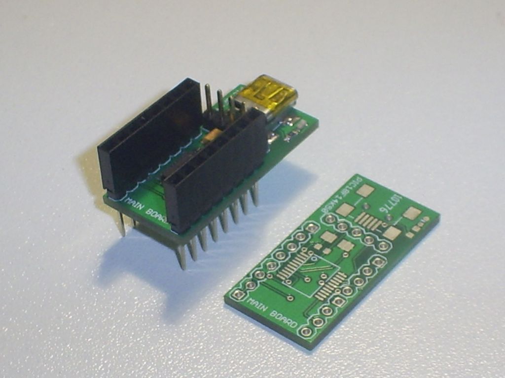

My Project

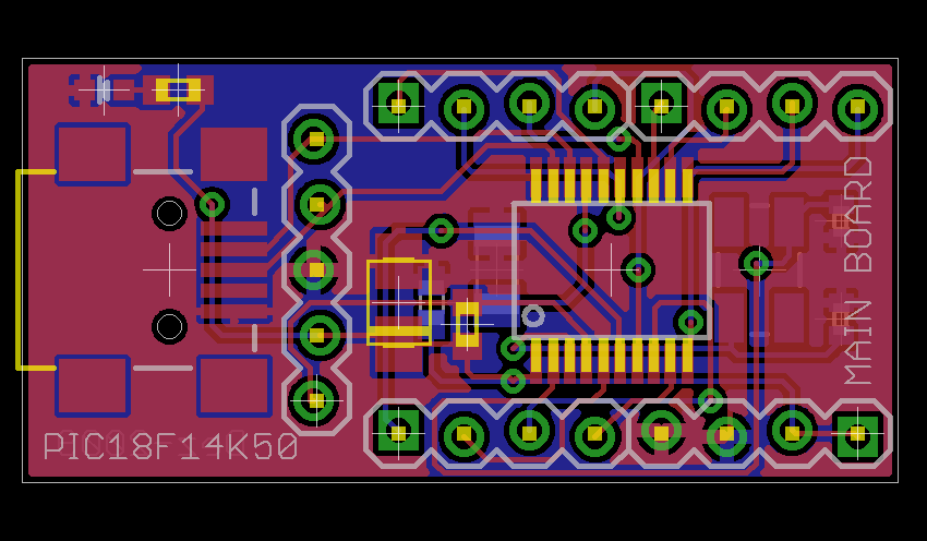

My idea is create a little board with most of Microchip kit, but less parts then all these boards. Only the basic
components to get the microcontroller up and running the Microchip USB Library examples. PIC18F14K50 is a really
basic device and after some research I found what you can do and what you can not do with it:
  • What you can do: USB HID (Human Interface Devices) like mouse, keyboards, sensors, serial-usb converters, etc
  • What you can not do: USB storage devices, like USB flash drives
USB storage is a problem because of memory limitations on PIC18F14K50 family.

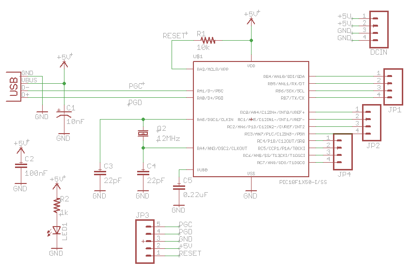

The circuit design is very simples. Basically all you need is
  • PIC18F14K50;
  • 12MHz Crystal;
  • USB connector;
The circuit still have a ICSP header for device programming and debugging. It’s USB powered, so you can pay
attention on current drain (500mA max.). See below:
Schematic

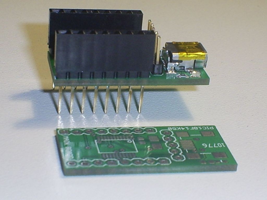

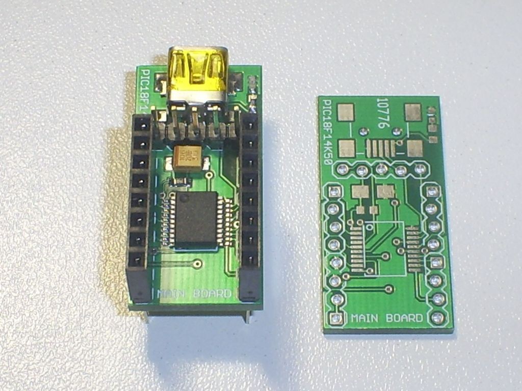

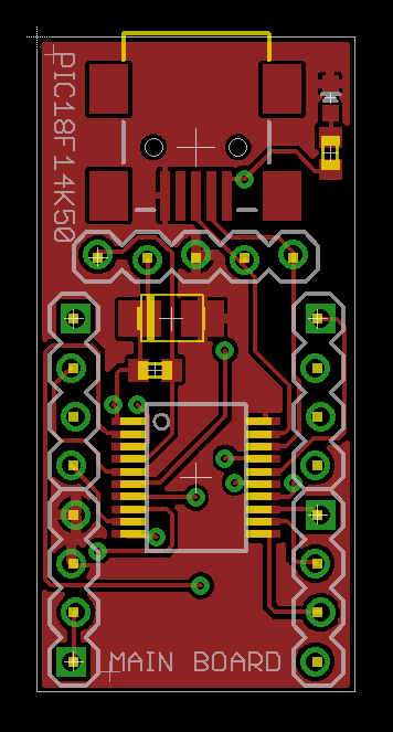

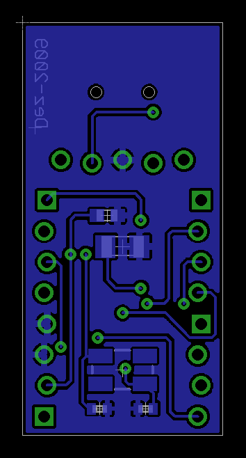

The board is very simple and clean. I want a little device to put on breadboard or stay alone, with headers to
connect wires and breakout boards. I don’t put a RESET switch on board because I think it’s not necessary (does your mouse have a reset button?). The final design you can view above:
board_bottom_layer
Bottom Layer
board_top_layer
Top Layer

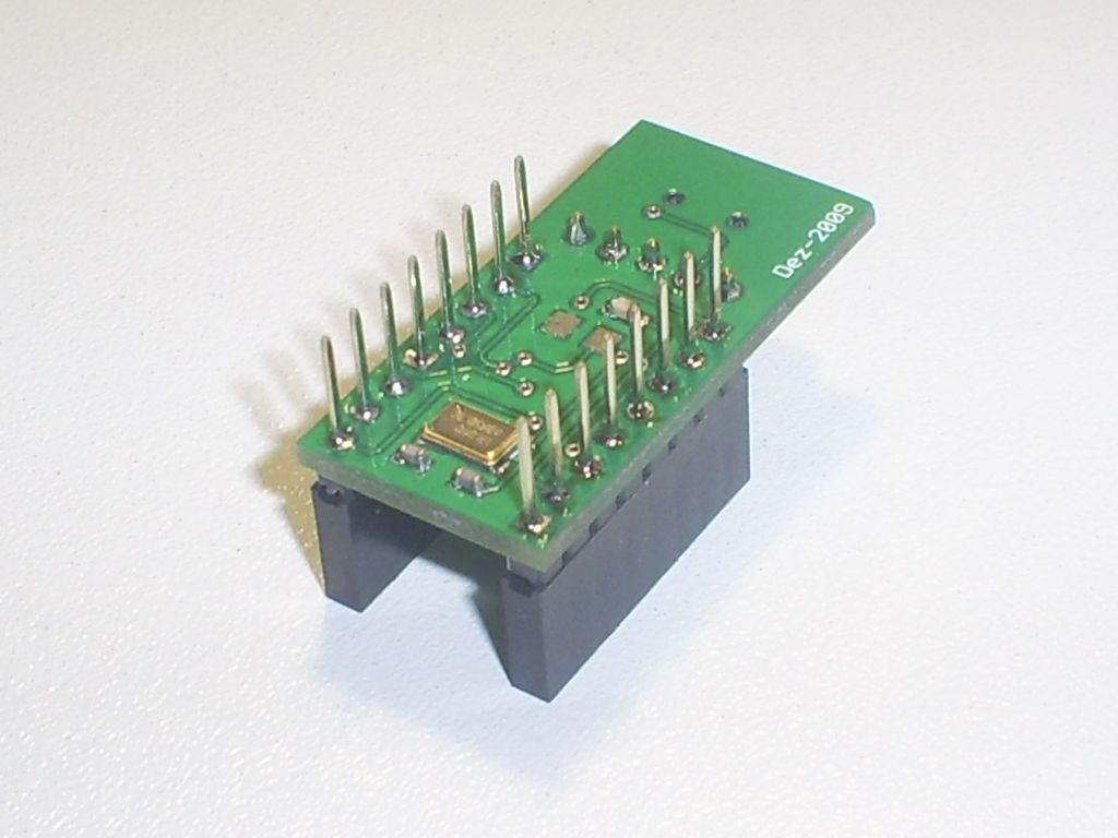

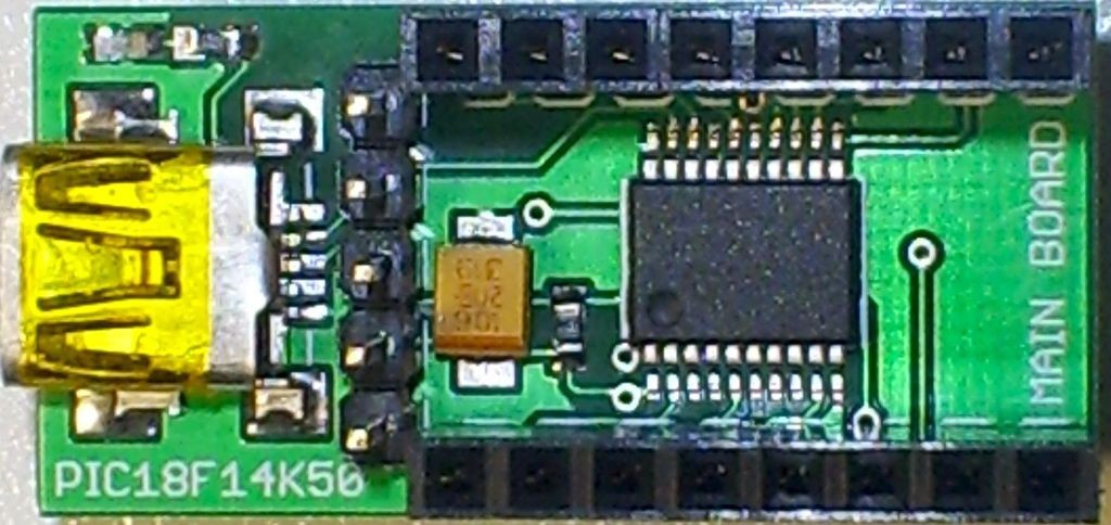

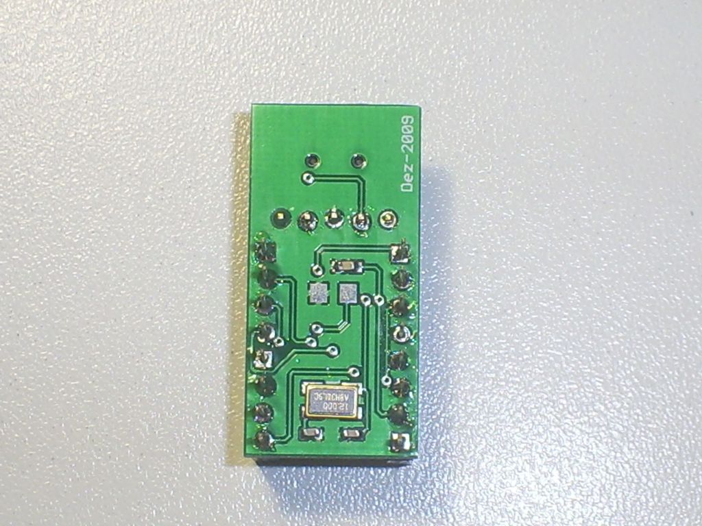

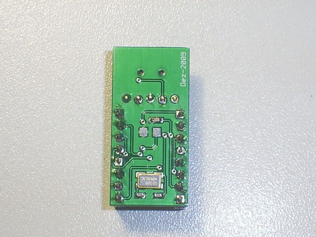

SAMSUNG DIGIMAX A503
Real board after solder

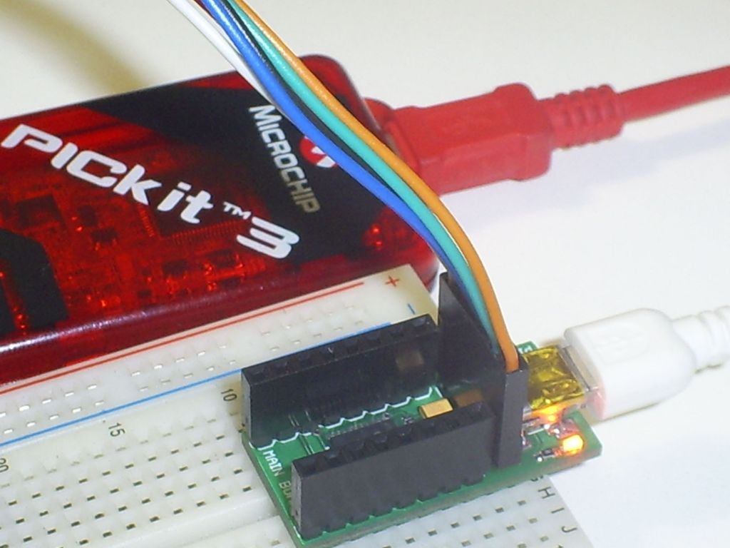

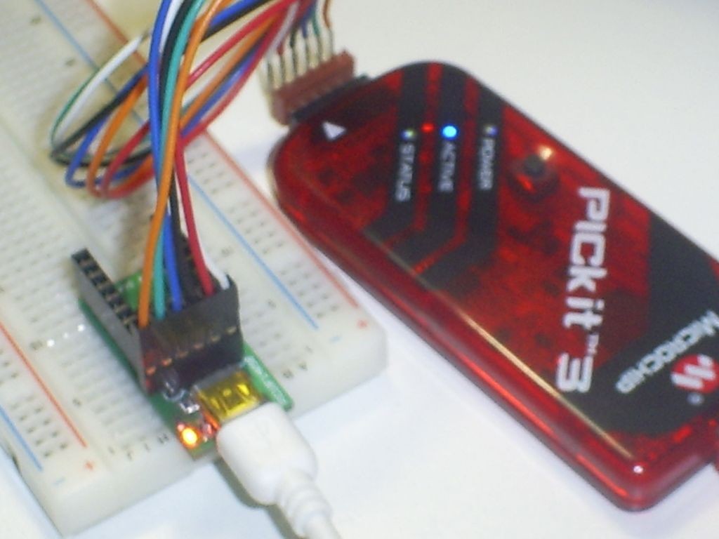

After finish the project I make some tests. The board is very functional and easy to use. To program it I use my PicKit3 program, directly in ICSP connector:
Programming via PicKit3

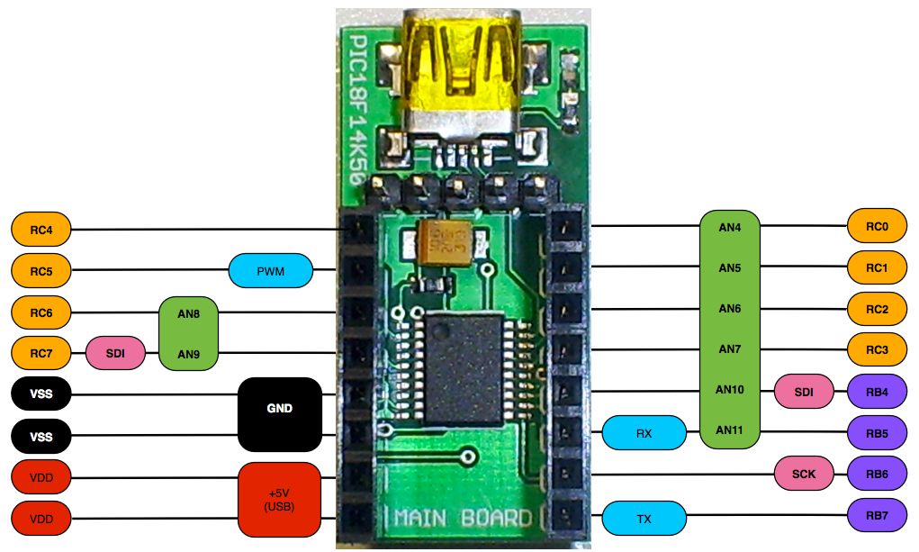

Because the board space, there’s no labels on MCU pins, so I draw a little card to help my mind:
USBLowPinKit_ReferenceCard

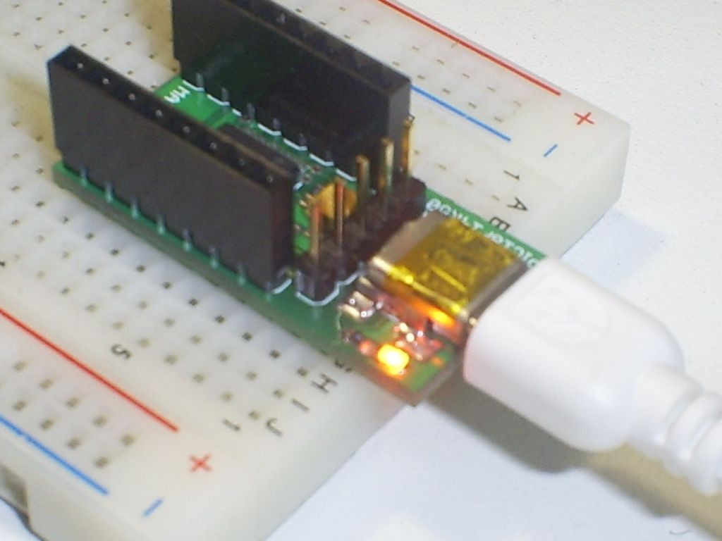

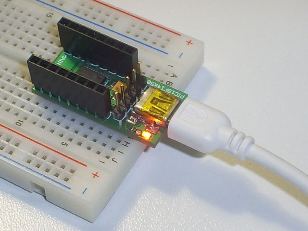

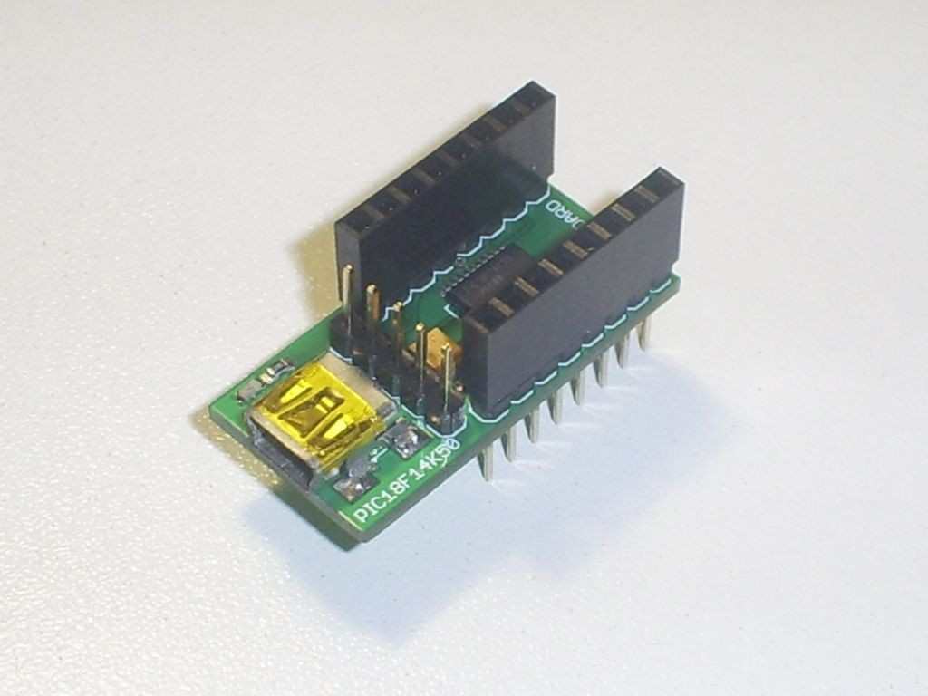

I’ve used long terminal header, to plug it in breadboard. See the next pictures:
After some tests I’m very happy, because:
  • All Microchip original kit projects work with my board;
  • My knowledge on USB grow up;
  • The board is very small, so designs like a mouse with accelerometers is easy to implement;
