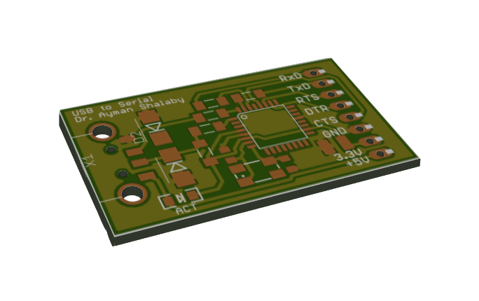

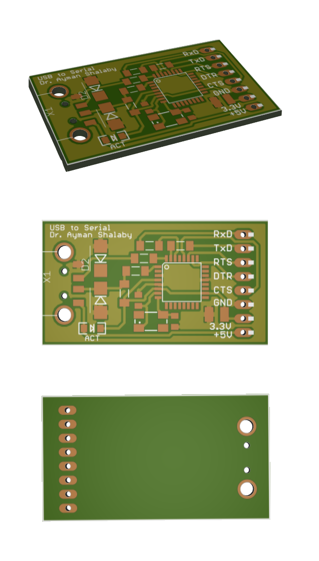

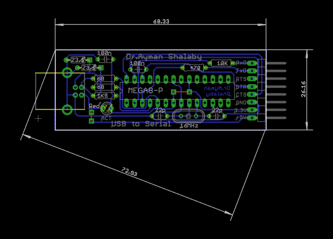

USB to Serial Converter using AVR microcontroller

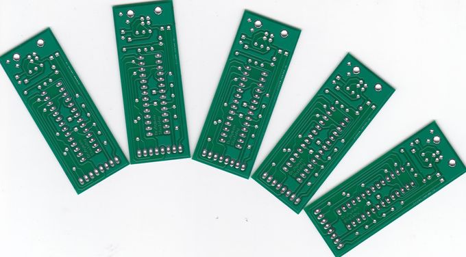

This project is a USB to Serial converter using an ATMEL AVR microcontroller. There are two version of the converter, one with SMD parts and another with TH parts.
3D_PCB_SMD_first
This project is a USB to Serial converter using an ATMEL AVR microcontroller. There are two version of the converter, one with SMD parts and another with TH parts. The mcu used is an ATmega8 and USB communication is done using software on AVR mcu. It’s based on the software USB implementation of AVR-CDC. Firmware can be downloaded from the download section of CDC-RS232.

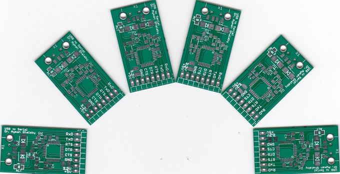

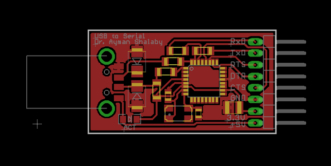

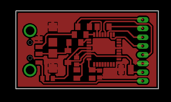

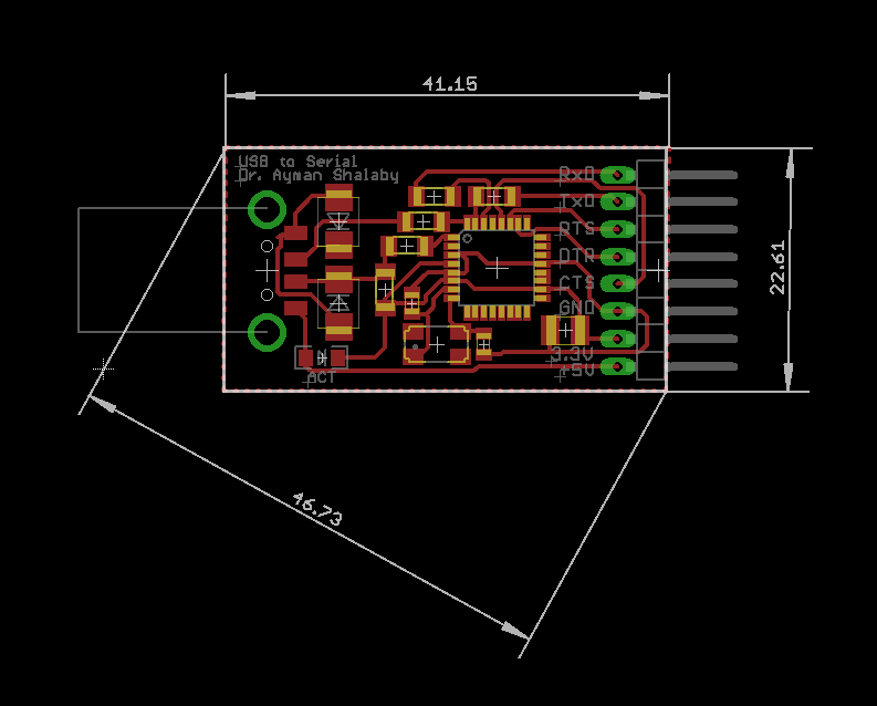

SMD version
Schematic_SMD

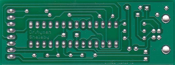

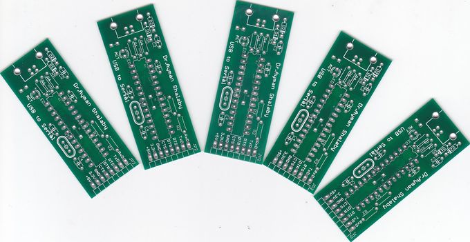

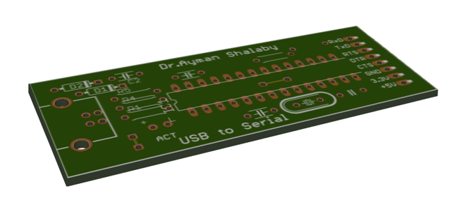

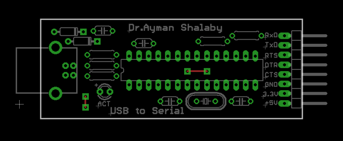

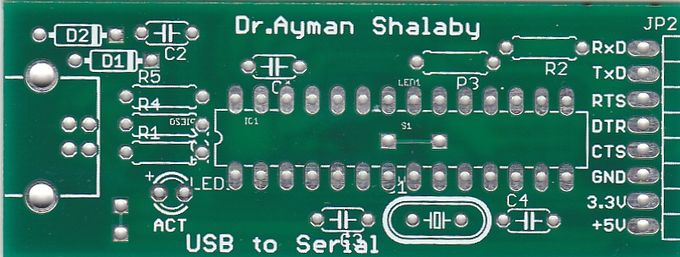

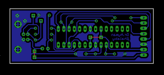

Throught hole version
3D_PCB_first

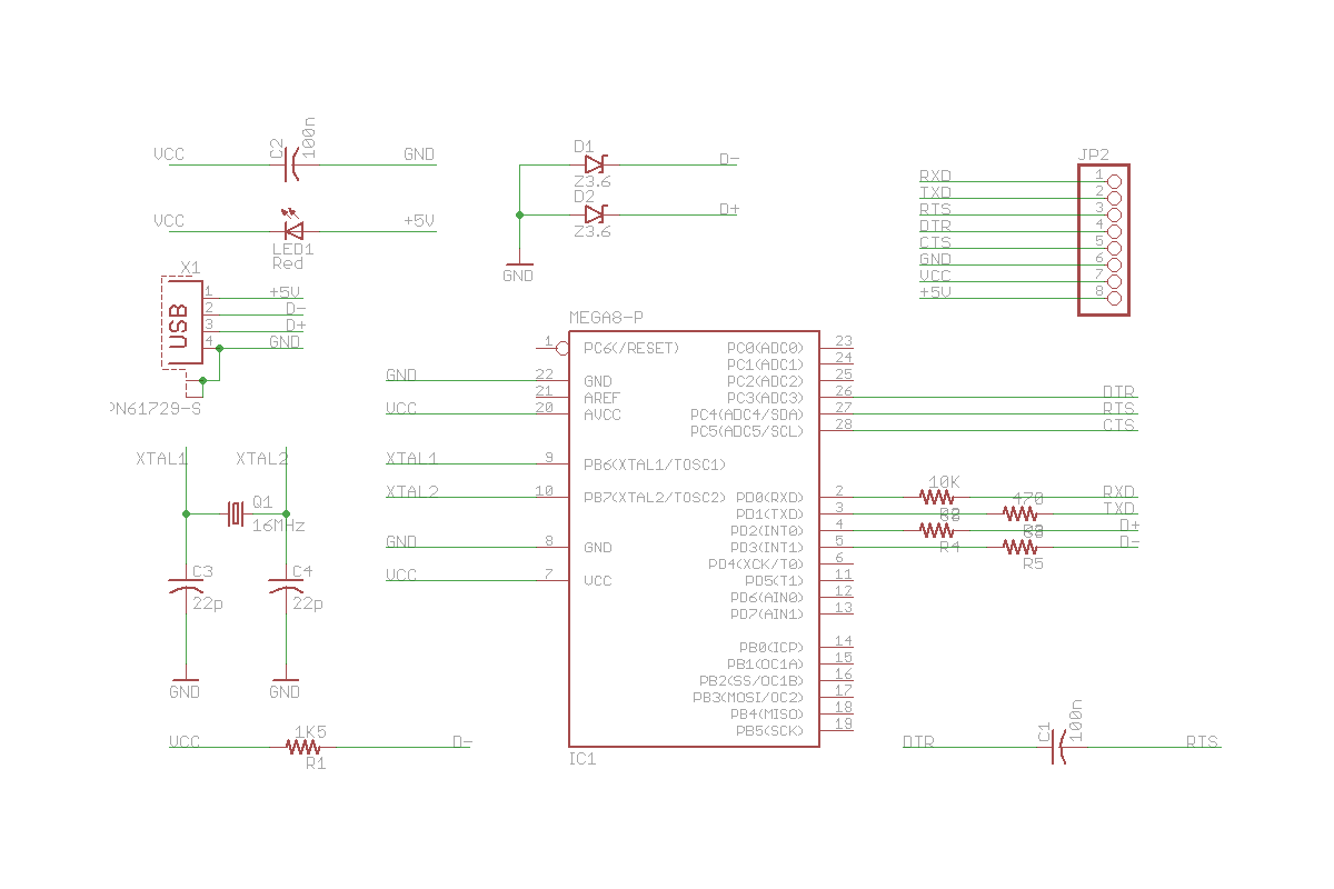

Schematic
IMG_0004
IMG_0005
IMG_0002
IMG_0003

Sir Ayman, I’m trying to install the driver. I’m using a Atmega328p. My O.S. is a Windows 7 64 bits Ultimate. I follow all the instructions on “Read Me 64 File”. But, doesn’t work yet. The Device is not recognized. And your schematics here in this page, you use a 16 Mhz crystal. But, in CDC 232 page, you use a 12 Mhz Crystal. In the Hex file from CDC 232 page, the 328p Hex file, needs a 12 Mhz and I’m using this. But, there is a Hex File for a 328p with 16 Mhz clock ? since from now, sorry for my terrible self-taught english and thank you Sir in advance for your attention and help.

Just wondering – for the smd version of your board, there is no ISP header. How do you load the firmware into the ATmega8?
