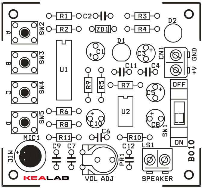

  • Input – 6 VDC @ 300 mA
  • Output – Speaker, 8 Ω / 0.5 W
  • 7 Step level shifting (Volume Control) SW3 (TGU) and SW4 (TGD)
  • SW2 – Vibrato mode, SW5 – robot mode
  • LED to display the voice level input
  • ON/OFF slide switch for power supply
  • Audio amplifier type LM386 with volume control preset
  • PBT (Power Battery Terminal) connectors for supply voltage and speaker output
  • Power-On LED indicator

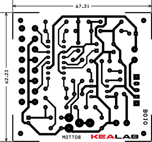

  • PCB dimensions 63 mm x 68 mm
CN1 – 6 VDC Supply Input
MIC1 – Electret Condenser Microphone
LS1 – Speaker

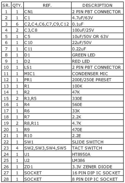

Parts List
VOICE_MODULATOR_BOM
