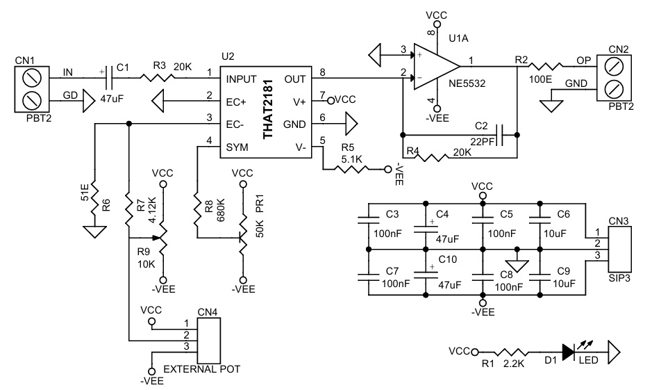

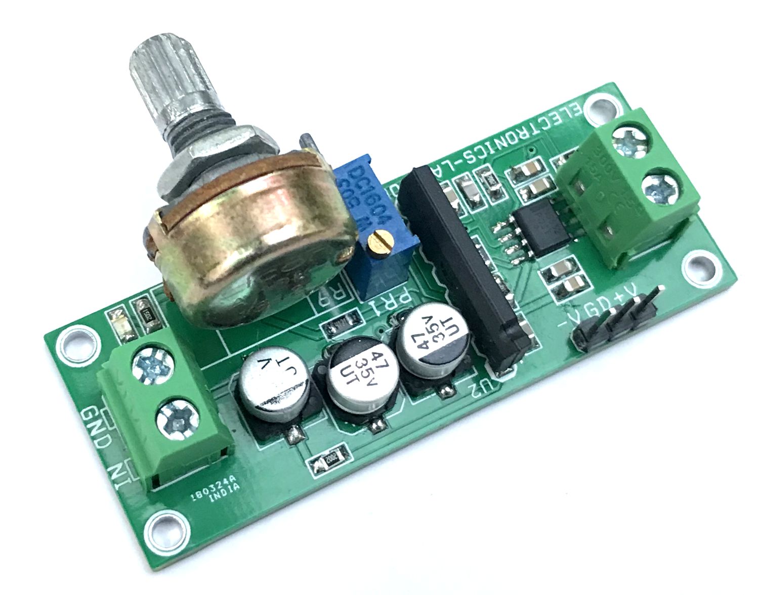

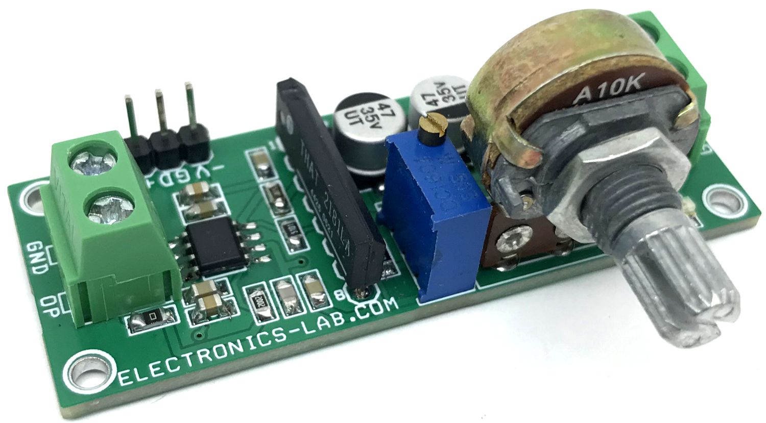

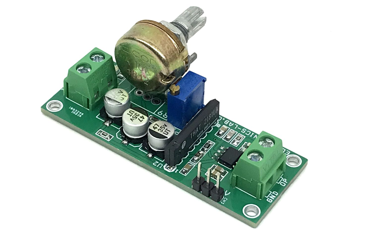

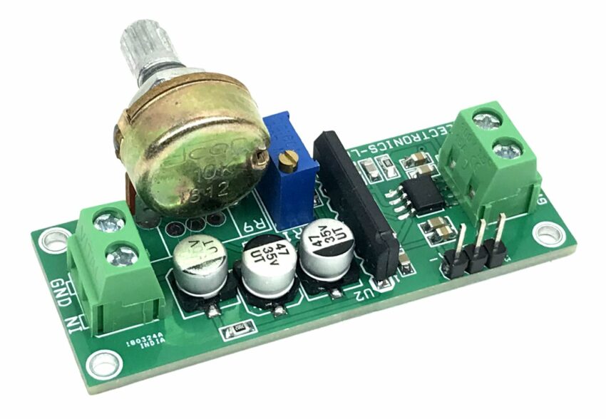

The project presented here is a Voltage Controlled Amplifier (VCA). A VCA board helps users control the Audio Level from a remote potentiometer.

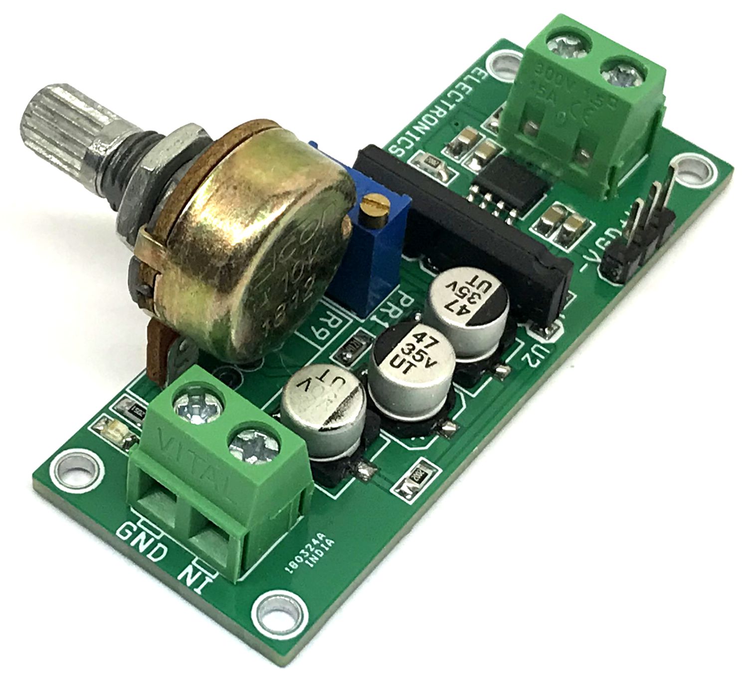

The project presented here is a Voltage Controlled Amplifier (VCA). A VCA board helps users control the Audio Level from a remote potentiometer. It requires a single-ended audio signal in the input. Gain control voltage can be adjusted through an on-board potentiometer or use an external potentiometer connected to CN4. The project works with a dual ±15V power supply. Screw terminal connectors are provided for signal input and signal output. The project is built using THAT2181LA chip, a VCA that is designed for high-performance audio-frequency applications requiring exponential gain control, low distortion, wide dynamic range, and low control-voltage feedthrough. These parts control gain by converting an input current signal to a bipolar logged voltage, adding a DC control voltage, and re-converting the summed voltage back to a current through a bipolar antilog circuit. Stereo control of VCA with a single potentiometer is possible.
THAT 2181-series trimmable Blackmer voltage-controlled amplifier (VCAs) ICs are very high-performance current-in/current-out devices with two opposing-polarity, voltage-sensitive control ports. They offer wide-range exponential control of gain and attenuation with low signal distortion.
Trimming
The trim should be adjusted for minimum harmonic distortion using PR1. This is usually done by applying a middle-level, middle-frequency signal (e.g. 1 kHz at 1 V) to the audio input, setting the VCA to 0 dB gain, and adjusting the SYM trim while observing THD at the output. In THAT2181LA, this adjustment coincides closely with the setting which produces minimum control-voltage feedthrough, though the two settings are not always identical.
- Power Supply +/-15V DC @ 40mA
- Gain Range -100dB Min-+20dB Maximum
- Total Harmonic Distortion 1V 0dB Gain 0.0025%
- Screw Terminal for Single-Ended Audio Input
- Input Impedance, Audio 20K Ohms
- Screw Terminal for Audio Output
- On Board Power LED
- 5mm Mounting Holes
- PCB Dimensions 60.96 x 23.50 mm

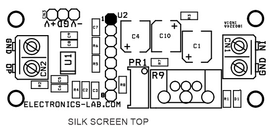

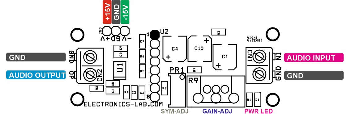

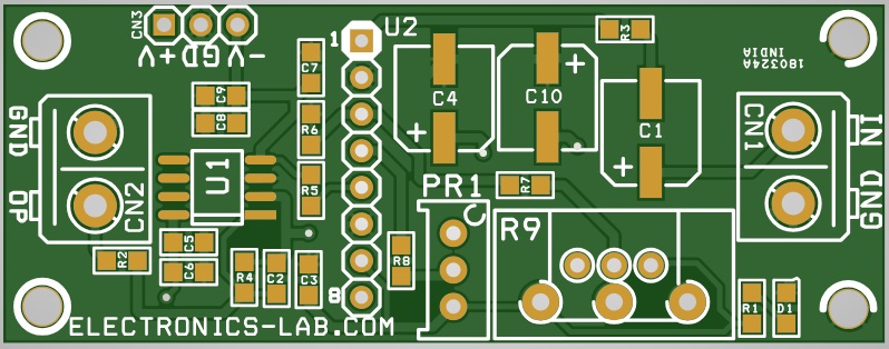

Connection
- CN1: Pin 1 = Audio Signal Input, Pin 2 = GND
- CN2: Pin 1 = Audio Output, Pin 2 = GND
- CN1: Pin 1 = +15V DC, Pin 2 = GND, Pin 3 = -15V DC
- R9: Gain Adjust Potentiometer
- CN4: Optional External Gain Adjust Potentiometer
- D1: Power LED
Schematic

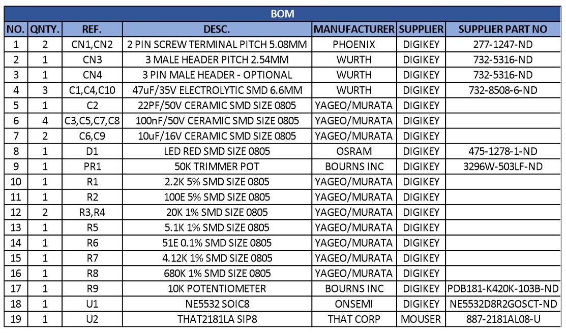

Parts List
| NO. | QNTY. | REF. | DESC. | MANUFACTURER | SUPPLIER | SUPPLIER PART NO |
| 1 | 2 | CN1,CN2 | 2 PIN SCREW TERMINAL PITCH 5.08MM | PHOENIX | DIGIKEY | 277-1247-ND |
| 2 | 1 | CN3 | 3 MALE HEADER PITCH 2.54MM | WURTH | DIGIKEY | 732-5316-ND |
| 3 | 1 | CN4 | 3 PIN MALE HEADER - OPTIONAL | WURTH | DIGIKEY | 732-5316-ND |
| 4 | 3 | C1,C4,C10 | 47uF/35V ELECTROLYTIC SMD 6.6MM | WURTH | DIGIKEY | 732-8508-6-ND |
| 5 | 1 | C2 | 22PF/50V CERAMIC SMD SIZE 0805 | YAGEO/MURATA | DIGIKEY | |
| 6 | 4 | C3,C5,C7,C8 | 100nF/50V CERAMIC SMD SIZE 0805 | YAGEO/MURATA | DIGIKEY | |
| 7 | 2 | C6,C9 | 10uF/16V CERAMIC SMD SIZE 0805 | YAGEO/MURATA | DIGIKEY | |
| 8 | 1 | D1 | LED RED SMD SIZE 0805 | OSRAM | DIGIKEY | 475-1278-1-ND |
| 9 | 1 | PR1 | 50K TRIMMER POT | BOURNS INC | DIGIKEY | 3296W-503LF-ND |
| 10 | 1 | R1 | 2.2K 5% SMD SIZE 0805 | YAGEO/MURATA | DIGIKEY | |
| 11 | 1 | R2 | 100E 5% SMD SIZE 0805 | YAGEO/MURATA | DIGIKEY | |
| 12 | 2 | R3,R4 | 20K 1% SMD SIZE 0805 | YAGEO/MURATA | DIGIKEY | |
| 13 | 1 | R5 | 5.1K 1% SMD SIZE 0805 | YAGEO/MURATA | DIGIKEY | |
| 14 | 1 | R6 | 51E 0.1% SMD SIZE 0805 | YAGEO/MURATA | DIGIKEY | |
| 15 | 1 | R7 | 4.12K 1% SMD SIZE 0805 | YAGEO/MURATA | DIGIKEY | |
| 16 | 1 | R8 | 680K 1% SMD SIZE 0805 | YAGEO/MURATA | DIGIKEY | |
| 17 | 1 | R9 | 10K POTENTIOMETER | BOURNS INC | DIGIKEY | PDB181-K420K-103B-ND |
| 18 | 1 | U1 | NE5532 SOIC8 | ONSEMI | DIGIKEY | NE5532D8R2GOSCT-ND |
| 19 | 1 | U2 | THAT2181LA SIP8 | THAT CORP | MOUSER | 887-2181AL08-U |
Connections

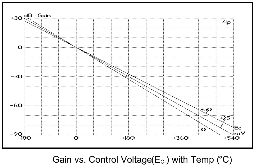

Gain vs Control Voltage
