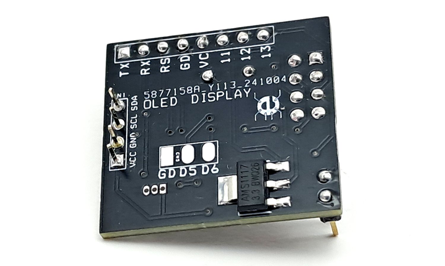

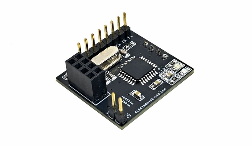

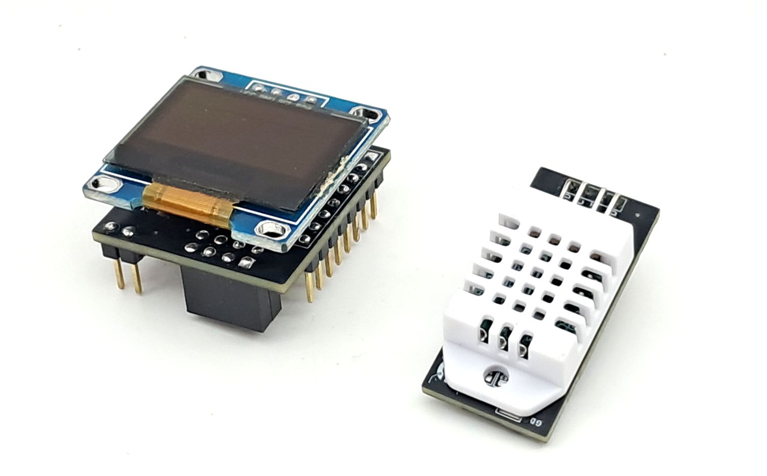

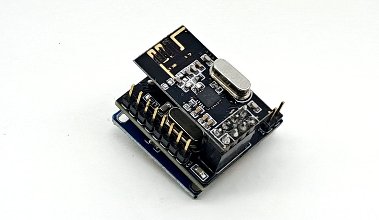

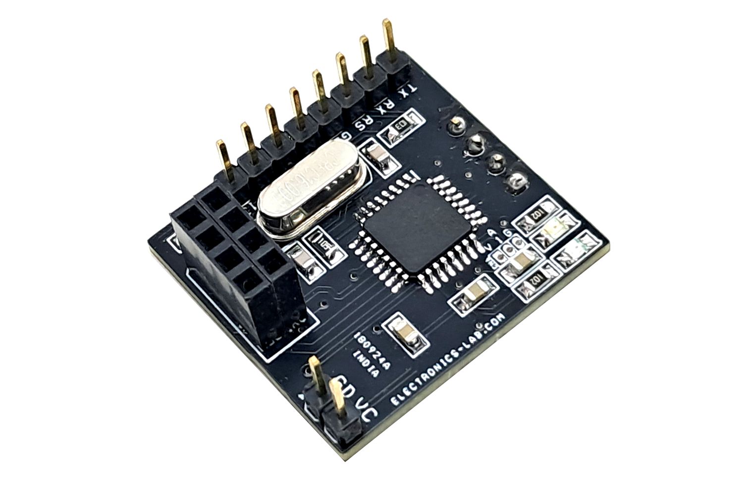

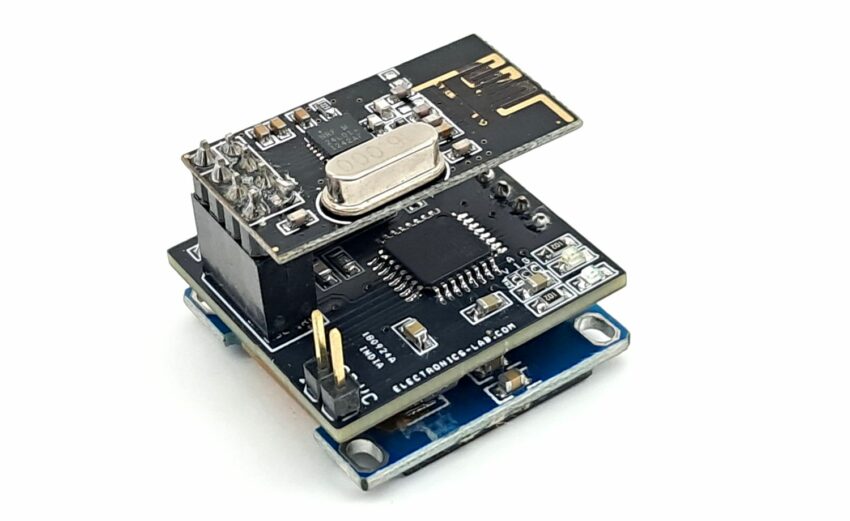

This project is the receiving end of a Wireless Humidity and Temperature monitoring system. The receiver unit is built around an Arduino microcontroller, utilizing the ATMEGA328 chip, which provides a reliable and efficient processing platform.

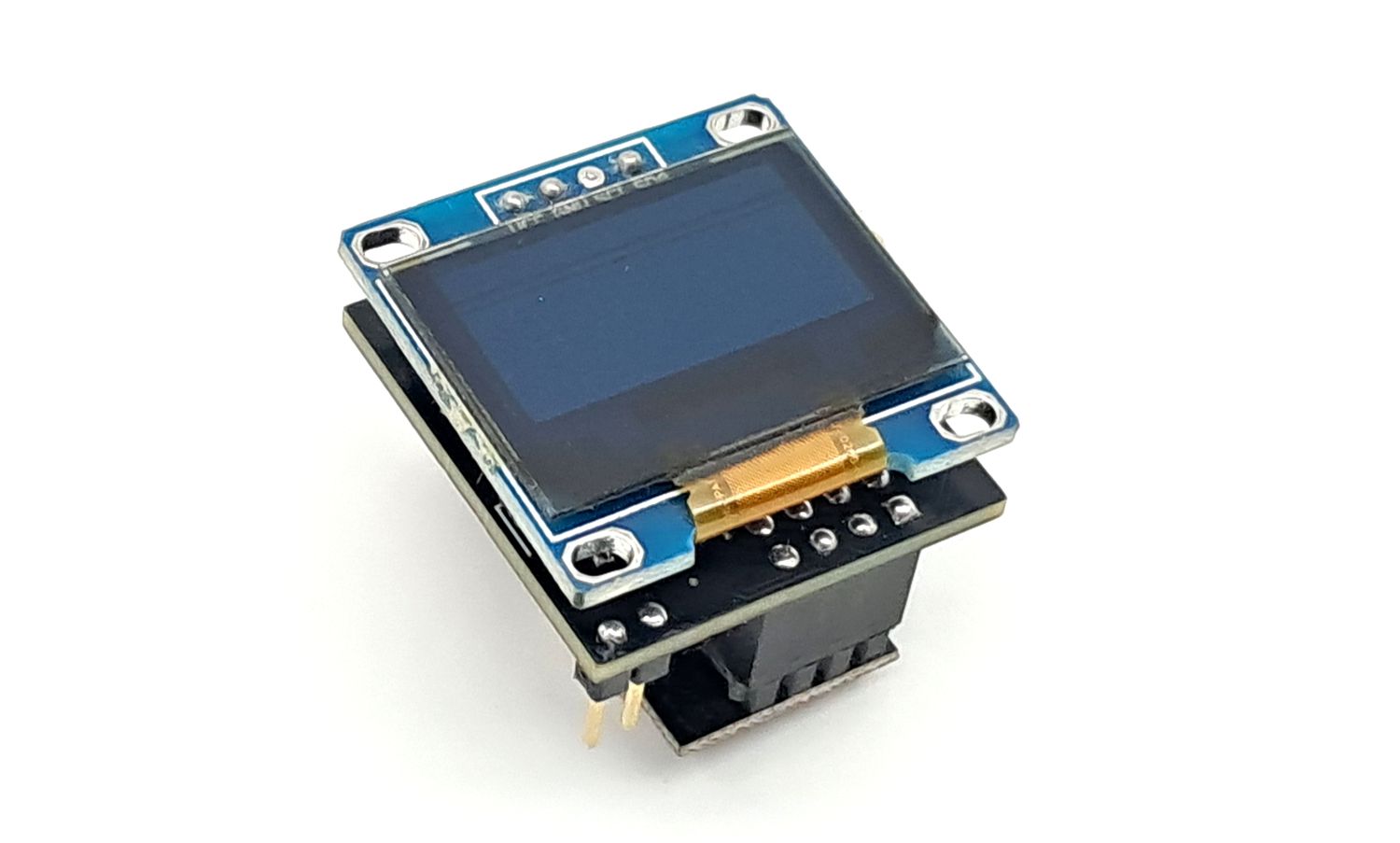

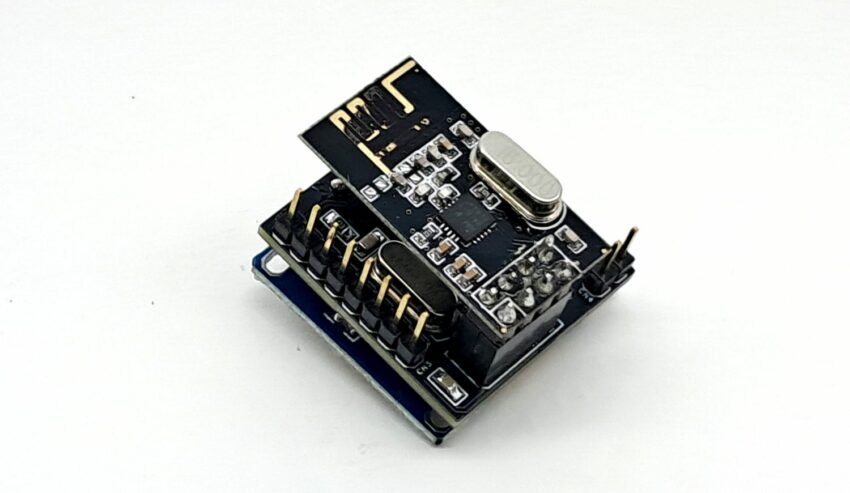

This project is the receiving end of a Wireless Humidity and Temperature monitoring system. The receiver unit is built around an Arduino microcontroller, utilizing the ATMEGA328 chip, which provides a reliable and efficient processing platform. The NRF24L01 transceiver module is used to receive data from the corresponding wireless sensor, while a 0.96-inch I2C OLED display is employed to show the received temperature and humidity values in real time.

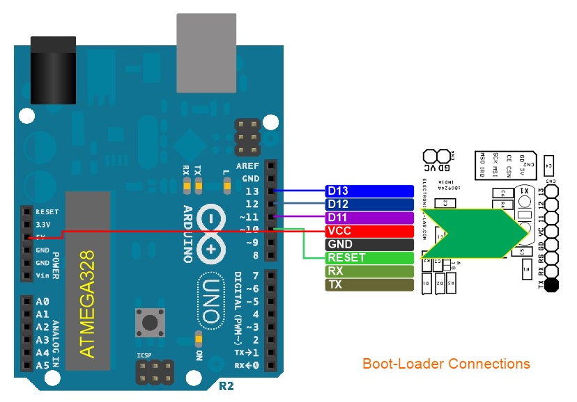

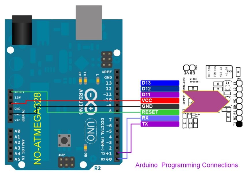

The Arduino code is available for download, and users are instructed to burn the bootloader and upload the code using the Arduino IDE. The connection diagram for bootloader Arduino programming is also provided, along with additional resources for Arduino programming and bootloader information.
Resources
- Programming ATMEGA328P microcontroller with Arduino IDE: https://www.electronics-lab.com/project/programming-atmega328p-microcontroller-with-arduino-ide/
- Arduino To Breadboard example: https://docs.arduino.cc/built-in-examples/arduino-isp/ArduinoToBreadboard/

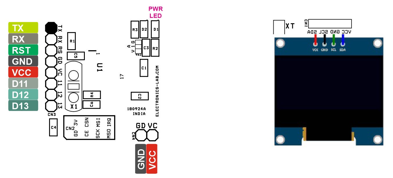

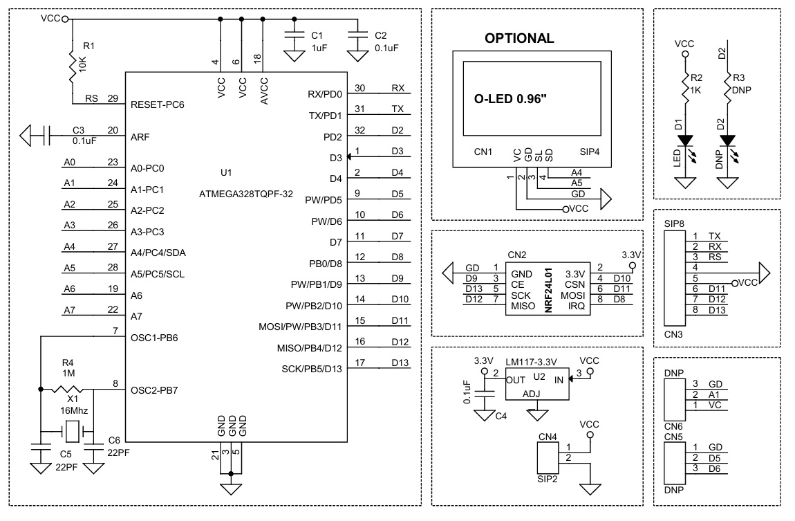

Connections
- CN1 OLED Display: Pin1 = VCC, Pin 2 = GND, Pin 3 = SLA/A5, Pin 4 = SDA/A4

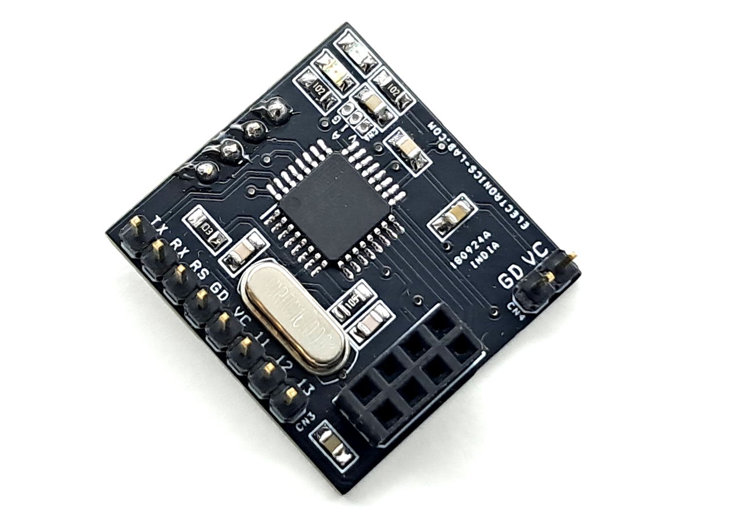

- CN2 NRF24L01 RF Module: Pin 1 = GND, Pin 2 = 3.3V, Pin 3 = D9, Pin 4 = D10, Pin 5 = D13, Pin 6 = D11, Pin 7 = D12, Pin 8 = D8
- CN3 Programming Connector: Pin 1 = TX, Pin 2 = RX, Pin 3 = Reset, Pin 4 = GND, Pin 5 = VCC, Pin 6 = D11, Pin 7 = D12, Pin 8 = D13
- CN4 Power: Pin 1 = VCC 5V DC, Pin 2 = GND
- CN5: Solder Pad (Not Used)
- CN6: Do Not Install
- D1: Power LED
- D2: Do Not Install
Schematic
